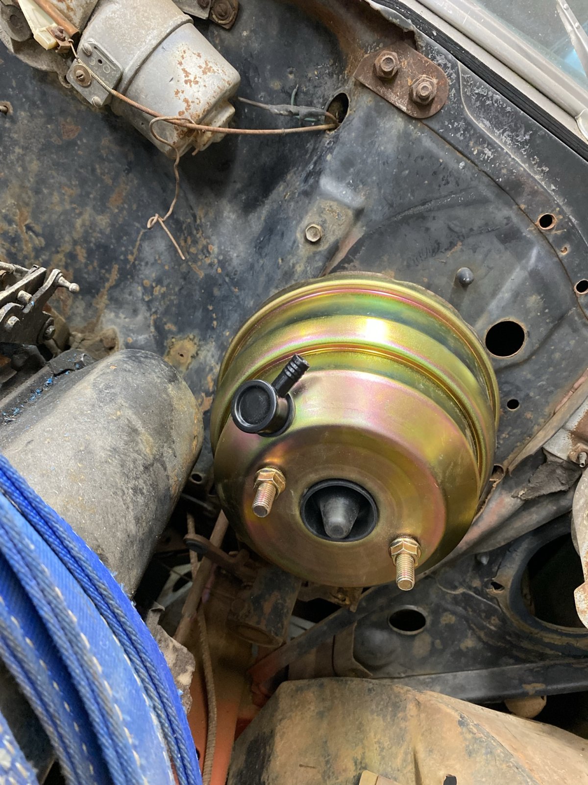

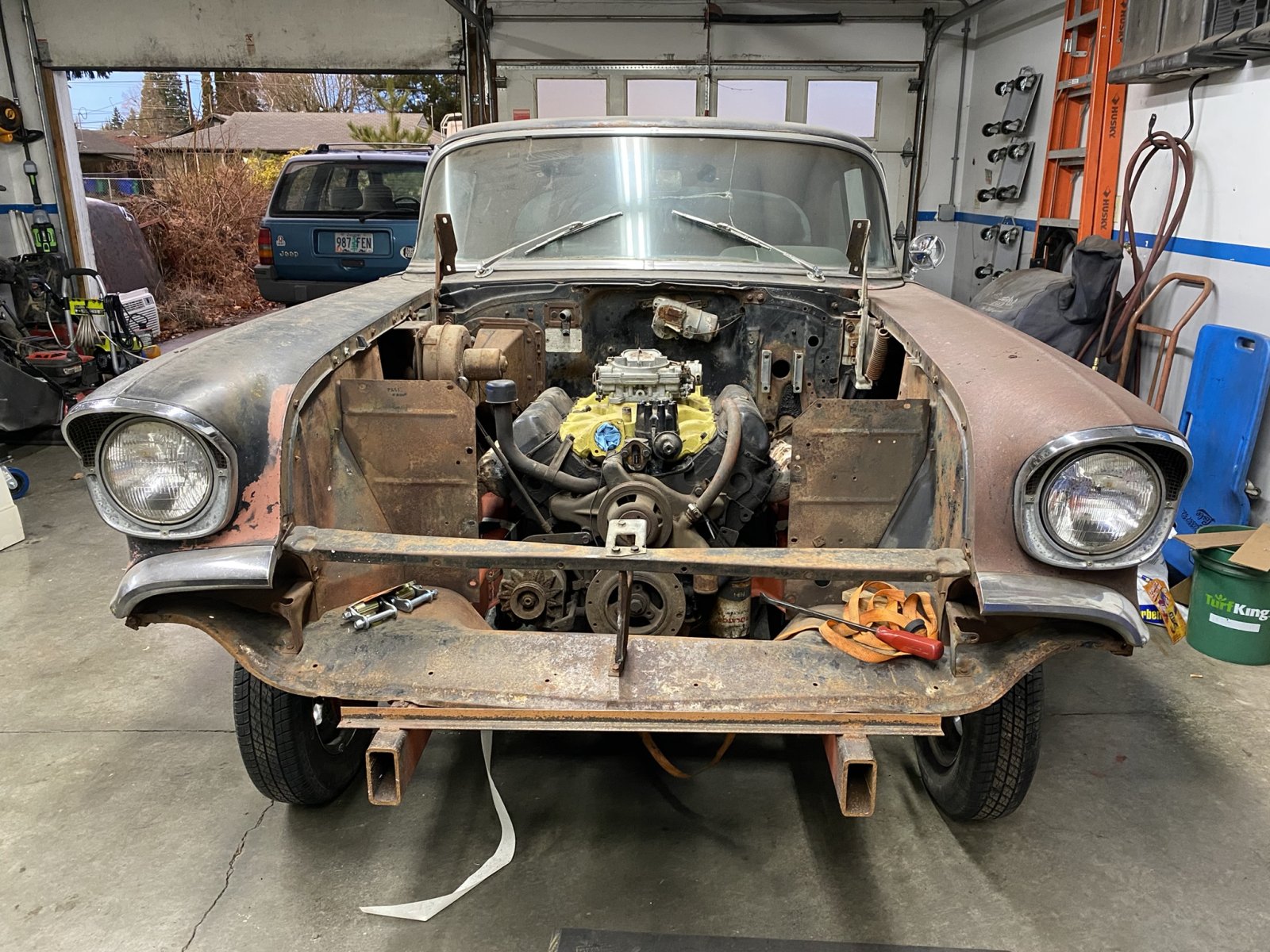

    IMG_8620.JPEG 64574244274__19197372-1F46-4535-83BA-A0EA1CF870EC.JPEG Clearance to the brake booster is tight and that is with the engine shifted 1/2" to the p***enger side. Also the current alternator is close but could get a little closer to the frame rail. There should be an extra inch of clearance at the back for the faux generator/alternator though it will need a revised bracket.

    Ride height isnt finalized as I will keep adding things to the front end including a radiator full of water and antifreeze but I set it up with the engine block as low in the frame as I felt I could and the crank centerline is still just a touch below the 24" max many of the rule books have or had.

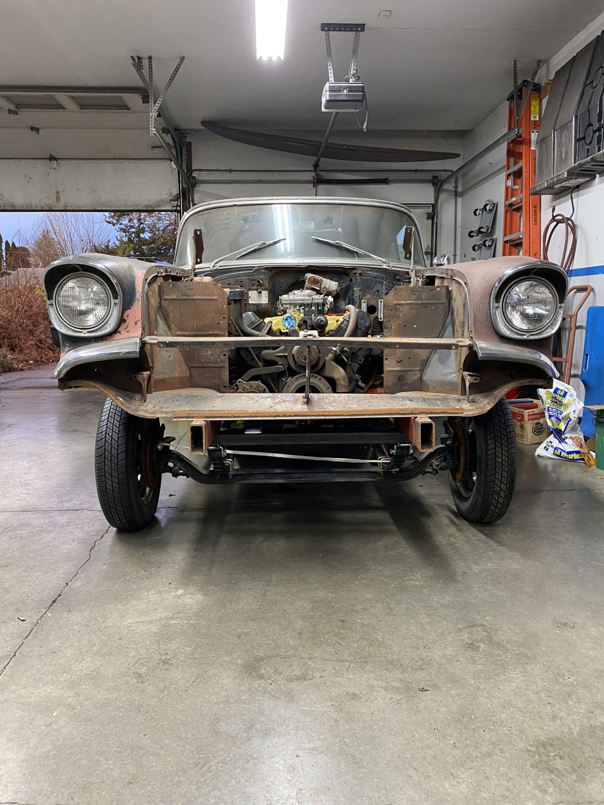

    Here is how it is currently sitting at approximate ride height. The tape is being used to emulate the drag link as I was trying to see if the steering box could move far enough forward to keep it parallel. IMG_8636.JPEG IMG_8638.JPEG

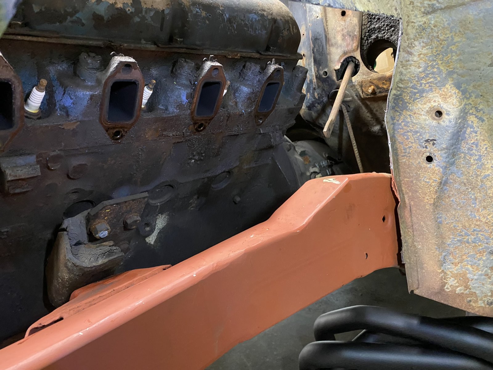

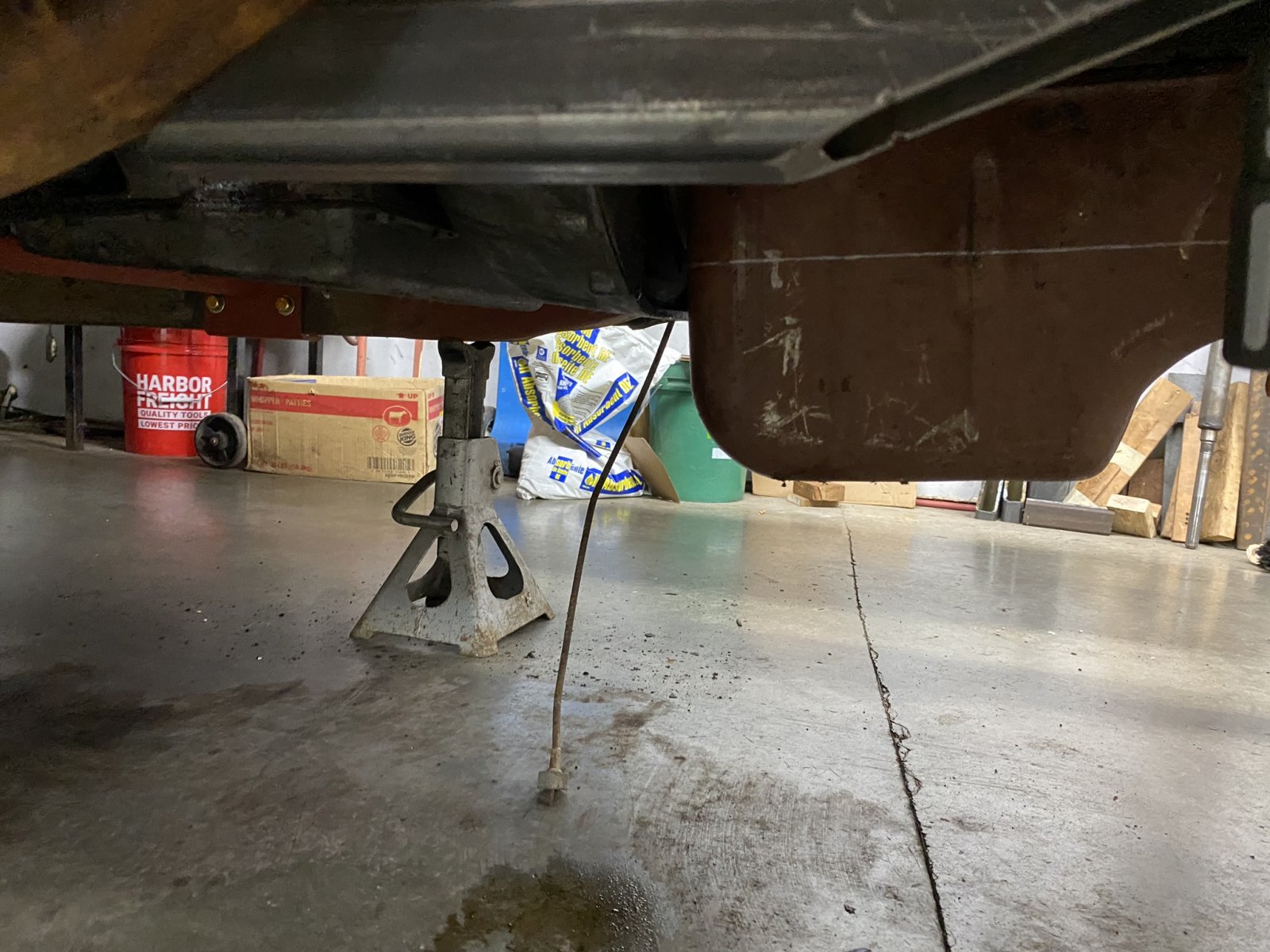

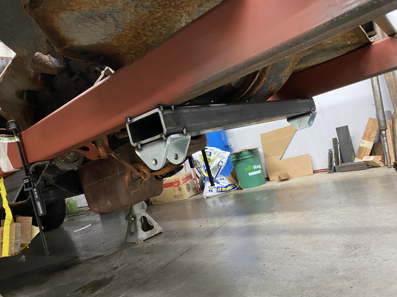

    Here is the vertical 2x4 tube that will carry the rear swing shackle of the front spring. It has a taper cut to marry up to the stock frame and will add strength to the front clip. The tape is holding on a 1/8 plate that is spacing out for a weld bead that connects the main new rail with the previous frame rail. Also you get a feel for the oil pan situation. The last photo shows how much I cut out of the inner fender well to run the headers. Hoping the flanges come in soon! Also I plan to make mounts for the front sheet metal to have some rubber isolation from the frame rails. A round tube spreader bar will go in place of the temporary angle iron. :) IMG_8640.JPEG IMG_8641.JPEG IMG_8643.JPEG

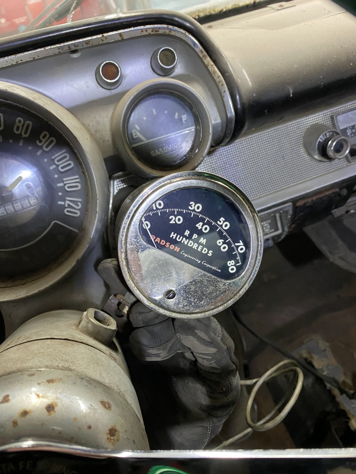

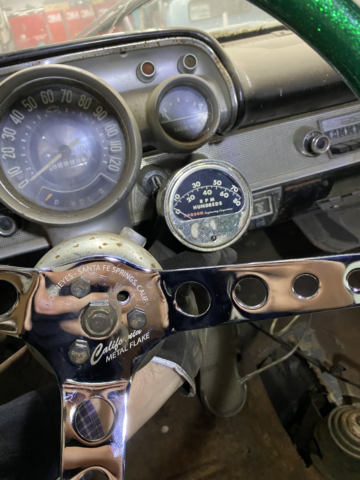

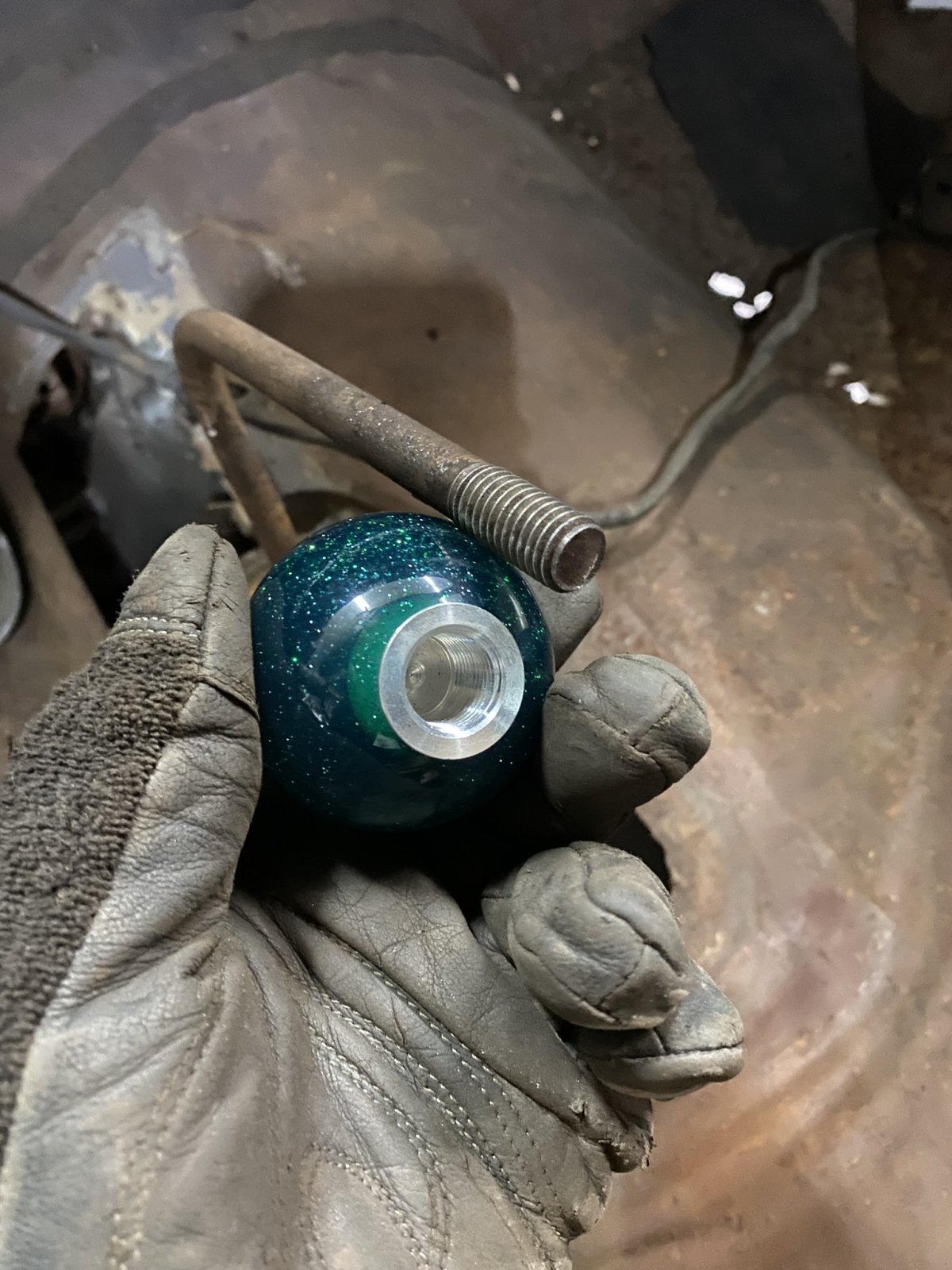

    I put the Mooneyes Steering wheel on and bought an ebay matching shift knob to go on the shifter that came from the same Edsel which I think is a vintage aftermarket 3 speed shifter. I need to make an adapter to go from the 1/2 13 thread to the shifter M16x1.5 pitch. Also got what I hope is a good deal on a Radson Tach. IMG_8644.JPEG IMG_8657.JPEG

    Worked on getting the Three on the Tree column out, looked at where the tach could mount, close up of the shifter knob issue IMG_8661.JPEG IMG_8662.JPEG IMG_8664.JPEG IMG_8665.JPEG IMG_8666.JPEG

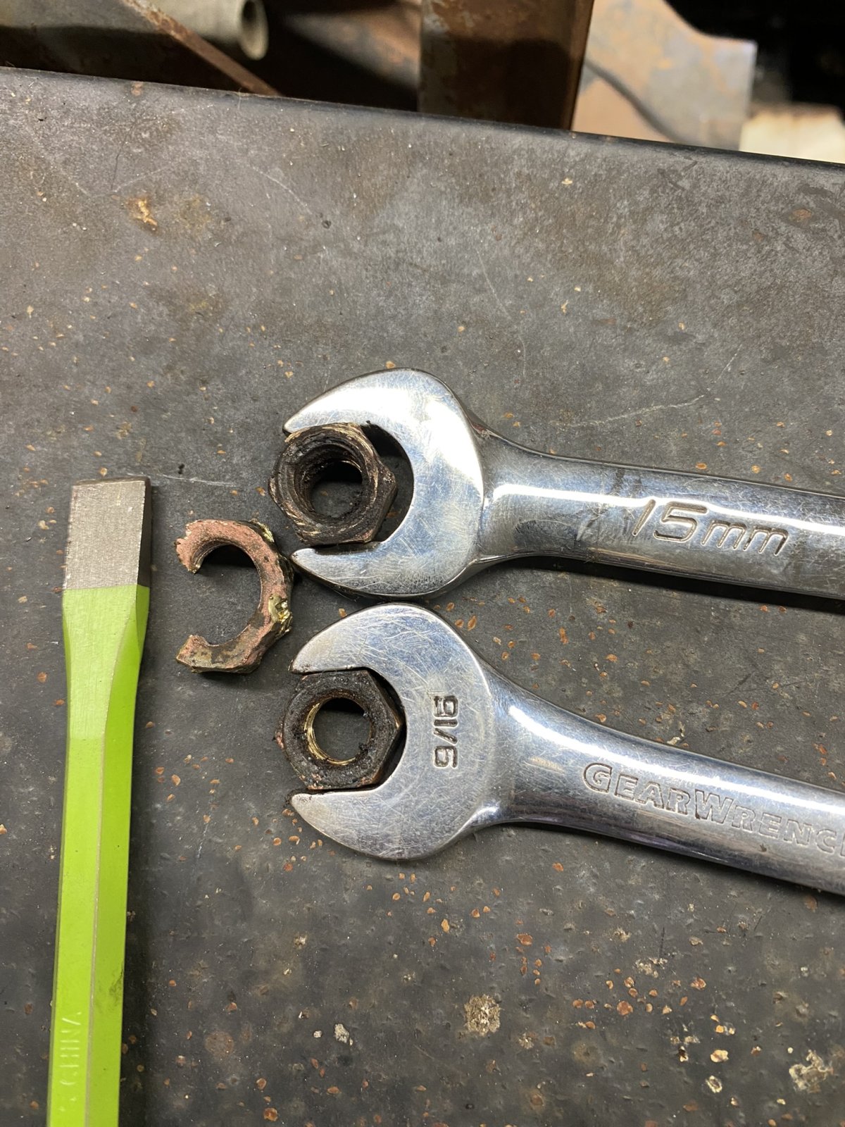

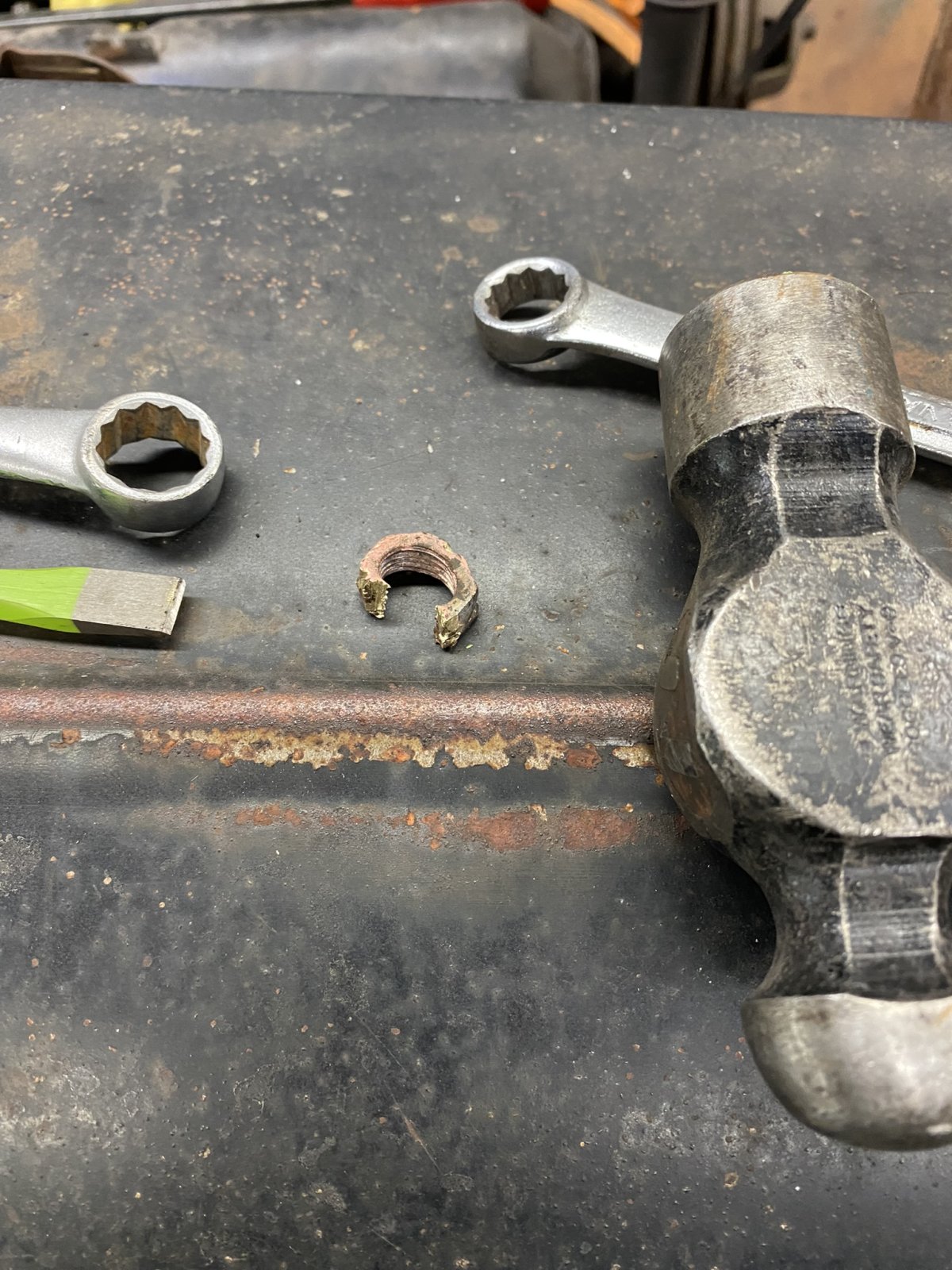

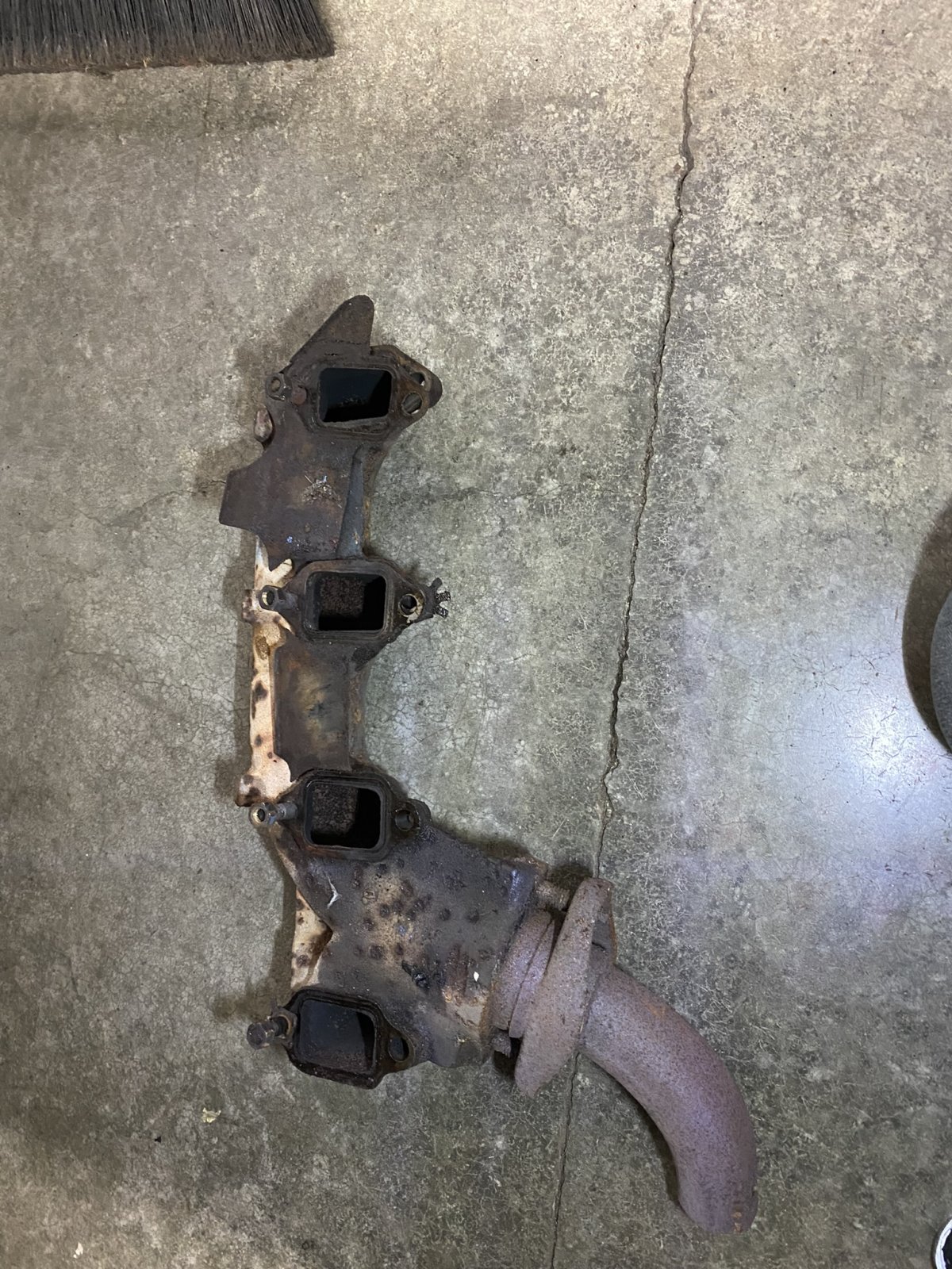

    I also fought to get the crazy *** MEL exhaust manifolds that bolt in two different directions with br*** nuts on studs that stay in the upper part of the manifold and bolts that hide underneath and may hold back oil? One nut had to be chiseled off as it was stuck and rounded itself off. Another nut was misshapen from heat and/or overtightening? That required some metric help to be removed. I held up the fender well headers and they should fit pretty well once my flanges come in and that spaces them out another inch or two. I will need to trim the inner fender well opening up higher as well. Also they leave ample room for steering shaft to live!!!! IMG_8680.JPEG IMG_8682.JPEG IMG_8683.JPEG IMG_8686.JPEG IMG_8690.JPEG IMG_8693.JPEG
