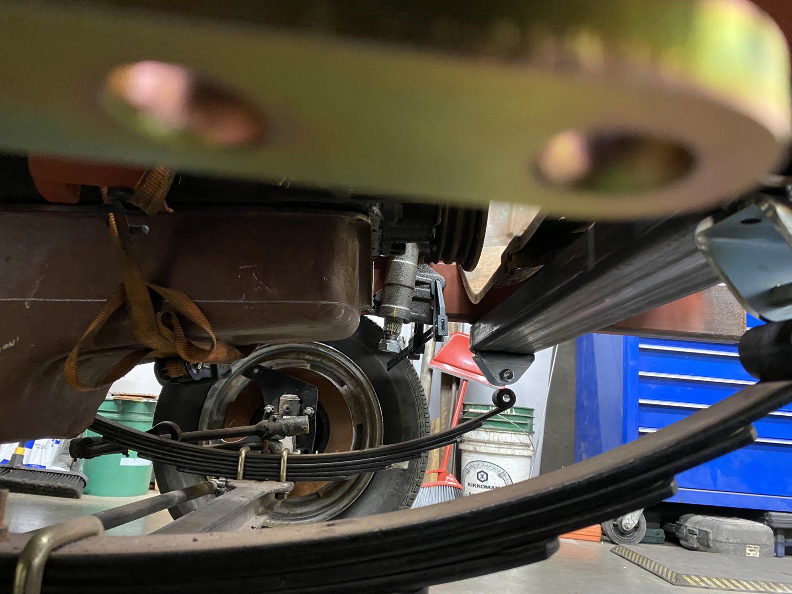

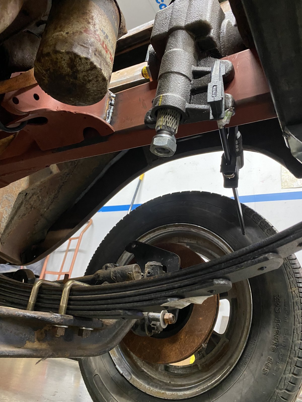

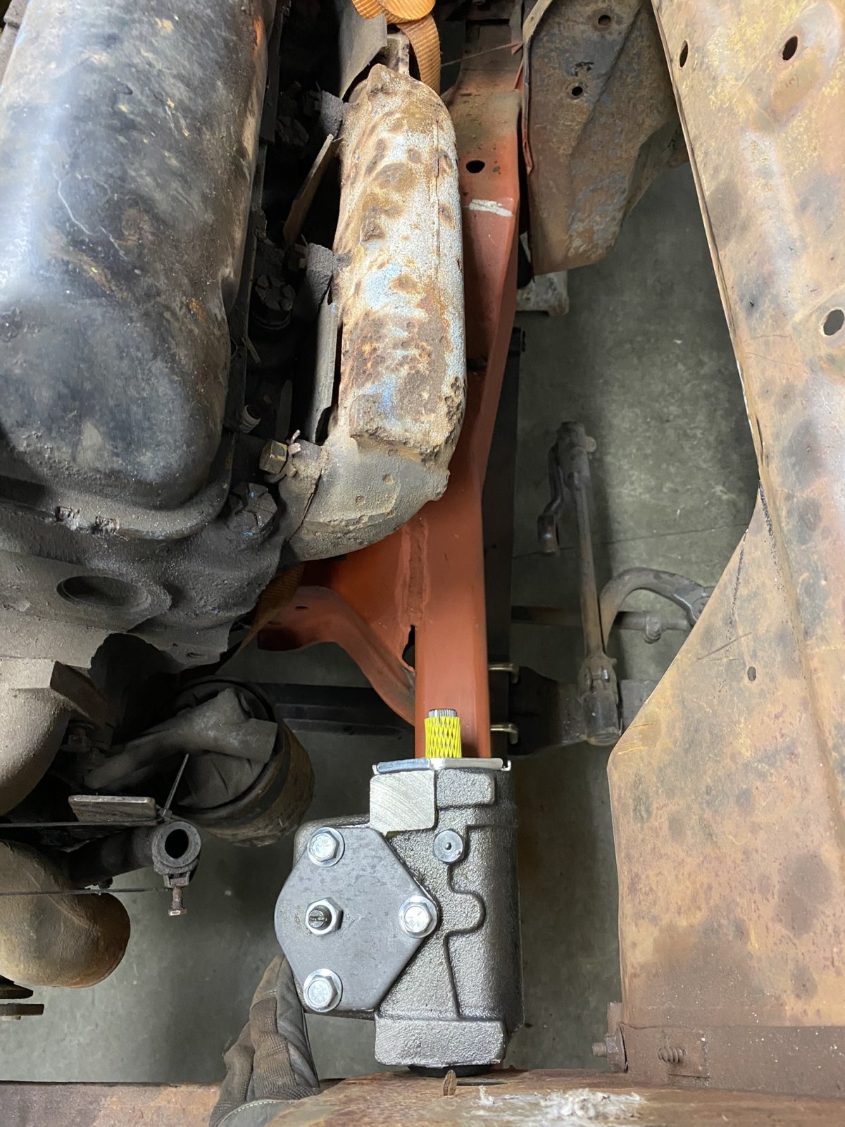

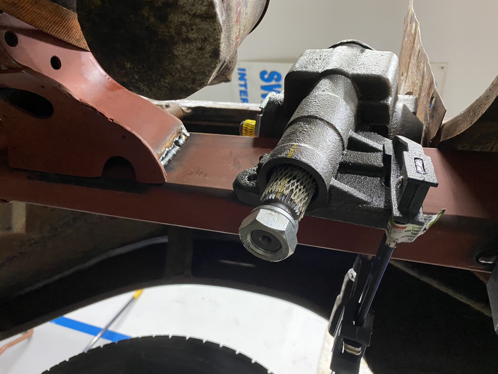

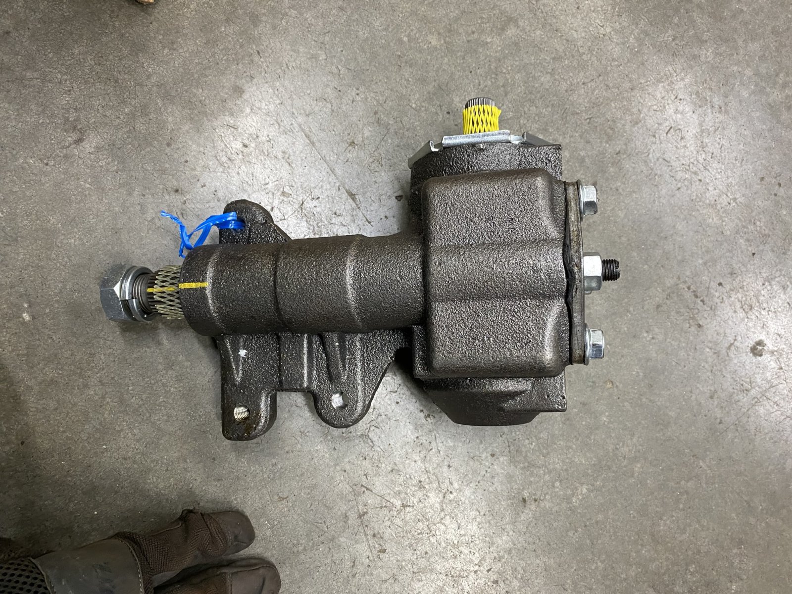

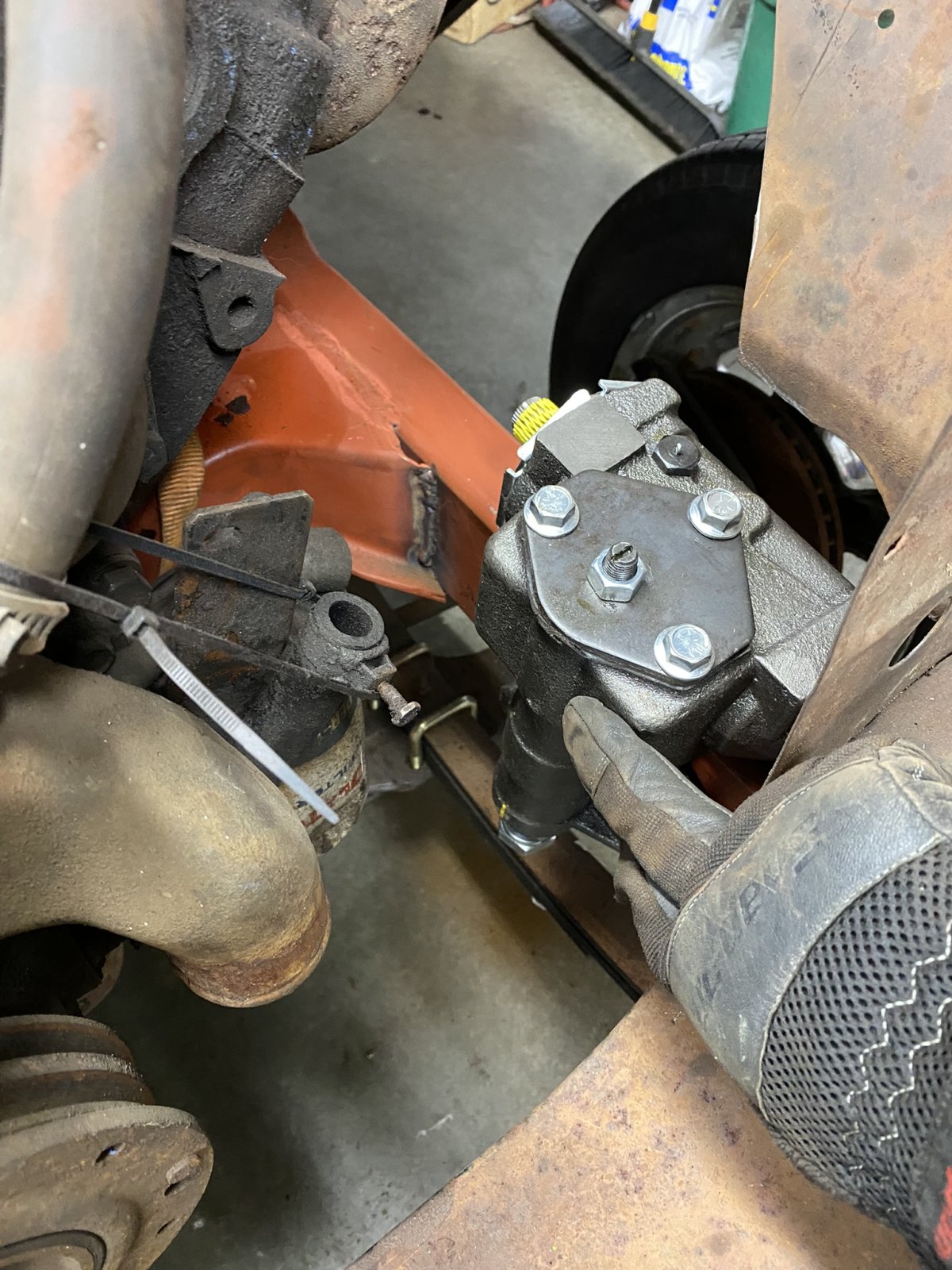

    Concurrently I was mocking up the Lares 18644 steering box and there appears currently to be ample room for steering shaft. I picked up a steering arm puller from Harbor Freight. I may still need a section of collapsible shaft and a joint but we will see. IMG_8667.JPEG IMG_8669.JPEG IMG_8670.JPEG IMG_8671.JPEG IMG_8673.JPEG IMG_8676.JPEG IMG_8677.JPEG IMG_8678.JPEG IMG_8679.JPEG IMG_8685.JPEG

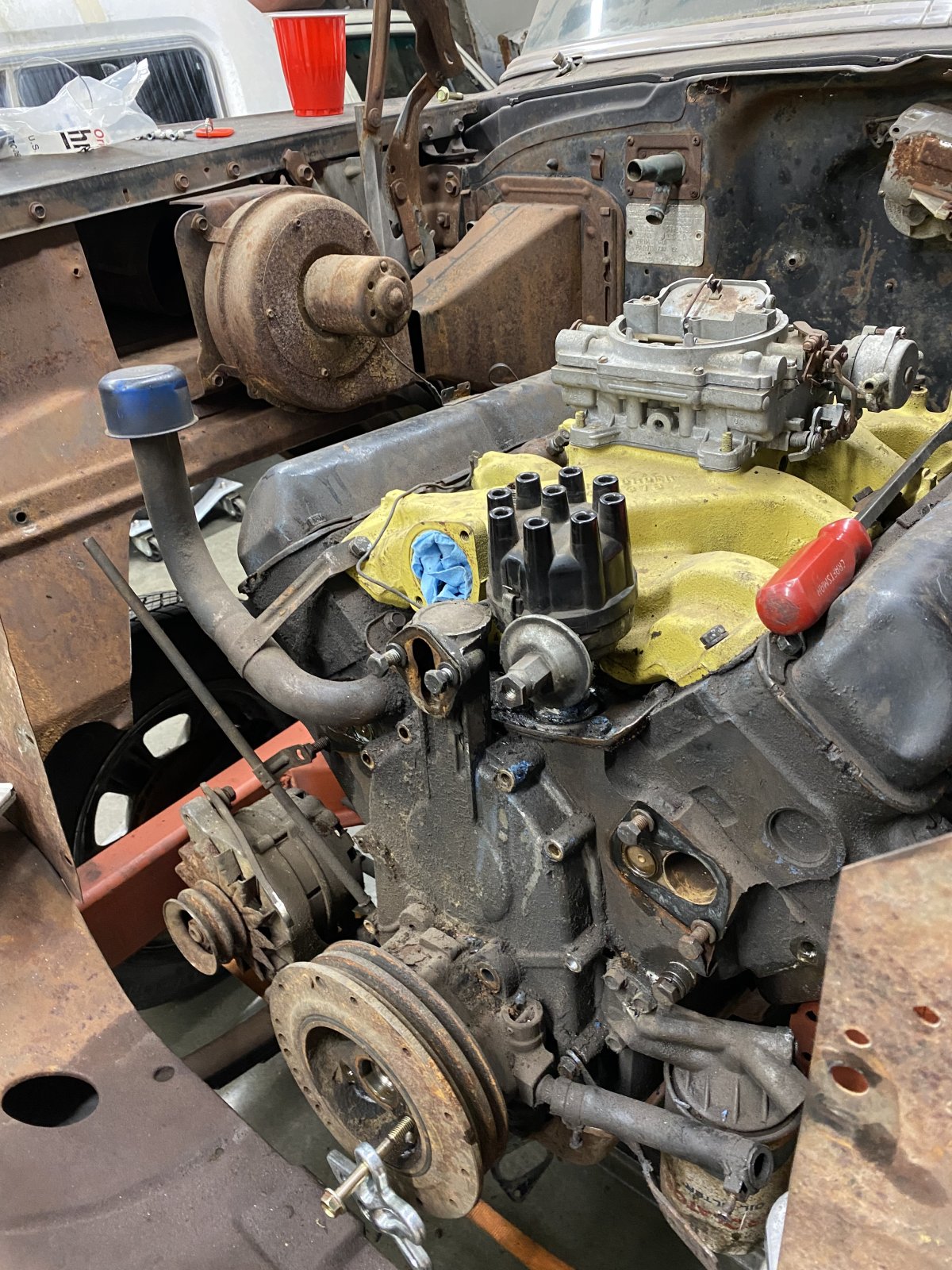

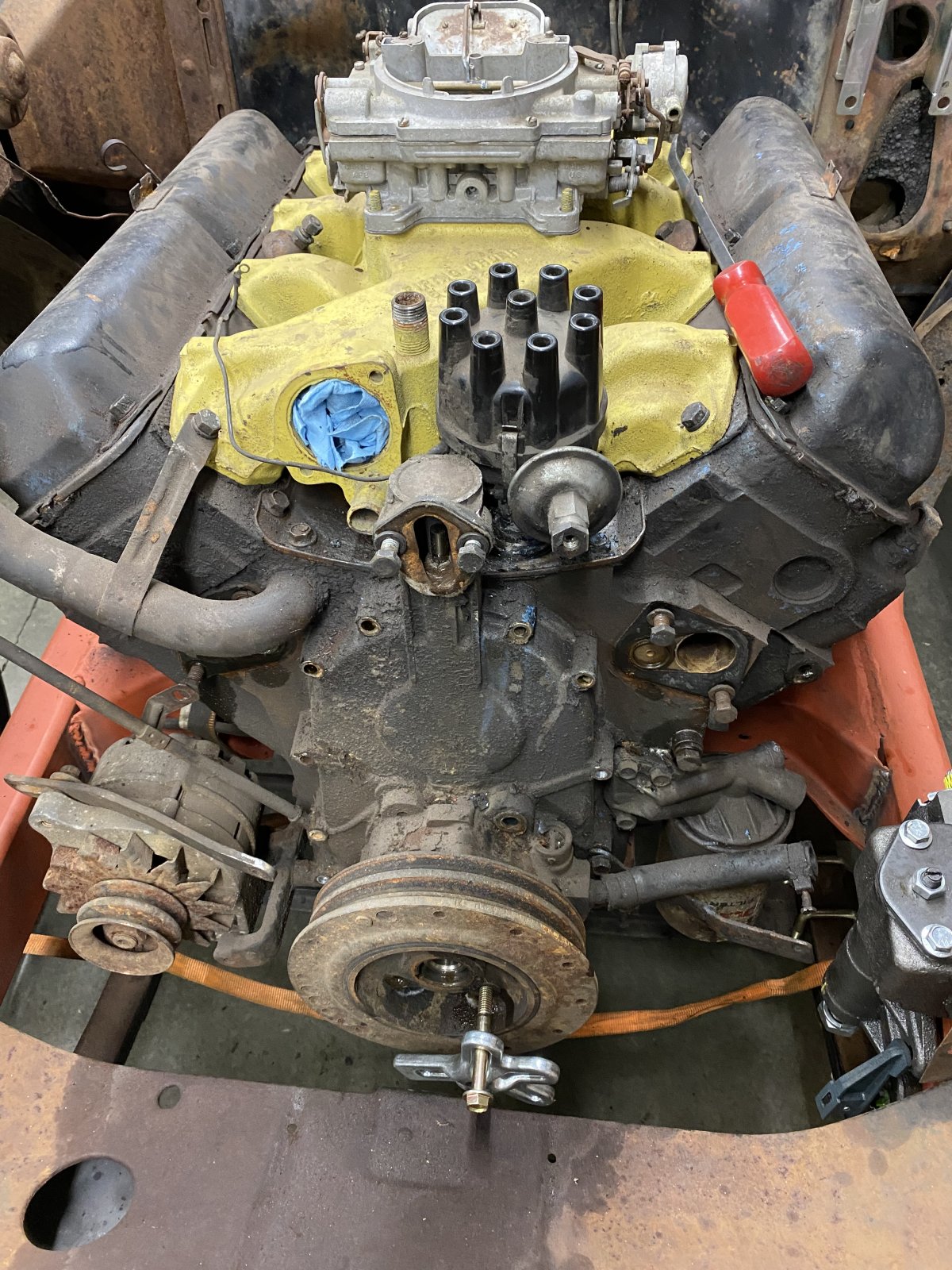

    Look past the ugly welds and lack of on the engine mounts, they are not final. The hole at the bottom of them is to get the socket up in them to tighten them. Not sure how the 60 year old engine mounts will hold up to drag strip launches but we will give them a try! I have some flathead biscuit style ones and I could do a saddle mount or something else down the line. Anyway they are doing their current job of holding the engine in the air which is the main thing.

    Fresh, stock mounts should survive with a torque strap/chain.

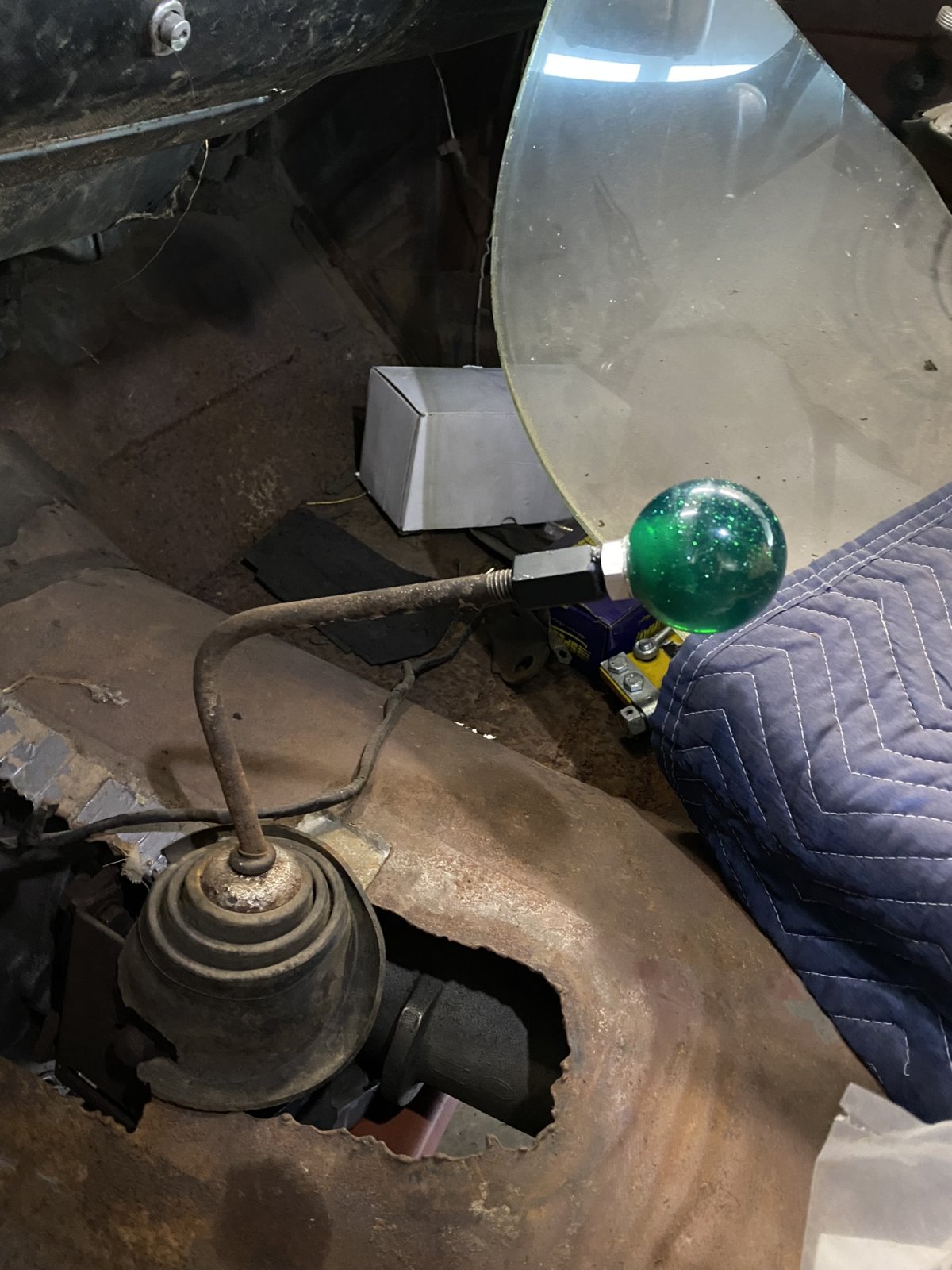

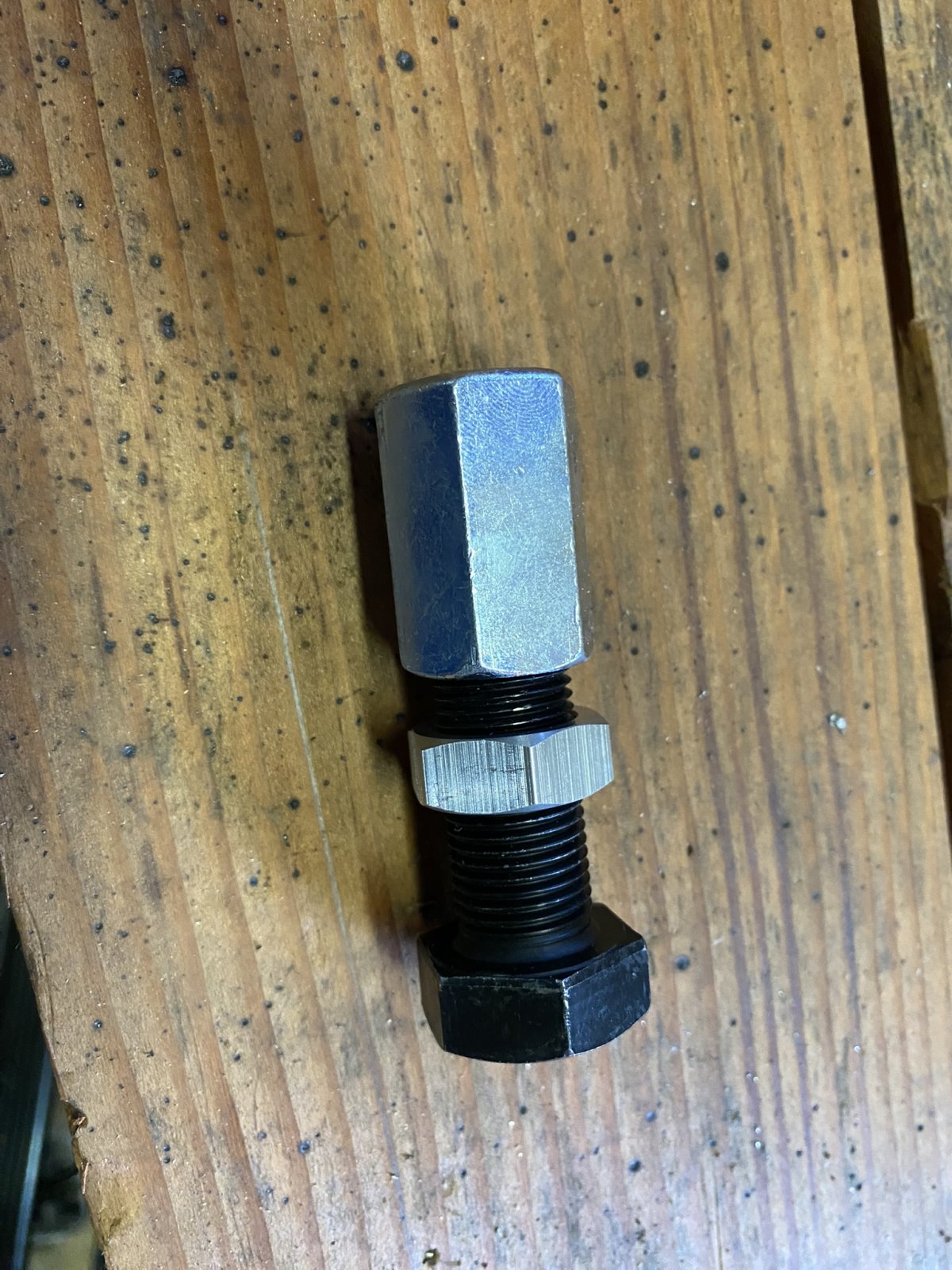

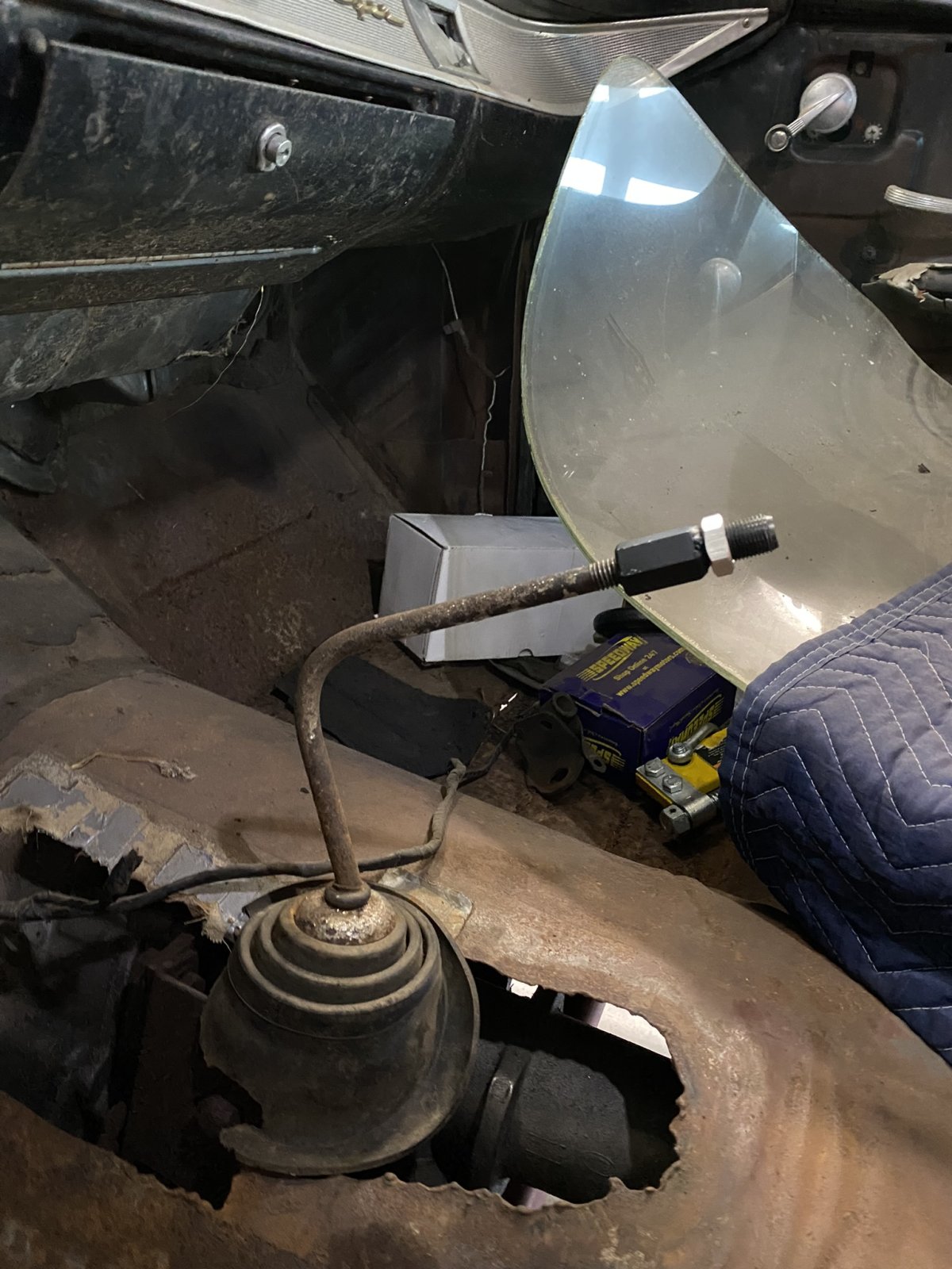

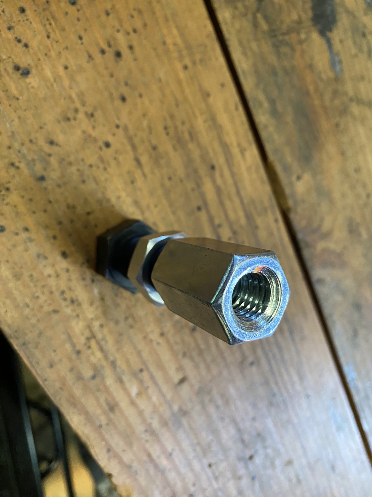

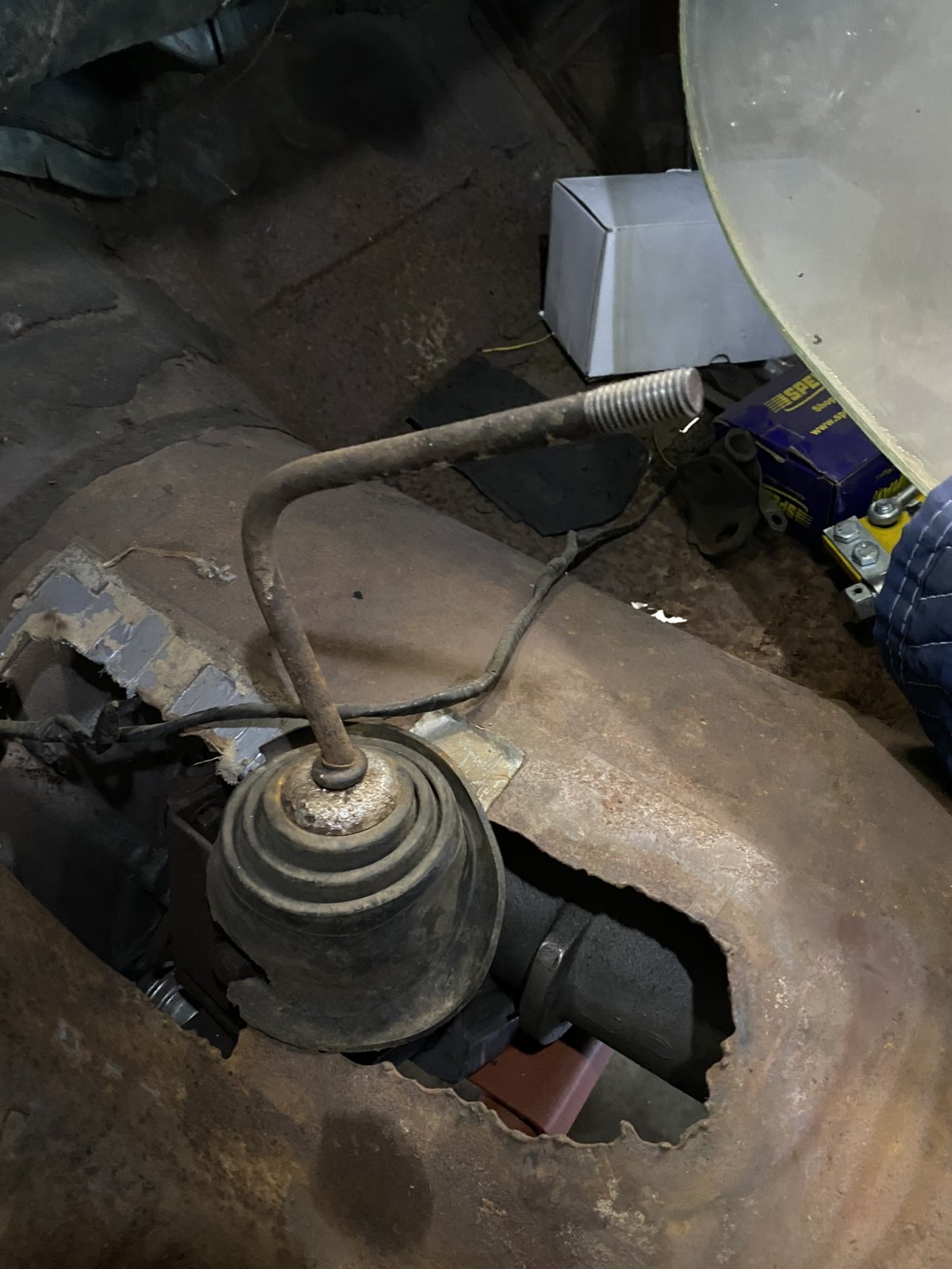

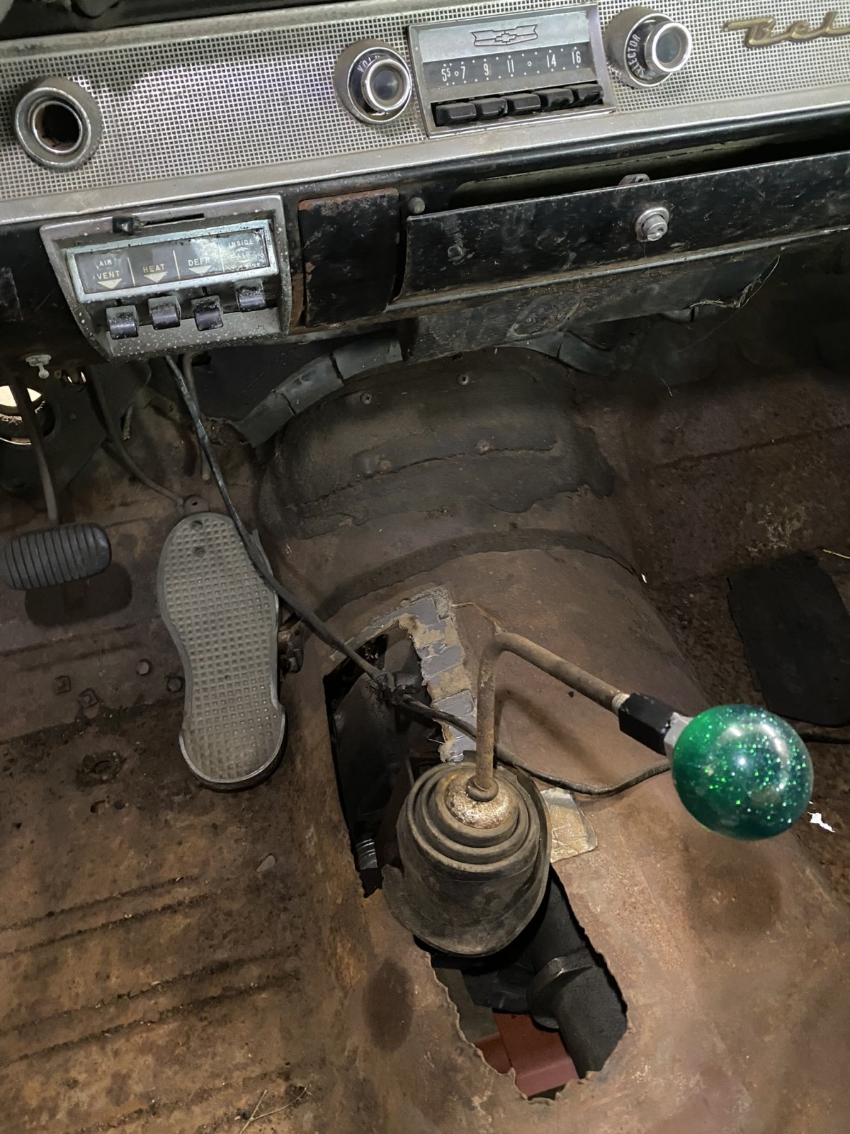

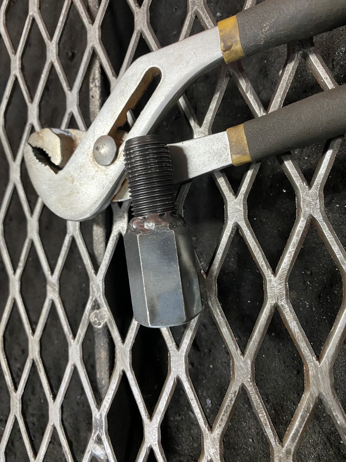

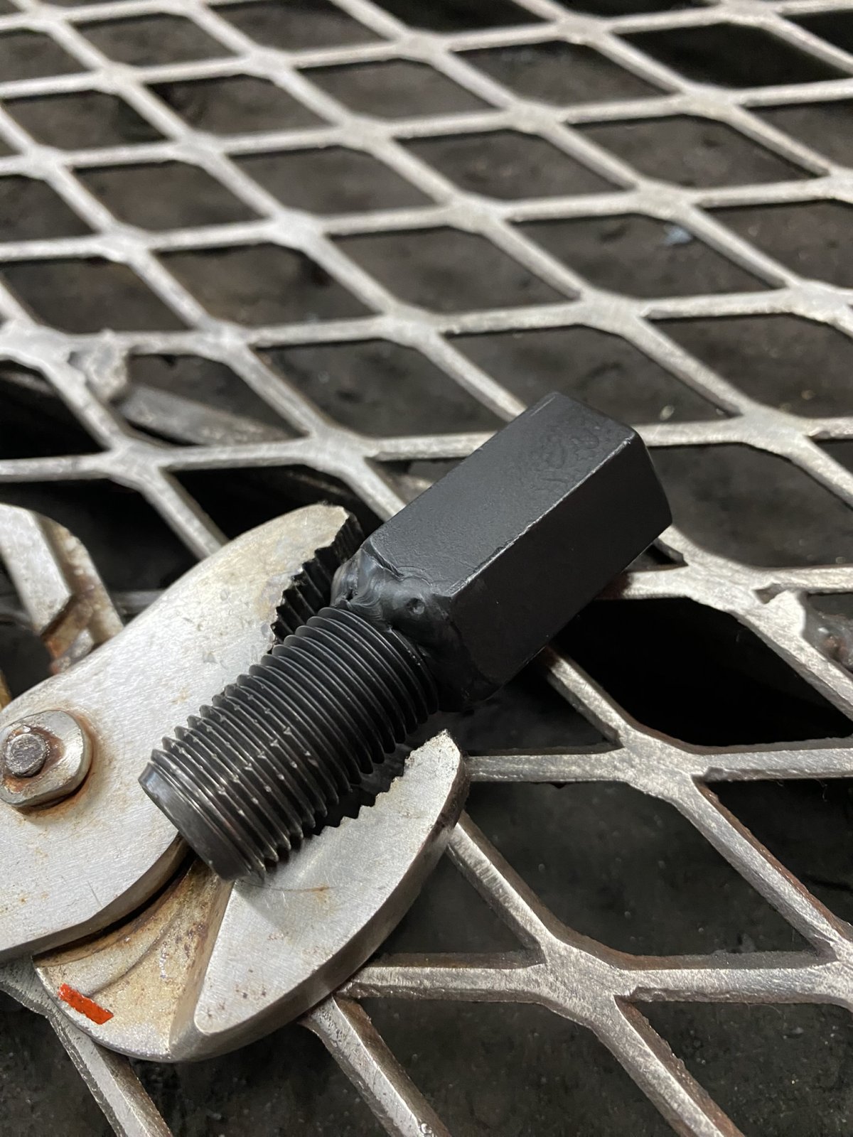

    An adapter nut plus a metric bolt ground down and welded together at least got the shifter ball mounted and adapted to the vintage floor shifter. Don't love it but it will make due for now. I need to trim the m***ive hole a little more and patch it back as well as connect the linkage to the transmission. The plan is to add a plate with some sort of detents so there is no funny business with accidentally shifting into Park or Reverse while taking it down the strip. IMG_8701.JPEG IMG_8702.JPEG IMG_8703.JPEG IMG_8704.JPEG IMG_8705.JPEG IMG_8707.JPEG IMG_8708.JPEG IMG_8709.JPEG IMG_8710.JPEG

  5. I really dig that shifter boot.
    fordman1 likes this.
  6. fordman1
    Joined: Jan 11, 2008
    Posts: 395
    fordman1
    It was less mangled before the wrecking yard removed it but oh well.
    Jet96 likes this.

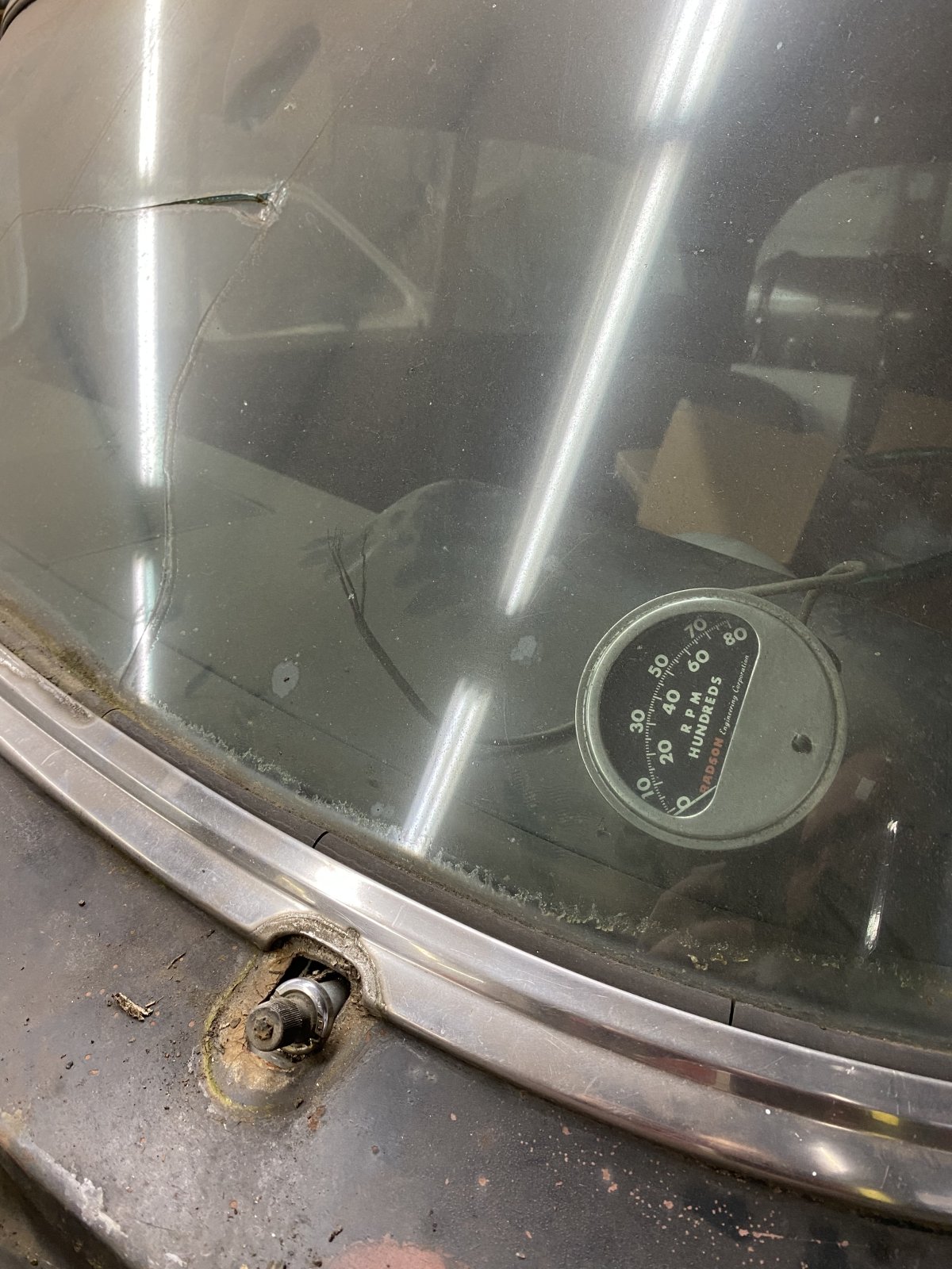

    Got a few more things done. Trying to pick at it every other day even though it isn’t at my house. Started the process of pulling the window to replace it with the intact used one that came with the car. Mostly just so it isn’t sitting inside the car risking it will also get broke.

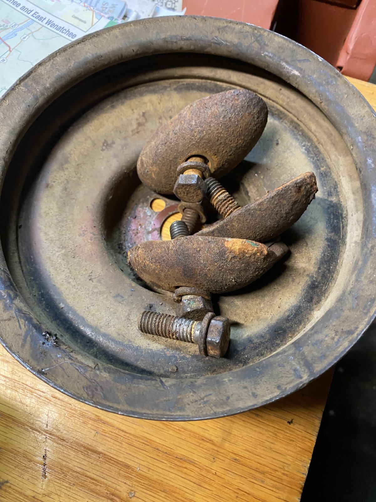

    If anyone has some extra Edsel “footballs” that hold down the ears of the intake I would be interested as they switched to smaller ones on these later Lincoln’s. Otherwise I will build up some weld and grind them smooth to give more surface area. 5537F8C7-106F-462A-A248-6A636C373187.jpeg B3554FB5-35A8-4B03-985D-842328C10C26.jpeg CF73E3AF-9E5E-41BA-AF94-8A51864EF4E0.jpeg 9A20CD8D-0C6E-42E2-81D8-40F49B6938E2.jpeg

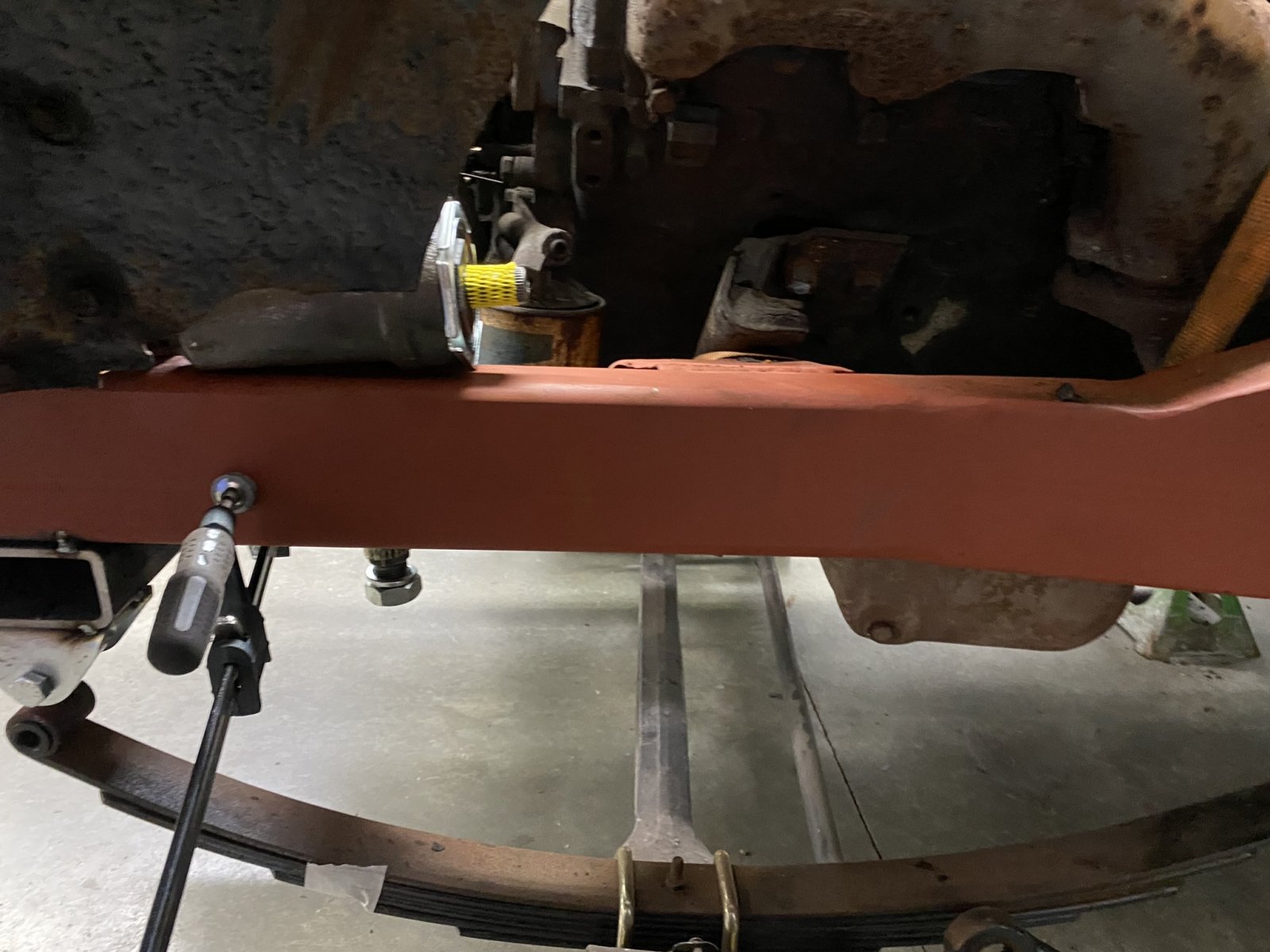

    There is a little more room then you would expect and the steering box needs to push a little further forward on the frame rail. I was looking at FE remote oil filter kits if it comes to that. There is a Summit Racing Fox Body torque strut on its way that should also fit in this little area. Never fear! Things will get packed in once a super charger is added to the mix.:D

    I'll bet if you removed the rear door handles 99% of onlookers would not realize its a four door hardtop. A la Coney Dog wagon.
    EDIT: Chevy 215/235 six footballs should work. They are longer.

    I will look into those! There is actually a 1965 GMC sharing shop space with a 292 and some un used 250s. Great idea.
