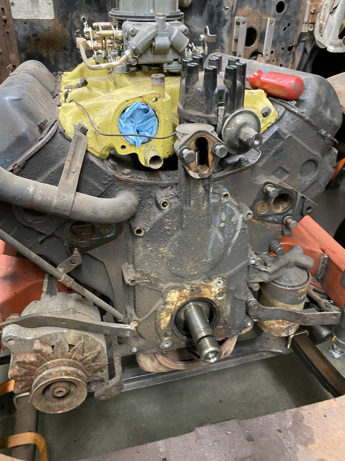

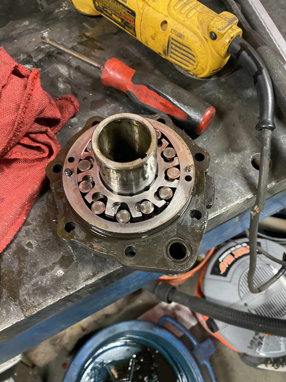

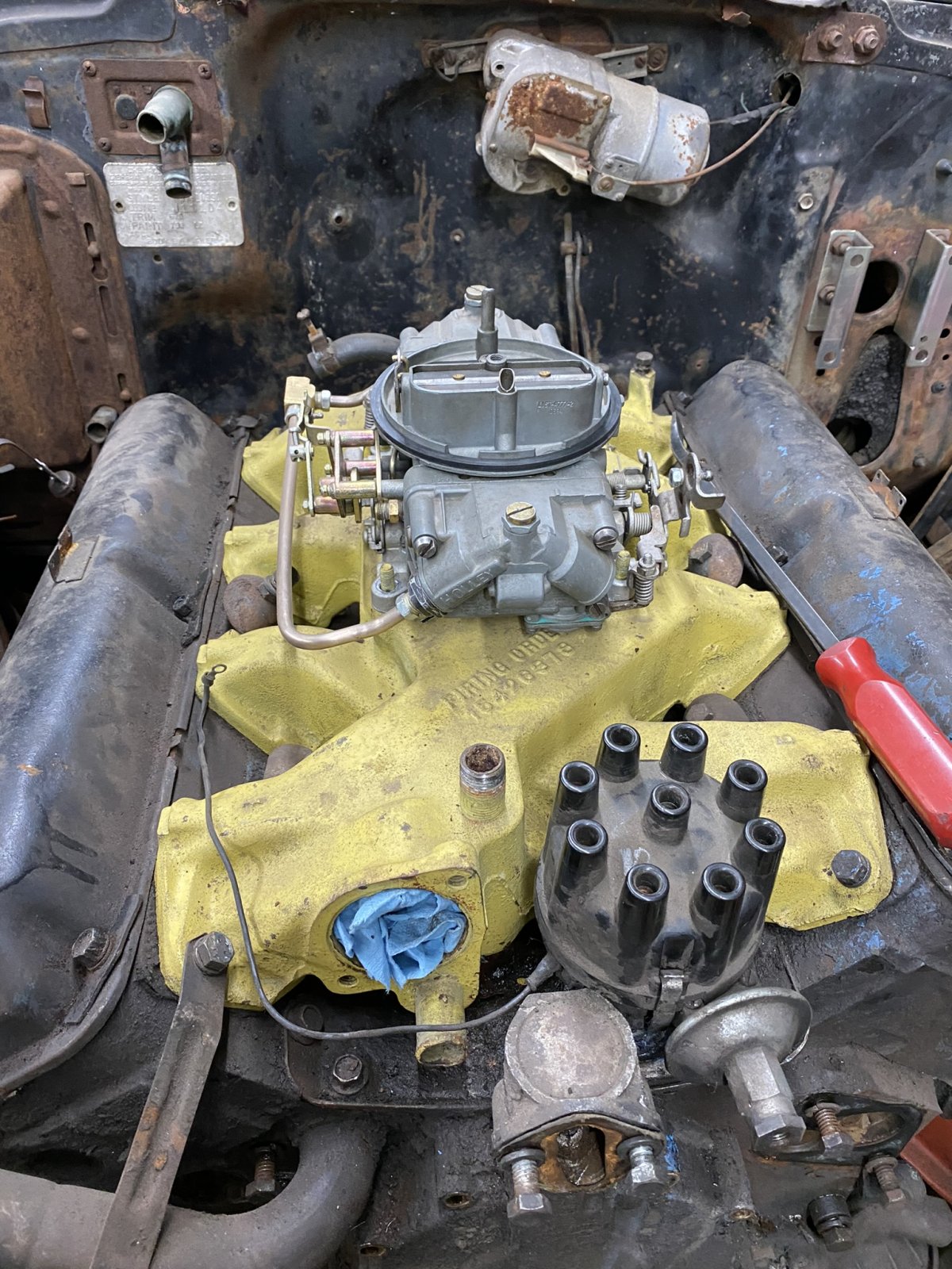

    Picking away at things. Pulled the harmonic balancer to pull the power steering pump. I will likely gut it and reinstall it to both seal off the front of the timing cover and space out the harmonic balancer. On the search for early Edsel and maybe Mercury's that came with a non integral power steering pump so they have a different timing cover and spacer for the crank snout. Also got a holley 4 barrel in trade and it all ready makes the engine look more racy. The gasket set came in so I will pull the engine/trans back out to clean, seal and maybe even paint it! IMG_8747.JPEG IMG_8748.JPEG IMG_8773.JPEG IMG_8774.JPEG IMG_8775.JPEG IMG_8776.JPEG IMG_8777.JPEG

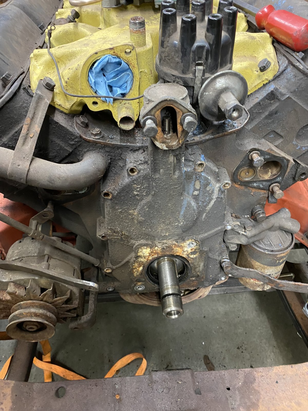

    I pulled the front dress and then bolted everything back together (with the polished front cover!) IMG_8780.JPEG IMG_8798.JPEG . I need to finish the front axle, get the windshield in it and wrap up the steering so I can move the car out of my friends garage. The engine will need to be pulled, degreased and then painted but that will have to wait until the move.

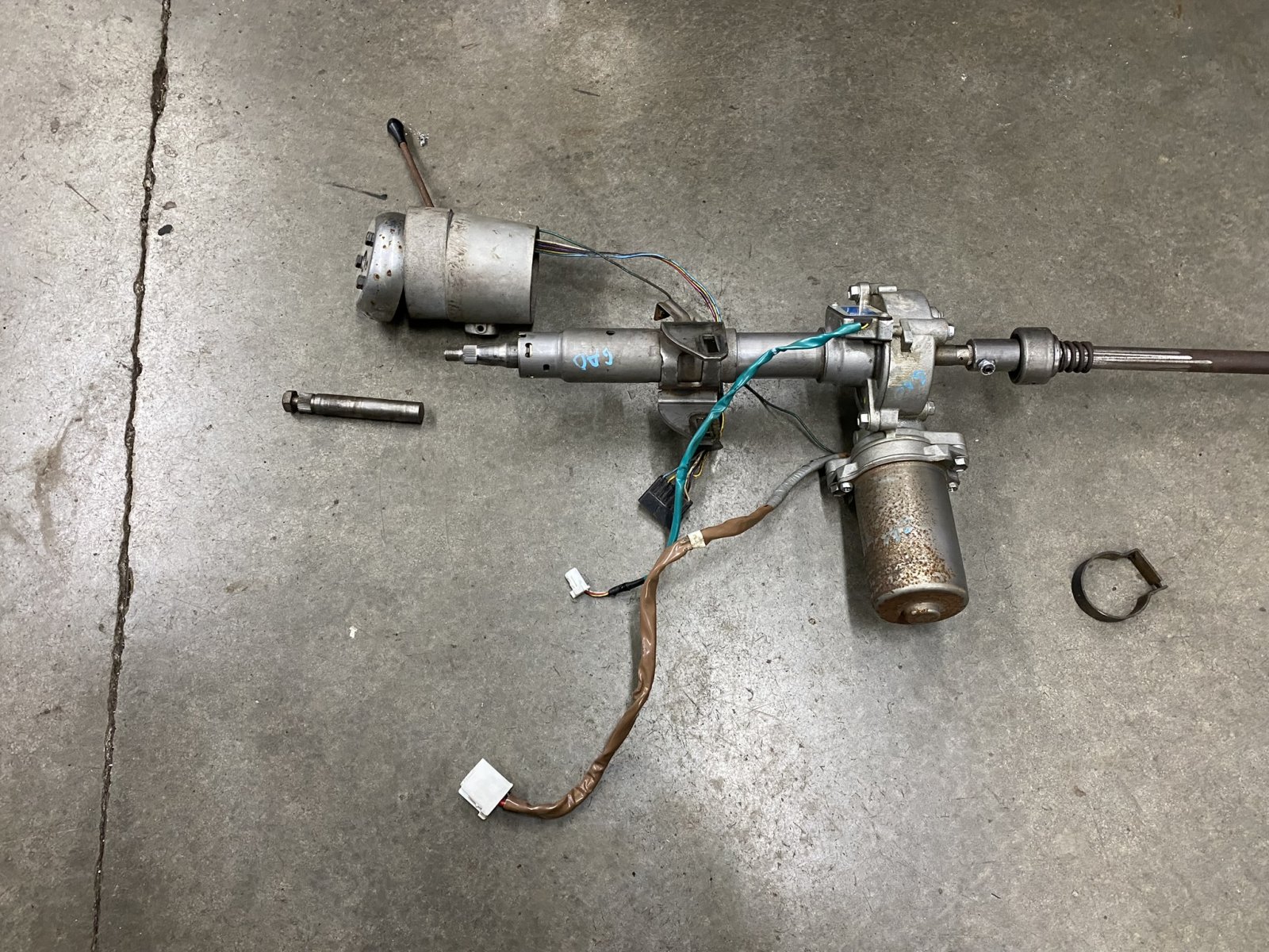

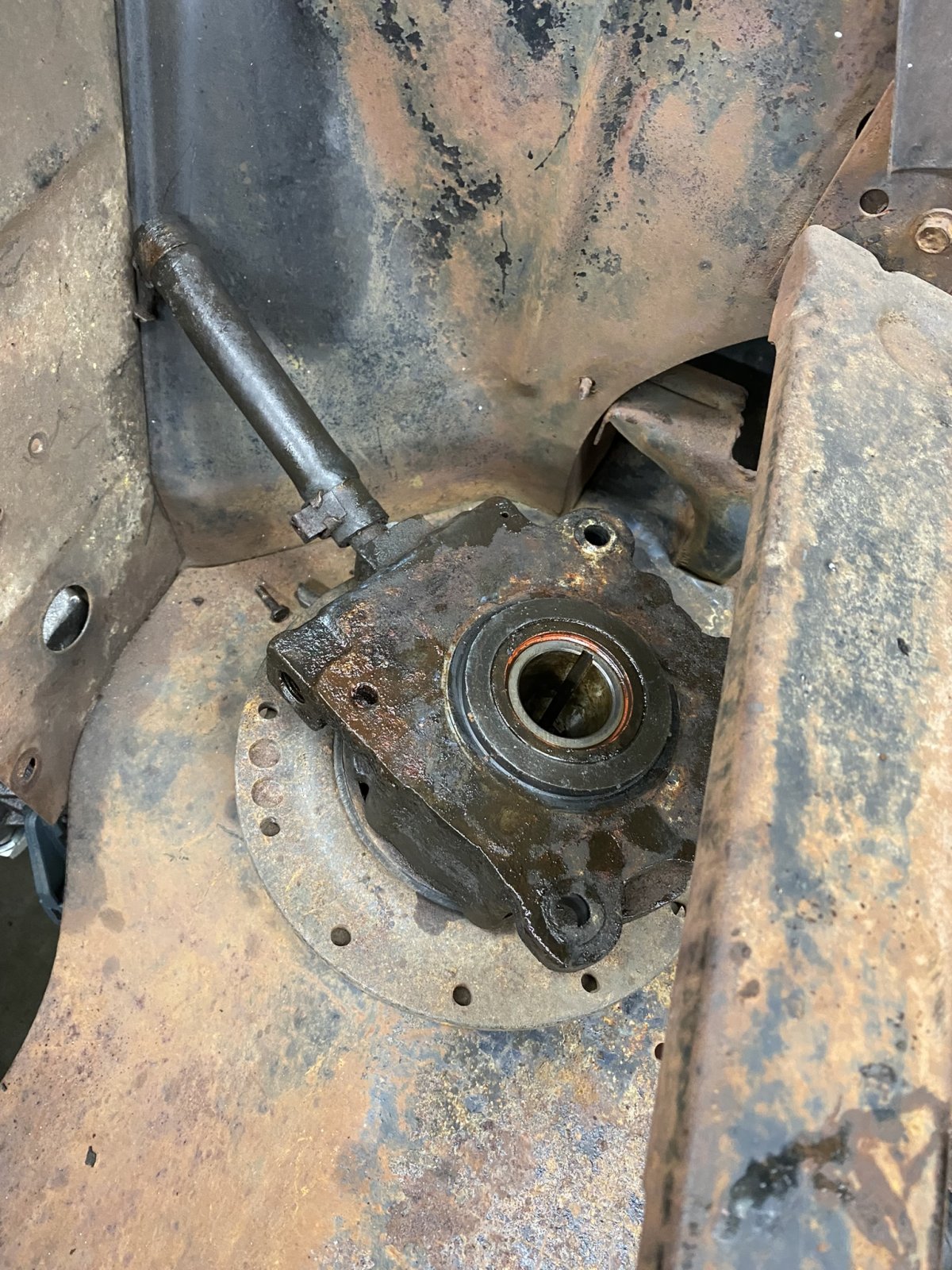

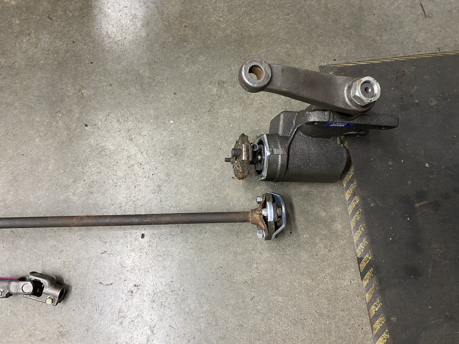

    I laid out all of the steering components and think I may have everything needed to go from the mooneyes steering wheel, to the adapter, to the 57 steering stub, to the prius steering, to a chunk of 1965 GMC steering column (which has a matching rag joint to the Ford one I have) and then to the FoMoCo steering box. Likely the toyota joints will work to make the connections from the straight portions. Trimming of the inner fenders was begun to push the box further forward though that also means it of course is conflicting with the front crossmember. Always something! I am hoping to keep the stock blinker stalk so that will need some rebuild parts. An operating horn button would be nice as well. IMG_8811.JPEG IMG_8812.JPEG IMG_8815.JPEG IMG_8816.JPEG IMG_8817.JPEG IMG_8818.JPEG IMG_8819.JPEG

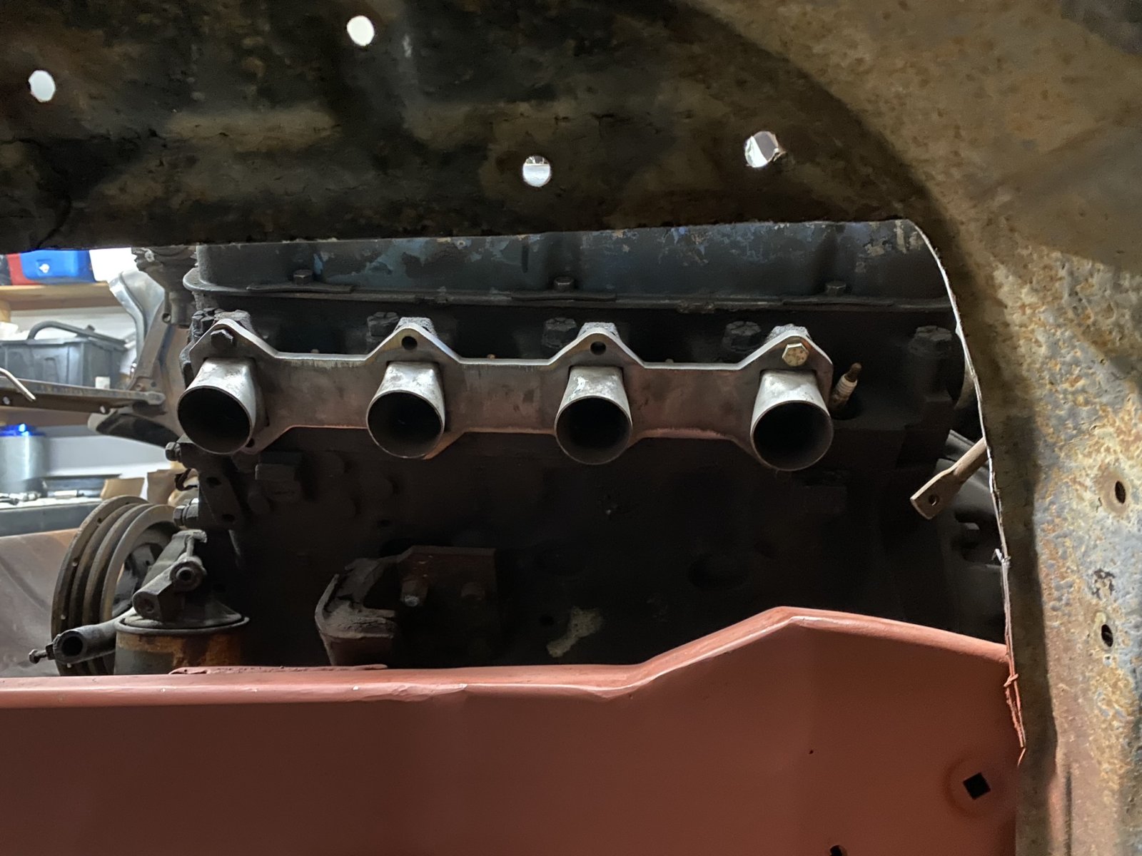

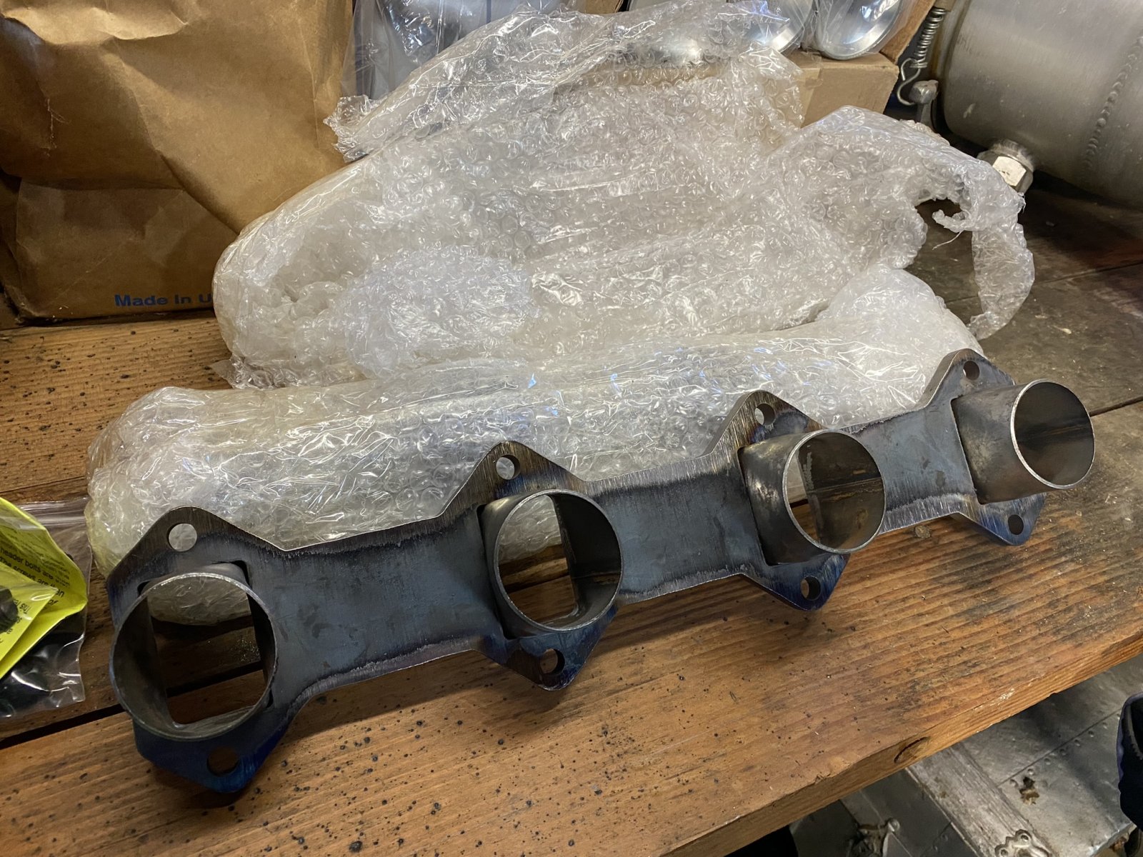

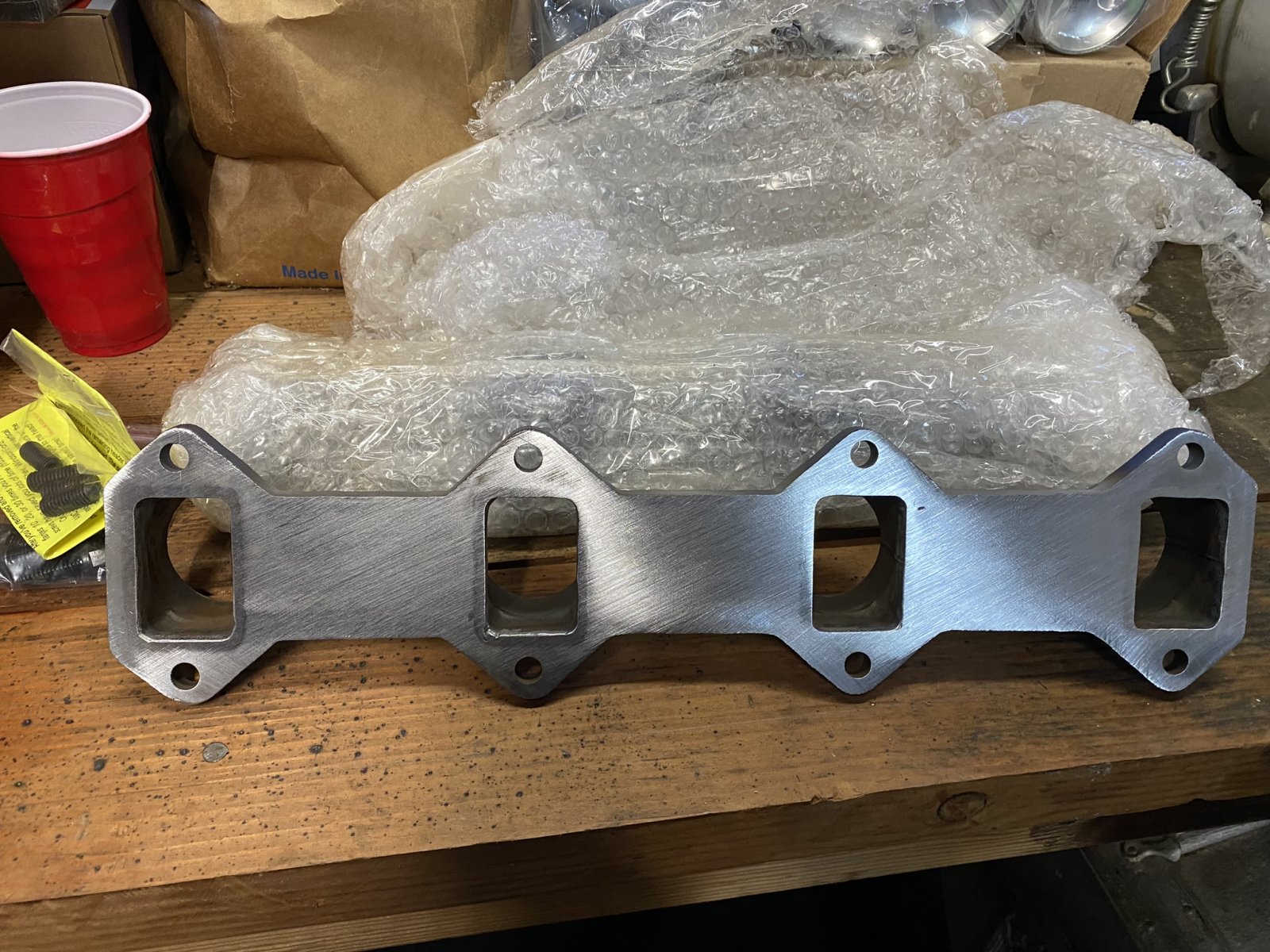

    The Header flanges came in so I can start the work to modify the BBC fender well headers to work with the big Lincoln! Really happy with the product. Not sure if I will need a bend to join the two or if a straight merger will work. I plan to include his logo in the car lettering. I am on the look out for someone to help me develop the logos on the car. Just one more step in the progress. IMG_9008.JPEG IMG_9009.JPEG IMG_9010.JPEG

  11. Change that timing gear before you get it all together, it's got nylon teeth on it. Quite surprised they aren't all broken off yet from age. That'll quickly turn into the kind of "gummer" that sends valves into pistons.
    Badass combo there, stock 430s haul ass in the big cars so it should be a nice handful in a 57. Looking forward to seeing your progress.

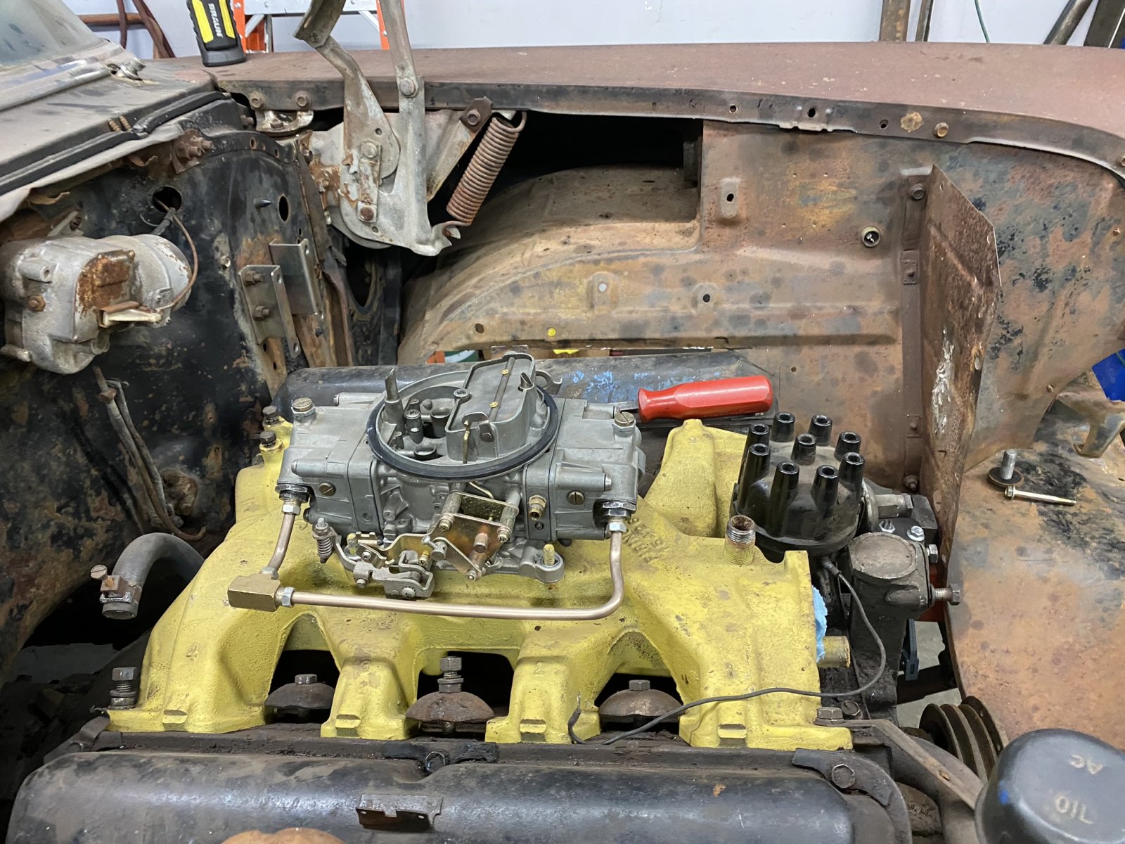

    That's Me! Yes, I am still slowly working on this project. I am still trying to find some one who can do a lost foam casting and make a few copies of the 3D printed intake. It has been a struggle so far. Most foundries want 5 figures per intake to cast a few up. If anybody knows of a lost foam aluminum caster that would be willing to work on this for less than the price of a new truck, I would gladly take the info.
    The Weiand MEL blower intakes have three big short comings for a street application.
    1: The distributor has to be relocated.
    2: There is no provision for a thermostat and the water passages are very small and restrictive. No surprise as it was designed as a race only manifold.
    3: It is one giant plenum that results in very short intake runner lengths that will have a very negative effect on low speed, part throttle operation.
    My intake should cure all three of those problems.

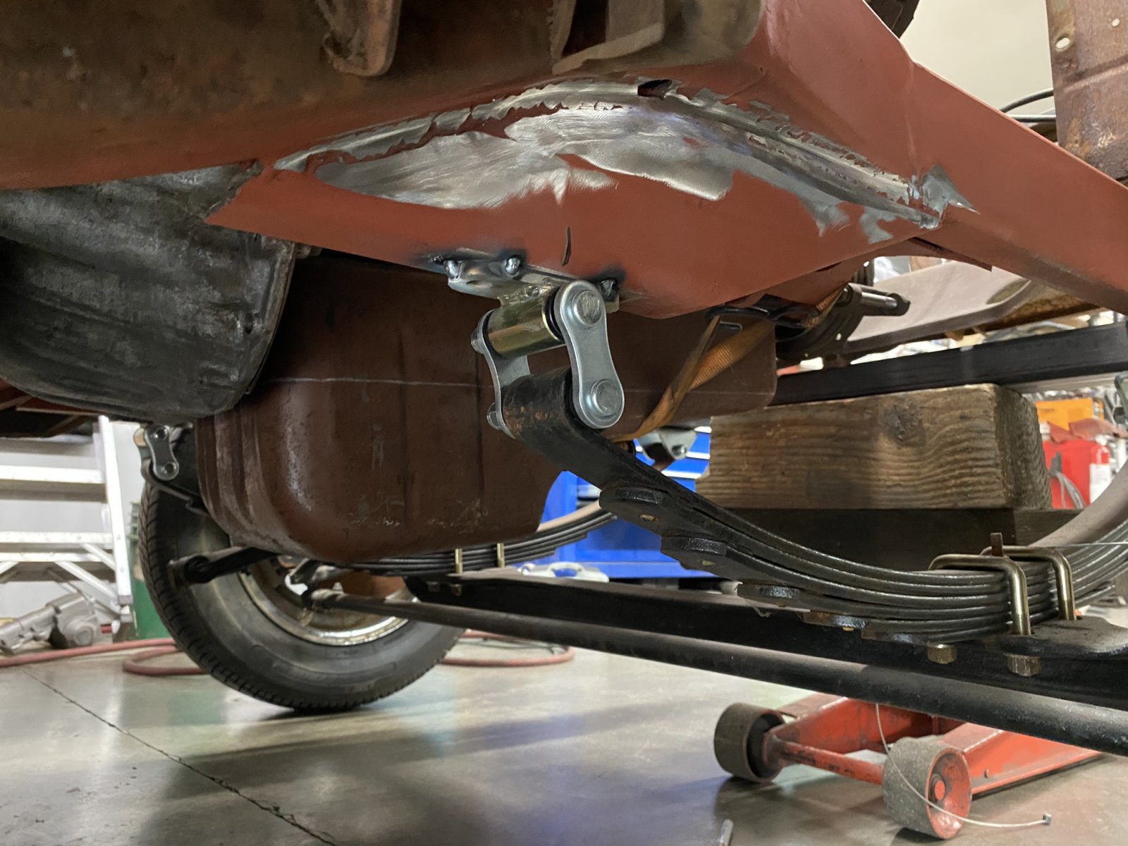

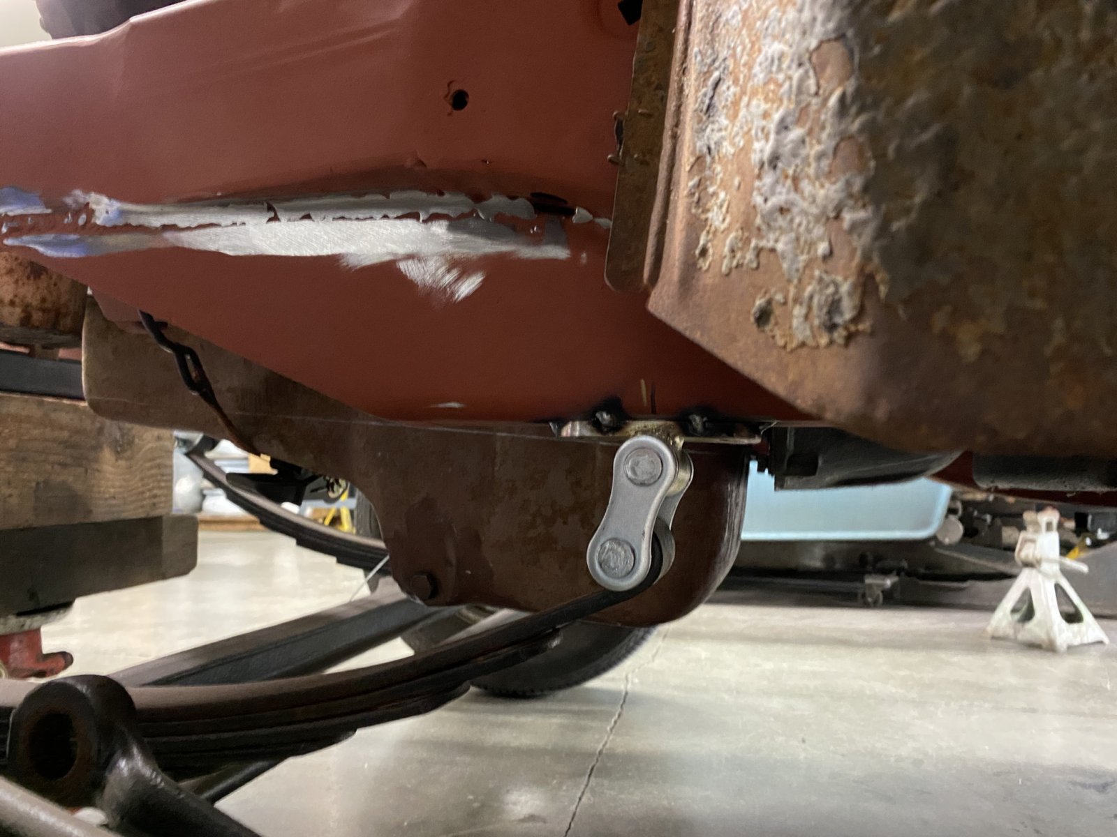

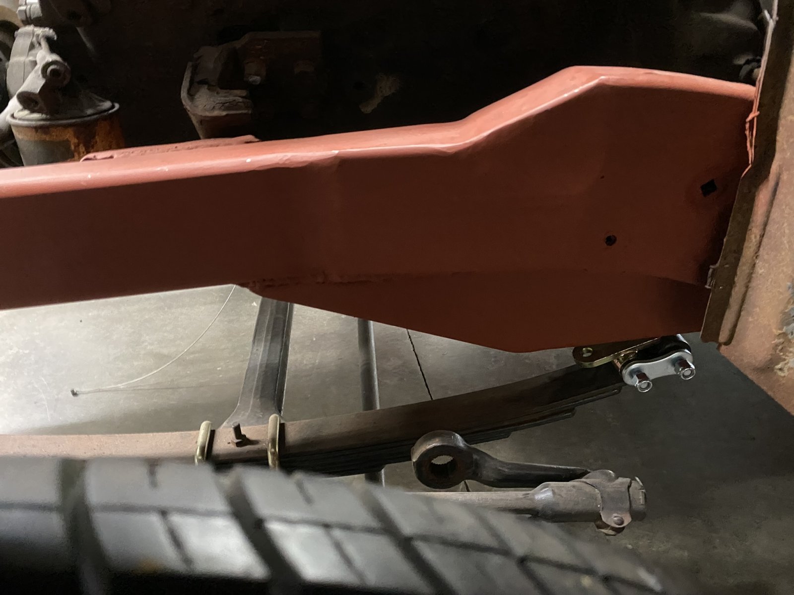

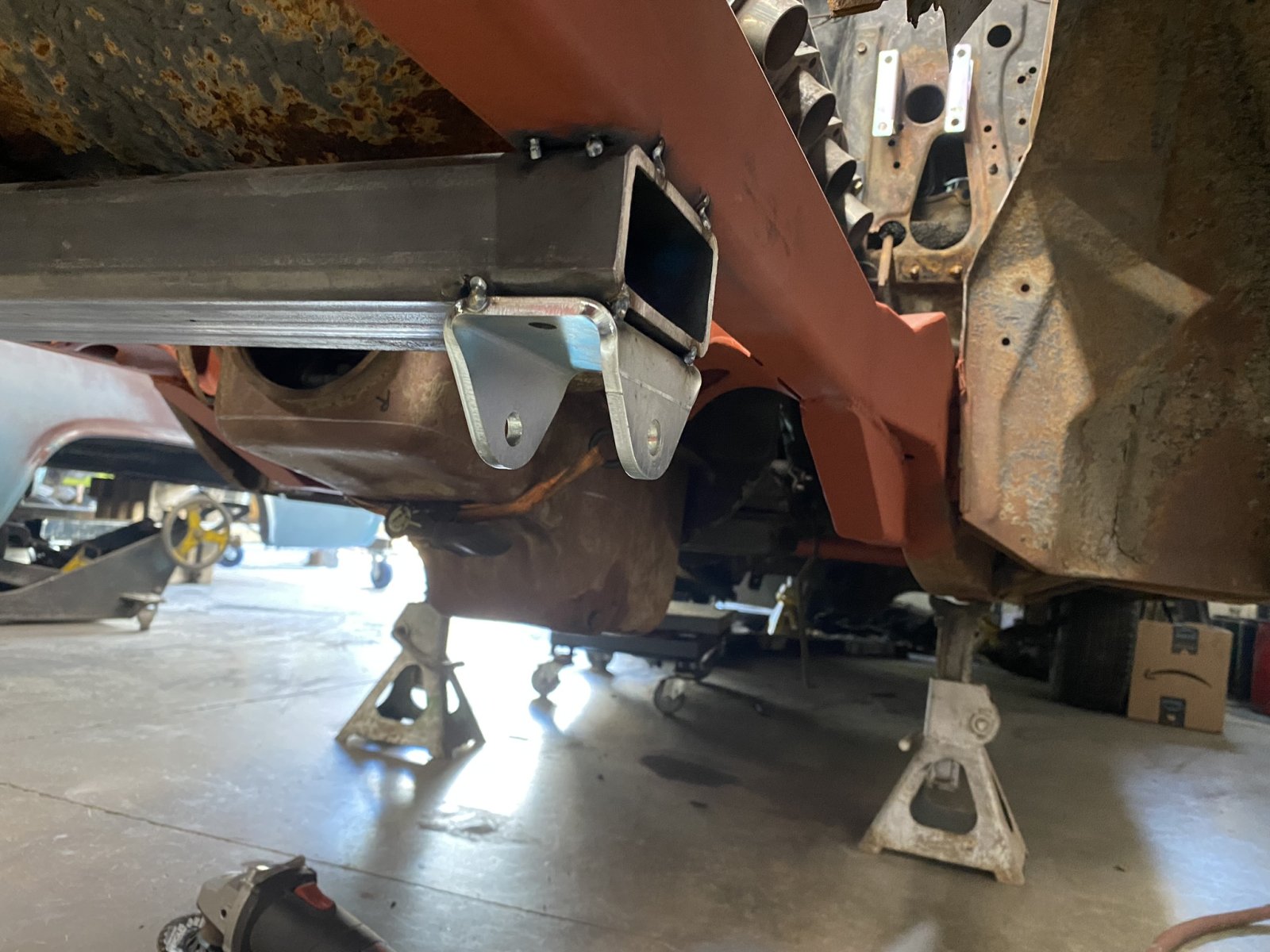

    I have been working but this is a little catch up on efforts on the frame. I have struck out the first two times on shackle placement but found a YouTubevideo that will hopefully get it right on the third try. I may have to lower the front mounts to get the angle right as well as help with the stance. Not cartoonish but also not level. Also threw on the header flanges and excited about how the BBC fenderwell headers will look once they get cut up! I have already started addressing the bad welds and still need to add fish plates over the joints between new and old. IMG_9095.JPEG IMG_9096.JPEG IMG_9097.JPEG IMG_9098.JPEG IMG_9099.JPEG IMG_9100.JPEG IMG_9101.JPEG IMG_9104.JPEG IMG_9105.JPEG IMG_9107.JPEG IMG_9108.JPEG IMG_9109.JPEG IMG_9110.JPEG IMG_9111.JPEG IMG_9213.JPEG IMG_9214.JPEG

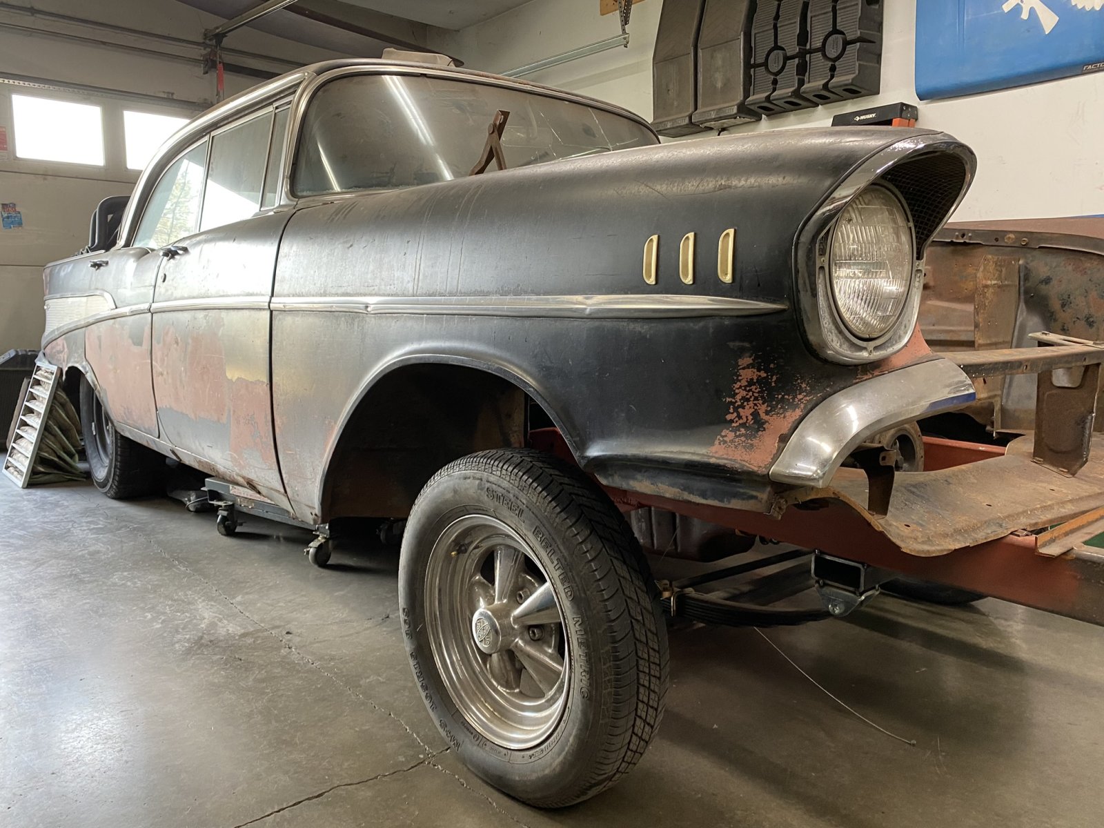

    In bigger news, I moved her to my house! My hope is that with closer proximity it will pick up the pace some. This should make my buddy happy to get some shop space back. Wifey maybe less so but will be added fuel to get it done as quick as possible. We did get the old windshield out only to find that the glass I have been storing to replace it is back glass and not a windshield. No one in Portland has one so will have to wait for a group order to get one and of course there is now rain in the future. I need to put the hood on but it has two broken bolts so those need to be extracted first. Thirdly a new drivers door handle needs to go on to help with the getting work done as it cant just be left open. Hoping to get something done over Father's day weekend but time will tell. IMG_9599.JPEG IMG_9602.JPEG IMG_9603.JPEG IMG_9605.JPEG IMG_9608.JPEG IMG_9611.JPEG IMG_9612.JPEG

    Also on the suspension front: I have brand new rear springs so those will go under before the front is finalized to bring the ass end up before setting front heights.
  28. Auto City Classic out of Minnesota has glass for good prices. Just bought a windshield for my 57, 310 shipped to my door nicely packaged.

    You can also buy tapered shims to adjust kingpin angle if it's not exactly where you want it, and you don't want to change ride height to get there. Glad to see it is home now!
    Did you ask at Cliff's Classic Chevy out past Rockwood south of Stark to see if he might have a decent used windshield?

    Cliff has me in line with one other guy to get group shipping. He wants at least one more. Looks like a tarp is in my future....
