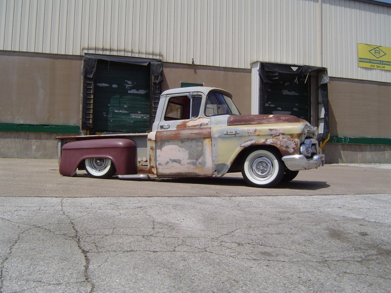

    Found this picture online, and Im in love with the stance! Im gonna shoot for this stance when I lower it.

    I dont have a lot of free time to work on this thing because of school and work, but I finally got that new fender on! The grill fit kind of tight, and it has a small gap on the new fender, and it fits flush on the other side. Is there a difference between 55/56 front fenders and 57 fenders? Or could everything just be a little tweaked because its all old and stuff?

    I vote tweakage but what the hell do I know. Looking good Taylor, tell your Dad I said Hi.
    Mark
  19. 1959apache
    Joined: Nov 22, 2009
    Posts: 2,635
    1959apache
    Trucks were expendable work vehicles and they were allowed some slop. Keep in mind fenders that have been off of a vehicle for a while, especially NOS parts that have never been put on a vehicle start to lose their shape as time p***es, just by a little bit. My NOS fender from 1940 for my '40 Plymouth is out of shape, but with a little help from a buddy I will be able to get it to fit. I suggest you get a friend to help you tweak it to where it needs to be.

    yes, there is a slight difference. i was told this back when i had my 57....
    and this ad from brothers confirms it... hope this helps..
    http://www.brotherstrucks.com/products.asp?dept=355
  22. BZNSRAT
    Joined: May 30, 2007
    Posts: 709
    BZNSRAT
    There are slight differences but you can't really tell. Basically the same shape and size. I run a 57 on my p*** side.
  23. 1959apache
    Posts: 2,635
    1959apache
    No! Don't do that. Post some pictures of where it is tight. Usually two or more people and a couple flat head screw drivers can get it into position while someone else bolts it down.
  24. TaylorCrawford
    Joined: Jul 28, 2009
    Posts: 792
    TaylorCrawford
    Its all bolted down and tight, theres just a slight gap between the grill and fender.
  25. 1959apache
    Posts: 2,635
    1959apache
    Are you sure that the rest of the front clip didn't shift when you removed that fender? It is possible especially with as much spring force as there is there with the hood springs. I have had that happen to me a couple times. Best way to find out is to loosen the bolts on the drivers side fender open the hood all the way and give her a shove from the p***enger side. Naturally it will want to hop back to the p***enger side, but that is where a couple buddies come in.
