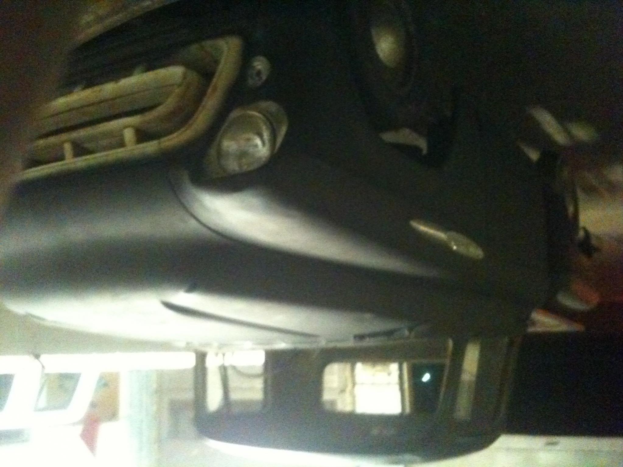

    Finally got my black widow painted over the weekend, still needs a little body work but other than that, it looks pretty sharp to me! I don't know how to post pics tho

    Wait let me try this rite quick
  8. ... and you shipped it to Australia :D?

    Down under ehh, nice! I'm trying to get it ready for a benefit car show my shop is hosting next month. Wether or not it's ready, I'm showing it. Just hope I can get it running smoothly for the cruise. What I'm needing most is a wire harness tho when I got my truck, every single wire was shot.

    Looks pretty good even when its upside down!

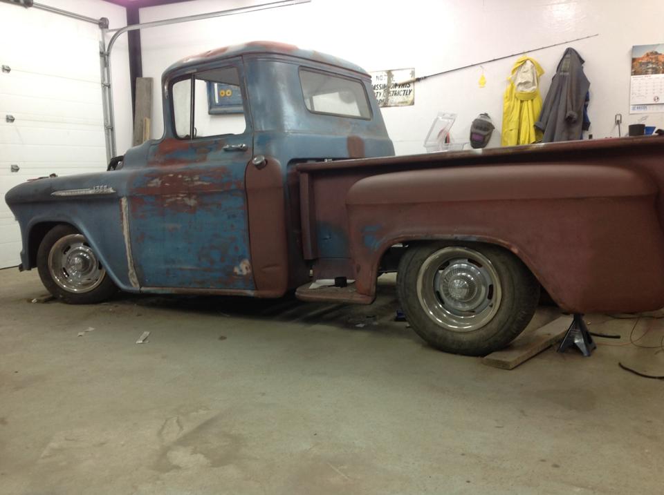

    Alright, so Im about to make some progress on this thing, and then I hit a major road block and everything comes to a screeching stop...
    Right now Im running 15x6 wheel with 0 offset, and I believe its 3.5" of backspacing. I cant go any lower or else I'll scrape the rear fenders. I called the Wheelsmith (and I was a little less then stoked on the way the treated me over the phone, but whatever.) And they said they cant make the wheels with the backspacing I need to be able to clear my fenders. I need to bring my wheels/tires 1.5" closer to the bed of the truck.
    So what do I do now? Run a different wheel and tire? Narrow the axle?
    Anyone who's tucking there tires, what size wheel and tire are you running?

    i ended up swapping my rear end to one from a Chevelle that is 2" narrower to be able to run that same back space with the 15" Corvette rally wheels. The cheapest way would be to get different rims, I would think

    A BFG 255/70R15 tire will fit, but it needs to be centered perfectly. Right now I have 1.2" clearance to the side of the bed and .8" clearance to the fender.
    Your question really can't be answered correctly until you give us the axle measurement from outside face of the left drum to outside face of the right drum. Go get that measurement and post it here...

    Are you looking to tuck more than this?

    here is mine with 255 60 R 15's on thew back with 3 1/2" back space and 215 60 R 15's up front

    If it helps, my rear axle is a full posi 10 bolt out of an '83 Caprice, wheels are 15x8 with 4.25 backspace.
