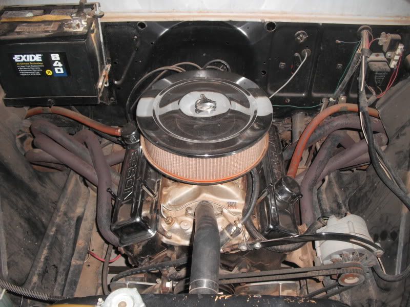

    Its definetly a project, but she runs like champ! Well actual more like a tractor. The previous owner said it tops out at about 65 on the freeway. So far Im working on getting the interior done and getting all the gauges working. There is VERY little rust, because shes been in Tucson since she was new. Desert truck! This is gonna be fun!

    I can drive it! I think Im gonna put an automatic transmission in it though. The one in it now is pretty beat up. I already have the trans, flex plate, drive shaft, and tourque converter...

    Okay...so I think the first major step is gonna be to take out the 4 speed and put an automatic trans in it. I have a Turbo 350 trans, the flexplate, a torque converter, and a drive shaft out of an El Camino. Do I need anything else? Is there any major modification that needs to be done? Or does it pretty much just fit in? Im worried it wont fit with the cross member, firewall, etc. Has anyone done this before?

    I wish my truck looked like this... (in 1 piece)
    And to answer your question I had to take my crossmember out for my 700-r4 and had to put a tubular crossmember in... (painless really) and I was good to go. I actually had to lower my engine mounts by using a tubular cross member as well just so I would have the proper angle for the engine. Make sure the linkage kit will be compatible. I got one off of ebay that was pretty slick. Very easy to use. If you want me to find you where I got it off of there I can do that. Let me know
    To be honest if it were my truck I'd keep the 4 speed. It is too cool not to.

    Eh the 4 speed is in pretty bad shape. The automatic 350 is in good shape, so it makes sense.

    My truck had a 350/350 in it when I got it. But the cross member was very close to it. the only way to drop the pan on the ****** to service it, would be to pull the whole ****** out, as I couldnt get to the front bolts, and it didnt have a converter dust cover. When putting my ch***is back together, I got also got a tubular ****** cross member and took the original one out. It was really easy, drill a couple holes, and bolt it in. Harder to get the original crossmember out in one peice (not neccisary, but I wanted to keep it intact)
    And those are some pretty knarly looking headers, more pictors please.

    They sound gnarly too! I'll take some more pics and maybe a video if I can get this stupid piece out from in between the door....:mad:
