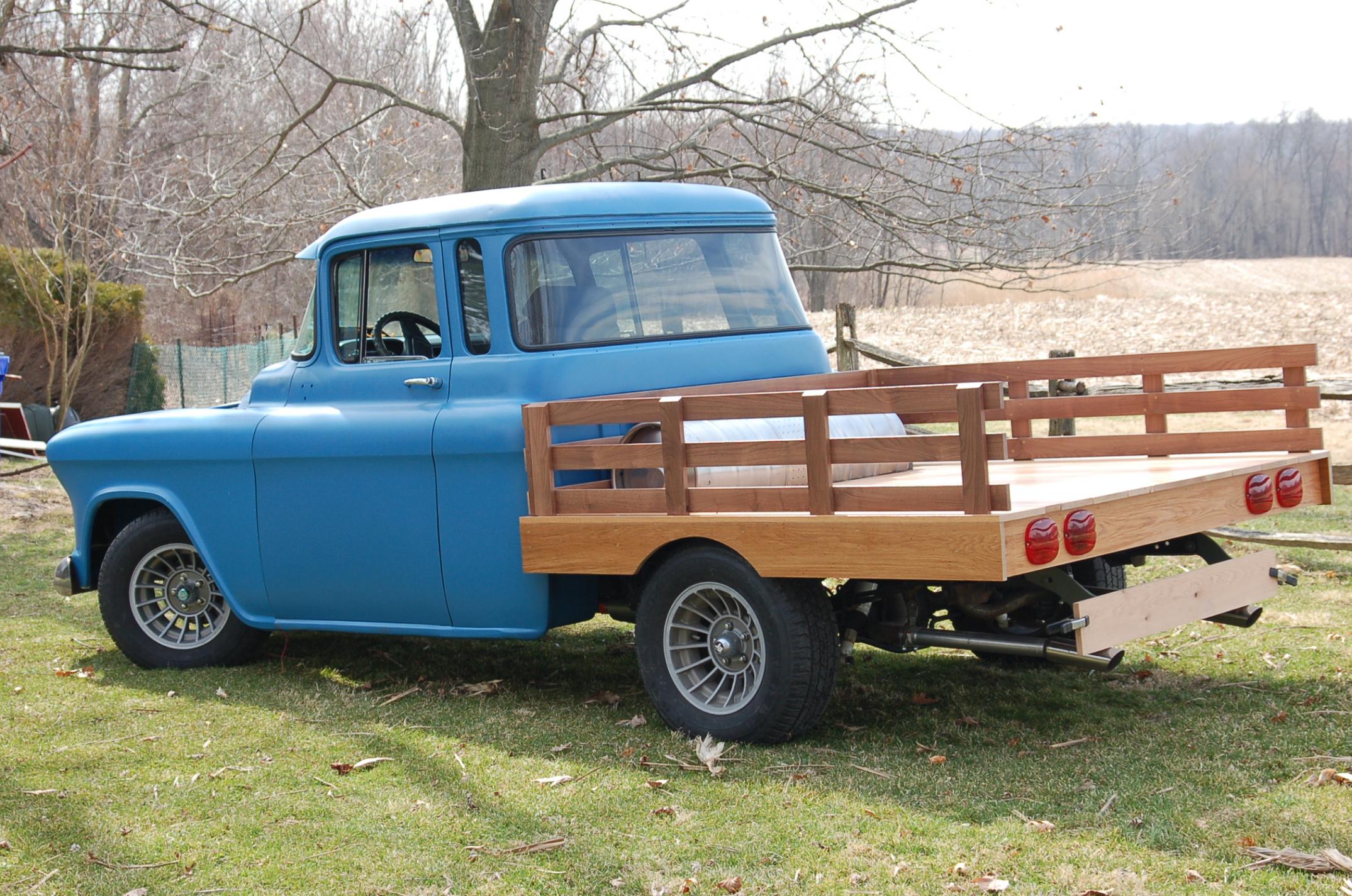

    Joined: Dec 15, 2006
    Posts: 971
    RB35
    Just tripped across this thread again and (not trying to jack it) wanted to post an update. Paint is the DP blue epoxy, Oak and black walnut on the bed, still looking for a '57 hood, but road worthy now. We're working on a half hexagon "doghouse" to go over the top on the kegs that will match the bed pattern with the boards running vertical rather than horizontal.
    Glad to see your progress.
    RB
