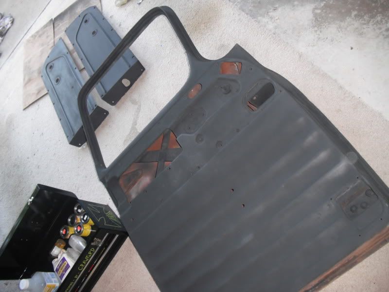

    This weekends progress....
    I pulled off one of the doors, and took the gl*** and chrome t******* off. I sanded and primared the door, door panels, the hinges, and some other random parts. I also went over to my grandpas and got some of his old tools, and found a fake Mooneyes pedal. Id say it was a good weekend!

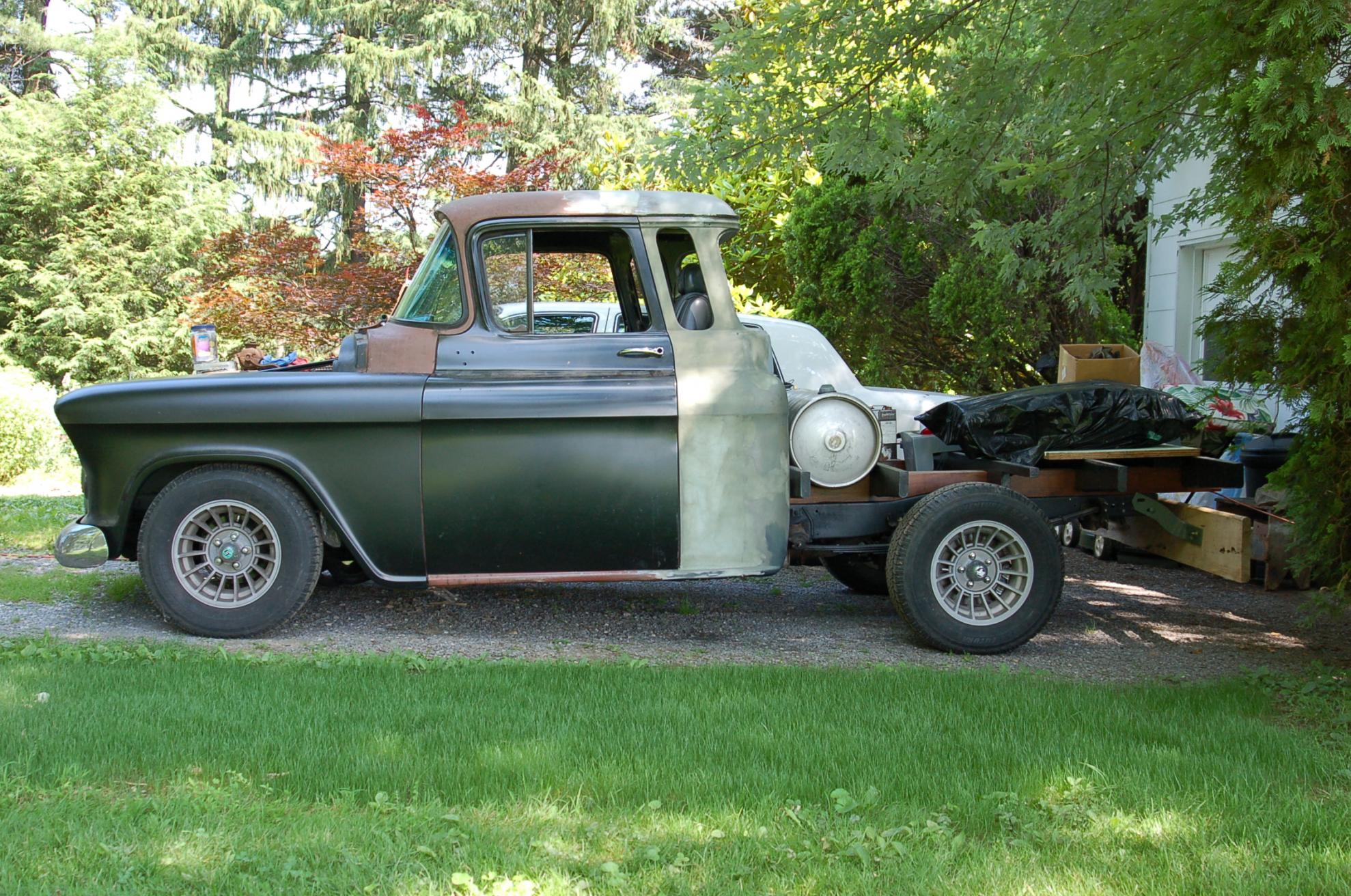

    I'm on the other coast, so can't offer too much help. My 75 yr old playmate has been working on his '57 for over a year, mainly due to income restrictions. It's got a 350/overdrive auto, a Volare front end and 3.59 Firebird rear, so discs all around. The difference is the cab extension, using a big window cab from the jambs back, replacement doors and then cutting down the original doors to fill the gap. He had a third set of doors that he got with the cab back and cut and flipped the rear window trim to finish off the opera window. The rear cab roof was cut for a sunroof, so he finally got the rear half of anouther roof which is glued on. He now has about 20 add'l inches behind the seats for storage. Just a couple of pics to give you ideas. Hood is off while we find a replacement and the visor will go back on.

    Nice! Its lookin good! I like the cab extension.
