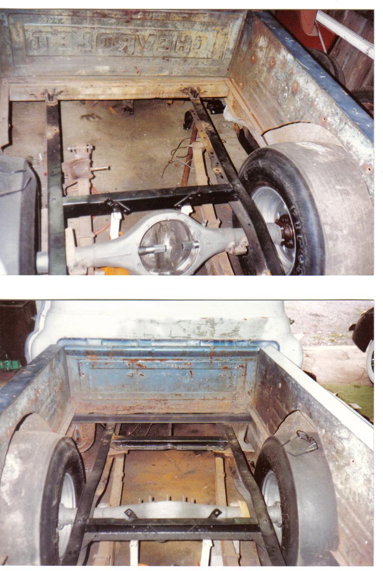

  17. swade41
    Joined: Apr 6, 2004
    Posts: 14,632
    swade41
    from Buffalo,NY
    A couple photos for reference, stock, then with the stock axle fliped on stock springs and finally stock springs switched to inside of the frame rails with a narrowed 9 in.
    As you can see you'll only have a couple inches when placing the axle on top of the springs, you live with it or "C" notch the frame.
  18. Antny
    Joined: Aug 19, 2009
    Posts: 1,071
    Antny
    from Noo Yawk
    With the axle atop the leaf springs, you should end up with about 2.5 to 3 inches of clearance to the frame rails, with no weight in the bed. I think you'll be good to go, unless you plan on hauling a heavy load.

    Suddenly Im not all too sure about this camero rear end haha!
  20. swade41
    Joined: Apr 6, 2004
    Posts: 14,632
    swade41
    from Buffalo,NY
    it bolts right in (2nd gen), go for it, you'll love the difference
  21. TaylorCrawford
    Joined: Jul 28, 2009
    Posts: 792
    TaylorCrawford
    Im just worried about the frame and tire clearence....
