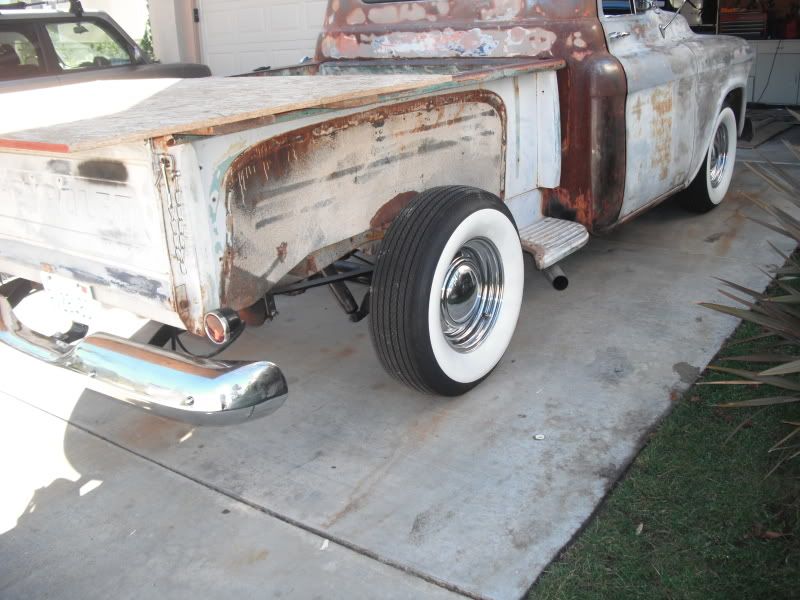

    This is how she sits as of a few minutes ago. Ive been kind of tight on money so all I have been doing is sanding and bondo, haha. You can see the new fenders in the bed that will be going on soon. Just gotta sand em down. Gotta get rid of the old ones too. Anyone wanna buy some orignal fenders? :D
    Note all the bare metal...
    Still driving the piss out of her!

    Im thinking I wanna put 2" drop shackles in the back. Whos done this? More info please! :D

    taylor, i have used a set 2" drop shackles when i first lowered my 57. used them in conjunction with pulling 4 of the 7 leafs. (now my rear is flipped).
    the shackles are a very easy swap. here is where i got mine from.
    good luck...
    http://www.brotherstrucks.com/prodinfo.asp?number=RES5559

    Okay thanks. Im running 4" drop mono leafs, Ive heard I may have to C-notch my frame if I go any lower. Is this true?
  18. terd ferguson
    Joined: Jun 13, 2008
    Posts: 3,734
    terd ferguson
    I'm running 4" drop monoleaves along with 2" drop shackles and new shocks. I have about an inch of travel. I don't hit the frame unless I'm hauling something heavy, like an engine.

    taylor,
    right now all i am running is the flipped rear and original shackles. this gives me right at 1" of clearance. with the newer shocks i have, it dont bottom out unless its a big dip in the road.
    when i flipped the rear and put all the leafs back in, it was right on the frame, thats why i put the original shackles back in. that gave me the 1" clearance i now have of travel.
    too bad i already got rid of my dropped shackles, i could have sent them to you.

    Right now Im running the mono leafs with the axel mounted under, so I should be fine right?

    i think TERD is running that setup, so you should be real fine.
    i dont have nay experience with mono's....
    you got a cool truck, .... get it down man. LOL.

    Rad! Gonna be a real *** dragger now! I think Im gonna add another leaf up front, I pulled 3 and I smack the axel on the frame a lot. Not fun...

    yea, i got 3 pulled from the front also. i put a strip of old rubber boat trailer mud flap onto the frame, so at least it aint metal to metal contact....

    Hmm..is it really that bad to be slapping the axel? I may just do that.

    dont think it will really hurt anything, but it sounds a lot better with the 3/16" thick rubber in there...
