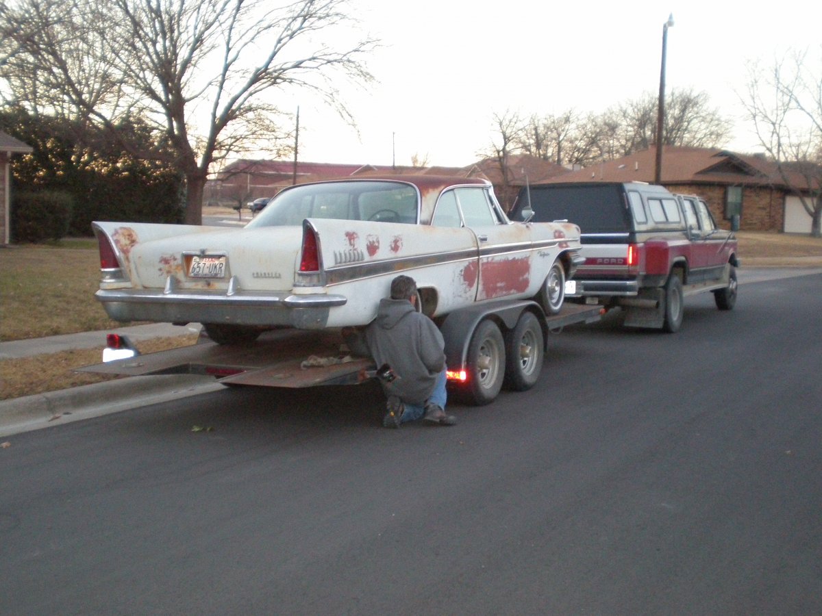

    So I kept looking. I had want ads, and ebay and craigslist searches all over the place. But one day I did a search on my local craigslist for '1957' and it turned up an ad for a 1957 chyrsler (sic). It didn't have any pictures, but it did say it was a 2dr. I drove out there that day to check it out. Here's what I found.
