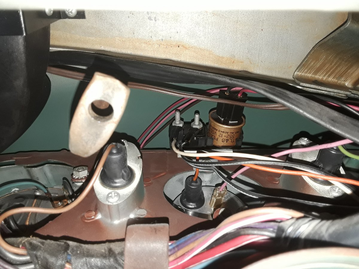

    Apparently I still don't have the right transmission pilot, so the drivetrain is still out of the car for now. We worked on a few other things this weekend instead. I pulled the dashboard out of the parts car and will work this week on cleaning the gauges and prepping it all for paint. As you can see, it's in amazing condition; it looks brand new. Door jambs are painted black. A little progress... but I sure would like to see that engine where it belongs. :rolleyes:

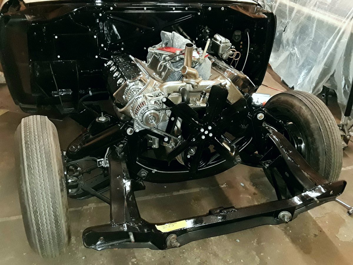

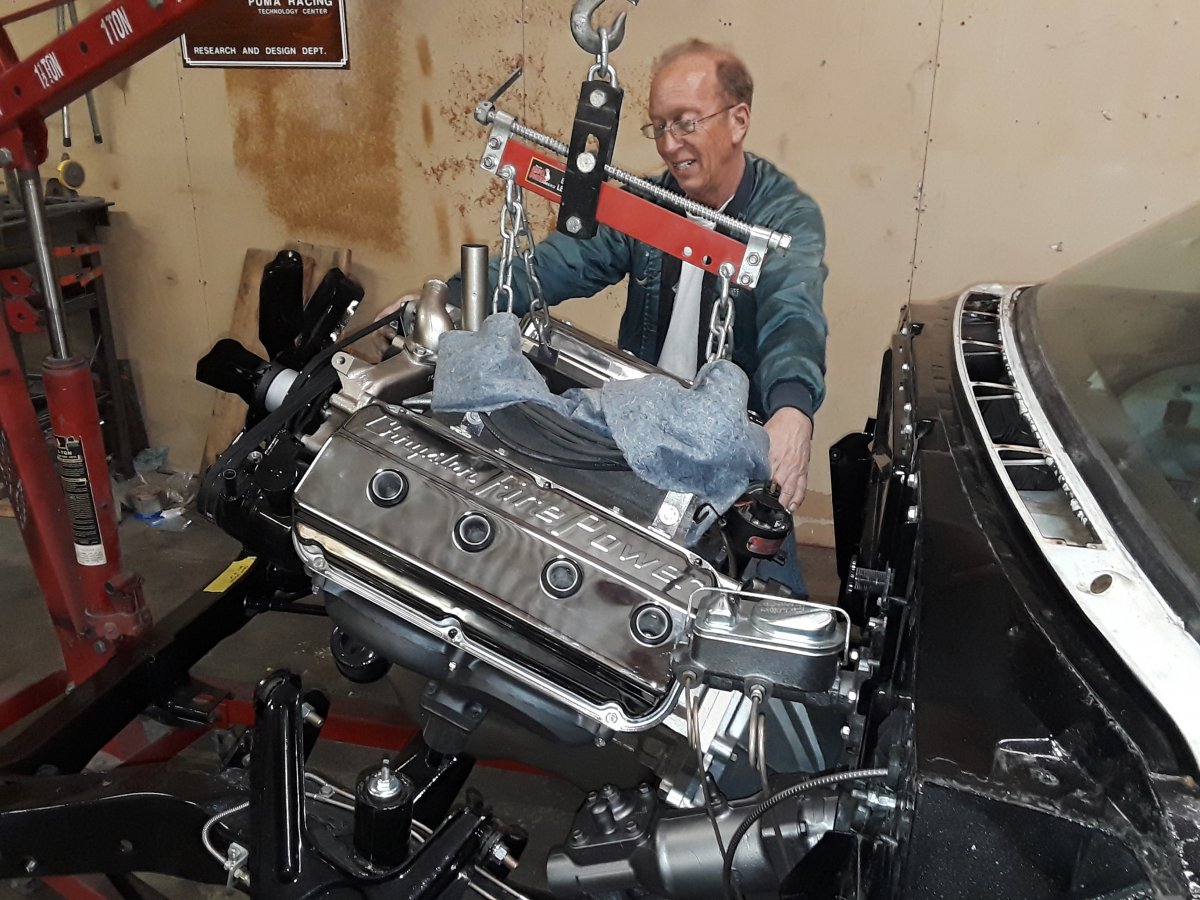

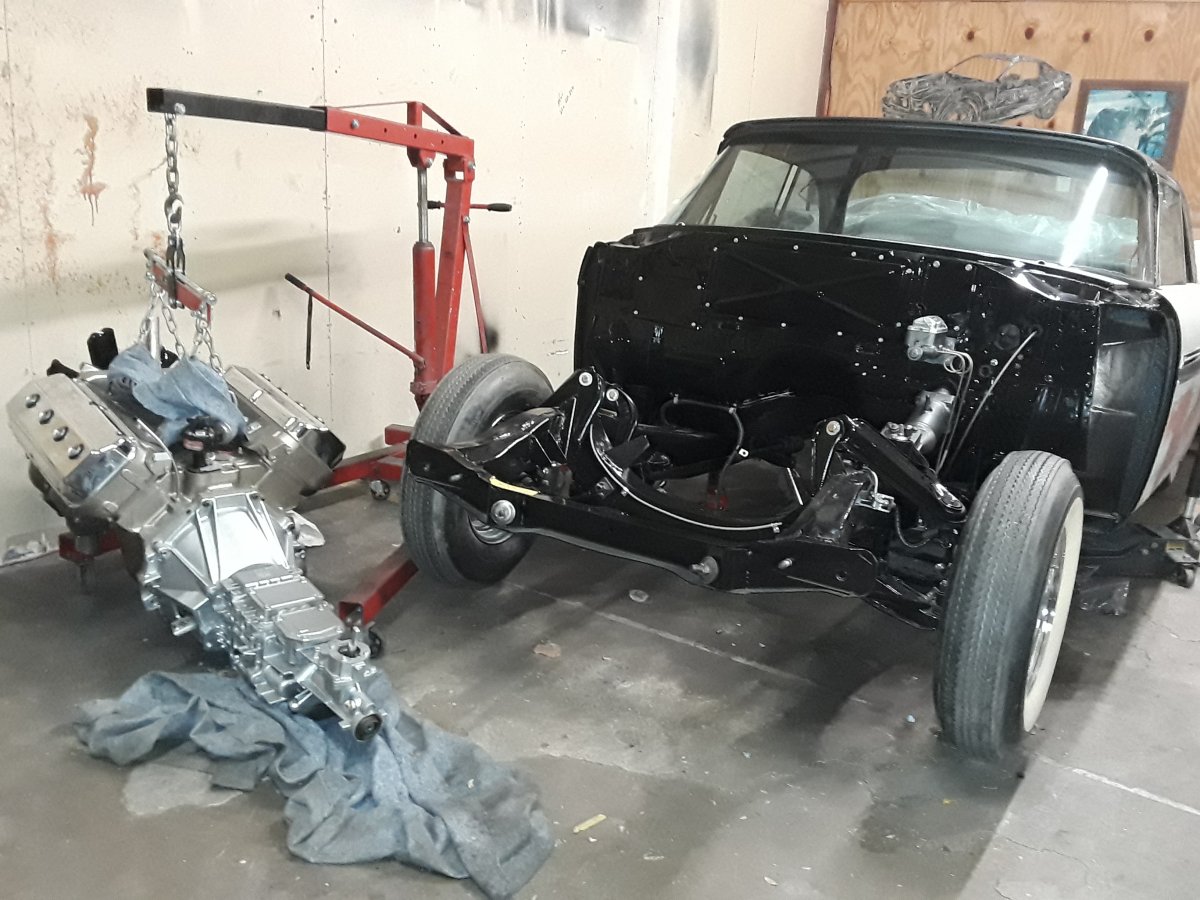

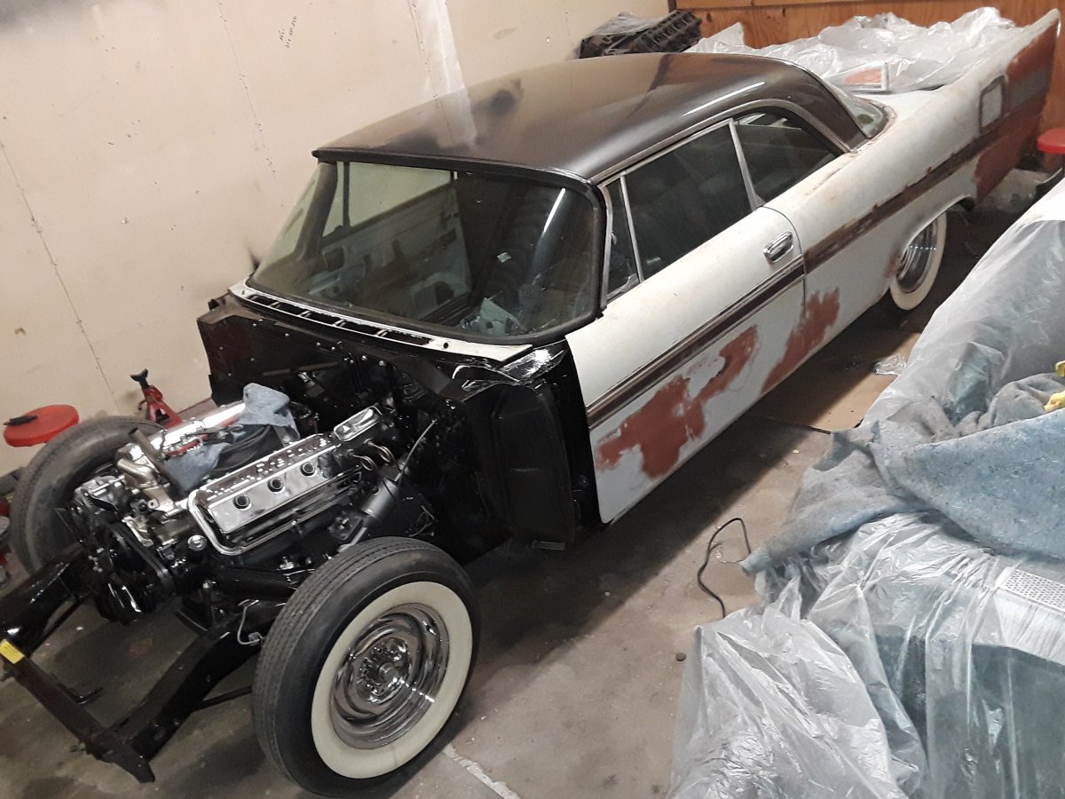

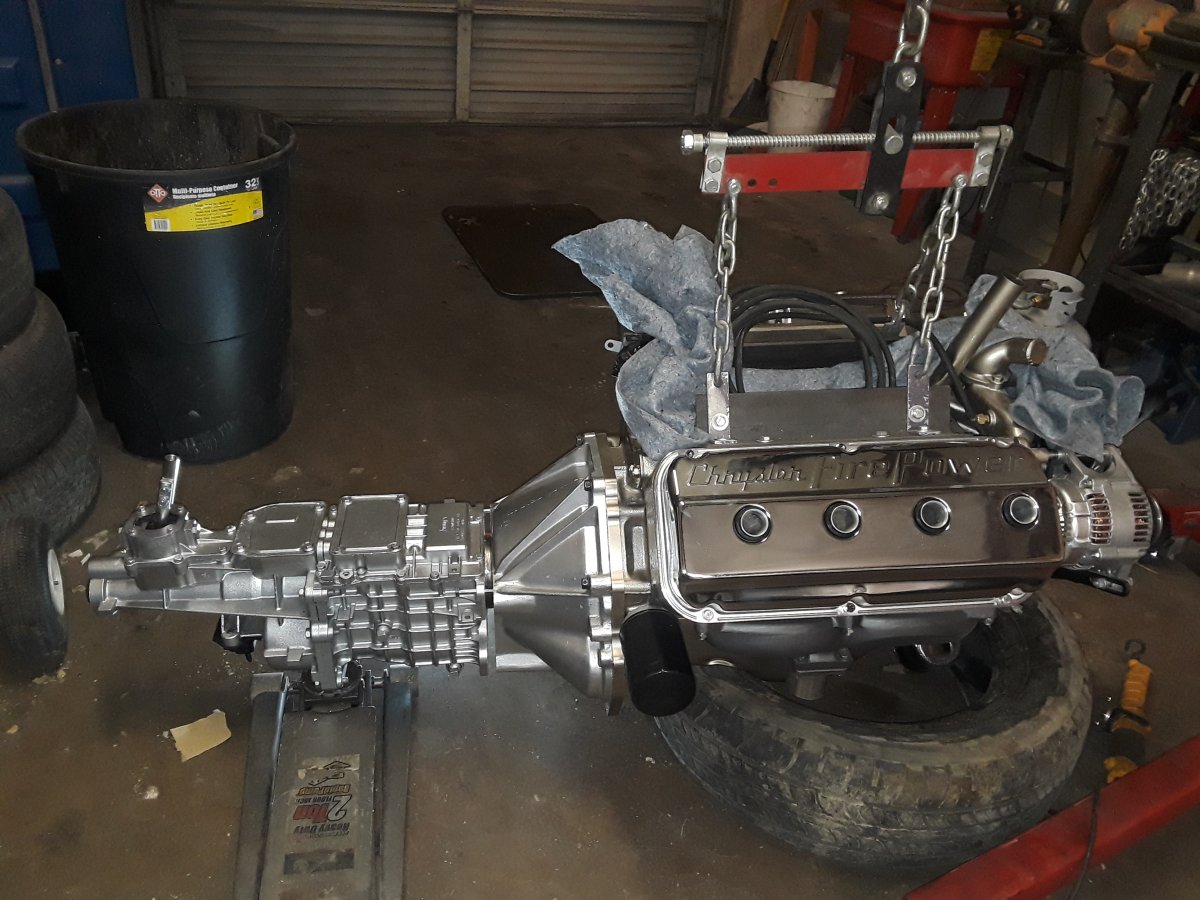

    Managed to get a lot done this weekend. Blasted and painted a ton of parts, like the air cleaner, hood hinges, sway bar, all kinds of stuff that needs to be done. Dad painted the steering wheel and it turned out great.
    After fighting the clutch pilot situation for weeks, we got it dialed in with this flywheel-mounted adapter. After getting the transmission bolted up, it was time to get the Hemi in the car. It lowered the front of the frame about eight inches! And I get to reclaim about 50 sf of shop space back.

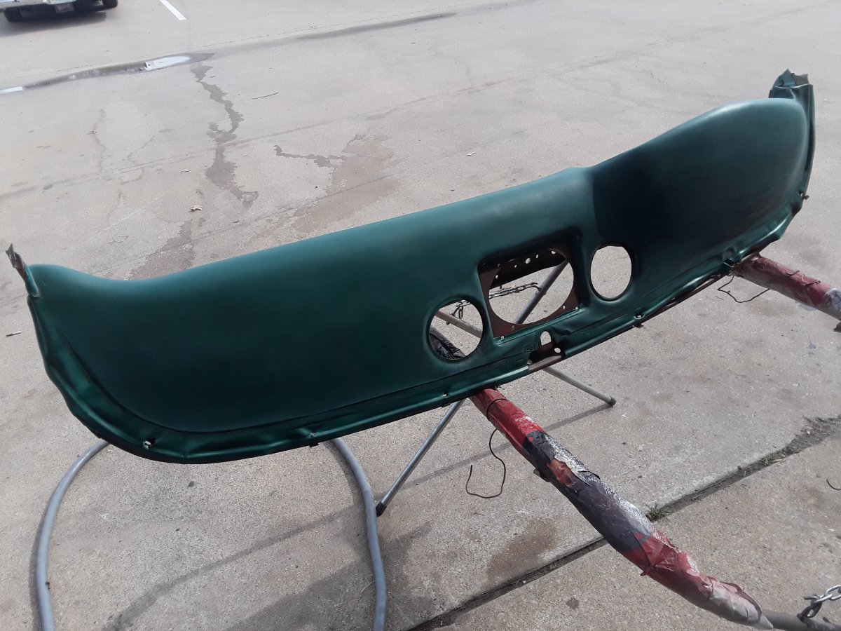

    We had a decent weekend of weather, so we blew apart the dashboard and cleaned it up. The padded dash has more lumps than I'd like, but no tears. Instead of buying a new one for $600+ we're going to dye it and run it this way for a while. Hopefully we can get it to look nice. The dash is the same gray as the roof, the pad will be black, and the gauge pods are gold. All the instruments and chrome are cleaning up nicely. I am using a 150mph speedo from a 300C, I wonder if anyone will even notice. :D
