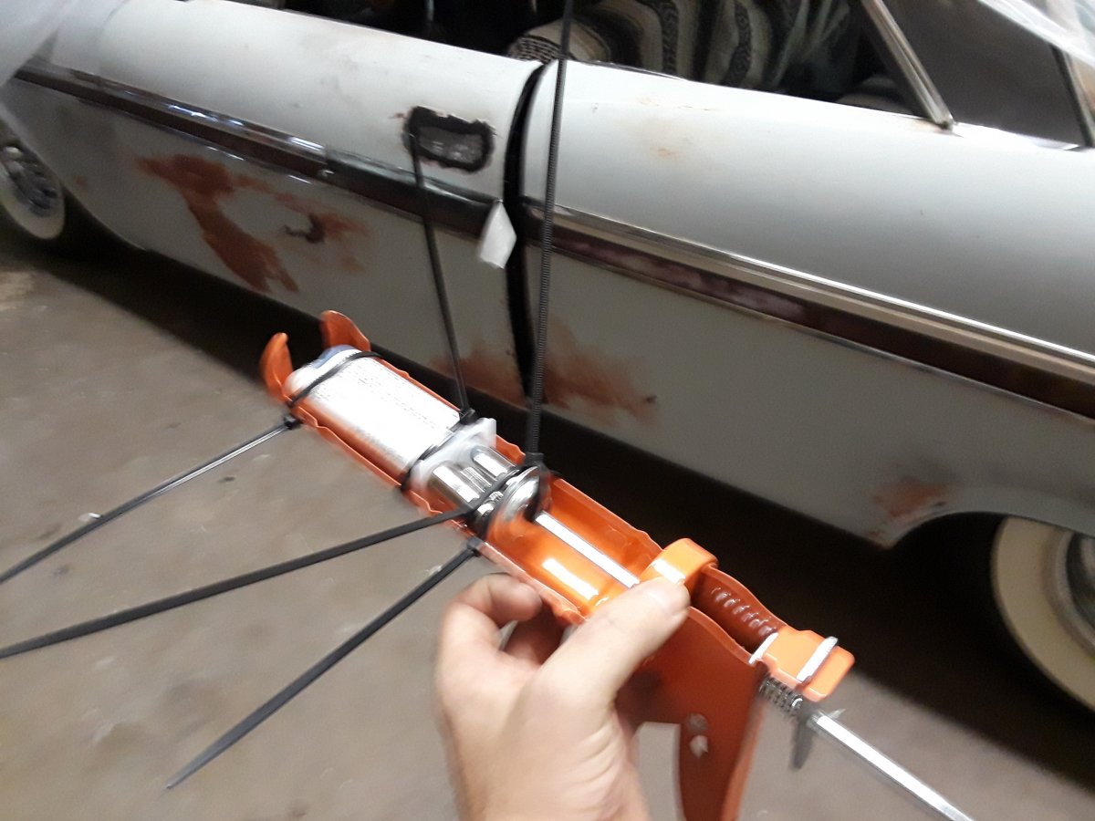

    Who says you need a $80 3M PanelBond gun? We made it work with an old caulk gun, a couple of sockets, and some zip ties. :D

    Did you glue the filler panel in ?
    chryslerfan55 and Gotgas like this.

    It was tacked into position and then PanelBond was used to fill in the remaining small gaps.

    Ummmmm ya might wanna grind that out of there and finish welding..any adhesive expands and contracts at different rates than the metal. It’s recommended for gluing flanges of body panels, not patch panels. It’s extremely strong, but when you open a tube of 3M 8115 up it shows the 1/4 panel
    Application and they show welding the sail panel cut for that very reason. Eventually a bond line may show up under your paint work.
    There was a very nice mild Kustom done Here years ago and the owner glued the headlight rings of his 54 ford on. I gave him a heads up...about 3 months later I saw the finished car...could see the bond line plain as day...he said....I know..I know..
    Great car btw, just wanted to give you a heads up

    Thanks for the heads up. I think we're gonna rock it. It's welded about 80% of the way around and this is just to fill the small gaps. It will have plenty of time to shrink, we won't be doing finish body work for a few months.
