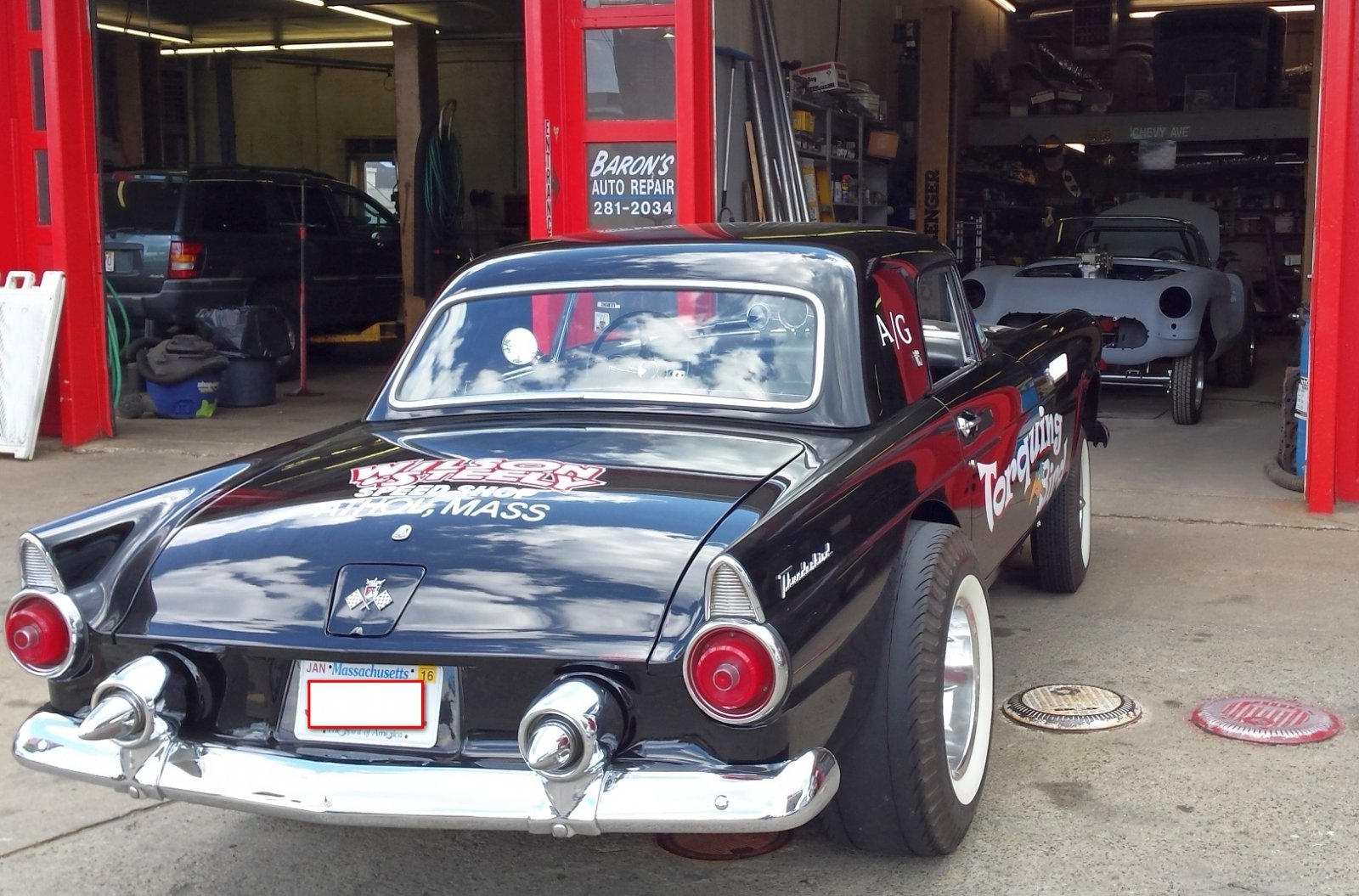

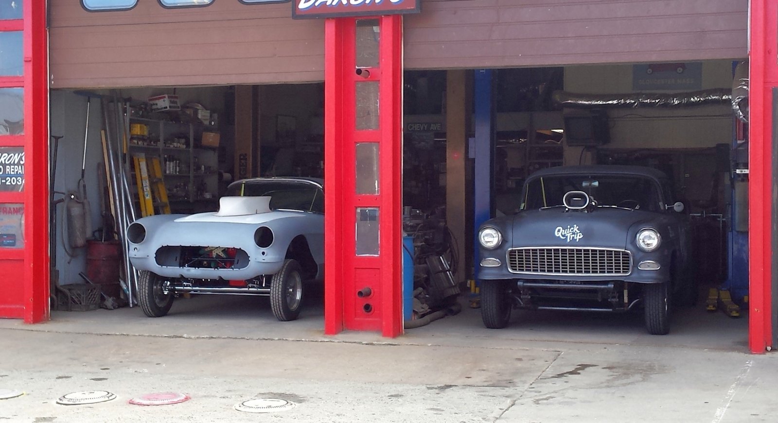

    First time I've driven the 55 Chevy this year and it needed a little maintenance. You can tell they have common DNA. ;)

    Now that is a pair to draw to!!!;):cool::D:)

    YEAH BABY.................................That's a stable full of race horses!

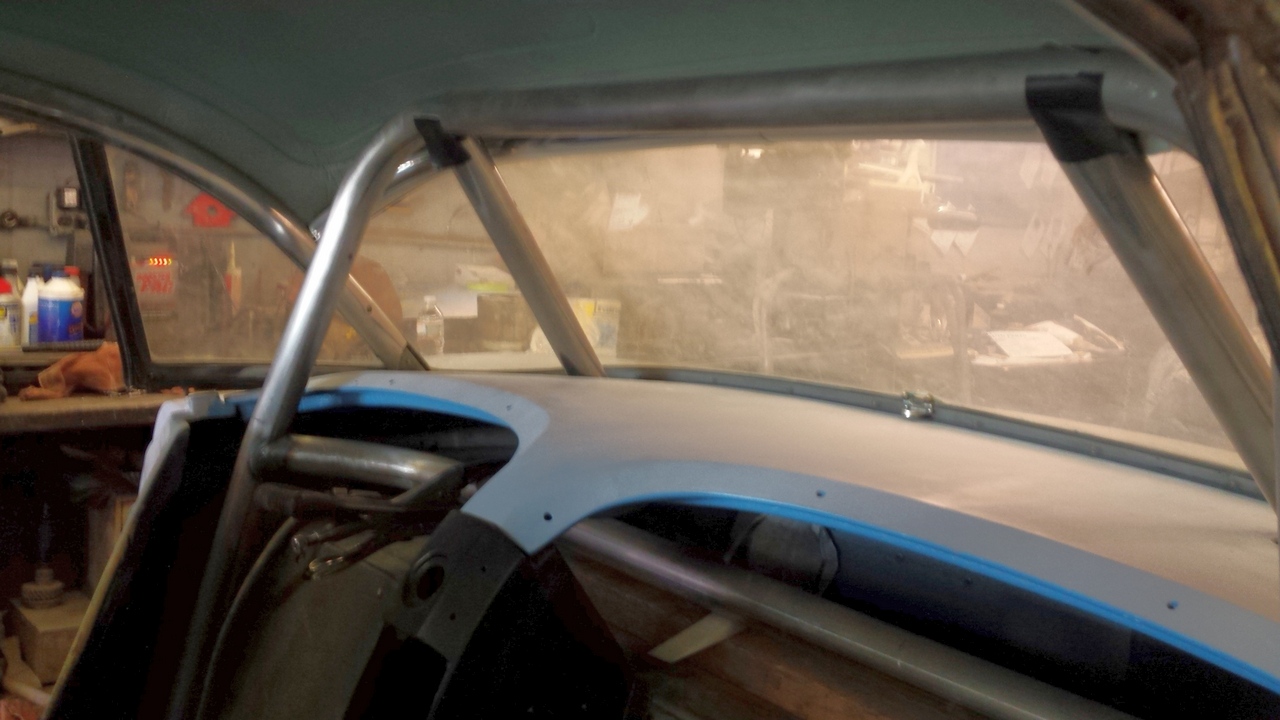

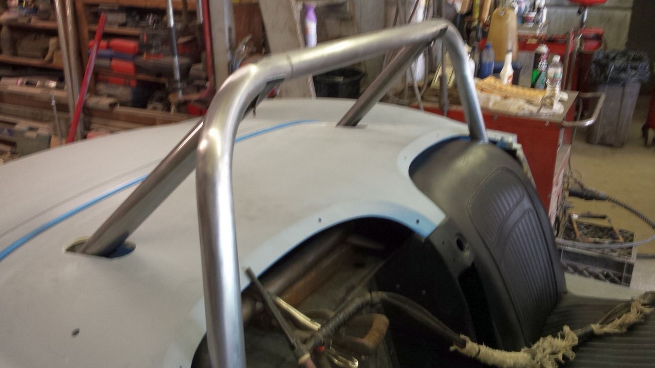

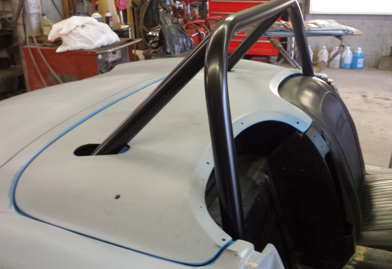

    Cut the holes in the rear lid today and doing the final fitting of the rear tubes for the roll bar. Tomorrow I will clearance the holes in the top lid, install the weather strip and bolt the panel in place for the final time before I weld the bars . Tight fit, but everything fits and there is still room for me Roll bar 5 15 15  b.jpg Roll bar 5 15 15  c.jpg Roll bar 5 15 15 a.jpg .

    Looks good Baron! I like the way the stock seat fits, the hardtop and I haven't seen you in it but I'll take your word:D

    Thanks Pat. The stock seats just make it. Today I got the roll bar half welded in . Painted the sections that will be hard to get at now that the lid is on for the final time. The elongated slots in the rear cover gives me a little leeway to lift the lid up should I have to get under there for anything. Making progress.

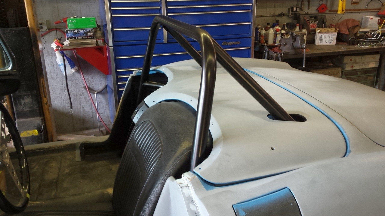

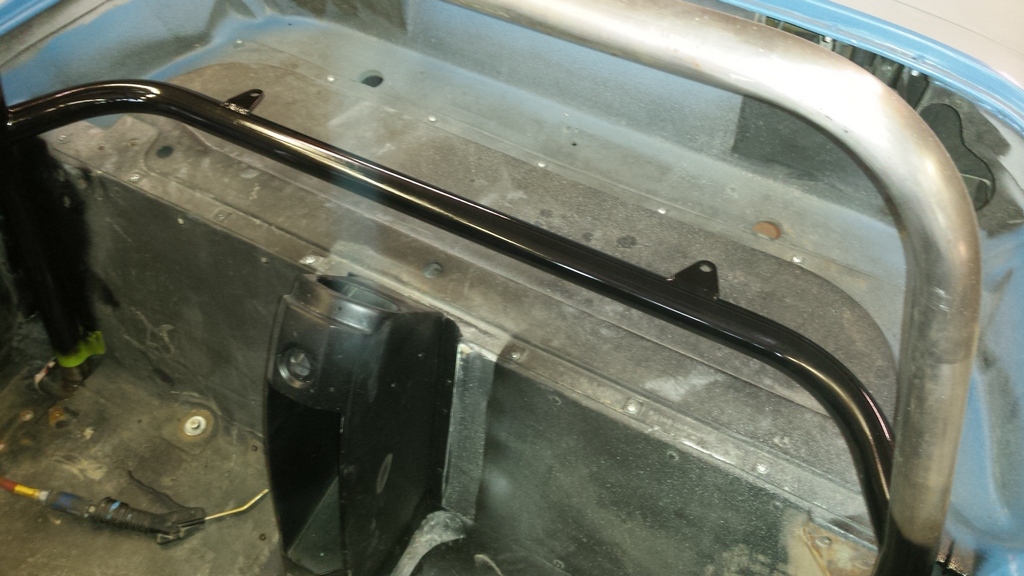

    I finally finished the roll bar today. Finished welding the down tubes to the ch***is, welded on the harness tabs, than prepped, primed and painted it.

    That is too cool! Love to see you & the 'Bird lined up side-by-side on the dragstrip one day.
    Baron the roll bar looks great. Are you gonna put side bars in or just the hoop & back braces?

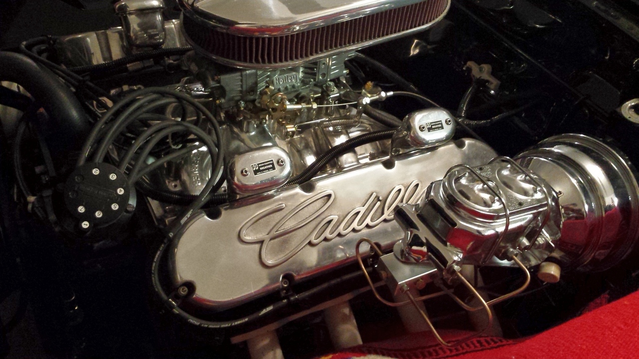

    What is the motivation in the bird, any more pic's
  17. Baron
    Joined: Aug 13, 2004
    Posts: 3,677
    Baron
    472 Caddy. Stock specs are 375 HP @4400 / 525 TQ @3000

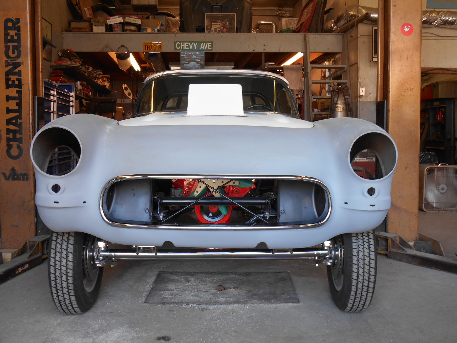

    It sure is. Saturday I bolted the grille surround in and not that it is any big deal, but who ever cut the grille opening in the nose had it too low by 3/8 of an inch. So needless to say, the surround is back out, and I will re-cut the top and probably have to gl*** up a few spots on the lower side to get it mounted where it belongs. All minor details in the grand scheme of things.

    I installed the grill surround today. The contour of the grill opening was a terrible match on the left side of the body, leaving a 3/8 gap with the grill bolted in place. Little gl*** work , bondo and it fits pretty good now.
    I just had this scoop made. As much as I like the other scoop, it is almost 6 inches wider than this one, and it really blocks your vision. I'll leave this on the car for a few weeks and see if it grows on me. Proportion wise, it does fit the car better. 57 Corvette 5 29 15 c.JPG 57 Corvette 5 29 15 e.JPG

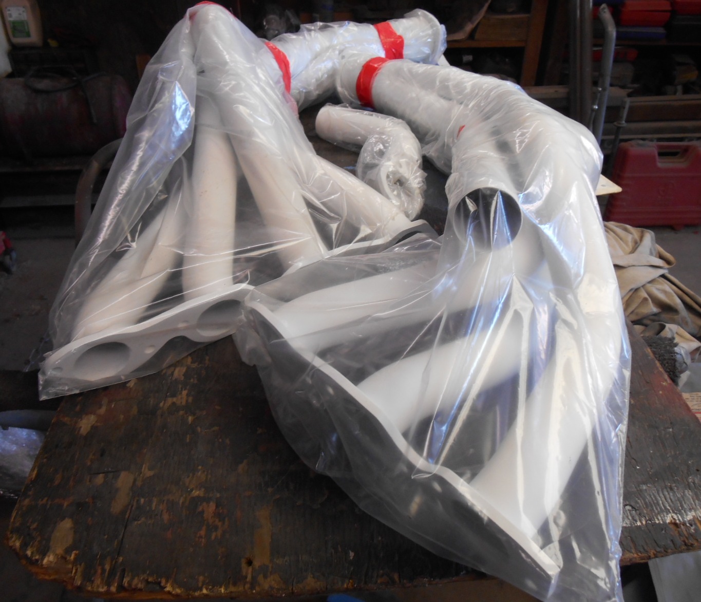

    Saturday's job will be to remove the steering shaft and column, paint the shaft and get the column ready for paint. And while the paint is drying, it should be a good time to install the headers. Just got them back from Central Connecticut Coatings this week and they did a great job. First they do them inside and out in silver, than they do the outside in white. Tubular Automotive headers 1.JPG Tubular Automotive headers 2.JPG

    Looking good Baron. In the early 70's I made a set of headers for my 36 Willys PU and had them, what they called ceramic coating by a place on LI or Brooklyn I don't exactly recall. They looked very much like yours, mine where white and rough like sand paint after running for awhile they took on a silvery white tone. It was bullet proof but did stain I think the roughness held the dirt and oil. But this was before Jet Hot and other coatings. I liked it a lot. Yours look very good also.

    I always used VHT paint in the old days. Six or seven years ago when I had the headers coated for my 55 Chevy, the place I had them done said they would not do them in white as it would not stand up to the temperature, so I did them in silver. Unfortunately the silver did not stand up very well either. This company has had good like with the white. Time will tell.
    It is. Because the low hood clearance , and the carburetors sit so high, the scoop had to be widened two inches to clear the linkage.
