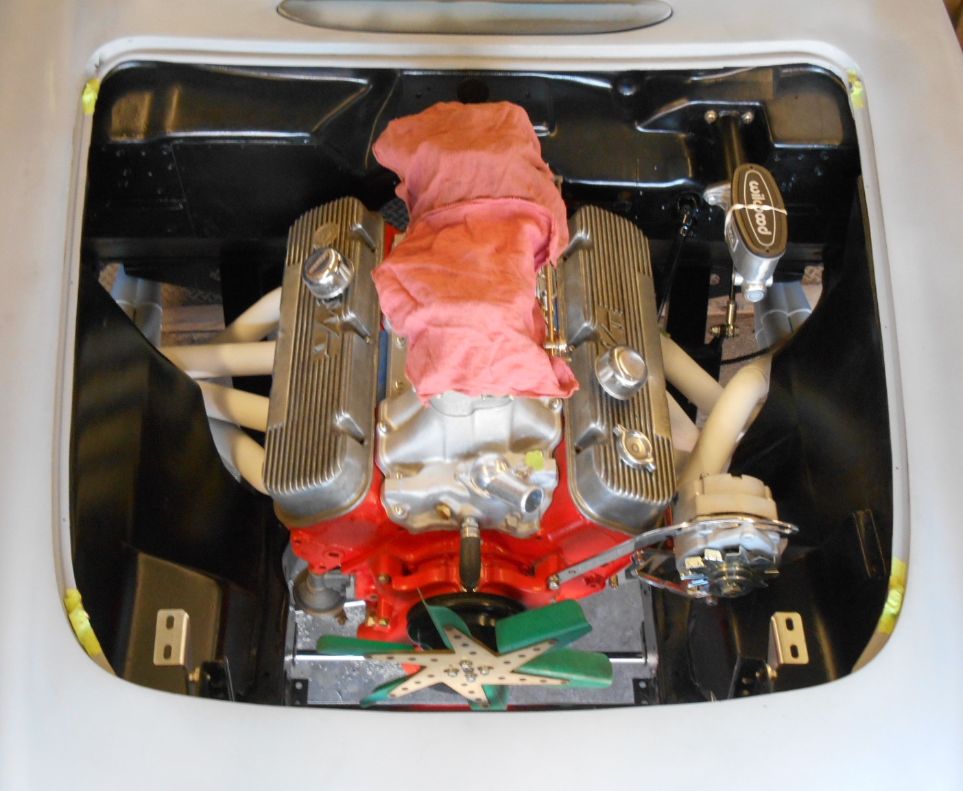

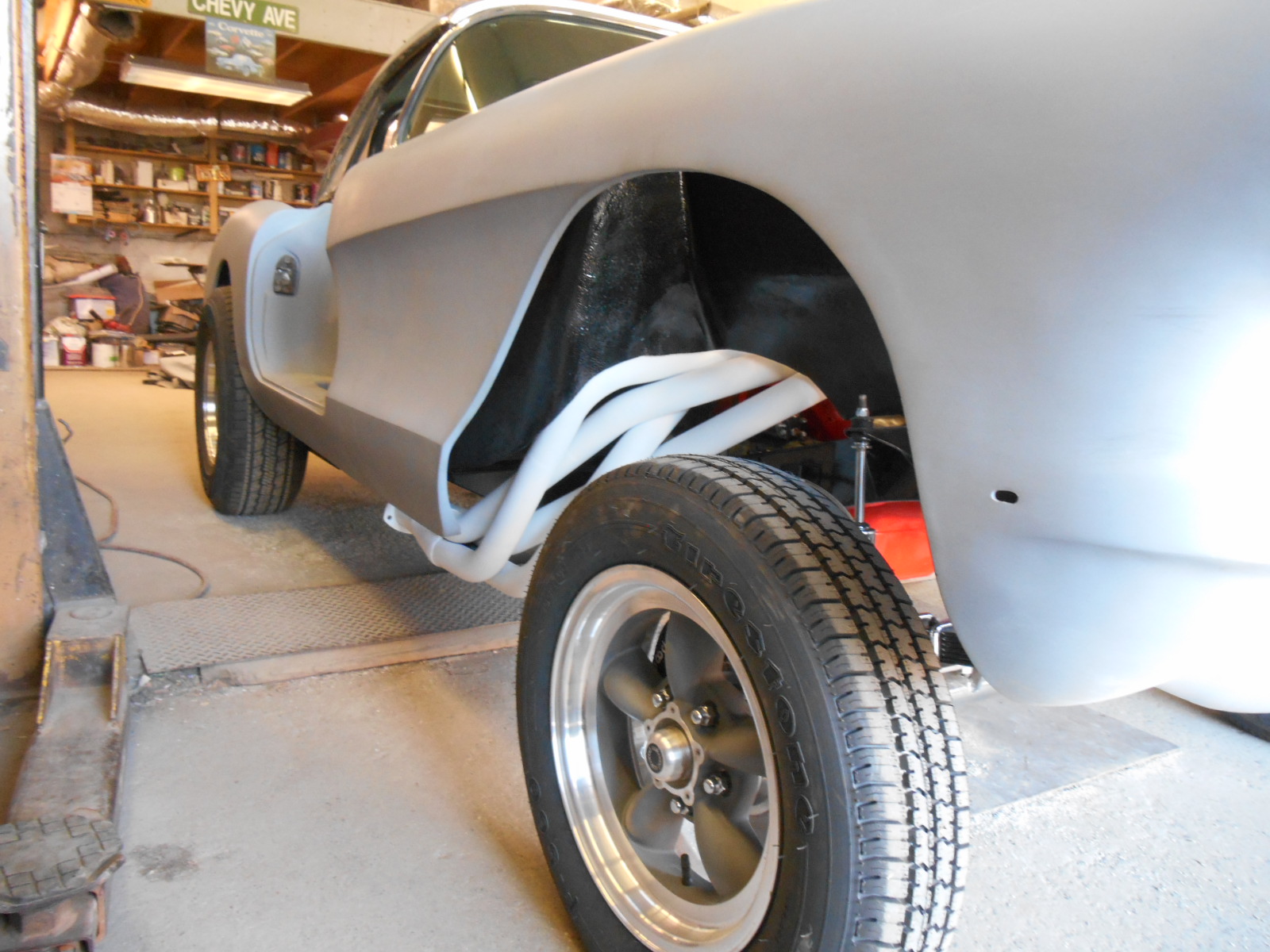

    A good day when everything goes together/fits like it supposed to Headers from underneath.JPG Headers left side pic.JPG Headers looking down.JPG Headers rt side pic.JPG Headers side shot.JPG .

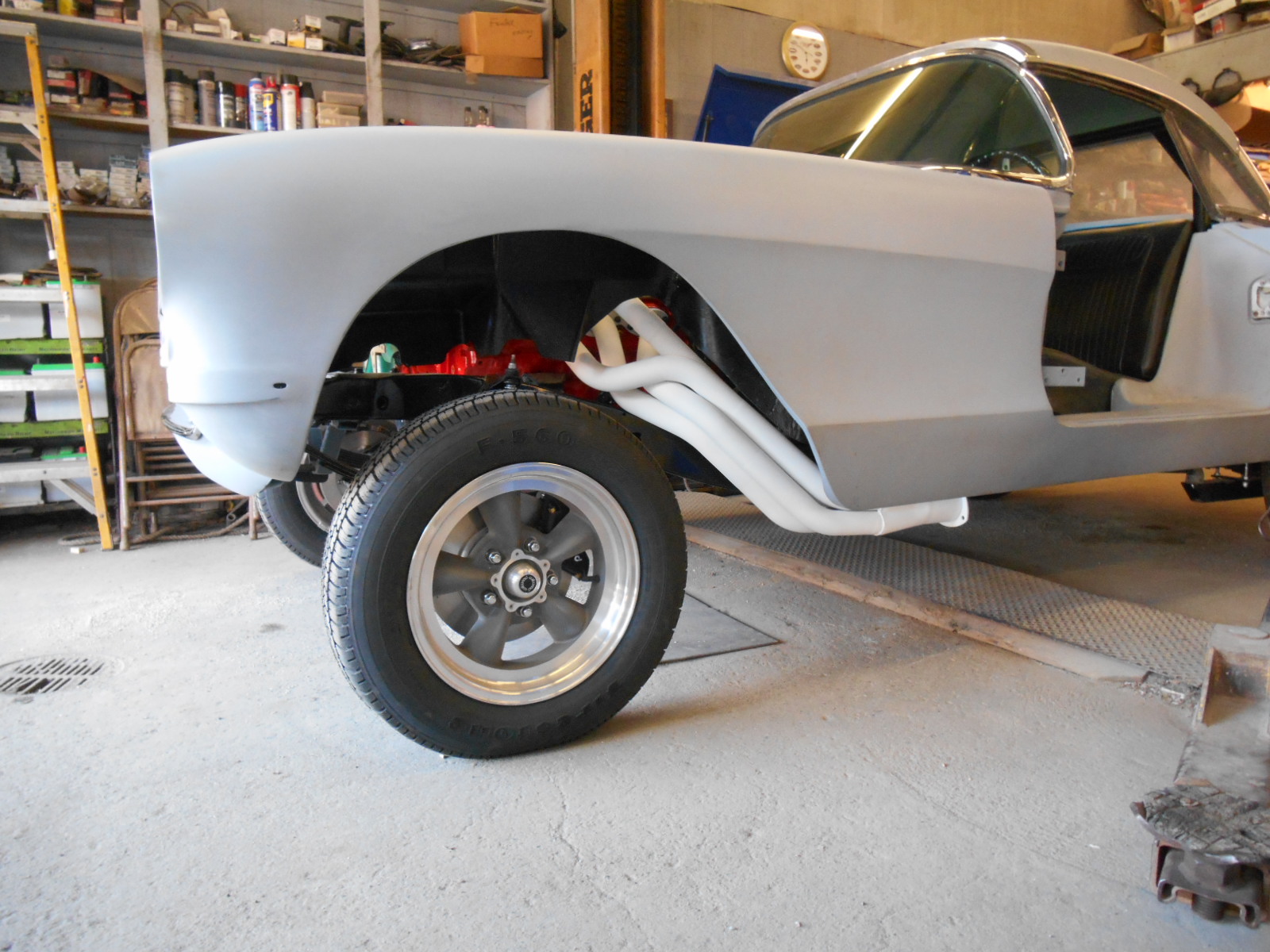

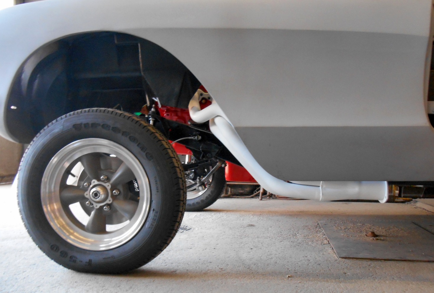

    I have always loved the sound of the chambered exhaust /side pipes of the 65-67 Corvettes. For me, nothing sounds any better. So I bought a couple chambered mufflers that just fit in the space between the frame and rocker panel and was able to tuck them up high enough so you only see the very bottom of them (other than headers, exhaust should be heard and not seen). Welded a couple of down spouts in front of the rear tires, and the exhaust if finished.
    Going to be noisy, but it will be "music to my ears".

    Great progress on your car !! You might want to re think the turn downs on the exhaust while you are still in the building mode. I have them on my red car's side exhaust. I hate them. They throw dirt, gr*** and stones on any car parked within 20 feet of my car when not parked on any thing other than a clean paved surface. Not cool. ( besides it gets my car dirty)
    I had to make up " slip on turn ups " to the turn downs to route the exhaust up and away from other cars . I would make the exhaust blow straight out to the side. Jim

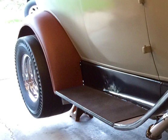

    Really loving your vette! I haven't posted yet on your thread, but I'd have to agree with vetrod62. Your turn-down's are borderline / you might hate them. Here's a shot of my A g***er exhaust, pointing nearly straight out, for exactly the reason's mentioned. image.jpg

    Both you guys are 100% correct. I cut and changed the angle of the outlets on my Cobra sidepipes for just the same reason(how quickly I forget...). The ones on there now were just left over mandrel bent 2 1/2" pipe I had hanging around the shop. I just orderd a couple of nice 2 3/4" stainless tips that should work out perfect.
    Thanks for keeping me in check. :)
