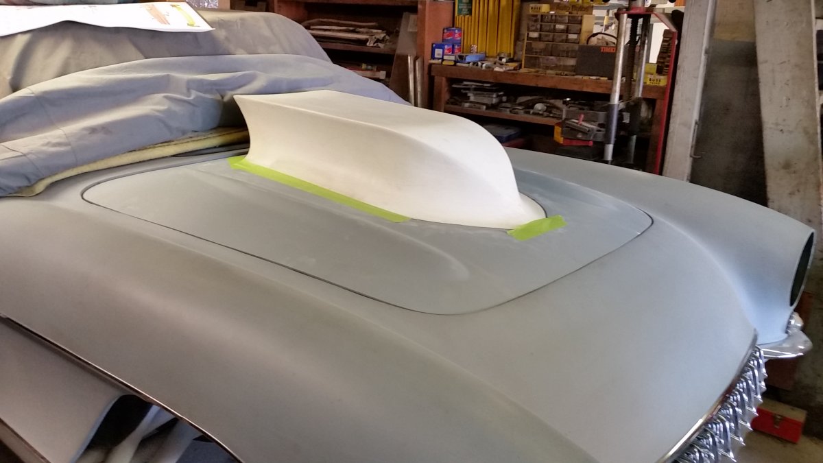

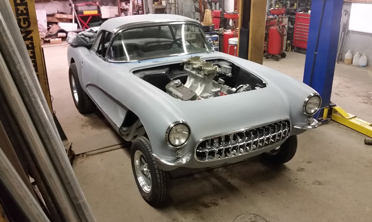

    Cut and fitted scoop to hood yesterday. Today my plan is to get my headlight buckets mounted and get the lights and bezels on. Scoop cut into hood 11 20 15 a.jpg Scoop cut and fitted to hood Nov 20 15.jpg

    I like that scoop much better. Maybe it's the way it flows with the curves of the car.

    I agree . The other one was just too square. The reason I decided to go with the other one was because it was a couple inches narrower than this one, but it only take another inch out of site on the rt side. Height wise it is actually a touch lower, and sitting in the car, I can see over it pretty good.

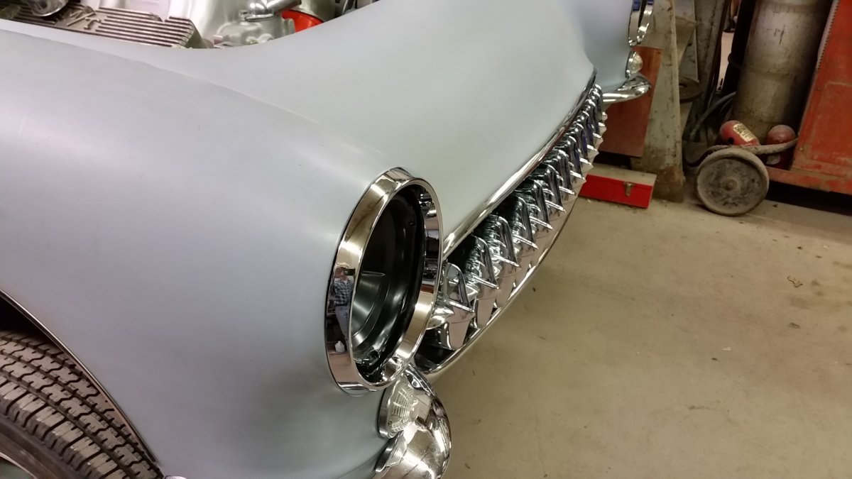

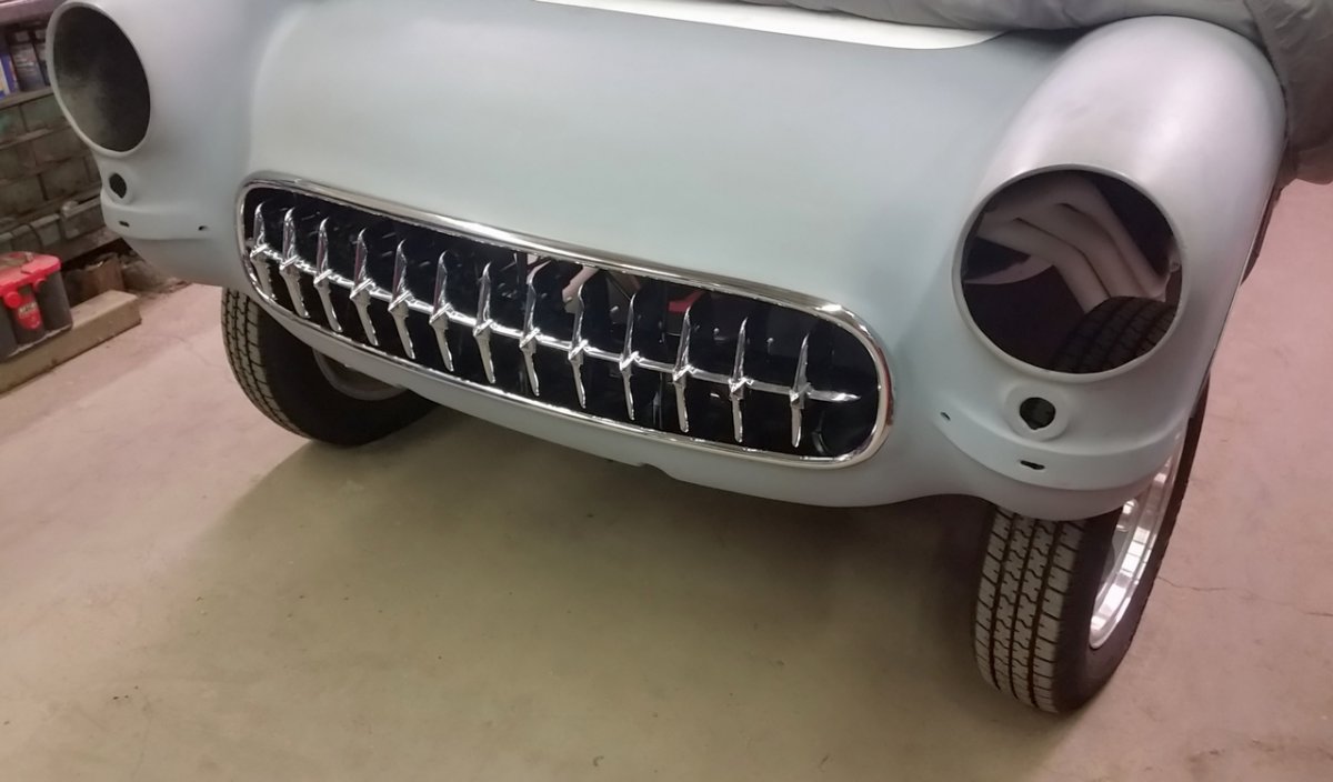

    Thanks Jim. Coming along. I spent today fitting the headlights. Between the after-market nose, after-market headlight buckets, after-market mounting flanges , and getting everything to line up correctly to gl*** in the mounting flanges to the nose, it took the whole day to finish this "simple job". I still have to remove the buckets one more time to gl*** the front sides of the flanges, but the good thing is the worst is done. The nice thing is once the headlights are in, it really makes the car look whole again. 20151121_165232.jpg

    I remember having a girlfriend that had a grill like that...:D

    Finished the headlight install today and also fabricated and installed the rear exhaust hangers. Made them so I can un-bolt the pipes/mufflers at the collectors and slide them out of the rear hangers to remove completely from the car.

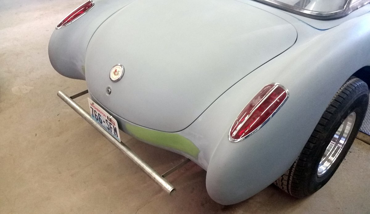

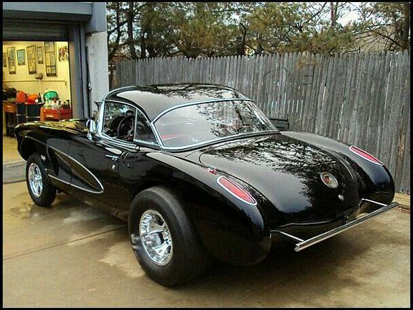

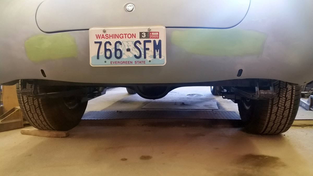

    After seeing the picture of the black Corvette with the push bar, I really liked the way it looked. Also a lot less expensive than $600.00 for the new repro bumpers that I had be thinking about buying. So I removed the stock bumpers, gl***ed up the holes, figured out where and how I needed to mount the bumper brackets and made this mock bumper up with exhaust tubing and a couple pieces of 1 x 1/8 flat stock. I used 1 3/4 inch tubing. I looked at 2 1/2 and it looked to big /heavy. I may go up to 2 inch, but no bigger. I'll look at it for a few days and once I decide, I'll order some stainless stock and duplicate this one. Open to suggestions you guys may have on tube diameter, length, etc. This is 45 inches wide, dropped low enough to clear the license plate and have extended out to protect the backs of the fenders. Corvette rear bumper slots.jpg 20151212_152552.jpg 20151212_152610.jpg

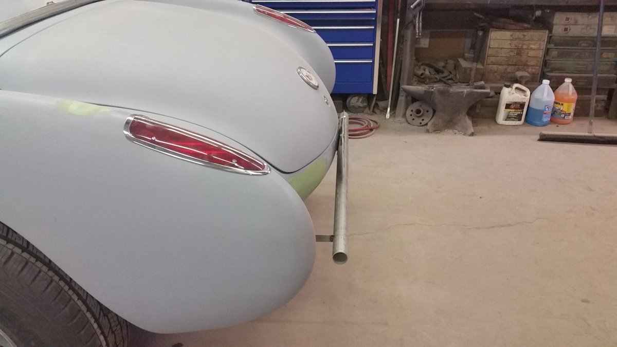

    Hi Baron, I like the push bar look. If it was 1967 and my crew were building the push bar, we would have used 3or 4" heavy wall pipe and filled it with lead because the slicks back then were so poor. But today the tires do their job without all that extra weight. ( weight is not your friend when racing ) I would build it out of 4130 rollbar tubing and make it functionally strong so God forbid , someone hits you in the rear, even lightly. Maybe even some inside gussets. Then get chromed.
    If you look at the Black car that is inspiring this topic, It appears the tube is at stock bumper height. GMs styling team put the bumper at that height for a reason. Jim

    Hi Jim. Good idea on the chrome moly tubing. As far as height goes, because the car is higher than stock and the push bar being lowered about the same amount, puts it close to stock height. And the bumper braces will actually bolt to the rear frame rails whereas the stock bumpers were bolted to the gl*** panel below the trunk with a flimsy inner steel channel that actually provide little to no protection. So hopefully this will actually provide better protection than the stock bumpers. Appreciate your input.

    Baron, I was referring to the stock height on the body/ bumpers. Not off the ground. I just think it would look better. But that is what I see, I may be way off here and your vision may be better and it is your car. Once I thought I was wrong, but then I later found out I was mistaken. LOL . Any way you do it should be great. As far as alignment with the frame, Just like my work life, home life, and car building, I just do what ever, to get it done, Jim

    Yep. And I kicked that around today on the placement and the license plate issue. I suppose I could make a bracket to mount the plate off the back side of the bar. This is why I made it out of exhaust tubing and vise-gripped in place.
    And I gl***ed up the antenna hole while I was doing the bumper holes, so my kill switch will go where I originally planned. Thanks.

    Screw the license plate. A detail to work on later. The antenna hole would never p*** inspection any way. A question, do you want to race this car and expect it to go fast?? If so NHRA rules need to be respected, or they will not let you race.

    I like that push bar, but wonder if you could add a bit of curvature to it to better match the body line? Really like this build!

    I think I would mock one up to follow the body lines to see how you like it

    I also think one that was bent to follow the body lines would look good. But I think doing that it becomes more of a custom bumper than a push bar. Form over function. ( not that I plan on using it as such, but prefer it to be functional).
    Thanks Jim. Now this one is mounted down low , but not sure I like it as well as being located at the stock bumper height like the black one. I'll alter my temp bumper mounts to move it up to see if I like that better. Thinking about it last night, I can always lower the plate a couple inches on the body so that it would be visible below the bar .
