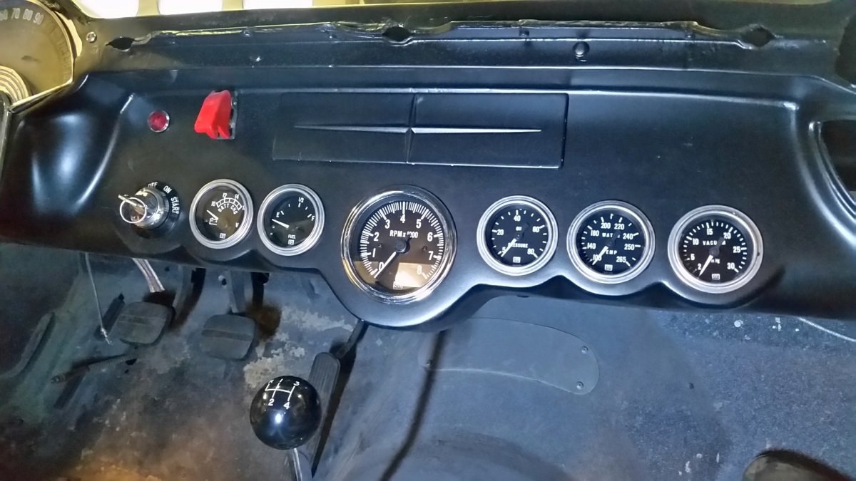

    Mounted the gauges in the dash today and installed the kill switch. Think tomorrow I will try to get the speaker grill and trim in and install the cowl vent handle ***embly and maybe even the e-brake handle. Good thing it is not too bad laying under the dash on this car with the seats out. Actually it's pretty roomy under there . Corvette gauges in  a.jpg Corvette kill switch installed.jpg

    It's looking real good Baron. What kind of gauges and steering wheel did you use?
    els, Rat Sass and Baron like this.
  18. Baron
    Joined: Aug 13, 2004
    Posts: 3,691
    Baron
    Thanks Jason. The steering wheel is from Con2R. The smaller 15 inch wheel makes it much easier to get in out of these cars. These repro wheels bolts on the stock Corvette hub and uses the original horn ****on.
    The gauges are just a set of Stewart-Warner mechanical gauges (oil, water and vacuum). The good thing is the gauges fit the stock openings in the dash. The clock opening has to be enlarged to fit the tachometer. This moves the tachometer out of the line of site, but a shift light mounted on my steering column will solve that problem.

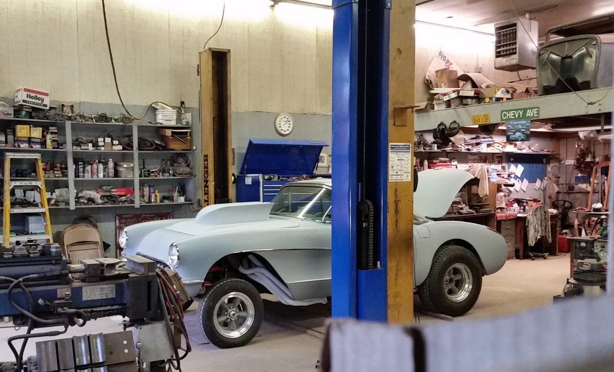

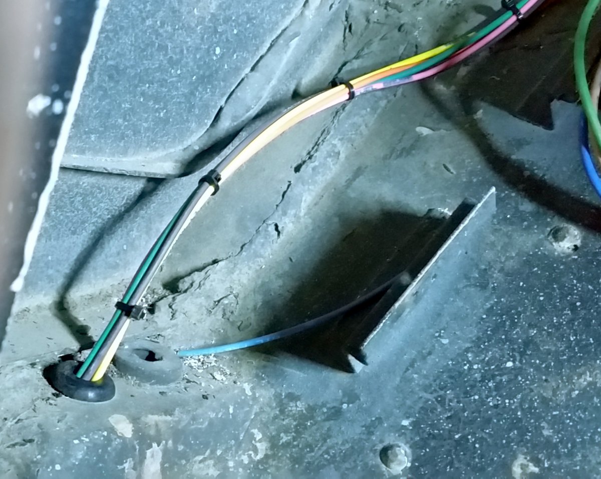

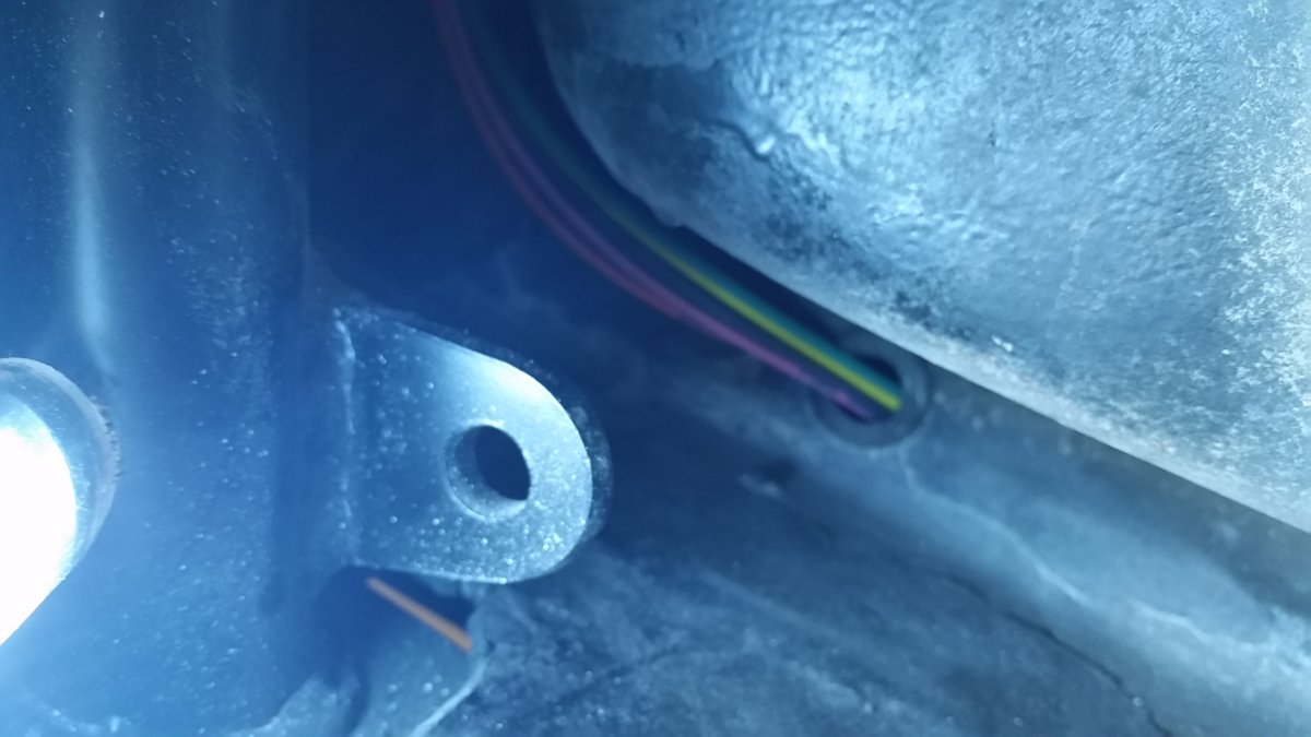

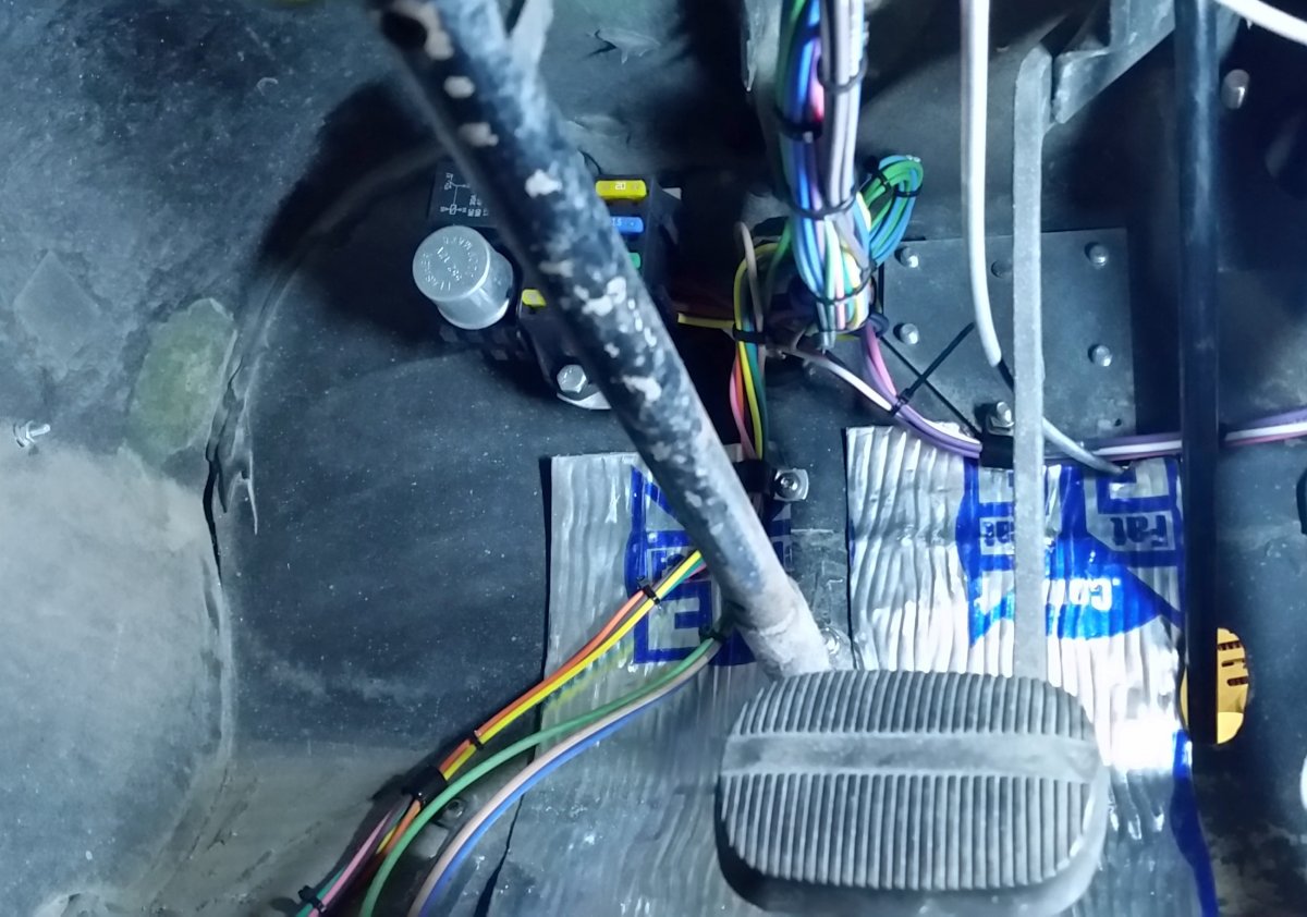

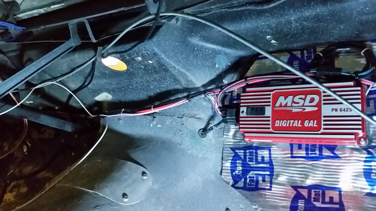

    For this car I bought a Rebel wiring harness from Jeff Sullivan (HAMB Vendor). Nice, simple unit and I have found that by the time you buy all the stuff to wire it from scratch, winds up costing close to the same.
    So I spent the last two days installing the MSD box, mounting the Rebel fuse box and ruffing in the wiring harness to the engine compartment, both front and rear of car and connecting the MSD box to the ignition wiring. I like to hide the wiring as much as possible. I'm running mechanical gauges, so the wiring to the engine compartment is minimal. I was able to snake the wires through the left rocker panel for the rear harness by drilling one hole the exits into the p***enger compartment just before the bulkhead. The front harness I mounted up under the left frt fender /inner fender panel. The new ignition switch I bought turned out to be junk, so I'll have to order another one. Also need to order the retaining nut for my headlight switch. Once I get those, I can finish up under the dash, wire up the gauges, dash lights etc. Nice ,relaxing work (laying under the dash), for a change.

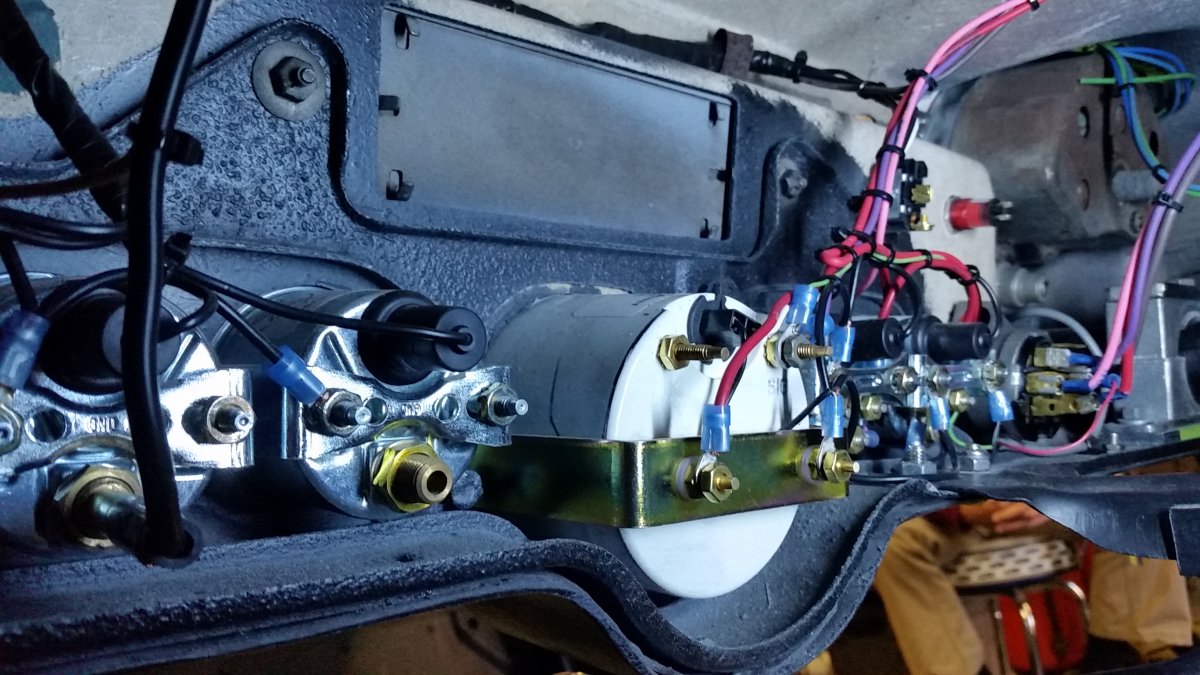

    Finished up under the dash today for the most part. Tie-wrapped the wires to neaten things up a little. Need the light bulb sockets for the speedo housing( directional and turn signal lights,etc) and fabricate a bracket for a stop light switch along with installing the oil line and vacuum line to the mechanical gauges. Next step will be to install a battery box in the trunk, and run the cables. Once that's done I can install a battery and see if everything works like it is supposed to.

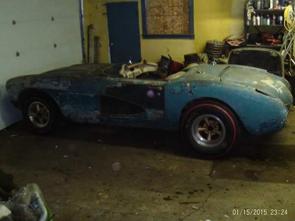

    A friend of mine just picked up this 61, rough as a cob in spots but is getting his Olds rear for it this weekend. He's a lurker here and I know he checks in on this thread to see how some things are done. The last photo is his latest mockup. 12593498_1101116909922289_2421980067246872392_o.jpg 12640428_1101118333255480_8077472959397198843_o.jpg 12622498_1101118456588801_174149686004257228_o.jpg 12743799_1111897918844188_2657289410337541778_n.jpg
