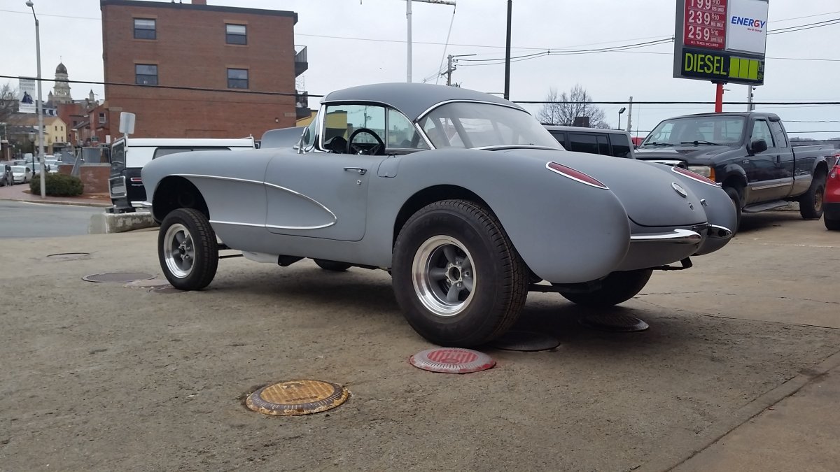

  2. Just looking at the car in the outside shot brings one word to my mind.
    Intimidating
    I'd back down from a race just by pulling up next to it and looking at it.
    Yes, call me chicken ****.

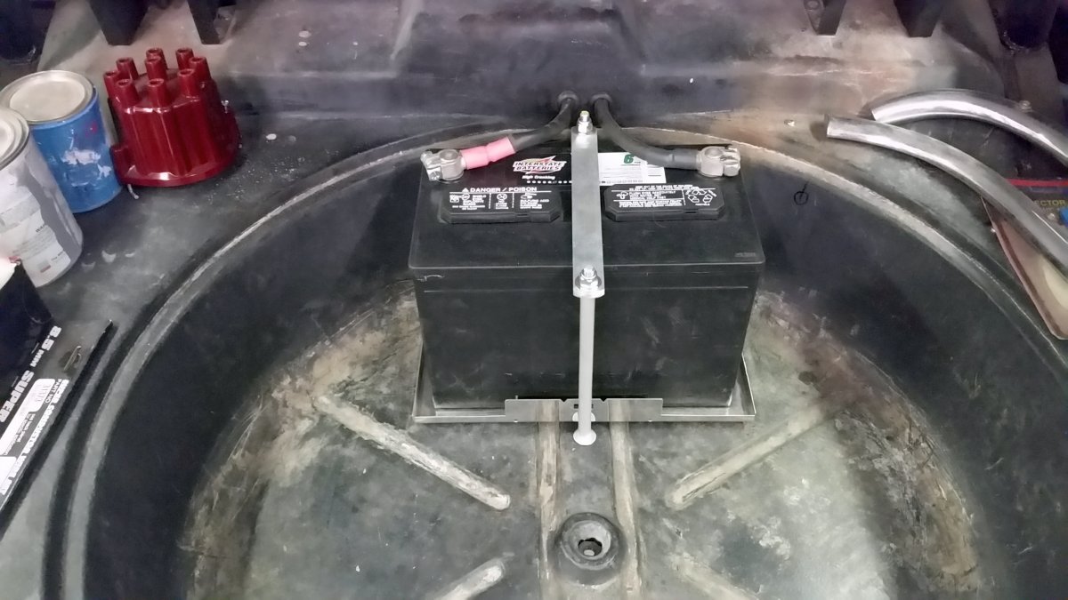

    ****s about your motor issues Baron. I have owned a dozen vettes and I have a funny feeling there are more in my future, yours is excellent! Curious, are you wiring a battery cutoff switch? NHRA tech inspection requires them I think when you mount the battery in the trunk (I found this out the hard way).

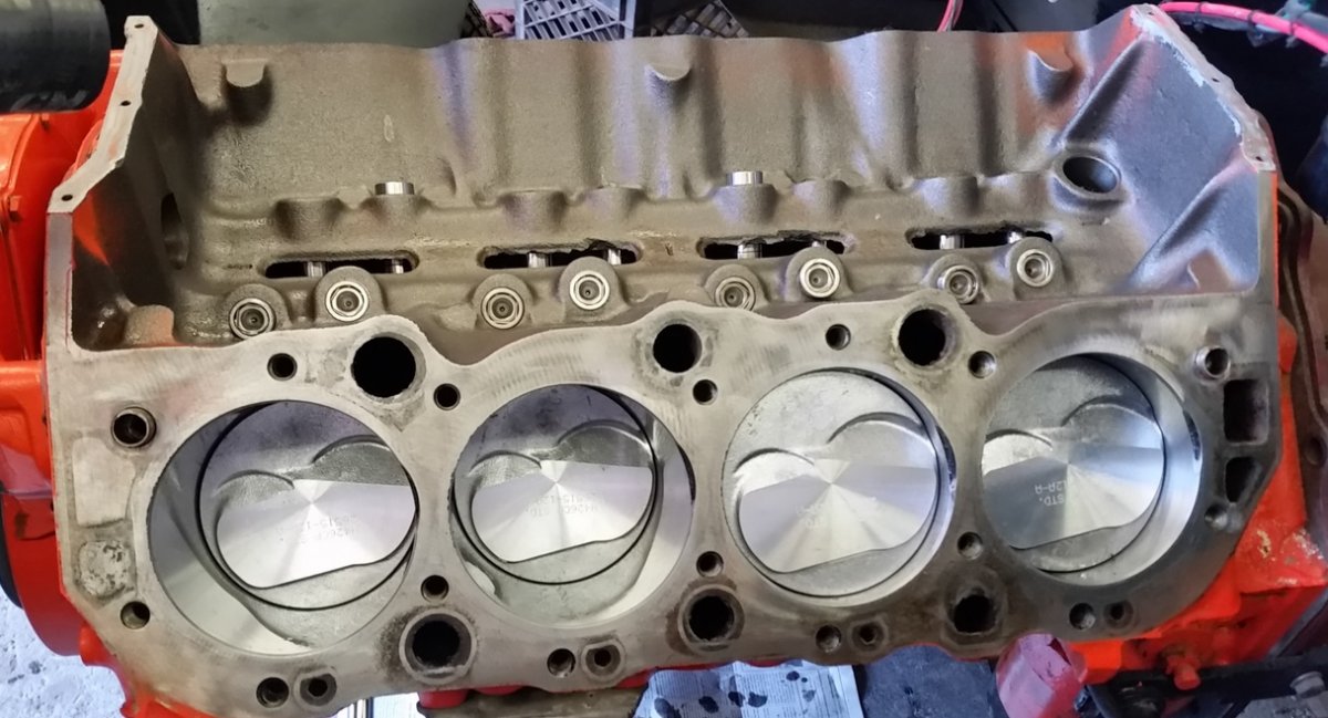

    The machine shop called me today. Bent all eight intake valves. I have decided to keep going with this motor and ordered a set of pistons, rings and gaskets today. Friday I'll pull the pan and remove the pistons and rods so I can get them to the machine shop to swap the rods onto the new pistons. All is good.

    Installed the new pistons today and got the oil pan is back on. Would have had the heads on today, but I ordered the wrong head gaskets. Correct ones will be in tomorrow and I should have it up and running tomorrow afternoon. :)
