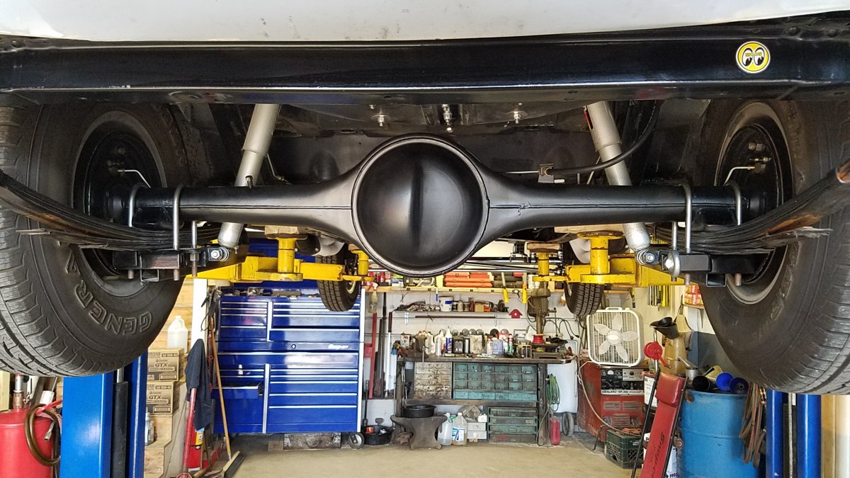

    All back together. I'll order the new driveshaft Monday and hopefully all will be good. Also rewired my kill switch so now it works as it should( alternator wire was back feeding the system). 20170603_171758.jpg
    els, swade41, Finn Jensen and 5 others like this.
  3. Baron
    Joined: Aug 13, 2004
    Posts: 3,672
    Baron
    Car's back up and running. Rear end is nice and quiet. 4.11's pull even better than I though they would over the 3.73s in the stock rear end. All good news. 57 Corvette olds rear end 6 14 17.jpg 57 Corvette new driveshaft  6 14 17.jpg 2017-06-07 18.48.25.jpg

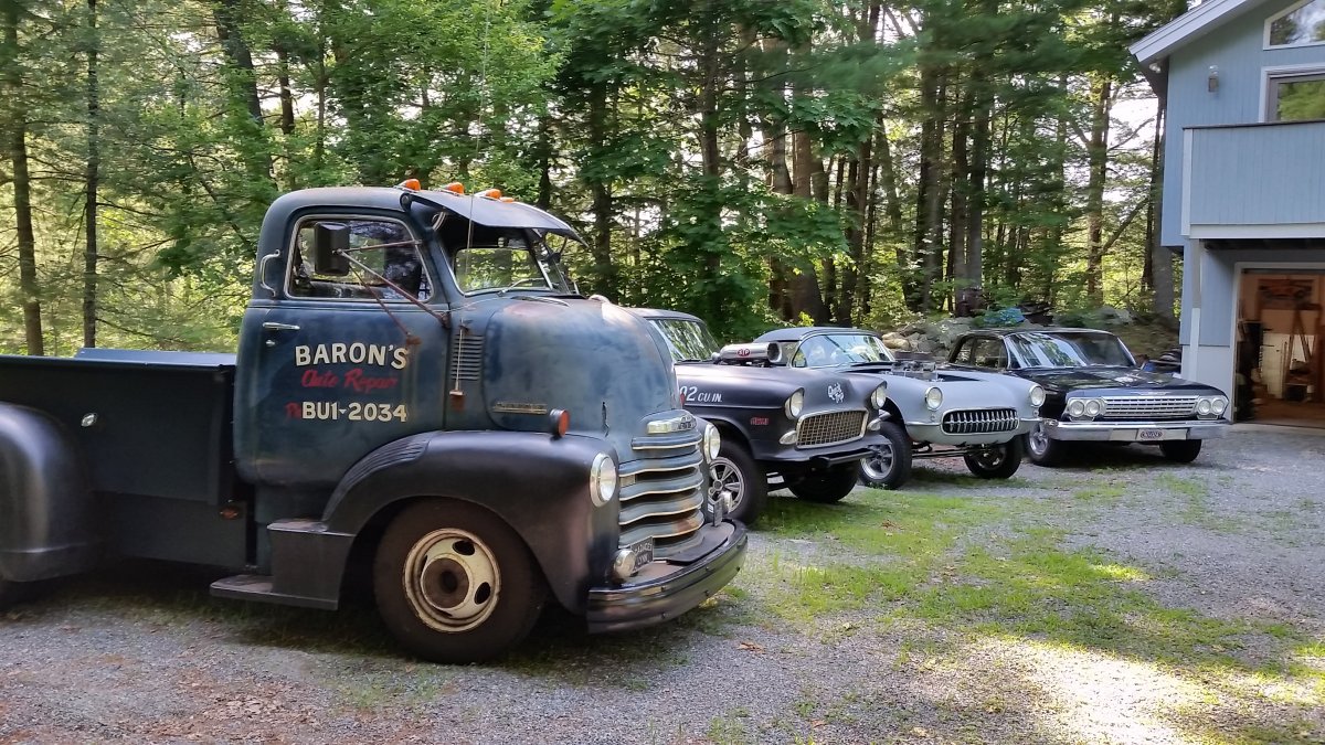

    Built the COE in 2010 just after finishing my 55 Chevy. 47 COE cab I mounted on a 1990 1 ton dump truck dually ch***is. Shortened up the wheelbase from 136" to 106". I'm running a 1984 Corvette 350 (now Holley Carbureted) with 400 trans, mounted under the front seat( about 18" back from the stock location of the six cylinder) which makes it almost mid-engine. Been a great shop truck.
    Thank's Mike
    That's as good as it gets. Trying to log some miles on it before I give it a good thrashing. :) 2016-07-16 16.11.11.jpg

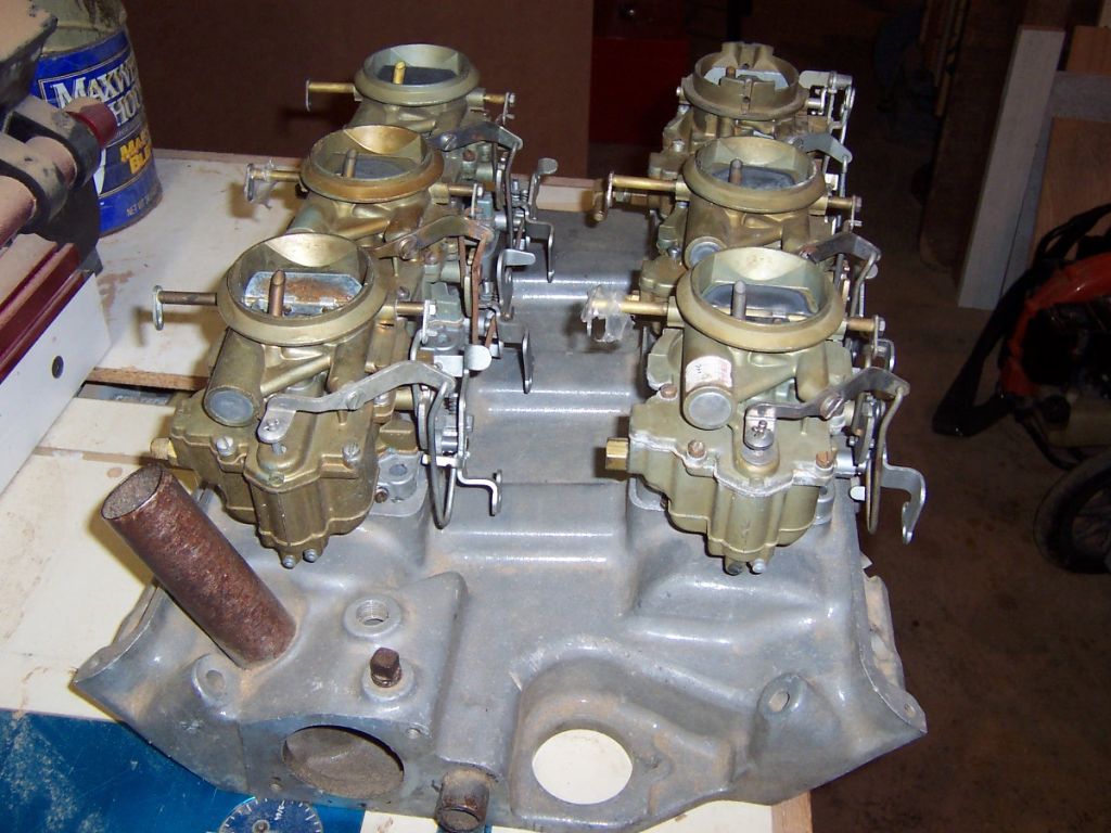

    Thanks for the reply. I'll be changing things and re-inforce the X member to install a non-Chevy but torque type engine of the 1960's era. But it will present my 60 Vette nicely. More to come next year but a picture of the intake.
    The engine will be a stroker @ 454 cubes. Oregon Cam, Arias pistons , H-beam rods, Vertex Mag and original Cast Iron exhust manifolds with a forged RC bell housing big in & out top loader. Vette purests will literaly hate me.
