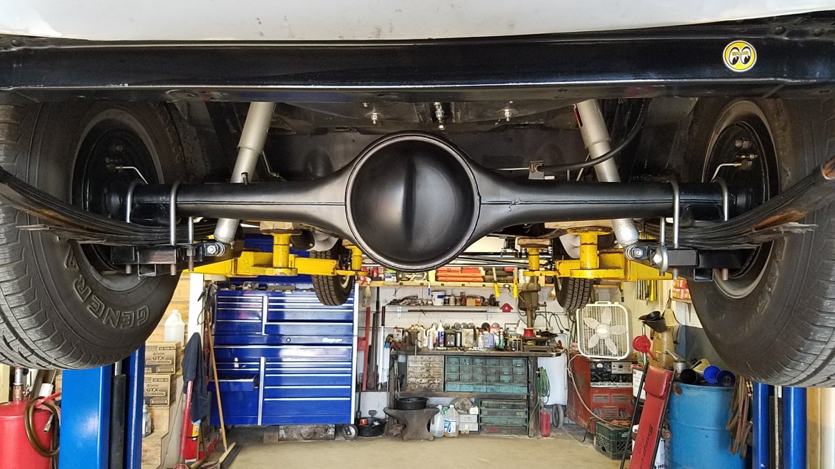

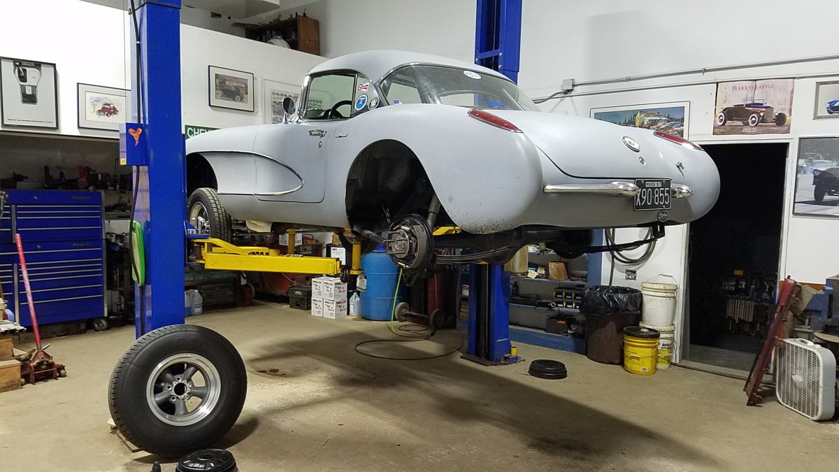

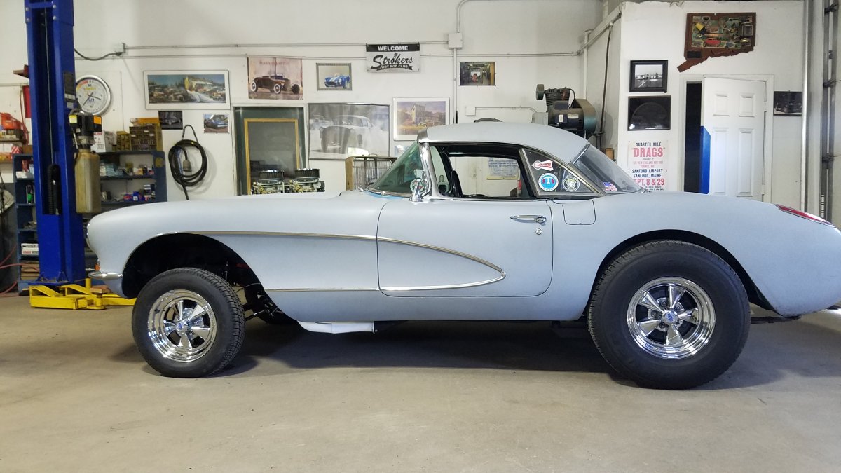

    After wrestling with the height of the front end since I built it, I finally called Bill Carlson ( WAC Customs in CT )a few months ago and he made me a new 2 inch dropped axle. Once I got the axle from him, measured up the old axle to figure out the caster angle and spacing, got the pads welded on and than sent it off to be plated. Got it back last week and installed it last Friday, had the front end aligned, and I finally have the car sitting at the height I originally hoped for. And thanks to Bill for making quality axles that the alignment specs are right on the money. Corvette 7 30 18 d.jpg 20180727_095209.jpg

    Two inch dropped axle.
  7. noboD
    Joined: Jan 29, 2004
    Posts: 9,103
    noboD
    That sits Purrfect. Really looks good.
  8. LowKat
    Joined: Nov 29, 2005
    Posts: 10,026
    LowKat
    Lookin' good, stance matters.
    Baron, Bowtie Coupe and loudbang like this.
  9. jimdillon
    Joined: Dec 6, 2005
    Posts: 3,322
    jimdillon
    I agree the stance is much better IMO. Looks great.
  10. loudbang
    Posts: 40,351
    Looks better with the new axle :)

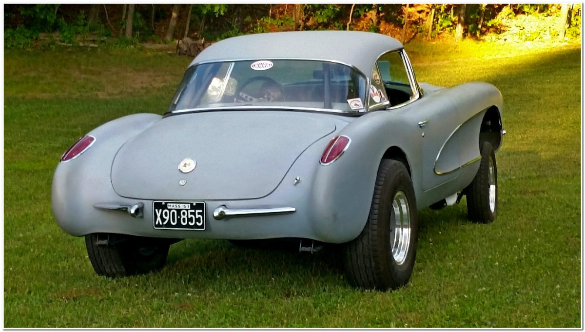

    The 57 Olds rear end is stock width and measures about 61 inches wide, axle flange to axle flange (outside drum to drum). Tires stick out just a touch, which is the look I was after. The Cragars have a 1/2" more back space than the Torq Thrusts that were on it in this picture. 20160621_191417_resized.jpg

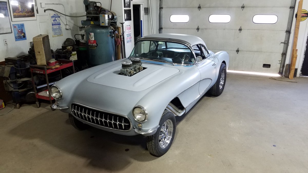

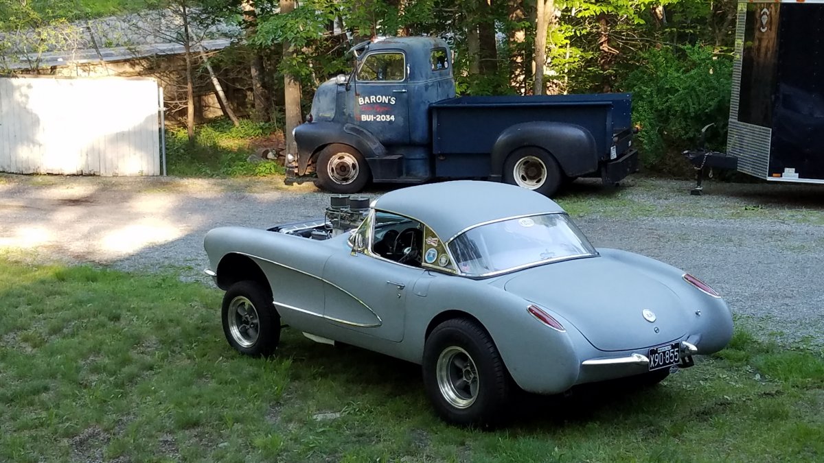

    Nice to have the hood on and still be able to safely see the road ahead. Corvette hood on 9 1 18 c.jpg Corvette hood on 9 1 18 a.jpg
  25. Steve Norton
    Joined: Sep 16, 2014
    Posts: 59
    Steve Norton
    Looking good Baron. Your car gave me the inspiration to build mine. Are you still going with a blue paint on the car, love the new look.
    elgringo71 and Baron like this.

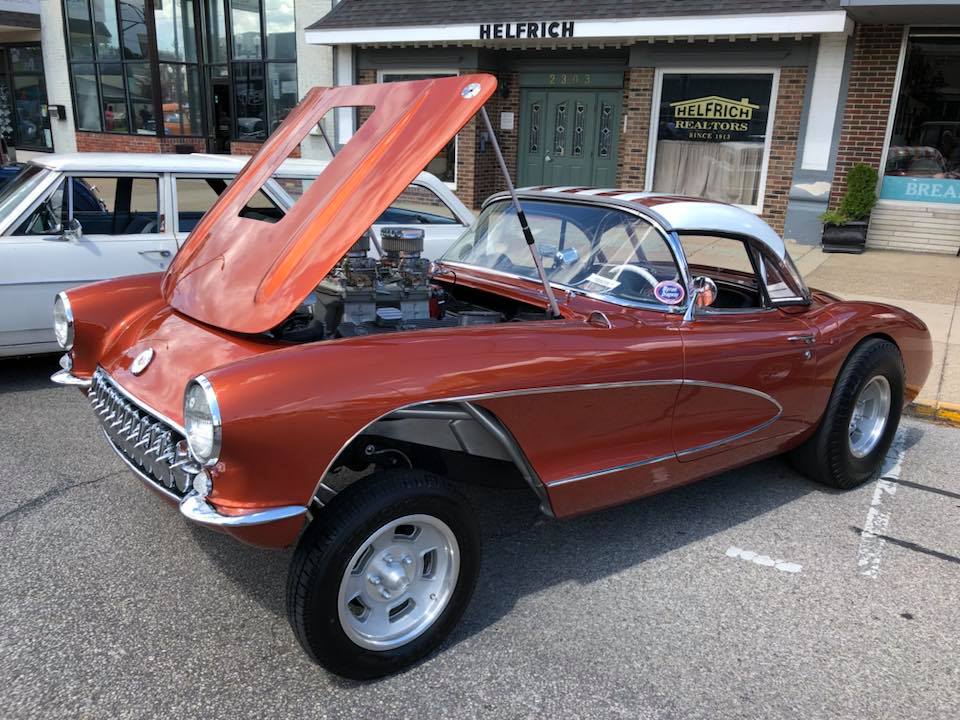

    For those of you who have not seen Steve's yet, here it is.
