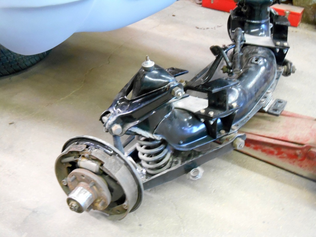

    Rear spring mounts are welded in. Wound up raising them 2 inches into the frame rails to lower the car. Forward mounts are 80% done. Figuring the front springs will settle 1.5 " - 2" once the motor ,radiator, etc. go in, I should have a final ride height very close to where it was with the old front end. Second picture shows 2 inch exhaust pipe axle for mock up. 004crop.jpg 57 Corvette 11 2 14 b.jpg

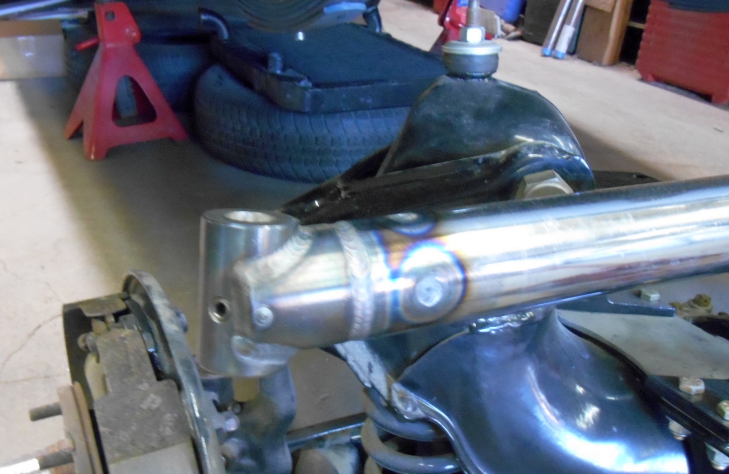

    Fitting spindles, brakes and steering arms to measure for tie rod length. Corvette axle and brakes 003.JPG Corvette axle and brakes 001.JPG

    As a retired tig welder I can say someone knows how to do it!:cool:

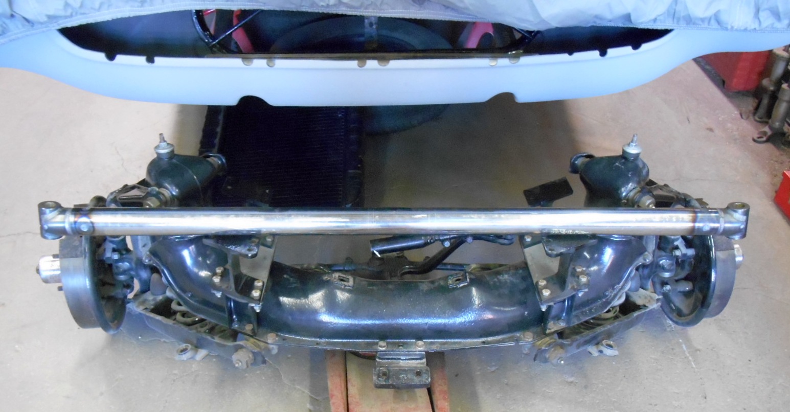

    els likes this.
