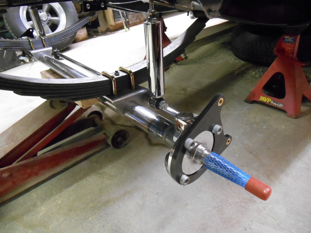

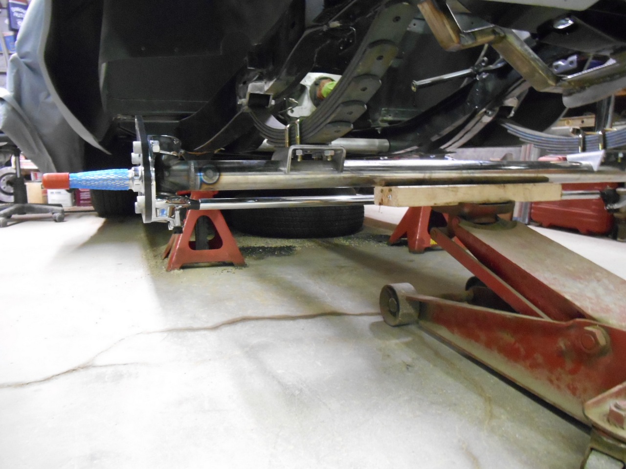

    Made up the frt lower shock mounts today and welded them to the axle saddles. Decided to mount them to the rear of the axle. Little cleaner looking and better spot on the ch***is to attach the upper mount. I didn't like how low the tie rod ***embly sat, so I re-tapered the steering arms so the tie rod ***emble comes in from the top. This raised the tie rod about three inches and will also give me better angle for the drag link to the pitman arm. Tomorrow it will be back on its wheels, and able to roll back on the lift to work on it. This working/welding on the floor with jack stands gets old pretty quick.
    Corvette axle install 11 21 14 a.JPG Corvette axle install 11 21 14 b.JPG Corvette axle install 11 21 14 e.JPG

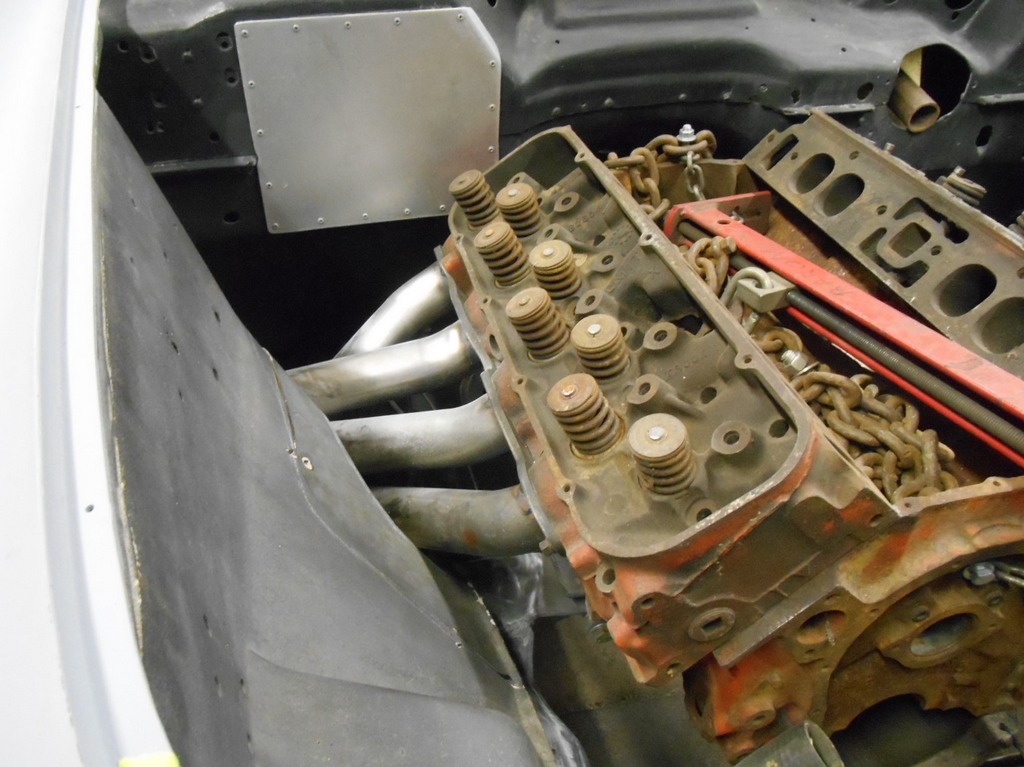

    Installed the side mounts for the motor today. Tomorrow I'll throw on a set of old heads and start cutting and t******* the inner fender panels to fit the Tubular Automotive fender-well exit headers. Looks like I'll be able to use a mechanical fuel pump. Mounts 2 rs.jpg Mounts 1 rs.jpg

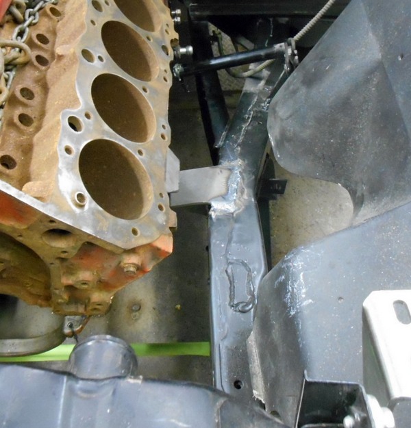

    Finished welding the motor mounts today and cleaned up the welds. Bolted in the clutch bell crank after cutting a notch in the bottom to clear block in the oil filter area. 001rs.jpg 003rs.jpg

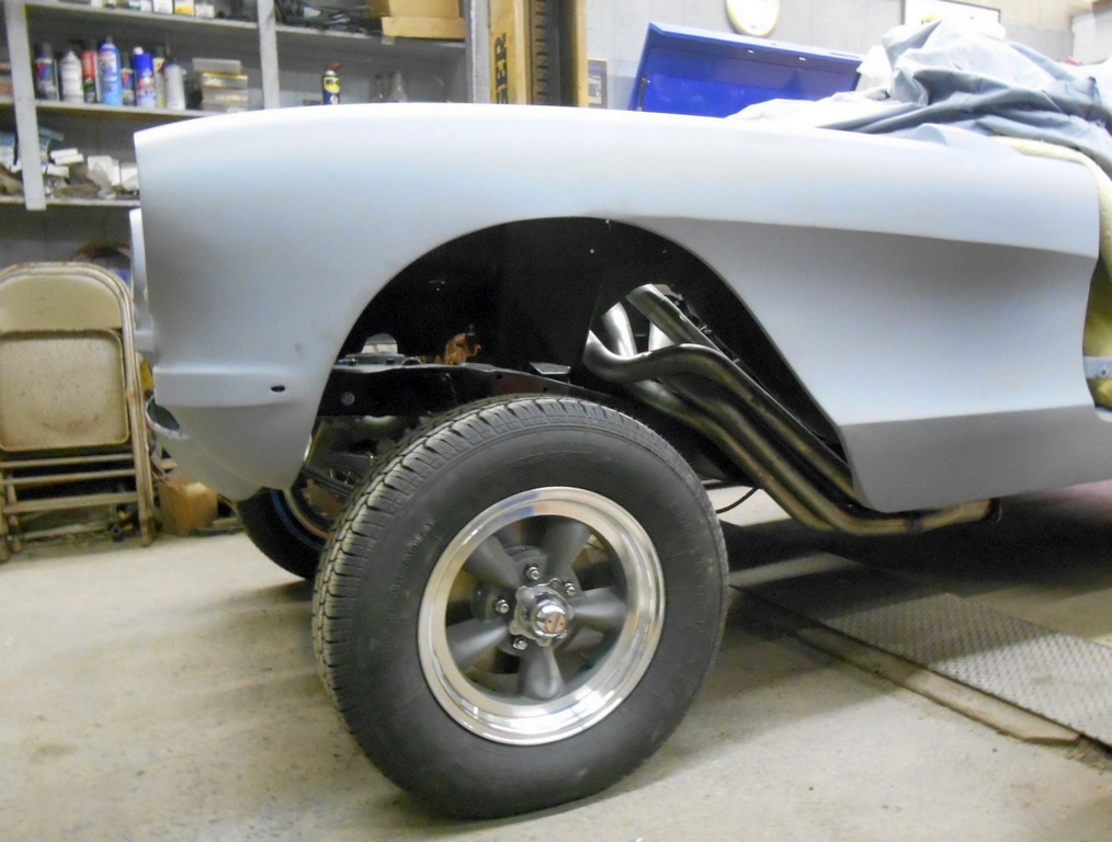

    015rs.jpg Trimmed the inner fender panels for header clearance. Left side came out good. Right side I wound up cutting more than I needed to, so I re-cut the panel and gl***ed it back in. I'll finish them off once the dummy motor is out. Everything fits as its supposed to. 010rs.jpg 012rs.jpg 014rs.jpg

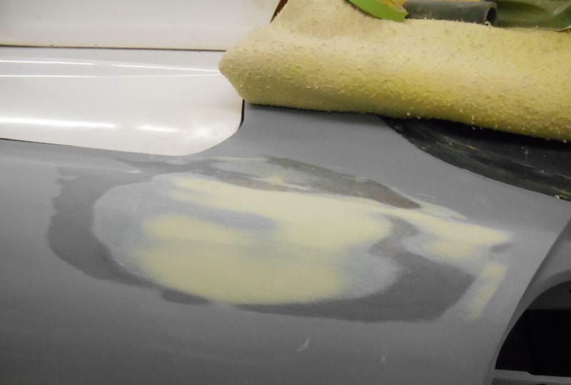

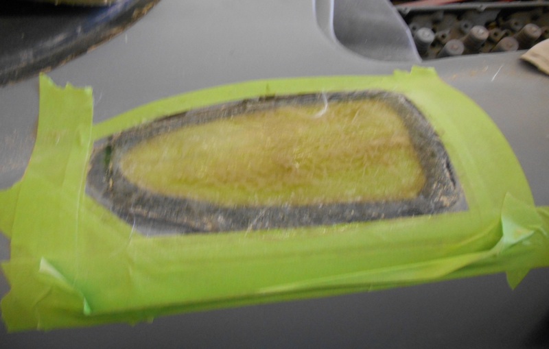

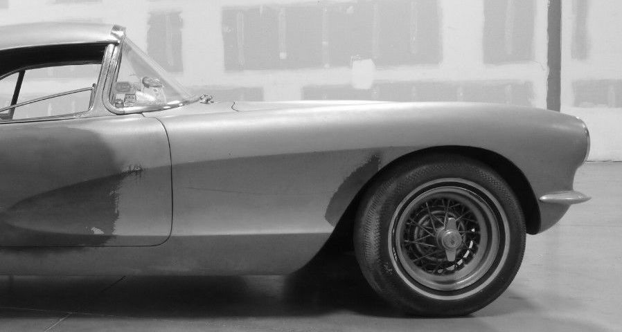

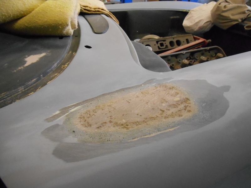

    Not a big fan of these fake scoops and tomorrow they are going. Being an after-market nose, they do not have the provisions to install the stock trim/inserts as the original nose did. Last pic is one with them removed. Much cleaner looking without them.

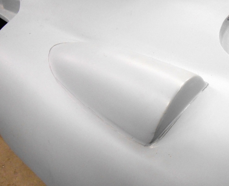

    The "hiccups" are gone.....

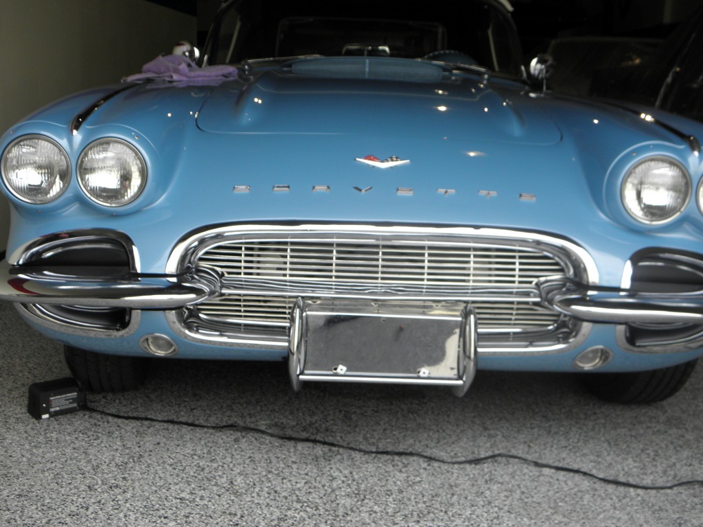

    Finally nailed down the color it is going to be. 1961 Corvette Jewel Blue. One year only, and only 855 were sold this blue. Two gallons of lacquer should arrive this week. Choosing a color has been one of the toughest decisions of the build. Here is a sample of the color.

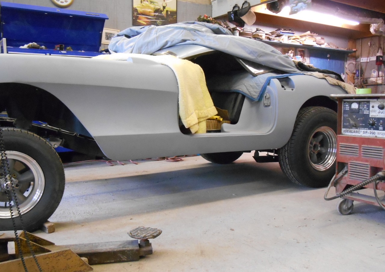

    Next I'll clean up the dash, and that will be the end of body work for a while.
