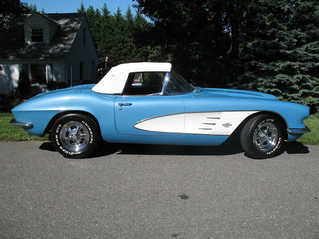

    IMG_0015.JPG The wifes 61, Jewel Blue with the white cove. Someday maybe she'll let me drive it instead of just working on it !

    Thanks for the picture. I like the color, and looks very nice with the white coves. Your wife has good taste.

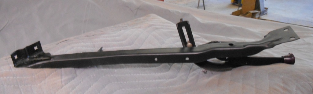

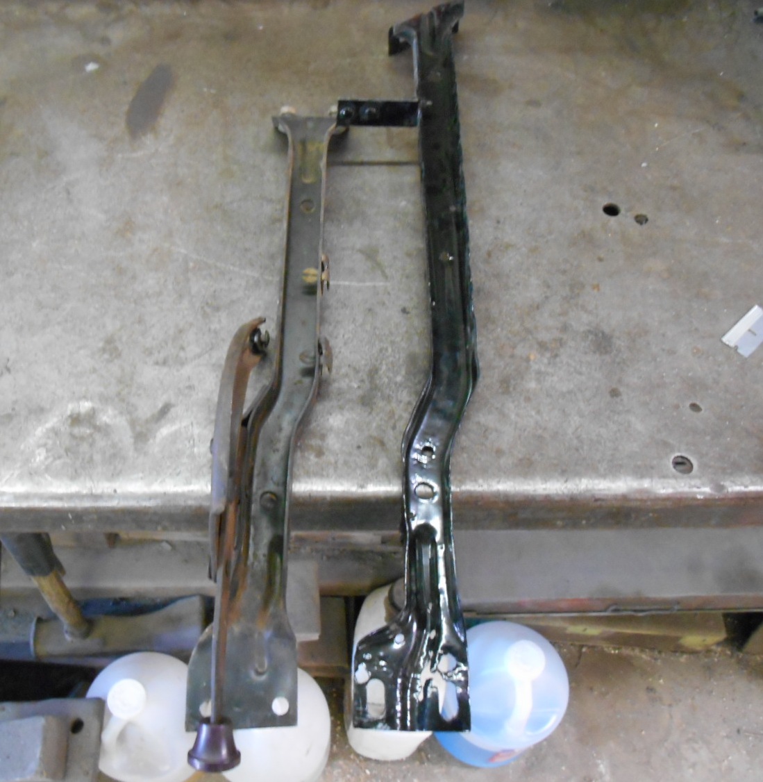

    Little job I just completed. Although I had the cowl vent bracket for my Corvette, the handle and linkage was missing. After a little online searching, I found that these Corvette ***embles sell for $400-$500.00 ! But after looking at the pictures, it looked a lot like the same set up in my 1947 Chevy Cab Over, just longer. To make a long story short, I bought one for a 48 Chevy pick up(truck left, Corvette right), combined the two together and it is all done for less than $35.00 and a couple hours time. Works for me. :)

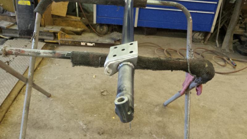

    My good friend Bryan Winter welded my axle pads on for me today. I can tig weld, but not like someone who does it everyday for a living. And Bill does such a nice job on his axles/welding I wanted the welds on the pads look as good. Once I got back to the shop, I polished it up, boxed it up and UPS 'ing it out to the chrome platters on Monday.
    I've been struggling with how high the frt end is. When I took the axle out, I came up with a better idea for my frt shackle mounts. This will bring the frt end of the car down another 1 3/4" - 1 7/8 ", so it will sit the same height as it did with the 4 inch I-beams. I'll post some pictures of the new mounts tomorrow night if I get them finished. Corvette axle ready for chrome 4.jpg Corvette axle ready for chrome 2.jpg .

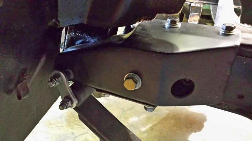

    Thanks Jim. Finished the front spring/shackle mounts today. Much happier with this set up over the last. The front end needed to down a bit more to get away from that "street freak" look. I think this will do it. And the nice thing is they bolt to the stock ch***is to existing tapped bolt holes with 6 bolts.

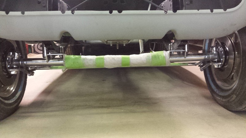

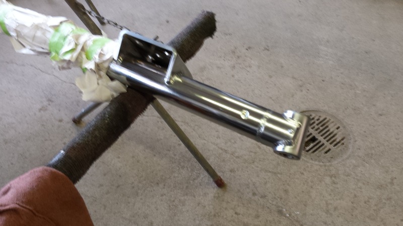

    Axle came back today and it looks good. It is what they call "racer's chrome". Not show quality, but certainly good looks good enough to go under the car. And the price was more than reasonable. I painted the front springs today and tomorrow I'll install the front end for the final time.

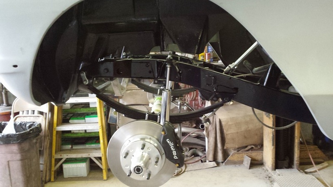

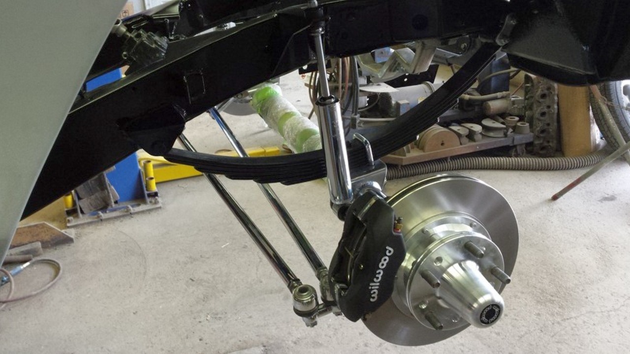

    I finished painting the front of the frame, finished filling holes in the engine compartment / firewall and have that ready for paint (semi-gloss black) and bolted on the frt shocks and front calipers. Nice to be ***embling some of these parts for the final time. Plan on installing the motor next week-end if all goes well. Corvette frame painted  and shocks in a.jpg Corvette frame painted  and shocks in b.jpg Ready for paint.jpg

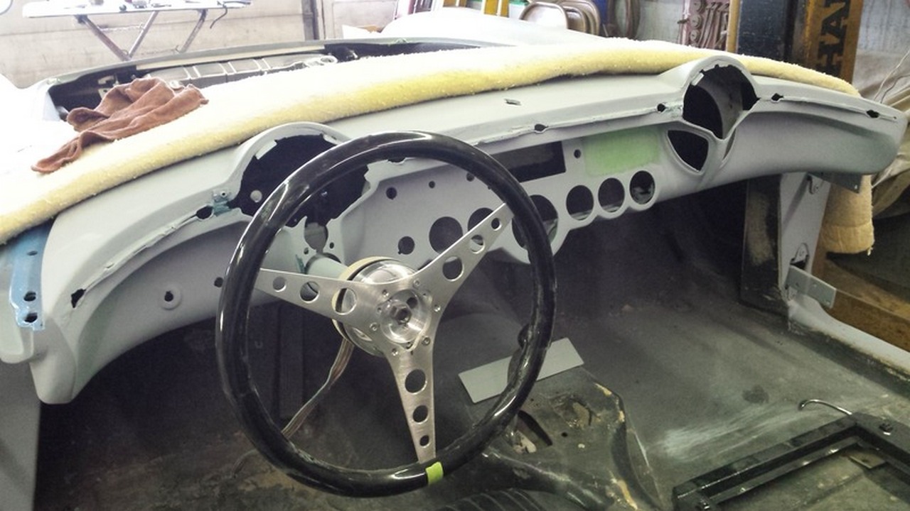

    I have lost track of the number of hours I have spent on the dash to get it paint ready. Almost there.

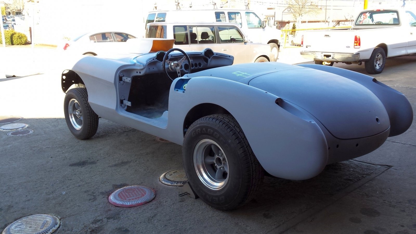

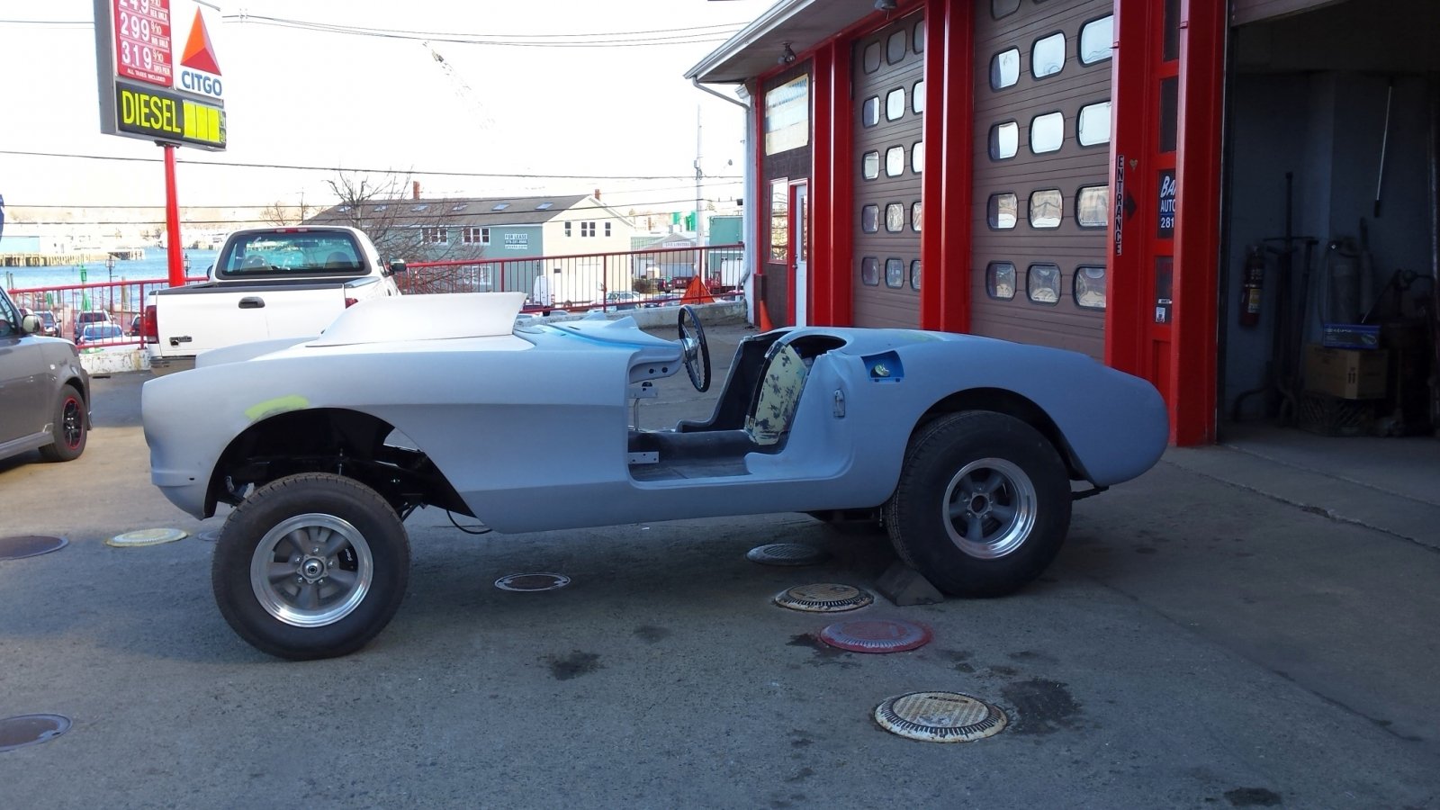

    First time out of the shop in almost 11 months. 57 Corvette 4 4 15 d.jpg 57 Corvette 4 4 15 b.jpg 57 Corvette 4 4 15 c.jpg

    Love the stance. Looks perfect Great job Baron
