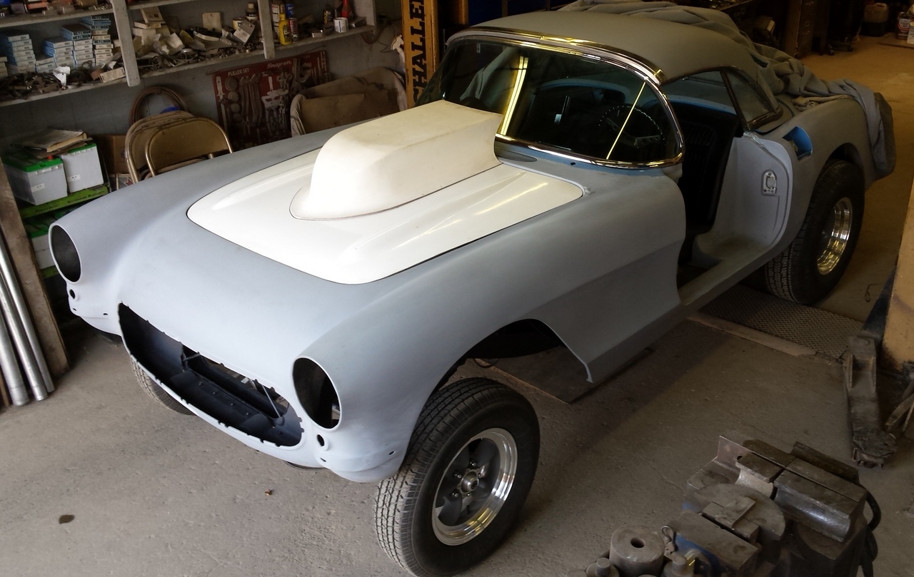

    Thanks for the comments guys. Been thrashing on the car this past week. Friend of mine let me use his spray booth for a few days while he is on vacation. This gave me time to paint the engine compartment and paint the dash. I also was able to get some color on the jams on the top lid cover and get the top in primer. With all this done, now I can bolt on the top lid cover , cut the holes for the roll bar to p*** through, and weld the roll bar in and install the motor. I hope to install the motor this coming week-end . The headers are out to be coated, the 57 Olds housing is out being sandblasted and I have a set of 4.10's / 35 spline spool coming . Plenty to keep me busy, to say the least. :D

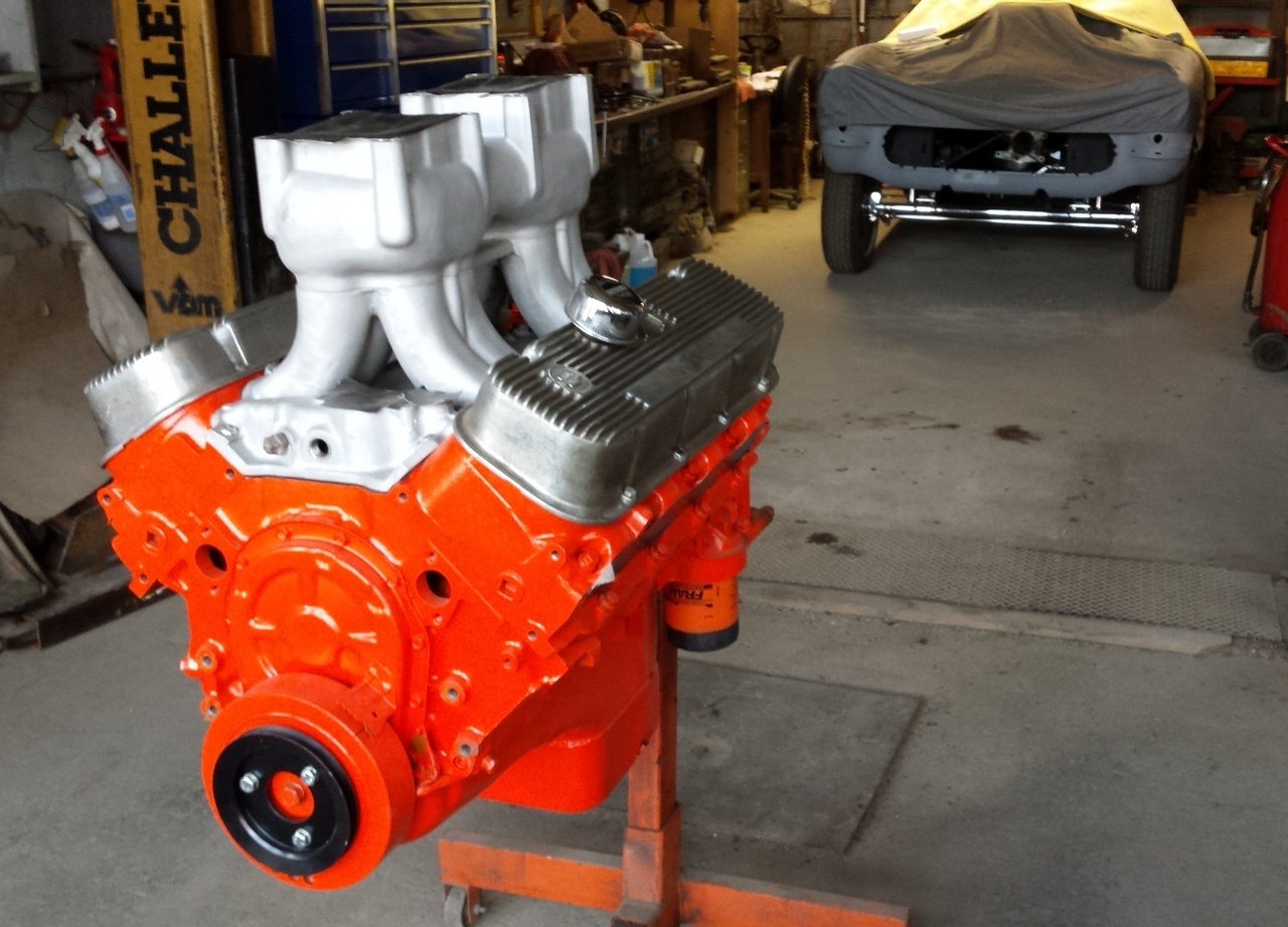

    Hopefully tomorrow night.

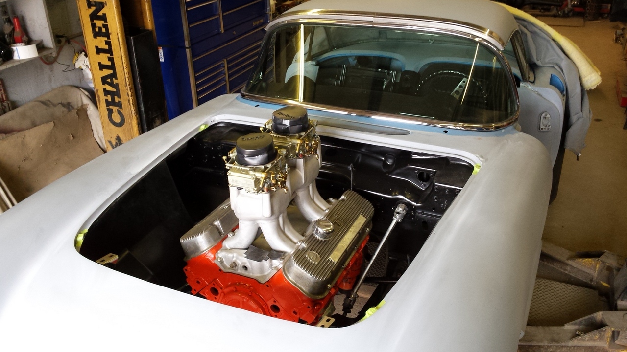

    The motor went right in today with no problems. I had left the transmission in the car as they are tuff to get in and out with the x-member being right in the way. Sometimes this method works well and sometimes not so good. Lucked out today. Little bummed out as the scoop I have saved all these years is not tall enough to fit. I can either cut the scoop and make it an inch and a half taller, use a different scoop or buy a new tunnel ram (new ones are 3 inches shorter). Plenty of time to decide while I continue putting this together.
    Corvette motor in 4 17 b rs.jpg Corvette motor in 4 17 d rs.jpg Corvette motor in 4 17 e.jpg

  23. That's a lot of blind spot Baron. I'm thinking that 3 inches lower might keep you out of a bad situation some day.
    Just sayin'
    Baron likes this.
  24. Baron
    Joined: Aug 13, 2004
    Posts: 3,691
    Baron
    Unfortunately, I am unable to take that much time off. But I will be going to the Hot Rod Reunion in Epping NH. Less than an hour from my home. :)
    Hi Jim. You got that right. At 6 and a half inches, this scoop just makes it ( no worse than my 55 or my Chevy II). Corvette  4 11 15 007.JPG

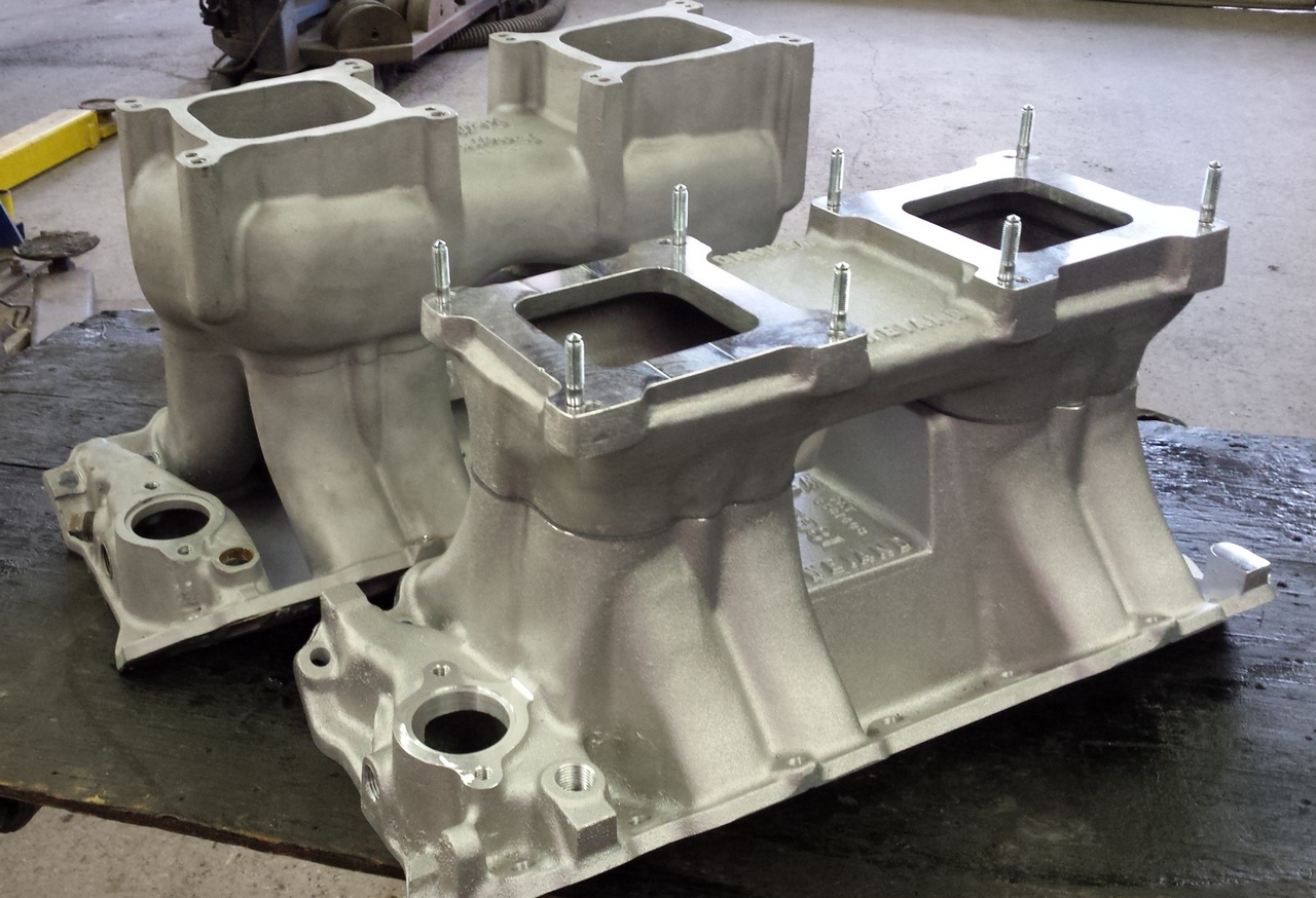

    The new Weiand manifold arrived today. Not quite as ***y as the old Edelbrock, but everything fits under the scoop and it will probably be better mannered on the street. And usually the only time my hood is open is when I checking the fluids.
