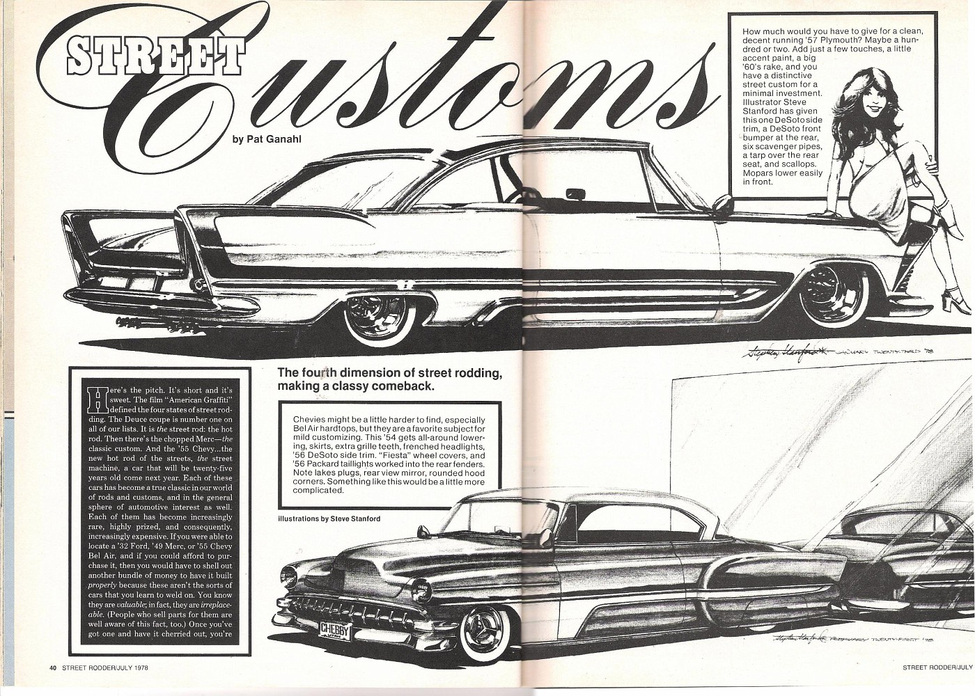

    Just a suggestion, I've been wishing for someone to build a '57 Plymouth like the one in this Steve Stanford illustration for a long time. A De Soto would be just a as good!
    Image courtesy Rik Hoving's amazing photo archive.

    Phillips: I have a friend in Houston that has a '57 Chrysler New Yorker two door hardtop and he has been thinking something similar, but with a chopped top. Not sure if or when it will happen, but I sure hope he does.
