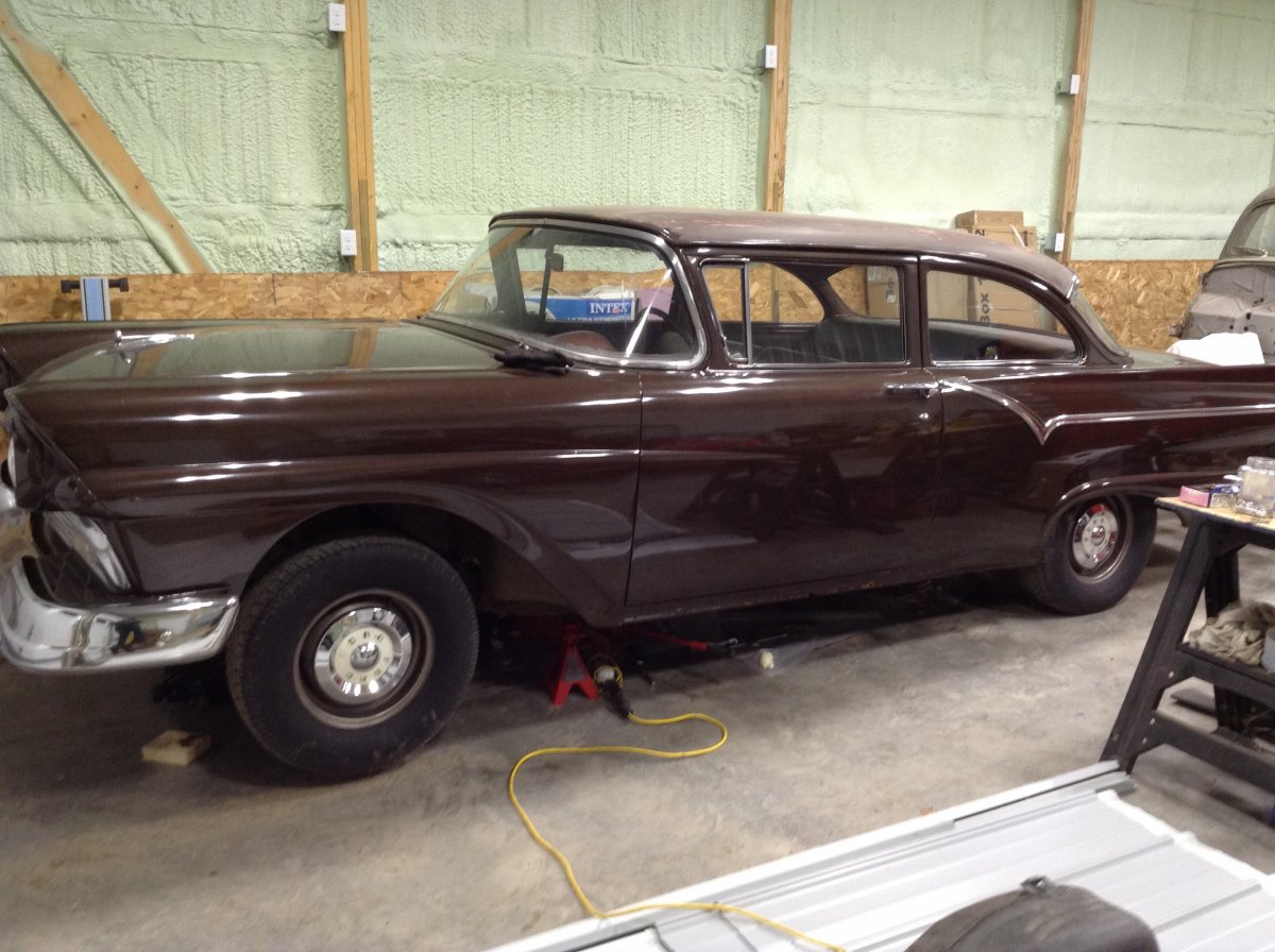

    Hi guys it's been awhile but I recently picked up a 1957 ford custom with a bad vibration. I'm not a ****** guy but ,The vibration is coming from the ****** tail bushing. I have unbolted the tailshaft, speedo cable, driveshaft and crossmember but cannot seperate the tail housing. I'm ***uming the shaft itself is connected ? What do I need to do to seperate it? Anyone have an idea? Thnx for your time. image.jpg

    Sorry I didn't reply sooner, thank you everyone but after reading all your suggestions I decided to remove the whole ******, especially after draining the fluid and seeing globs of **** coming out of it ! It is not an overdrive ......t85? The vibration was at about 35 mph and above. I will replace the u- joint too. My plan is to eventually put a V8 in with a top loader 3 or 4 speed. Since I have this trans out, do you know is there a top loader that will bolt right up? Will I need a different driveshaft? The V8 will come later, money is tight. I just want to drive this damn car right now. Thanx guys!

    Thanx Crazy Steve, a little about the car, a friend lost storage and had too many projects so I bought it. Engine appears original ****** is not. Needs some minor patching on floor ,trunk,and rockers but over all solid. Doors, body mounts, frame all good! Interior redone recently...too much brown for me, I will be changing some of that. Just a cool car that I can drive while I'm restoring my 40. The car was originally baby blue. The car must have went to a state highway dept. because they painted it Snowplow orange (snowbirds know what color that is) finally it was painted brown. I've been told these things have 9 inches rear ends? Looking forward to going to back to the 50s here in Mn.

    I really like that particular Model 57 Ford, and I'm a Chevrolet guy (who appreciates all cars). Nice color too. T-85 3 speed with overdrive would be on my shopping list. I am Butch/56sedandelivery.

    Thanx Butch, I've always been a chevy guy too but I keep finding these cool fords !
