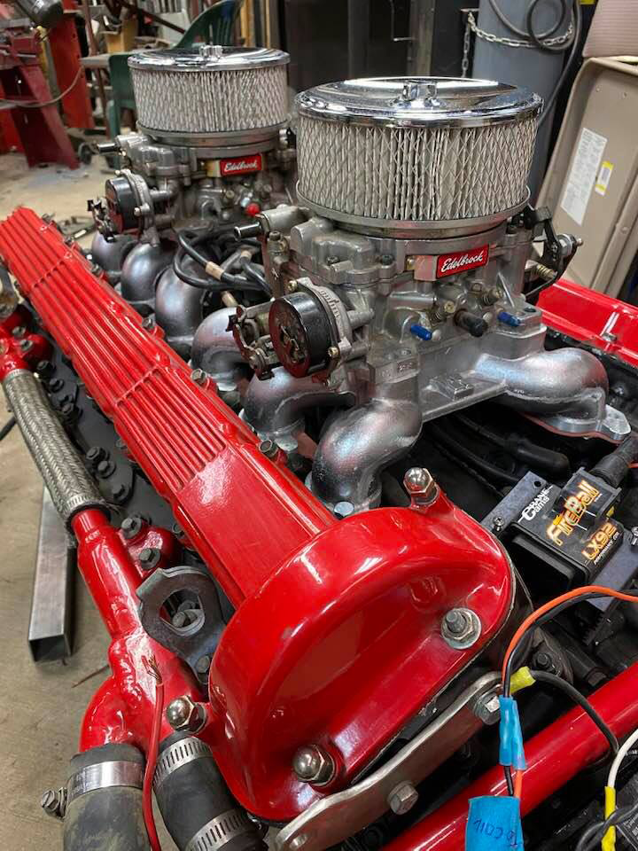

    did you make that intake??

    No they're made by a small outfit called Affinity Imports. 850 for the pair. Not bad for such a niche part just for weird maniacs like me.
    I have done foundry work in the past, and I did draw up CAD for some manifolds more alike to the stock ones, not unlike the mopar crossram manifolds. But these make life a lot easier.
    Theoretically you could saw off the throttle body from the stock v12 manifolds and TIG a squarebore plenum/airbox onto it without much trouble. And it'd work quite well, since the stock manifolds are actually pretty good. But i don't know how to TIG weld so whatever.

    thanks!--that IS niche! ,,,and nice!
