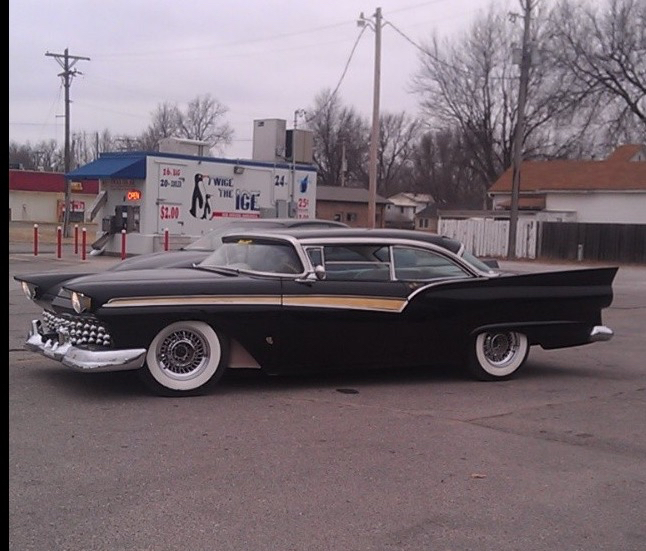

    Enlarge the photos of Kotton Kandy built by Jeff Myers and study the rear window. It was sunken down into body . It looks stock , the shortened trim covers the gap . The package tray hides the work done inside.

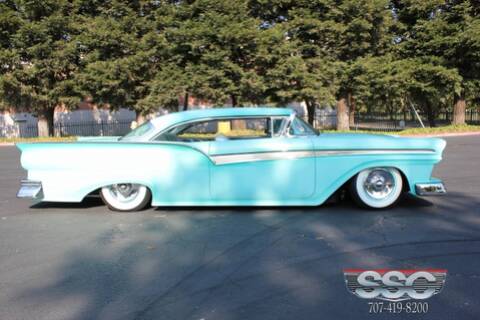

    In terms of chopped 57 Fords, there are two main examples I can think of. The first is the late Jeff Myer's "Cotton Candy" that has been previously posted here.
    It may be an unpopular opinion, but I was never particularly fond of the styling on this car. The exaggerated headlight brows aside, I just don't think the chop lines work well. It's cut too steep in the front and because of it, has a crown at the back of the roof. The roof line is more of an arch, as opposed to a gentle sweep.
    On the other hand, Richard Zocchi is one of the very few who got the lines right with this stunner.
    Here it either looks like the front is not cut quite as much, or the rear gl*** is laid down further. But either way, the chop flows from front to back and looks absolutely dynamite.
    Of course, in both cases, the substrate for the build is a 2 door hardtop, Fairlane body with the long wheelbase. In terms of building a custom, that's the name of the game. Long, and low.

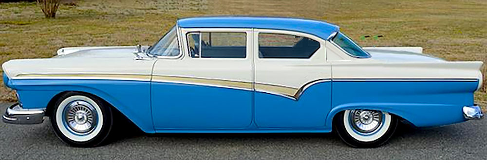

    Again, the OP has the least desirable of all body styles, the 4 door sedan. Chopping a sedan comes with a whole host of other issues aside from the curved gl***. The roof has to drop vertically to keep the B pillar straight, then the roof has to drop abruptly. A hardtop doesn't have to come down vertically, because there is no B pillar to concern yourself with. The roof can angle back and flow better. At the opposite end of the spectrum is the OP's sedan, that has technically 4 pillars, not just 2. The result will end up looking squashed, as opposed to looking fast and sleek.
    In sum, my suggestion is to forego this foolhardy venture. Get the car on the road, make it run and drive, maybe have some fun doing mild custom modifications and cool custom paint. But I would strongly discourage any chopping of the car. It's a fast track to it becoming a parts car.
