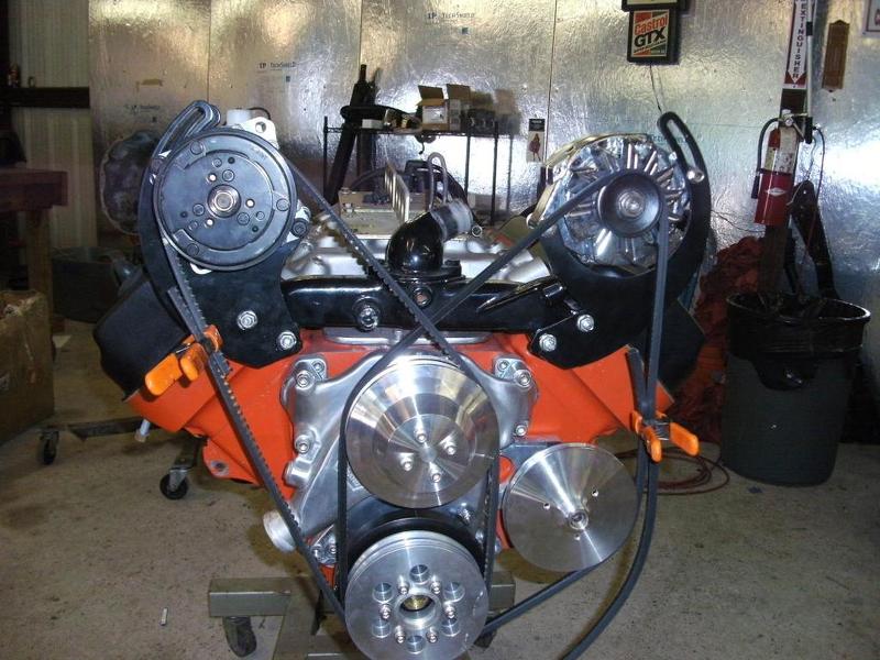

    I like your set-up. That mini alternator is sweet. I have 10" from the center of the crank bolt to the frame rail. I could possibly modify the Hot Heads lower bracket to fit one of those alternators.
    Thanks for pointing this out. I'll look in to this a little more.

    I know I've seen brackets that mount the Alternator low like that I thought hot heads sold em

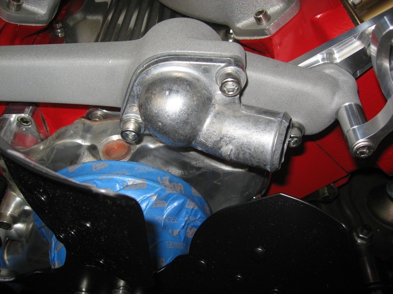

    Just tried using the original water crossover. The old generator tab would need to be cut off and even then a bolt on the alt bracket seems to be in the way.
    Trying to make off the shelf parts work has proven to be quite a challenge. I've been trying to avoid it by may have to go to this piece from Hot Heads. I think this will do the trick I just don't care for the looks of it.

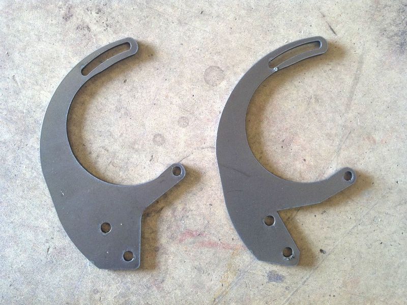

    I'll take a look and see if that's possible. I did order another alternator bracket today. This mounts up high, in the middle, or down low.
    Here's what it looks like mounted.

    Hose routing is more difficult with the stock crossover. I had it mounted on there yesterday. I could use it if necessary but with the stock or the cast Hot Heads crossovers there are interference issues.
    With the stock piece I would have to run the hose over the fan or near the belt and the hose would need to be longer. Not usually a problem but I don't want any flex in to the fan or belt areas.
    The Hot Heads piece would allow for a very short hose and if I can mount it on the passenger side it the upper hose will be away from the fan. It would look much cleaner too.
    I'll get some more pictures when the new bracket comes in. Hoping it will be here Wednesday.
    Here are a few of the stock crossover. I'd need to grind off the generator tab on the bracket. The fan hits it. I'd also need to rework some of the bolts on the alt bracket as they hit the belt.
