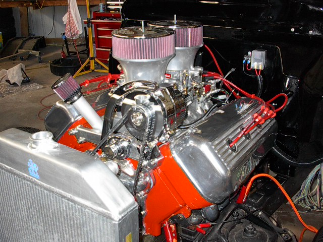

  9. 4tford
    Joined: Aug 27, 2005
    Posts: 1,824
    4tford
    My alt sits above the valve cover on drivers side it has a bracket that mounts to the intake on my 2x4 intake. and another bracket that mounts to the crossover. I've added pics.
  10. HuskyV8
    Joined: Apr 30, 2010
    Posts: 540
    HuskyV8
    Yours is in the spot mine needs to be in. Thanks for the photos.
