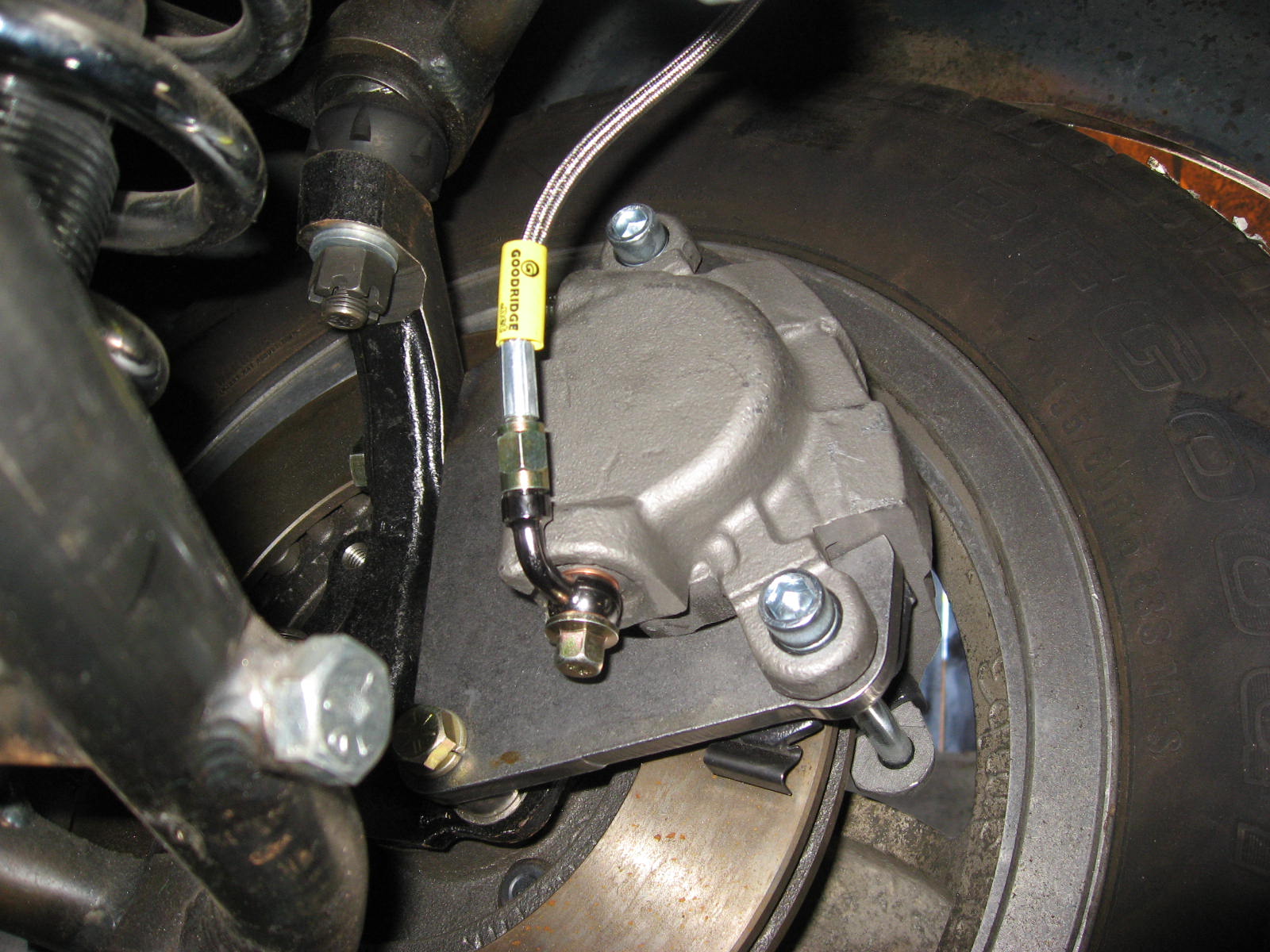

    It's been a while but we've made some significant progress. The brakes and clutch are all plumbed and almost done. Only thing that isn't done is brake fluid and I won't do that yet since it has to come apart to do some sheet metal finish work paint the engine compartment. Here are a couple shots of the rear calipers hooked up

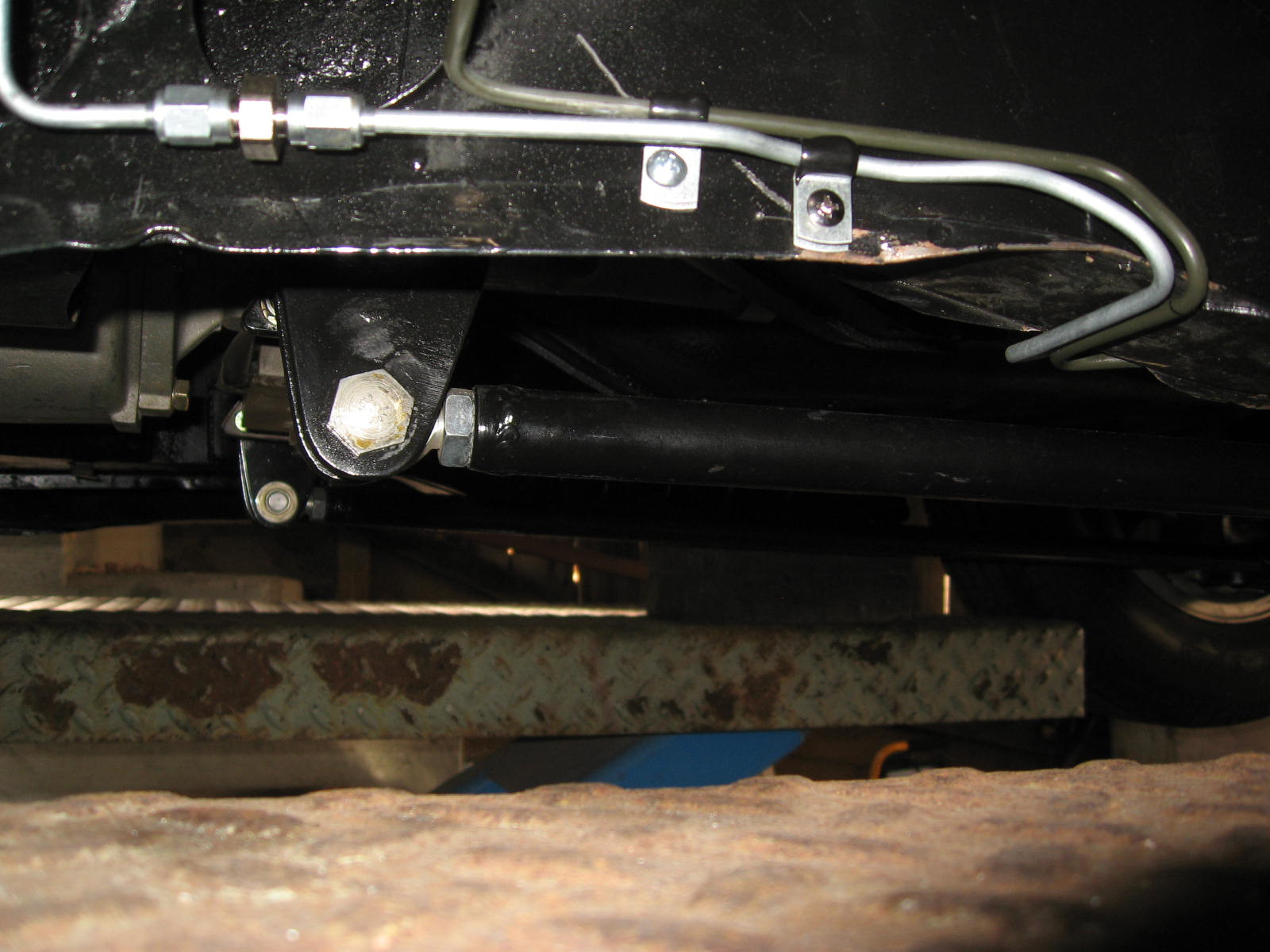

    Here are some shots of the plumbing.
    Where these lines cross the frame we have since added a steel plate to cover and protect them.....just in case.
    The bolts on the tab were temporary and have since been replaced by welding in the tabs. Note the residual valve since the master cylinder is lower than the calipers.

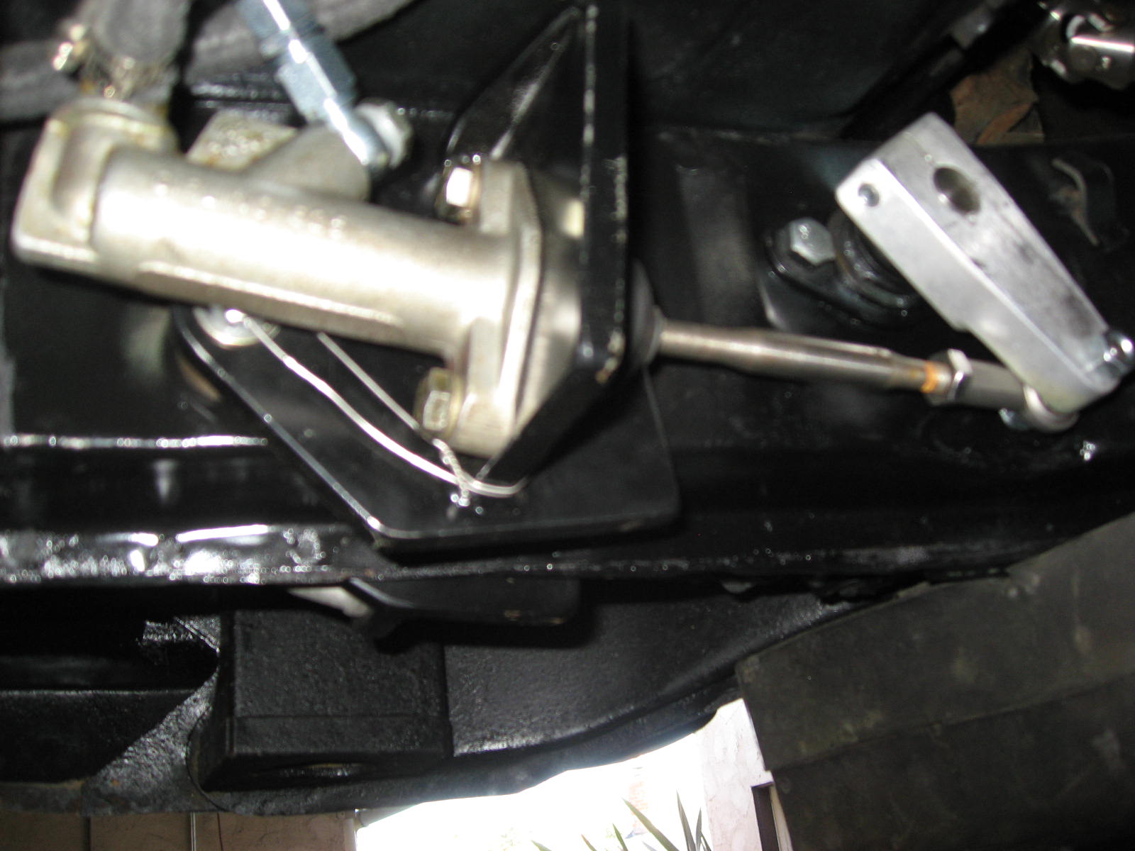

    Here are some shots of the clutch master. The car originally had a mechanical clutch. All of this was mocked up on a "dummy" frame that I had cut out of another junk Husky which was detailed on a previous post.
    We built a little cover for where the lines go in to the ******. I didn't want a loose line coming out where the bleed line goes. Now bleeding the clutch can be a 1 handed operation.

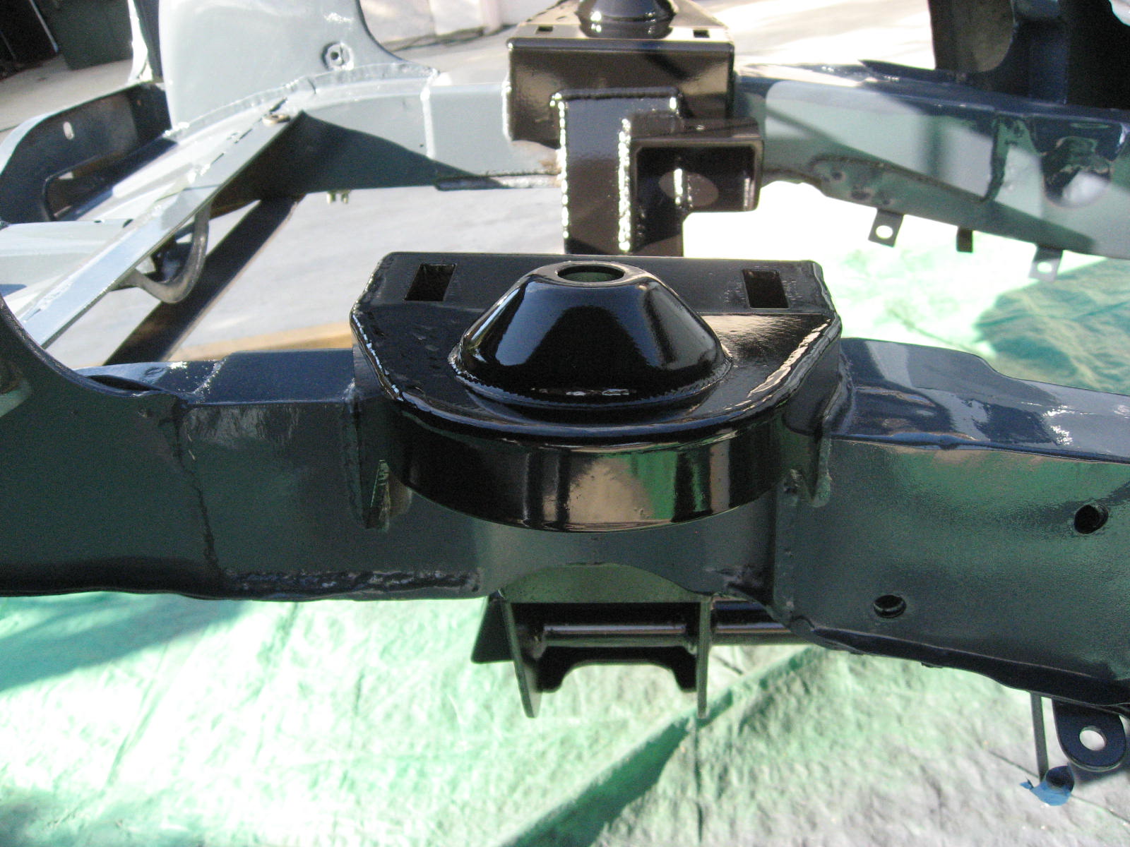

    I took all the control arms and steering out so they could get paint. Going to go with black. A friend helped with all the finish work in the engine compartment.

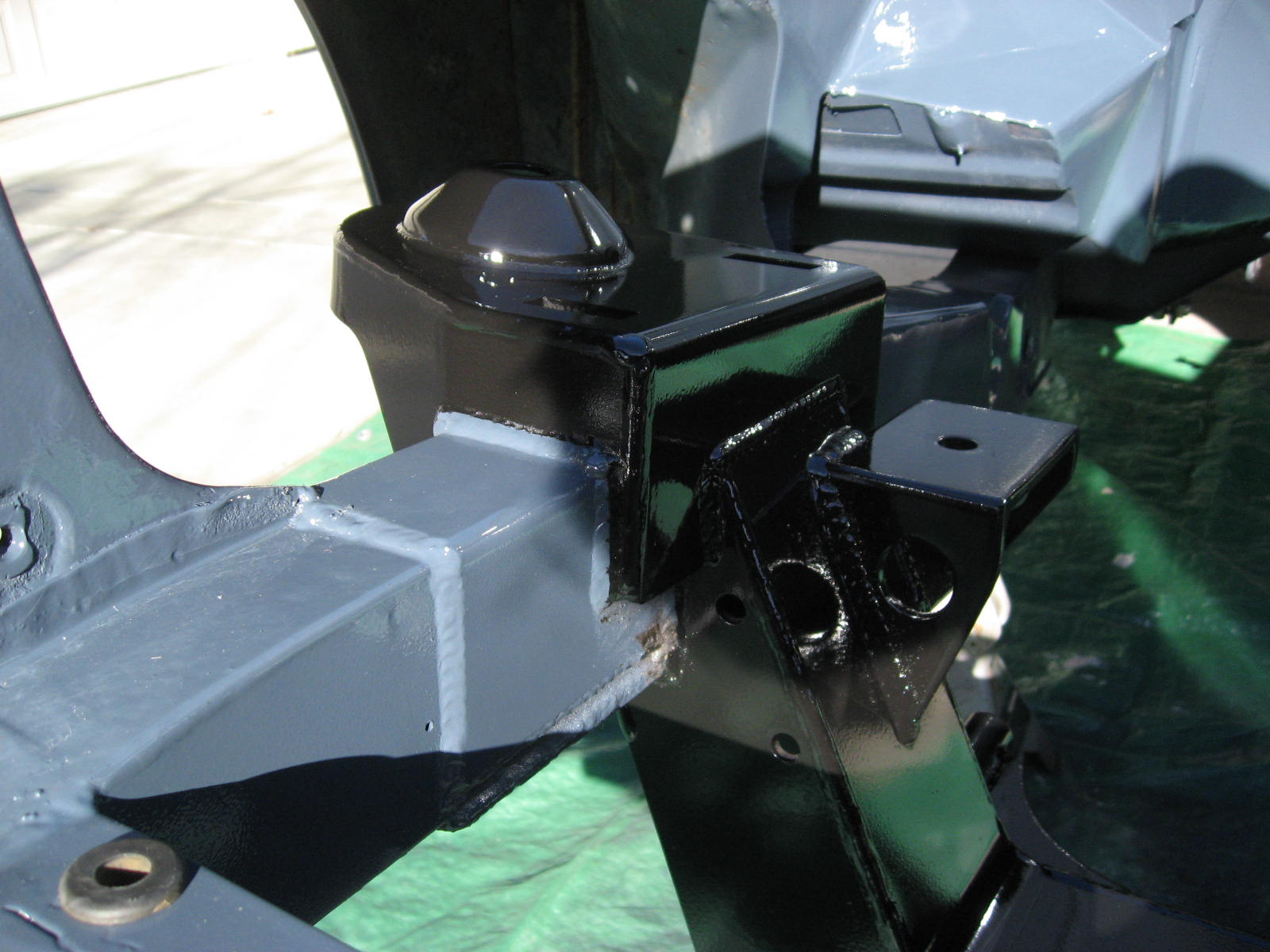

    After the blue dried I painted the cross member black. You can see how the fender wells are cleaned up. My buddy Dave put a flange on that edge using a hammer and a dolly. It came out great. Thanks Dave!

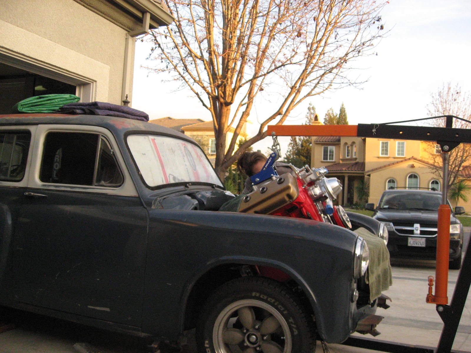

    Here is the motor going back in. Had SWMBO helping make sure the engine didn't damage any of the fresh paint. My 6 year old manned the camera. Took some good shots.
