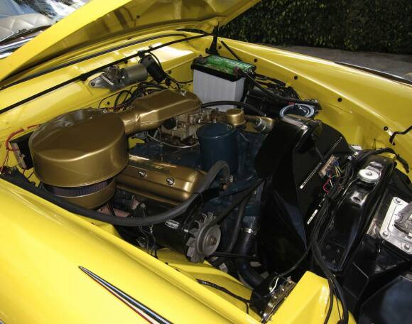

    Here are some shots of the fuel system. Air cleaner may or may not be used. I may powder coat it to match the valve covers.
    Fuel lines are all stainless....not polished yet but will probably add a little shine. Rubber lines are teflon lined to resist PTFE (bad gas).
    This shows the dropped base air cleaner. I'll use this filter and base but am deciding which lid to use. I'd like to find an old Golden Commando lid.....that would look just right in there.

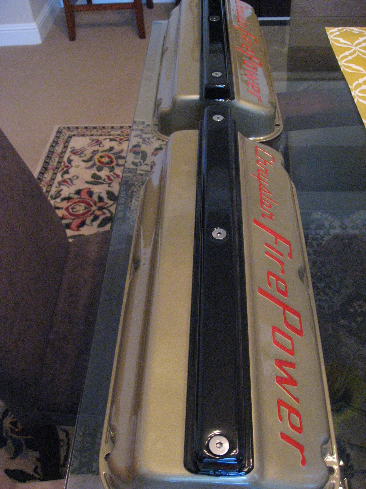

    Here are some shots of the valve covers. I'll put them on when it's time to prime the motor.
    They turned out pretty nice......not perfect but perfect for this car.
    covers were gold powder coated and then lettered by Real Ralph. Then they were cleared for a little protection and shine. Check out those screws holing down the spark plug covers. Good ole Bob Smith made those for me.
    The wife has not yet asked why they are getting stored on the dining room table.

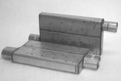

    I'm lining up parts for the exhaust. Here's a question for you hemi guys......I'm using stock exhaust manifolds which have an outlet just a little less than 2". I'm ***uming that a pipe bigger than 2" buys me nothing since it is limited by the manifold outlet size.
    My plan was to use 2.5" pipes but out the back I may only have room for 2 1/4" or 2". I know I'll lose some power but I just may not have room out the back for anything bigger. I'm using Spin Tech mufflers and they have some cool oval tubing that may help.....but I'm still not sure if anything over 2" will buy me anything since the manifold outlet is less than 2".
    Mufflers are by SPINTECH....I've used these before and they work well and sound great.
    The case is only 2-1/4” thick, 9” wide by 16” long.
