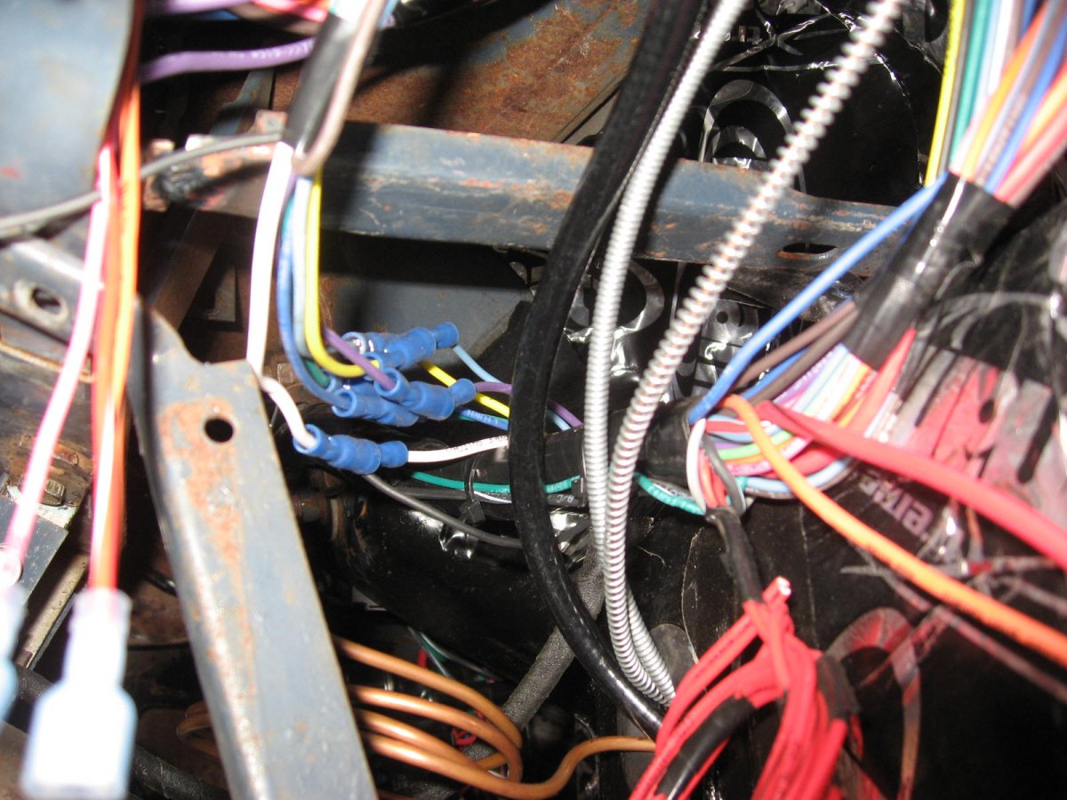

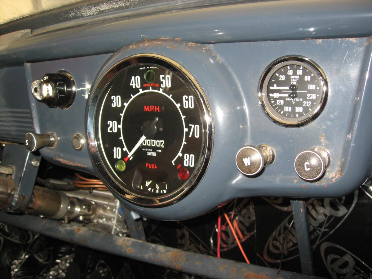

    Dash is now installed and wired up. Lights, turn signals, brake lights all work. Just need to chase a few more wiring issues and finish hooking up the power brakes, wipers, and horn. Shouldn't take too long though.
    Under the dash you can see the lower cubby box rail. This will hide most of the firewall and the steering box from view.

    You're right. Won't take too much time to get there. When the officer asks "do you know how fast you were going" I can answer 85 mph with a straight face.
    On a side note....the speedo didn't work at first. It's an NOS unit and was gummed up. Put just a little PP (I don't call it PB) Blaster in where the cable goes in and then hooked it up to my drill in reverse. Now it feels free and turns easily. Sad to say my drill only goes up to 70 miles an hour though.
    When I'm further along I'll test the speedo in the car with a GPS and see how close it is. I think I've got a red 21 tooth in there now, but I'm sure I'll need a different one.

    Not to be overly critical and I'm not even sure if it will stay that way, but I'm not a fan of what the under dash area currently looks like.
    I know that there isn't a lot of room there, but it presently looks like a nightmare, a dogs breakfast sort of thing with m***es of wires and the coiled up tubing's don't look great either.

    I don't mind overly critical. You're right it is a dog's breakfast. This is a build thread so it's still in progress. It isn't done yet that's why wires are hanging down and not routed. Tubes, cables and wires are coiled up and need to get run to their end locations. We need to drill a hole in the firewall for the temp sender. The head is only about 2.5" away from the firewall so the sender hole needs to be drilled directly behind where it will mount in the back of the head. We need to find the cleanest way to route it....same with the oil line and choke cable as they are not hooked up either. It will all be clean when it's done. If you look at the engine photos it will be similar (although in there everything is hidden). Can't hide it under the dash but it will be nicely routed....and there is probably more room under there than it looks from the pictures. It's not too bad.

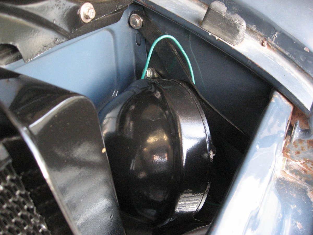

    Had a little time in the garage today. Nearly finished off the wiring harness. Got got the horn working and the brake power ***ist hooked up.
    This is the original horn ****on. It now works.
    There are two horns. One goes on each side of the radiator. One is a high note and one is a low note. Sounds pretty good for a small car.

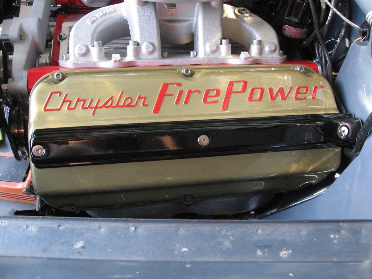

    Fun part was getting the finished valve covers on. They look pretty good in there.
    One other thing we did was to take off the fuel lines. Found out they were not compatible with fuel. Minor problem. Don't want the garage smelling any more like gas than it already does.
    Early on in this build I was going to use finned valve covers but I'm glad I kept the stock covers instead. They go better with the overall theme of the car. I like the clean look with the spark plug wires hidden. A big thank you to Bob Smith for machining the spark plug cover screws for me. One less thing for me to worry about.

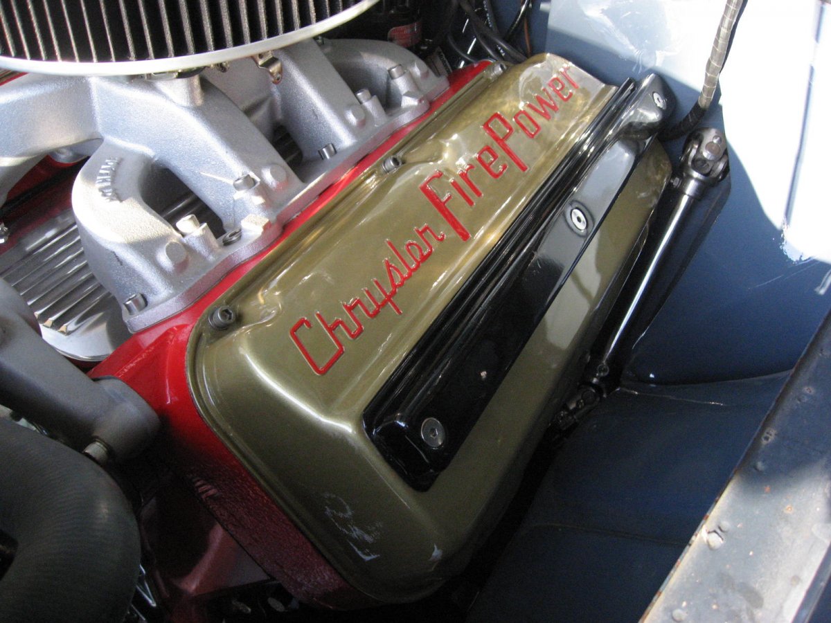

    Here are a few more engine shots. Not visible in the pictures but the choke cable needed shortening and is now hooked up.
    Fuel lines look like a trombone slide.
    People are always surprised when they see hemi in this car. Not because it's a hemi but because it doesn't look out of place or too crammed in there. This car is just about 12 feet long but the hemi fits right in.
    This is a temp air cleaner. The dropped base will stay on there but the top plate won't be used.

    Yeah, not a lot of doubt about what it is with those covers off. Forgot that it had adjustable push rods until I looked at the pictures again.
    Thanks for the best of luck wishes. We're getting close to firing for the first time. Just need to make the new flexible fuel lines and then fill it with gas, oil, and coolant and turn the key! Hopefully soon. I've said that before but this time it really is close.
