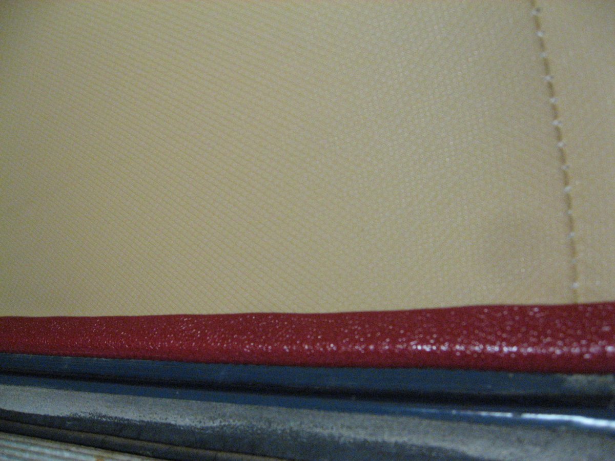

    A few more shots with it closer to being done.
    Furflex piping is dark red. I chose to use vinyl instead of the cloth type that was original.
    Most of these cars just had a visor on the driver's side but you could get an optional visor on the p***enger side too. Visors were always white even though headliners were tan.
    Didn't have good lighting for photos but the headliner came out very nice. No wrinkles and it looks nice and tight.
