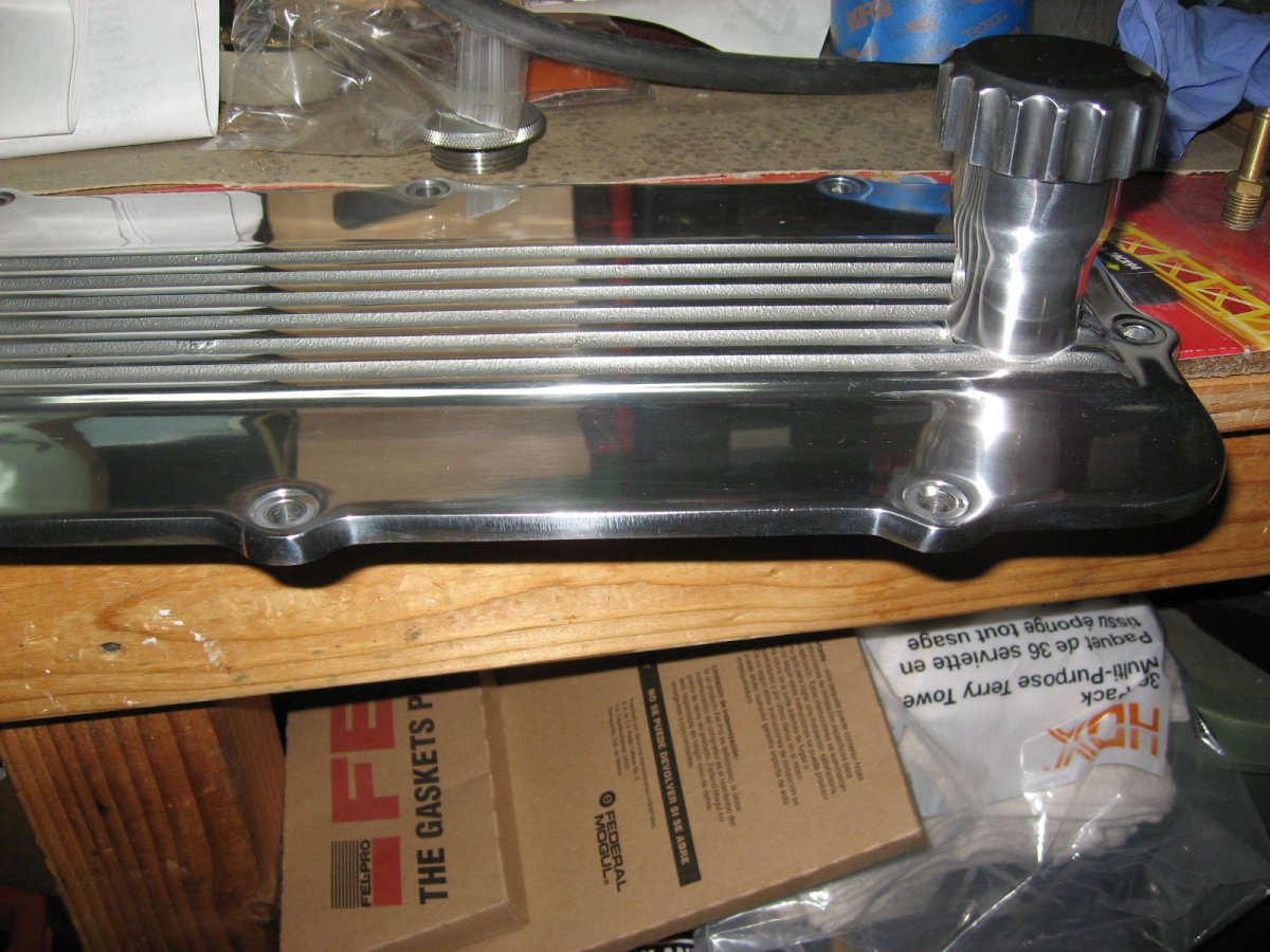

    I'm going to add an oil fill tube and cap. This one is a good match to the finned valley cover. I'll change the connector to a 3/8" barb and will pull in air from the air cleaner for the fresh air intake for the PCV system.

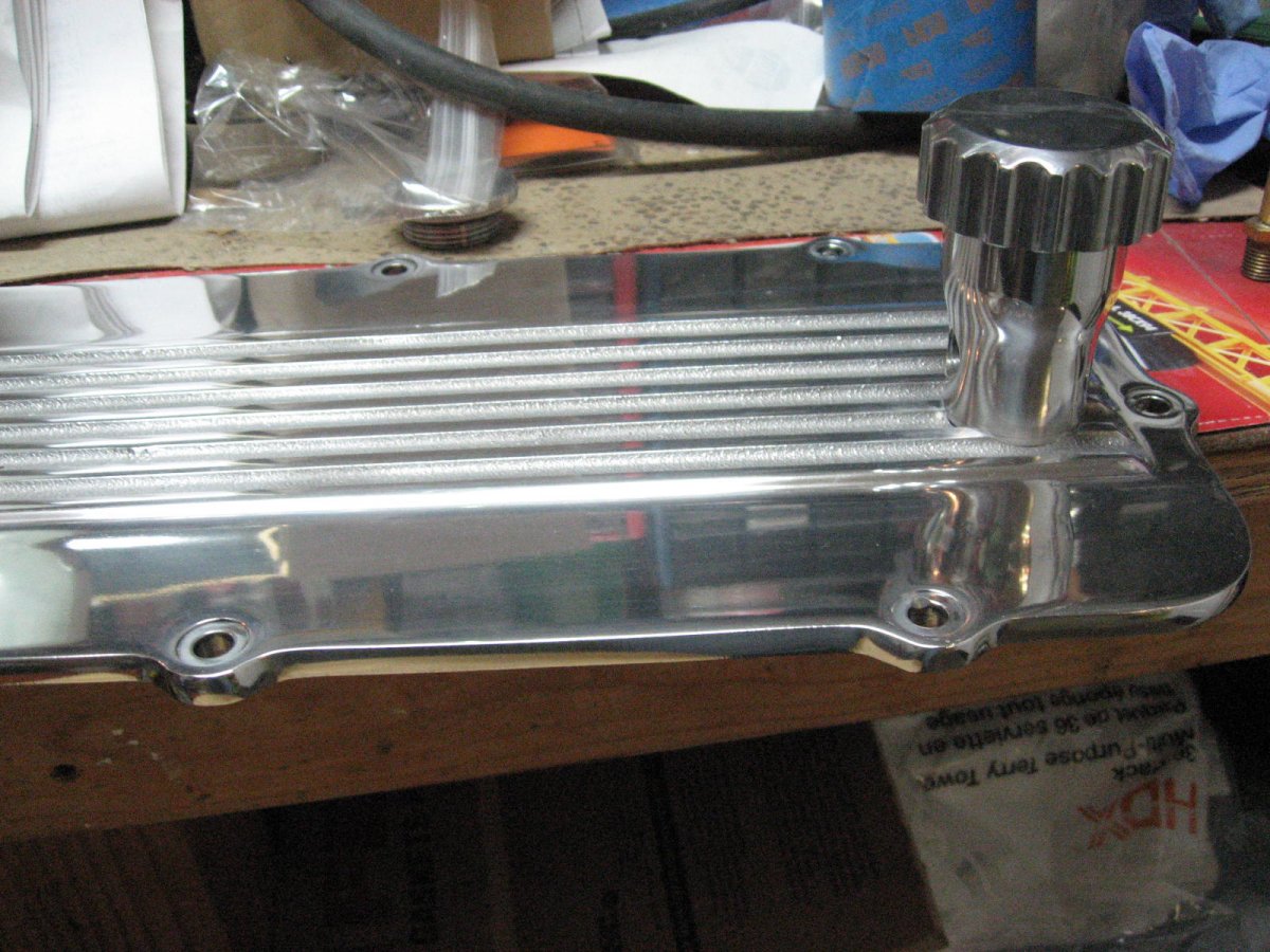

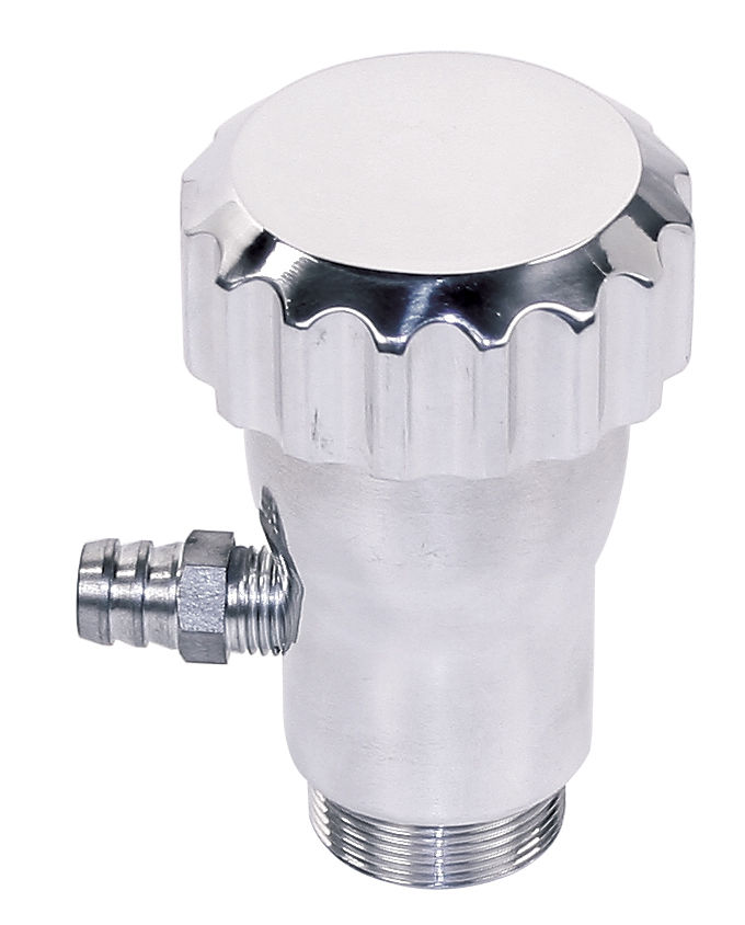

    Here's the oil fill tube pressed in to place. Hopefully it won't come loose. Used red Loc***e when pressing it in. The back of the tube will have a 3/8 barb so I can attach a fresh air inlet from the air filter. Not sure if I'll use a hose or some leftover 3/8" stainless fuel line.
    I think the fill tube and cap are a great match. Hard to believe they came from an off topic foreign car.
    Can you guess what this oil fill tube was intended for? If I were really nuts I would blast the valleys of the cap and polish the fins and then it would perfectly match the valley cover. Maybe another time.
    The PCV will go in the oil fill cap at the back. Need to figure out a baffle so it doesn't pull oil up through the PCV.

  9. milwscruffy
    Joined: Aug 29, 2006
    Posts: 4,176
    milwscruffy
    Who makes the valley cover ?
  10. HuskyV8
    Joined: Apr 30, 2010
    Posts: 540
    HuskyV8
    The valley cover is a Hot Heads polished piece. They make a front fill and a rear fill. The rear fill is really tough to get to so I added the filler on the front. Will convert the cap at the rear to take the PCV valve.
    milwscruffy likes this.

    Looks very good. So tell us what from is that oil fill tube :)
  12. HuskyV8
    Posts: 540
    HuskyV8
    It's from a VW Beetle. It's EMPI 7902 and was under $25 and that includes shipping. Sometimes it's nice to not have to re-invent the wheel. Almost everything else on this car has required that so in this case it was welcome to not have to.

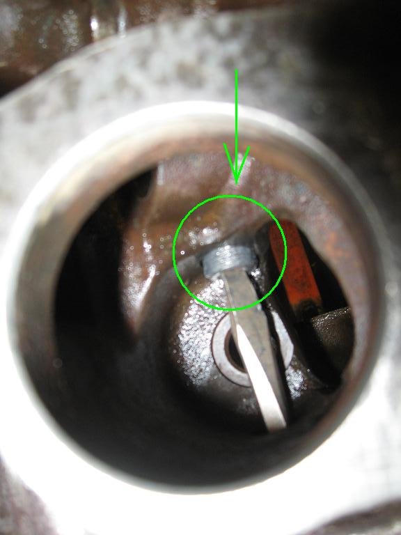

    Got it all ****oned up this weekend and fired it up again. Same results as before. Runs at 55 psi oil pressure unless you bring the RPM's down to 1,100 and then it's around 10 psi. Go below 1,000 RPM's and it dips below 10 psi but immediate back to 55 if you hit the throttle.
    That night I went looking for answers (online) and figured I had a piece of crud in a rocker shaft or a missing galley plug. First light of day I was out there yanking the distributor to check that galley plug. It's got to be that right? Bingo! No galley plug. Now I've got to figure out how to install it through the distributor hole. The firewall overhangs the distributor so I'll need a mirror to see down in there and some specialized creative tools.
    Has anyone ever done this and if so how did you do it? Really interested in what kind of tools were used.

    Posts: 22,380
    Husky
    Don't you just hate this kind of s#/t!
    If it's any consolation, someone else on the HAMB was faced with this very issue on his Hemi, wish I could remember the sitch, maybe a Google/HAMB search will hook you up.
    Sounds like once you get this rectified, you will be terrorizing the streets of Morgan Hill.
    Test drive video please.

    Now you don't want to hear this part, take the Engine out and do it properly.
    That Hemi deserves all the love you can give it, you will either drop it in the engine (pan has to come off) or worse yet cross thread the plug after hours of Fu%&in around with it. After all the work you have done on this Car it is not that big of deal.
    Best of luck with it! :)

    Yeah, totally ****s.
    I remember those threads when I first started looking for answers a couple months ago. There were a few that ran in to this and solved without tearing apart.
    I'll keep looking.

    I'm up for a challenge so will avoid pulling the motor for now. I have a right angle screw driver with a 1/4" socket that fits the plug. Also have a small ratcheting wrench I might try. I'll have some kind of dam in there so it cant drop down.
    Can also pull the valley pan to get a little closer. I think I could do it through there.
    Keep your fingers crossed. The cross threading aspect is the worst of it for me (knock on wood).

    Here's a couple of threads I found on that missing plug ...
    http://www.jalopyjournal.com/forum/threads/close-call-on-my-hemi-rebuild.399915/
    http://www.jalopyjournal.com/forum/threads/392-hemi-oil-galley-plug-need-help.785244/
    Post 4 of the second thread has the money quote ...
    "Tried every tool in the book, plus bubble-gum to put the plug in through the distributor hole. After a day I surrendered and popped the intake and valley cover off, and was done in 3 minutes. Just had to buy another set of intake gaskets."
    Good luck!

    Thanks SimonSez. I was just out looking at it. I cut down a water bottle so that will be the dam/container in case something falls off. Seems like it will work well. I don't have a 3/8" NPT plug handy....otherwise I might try it.

    Husky
    If you do try the up-top plug installation approach; it probably will be difficult to get it tight, not really a leakage issue, but a dab of Loc***e "small screw" threadlocker should retain it in the absence of wrenching space, won't take much.

    Good advice Denny. I'll put some Loc***e on there.
    [/QUOTE]
    Great advice, I can't see how this can hurt at all.
    Any way to try to get the oil off the area before trying to get the plug in?
    A little shot of Brake Klene?

    I took a pipe cleaner to it last night. Bent it in to an "L" shape and soaked it in lacquer thinner. I think I got it pretty clean.

    The usual trick is to drill a .050 hole in that plug to help oil the cam/dizzy gears.
