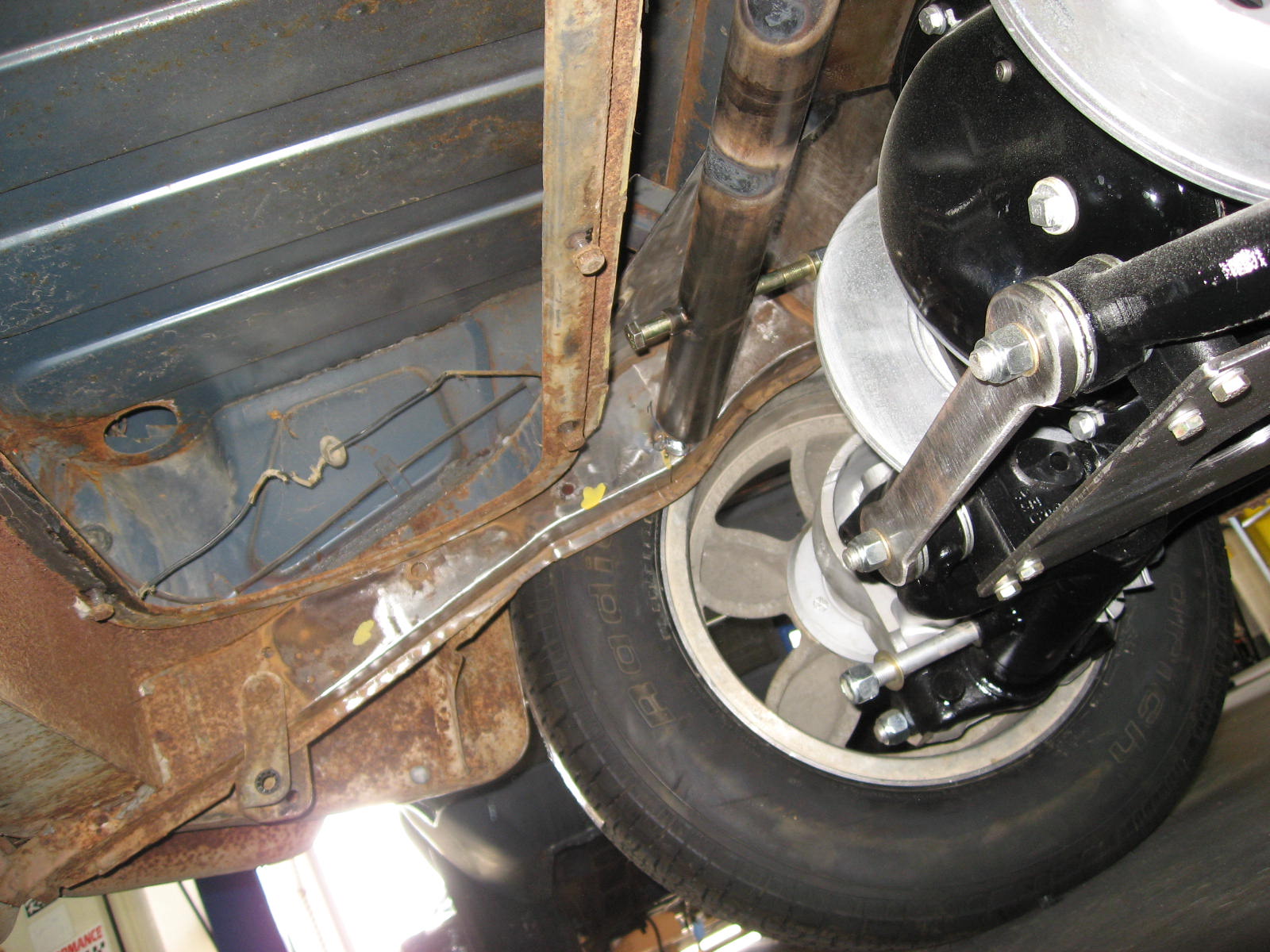

    This is the finished placement of the IRS. Also some shots of the radius rods. The radius rod mounts double as the rear transmission mount. Three bolts on each side hold the transmission cross member in place for easy removal.

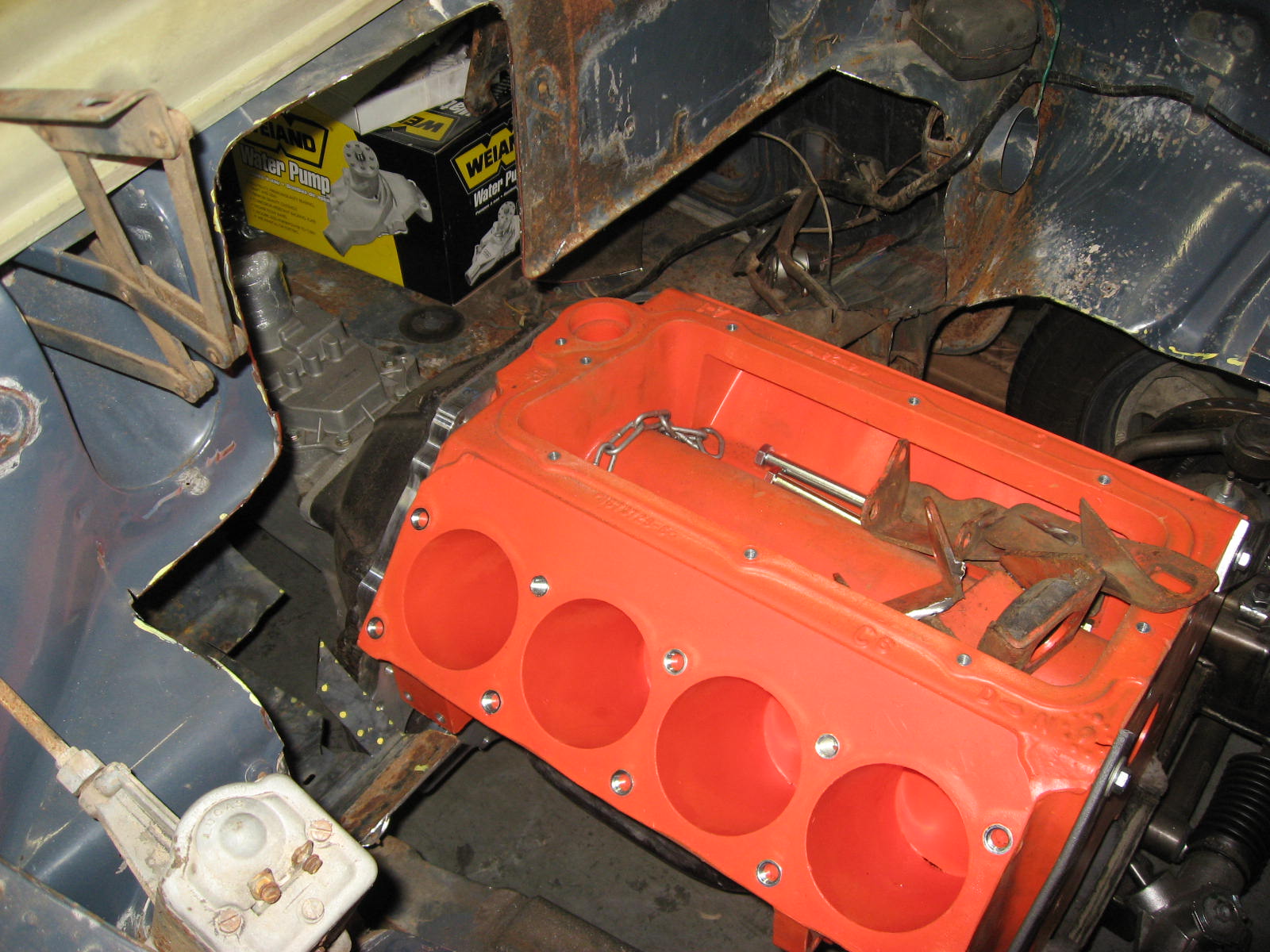

    With the firewall and transmission tunnel roughed in it was time to put the plastic 392 back in to check the fit.
    The white you see is a styrofoam mock up of a radiator used to make a real radiator for my 302 Husky. It looks like it would almost work in this car too.
    In these pictures I've gone to a Chevy water pump. This is about two inches shorter than the Chrysler original water pump. It's starting to look like the radiator will be able to remain close to it's original location.
    IMG_9851.jpg IMG_9852.jpg IMG_9853.jpg IMG_9876.jpg IMG_9877.jpg IMG_9878.jpg IMG_9879.jpg IMG_9851.jpg IMG_9852.jpg IMG_9853.jpg IMG_9876.jpg IMG_9877.jpg IMG_9878.jpg IMG_9879.jpg

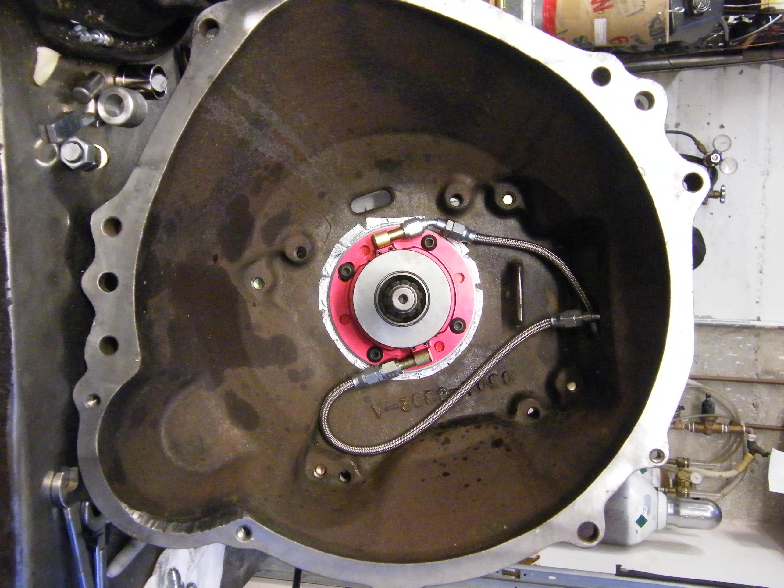

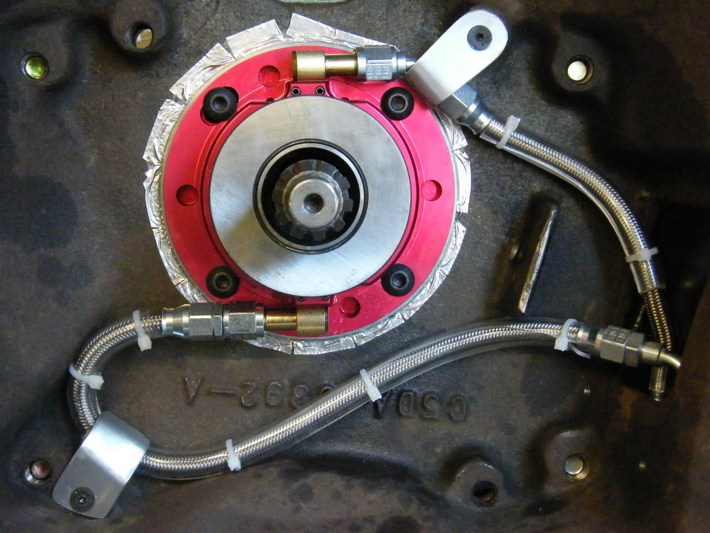

    Wilcap told me I'd need a slip on style hydraulic throw out bearing but after measuring it I found it wouldn't work. I returned it and got a bolt on style. I had a friend (Tom Hall) way more experienced than me dial it all in. Needed some offset pins to get the bellhousing aligned but it all looks good now. Bleeding the clutch should be a one handed operation since the lines are mounted solid. We had to mount the fittings as close as possible to the bellhousing to avoid hitting the transmission tunnel sheet metal. I think it will work fine.
    Bell hole taped.jpg TO Bearing installed.jpg Preliminary Assy.jpg Overall Assy.jpg Final Assembly.jpg Detail Fitting Box.jpg Clutch fittings, bottom front.JPG Clutch fittings side view.JPG
