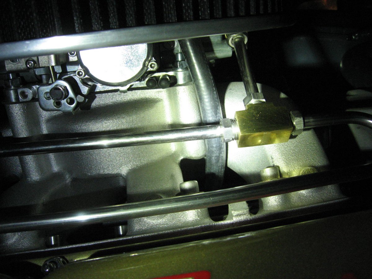

    Here's a shot of the extra oil pressure gauge. So there's this one and one in the dash. The one in the dash is off a bit.....showed 40 while the one on the engine showed 50.
    I may bring it up a tad higher and do a 45 degree fitting on it so it's a little easier to see. Might just leave it the way it is.

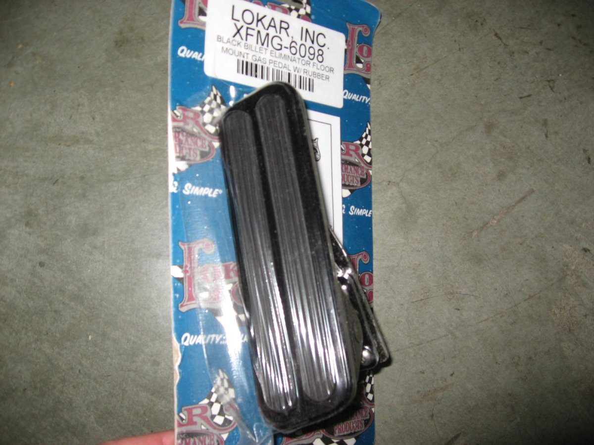

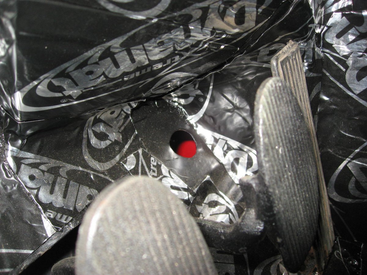

    Tomorrow hope to get to work on a gas pedal. The original one in there now hits the firewall. Might be able to move it down a little if not I'll go with a Lokar Midnight Series pedal.
    Even with the big hemi in there we managed to keep the clutch and brake pedals nearly in their stock location except they sit about an inch lower. Pedal ratio on the clutch is 4:1 which is what the McLeod hydraulic throw out bearing and ABS Brake ***ist called for. There was little to no room to move the pedals to the left to create space for the gas pedal. Thought about turning the tops 90 degrees sideways but figured if it was good enough for stock it would work work for me.
    This set-up requires a narrow shoe. The shoes I'm wearing now are too wide and make it tough to use the gas pedal where it is. Will have less room when carpet is added so will probably move the location of the gas pedal a little. In this picture you can see there is room to move it down some.
    It's hard to tell but the gas pedal is just barely hitting the firewall where we had to open it up for the hemi heads. You can see the old hole where the pedal linkage used to go through.
    I'll probably end up using this Lokar pedal since it's already set-up for a cable. This pedal is 2"x7" and the original pedal was 1.5"x7.
    In addition to the cable and pedal I got extra spacers for the pedal in case I need to tweak the location.

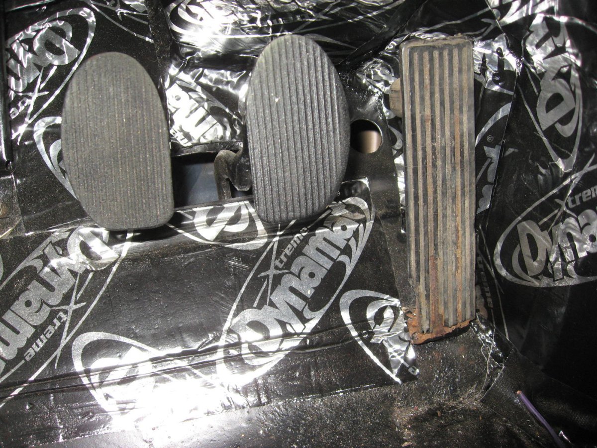

    Is there any space to the left of the clutch pedal, if you moved the sheet metal? An extra inch of width right there might be very nice to have.
  24. HuskyV8
    Joined: Apr 30, 2010
    Posts: 540
    HuskyV8

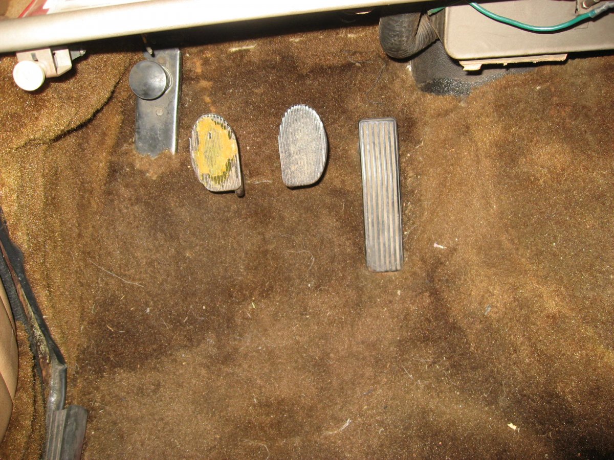

    No extra room. The clutch is all the way to the left already. There is a body brace directly net to the clutch pedal so I can't even bend the top of the pedal over.
    Pedal pads used to sit about an inch higher but we moved them a little to clear the firewall overhang.
    Pedal is less than 1/2" away from this floor brace.
    Here's a pedal set-up from one of my other Hillmans. This one is stock. You can see the brake and clutch pedals sit a little higher since they have not been modified. Same cramped set-up but there is a little more room to the right of the gas pedal. Other than that the two set-ups are nearly the same.

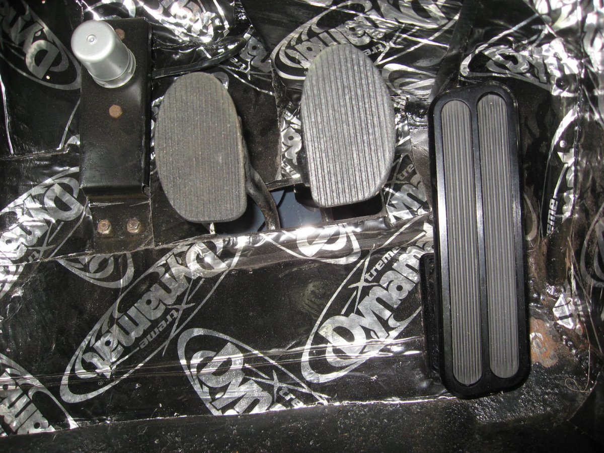

    Got the new pedal in today. Looks like it will work ok. Routed the cable up and to the carb without too much trouble. The gas pedal is just a little too close to the firewall though. The top doesn't have enough room to add carpet so I'll move he pedal down 1/2". Of course the base of the pedal can't move so we'll need to redrill the pedal itself to move it down.
    Going to find a way to also move the clutch and brake pedals to the left about 1/2" or so. Right now there just isn't quite enough room for the gas pedal.

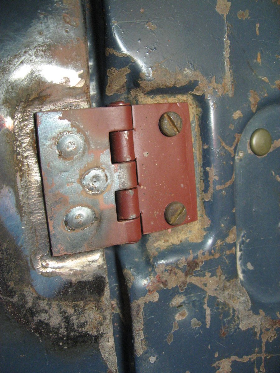

    Also worked on the rear seat back. We had to weld in some new hinges. The original hinges broke and then another owner brazed in another set.
    Hinges are a little offset. Thanks to my buddy Larry for fabbing these up and sending to me.
    May need to add a backing plate to the other side of the hinge on the body/floor side as this set-up is fairly weak. There's a little too much metal flex where the hinge attaches to the floor.

    Also got the gas pedal installed and functional. It's a little weird but seems to work ok.
    Gonna need small shoes for sure. My buddy with a 32 Ford says it will be fine and that the pedals on his car have even less room. So the gas pedal now sits 1/2" lower than it was before.

    That new throttle pedal matches up nicely with the oem pedals.
    It kinda resembles a two hole Anglia grill.
    Like you said; you may need to wear some Formula One driving shoes to fit those pedals.
