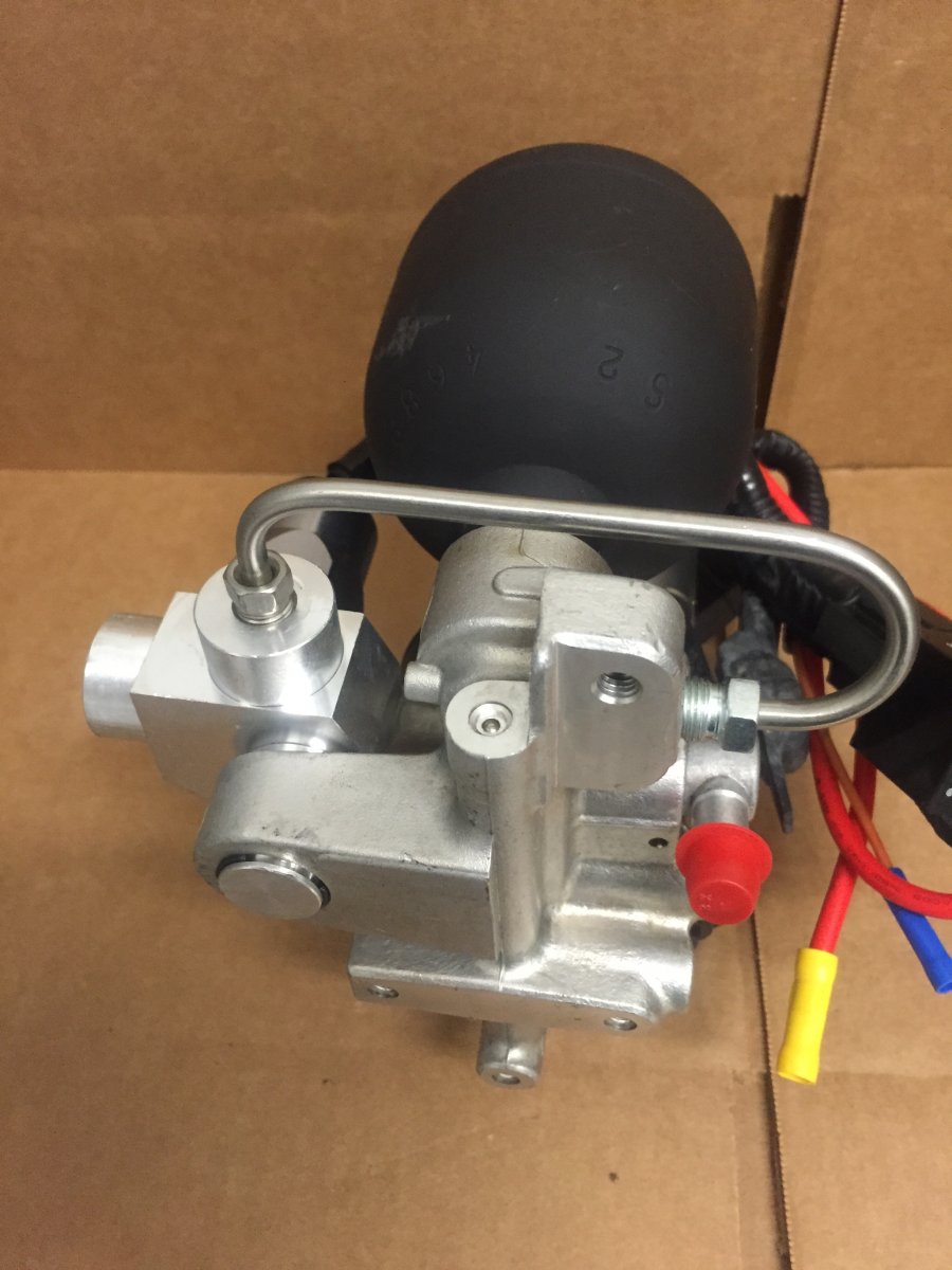

  9. HuskyV8
    Joined: Apr 30, 2010
    Posts: 540
    HuskyV8

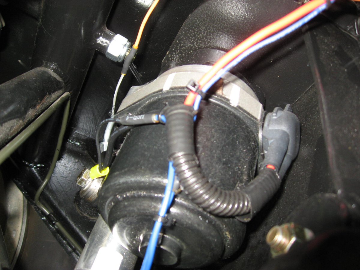

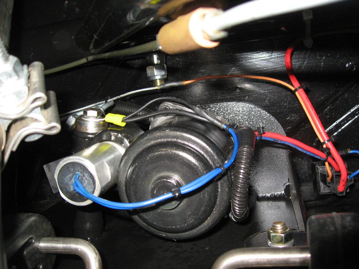

    Talking to the guys that sold me the electric brakes I decided to get their latest greatest version. They tell me it's much quieter than the older version I have. Seems like a no brainer since they are basically letting me do an exchange. I wanted to re do some of the brake lines anyway so this will be a good excuse to do it.
    This is the old pump. Had to make a special adapter for the ac***ulator. Not sure why we needed to do this. I think since it mounted sideways on the pump it would have hit the mounting plate. These pumps are a little louder than I'd like. Louder than a Holley fuel pump. That was a a big reason I went to an in tank fuel pump.
    You can just barely see the mounting plate we fabricated to mount the pump. The plate sits on rubber bushings but even with this it was a bit too loud. Hopefully I can get the pump and mounting plate off with the exhaust in place. Don't want to have to remove it. IMG_1542.JPG
    Design looks a little different but they tell me the ports are in "similar" locations. I think that means I should plan on redoing some brake lines.
    picture is upside down but I like that the ac***ulator faces down and not to the side like the previous version did.
    Red cap is where the line from the reservoir attaches.
    We have the option of locating the ac***ulator inline if we need to.
    kidcampbell71 and loudbang like this.

    Put the new brake ***ist in yesterday. The new pump is quieter. I like it. Sees to work too so on to the net project.
    The new pump mounted a little different so had to modify the mounting bracket and main mount. We put a layer of Dynamat on back to dampen a little more noise. The pump bracket mounts to the pump with rubber bushings and then the main plate also has rubber bushings to mount to the body. I don't think I'll be able to hear the pump above the engine noise. From my initial tests once the brakes reach pressure the pump comes on every 4-5 brake applications and then runs about 3-4 seconds to recharge.
    We're within a few inches of the exhaust but it's after the mufflers so hopefully won't be too hot. If it is I'll build a heat shield

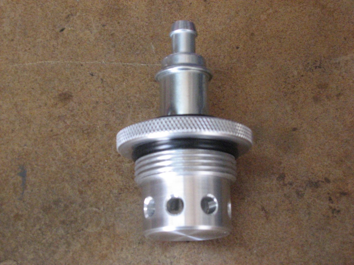

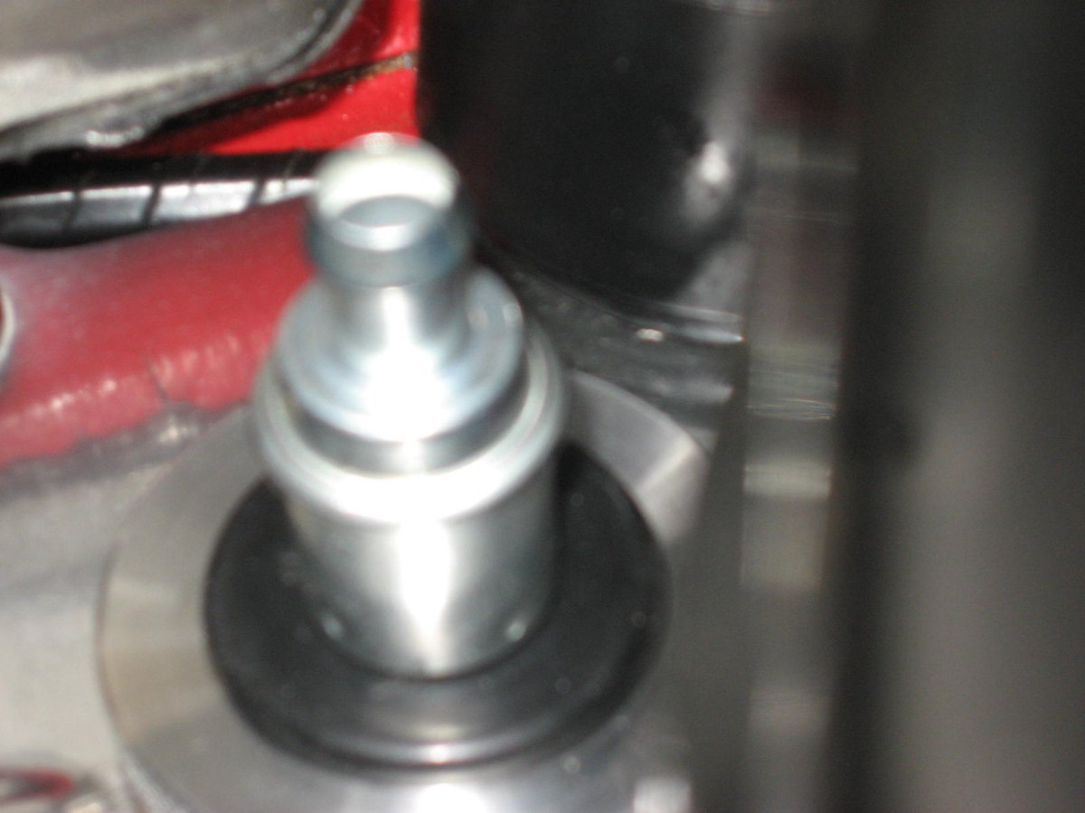

    So I made a list of big and small projects that the car needs. I'm going to try and cross off one item a day so it feels like progress is being made. Yesterday I cleaned up the door sill aluminum plates. Took about an hour so at least I accomplished something.
    Today I got the PCV valve set-up back from the machinist. It was no small feat but the oil fill cap was modified to take a grommet and PCV valve. It has a baffle on the bottom too so it won't **** up too much oil. The new oil feed is now on the front of the valley cover.
    The baffle on the bottom is pressed it. Looks like it's all one piece but it's not.
    It was not easy adding oil back here. Need to find a hose for this and then it's done.
    Here is the intake for the PCV system. It pulls filtered air from inside the air cleaner. This is a much easier spot to add oil too.

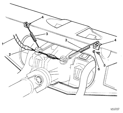

    I've searched the web and found little info on how to hook up the Jag emergency brakes so thought I'd post what I've found.
    Some of the earlier cars take this kind of set-up. I'm glad mine isn't one of them.
    This is how the rear end for my car started. This was just before I brought it down to Curt Hamilton. If you look closely you can see each ebrake lever has a little block on the end for the cable.
    When it came back it only had one of the blocks. The driver side arm would take a clevis....if the cable were coming from the p***enger side.
    This isn't my car but you can see the cable coming from the p***enger side. You can also see the springs that keep the ebrake pads from riding the discs.
    This was the picture that tied it all together for me. I now have the springs and spring tabs. On my car the cable will come from the other side. I will need to change out the driver's side arm for one that has the block on the end. Curt is sending me a replacement. Will be a major pain to change as there is very little room to see or feel what you are doing.
    This is the cable I'll probably end up using. I'll figure out the length needed and then send it down to Control Cables to have them swage an end on it.

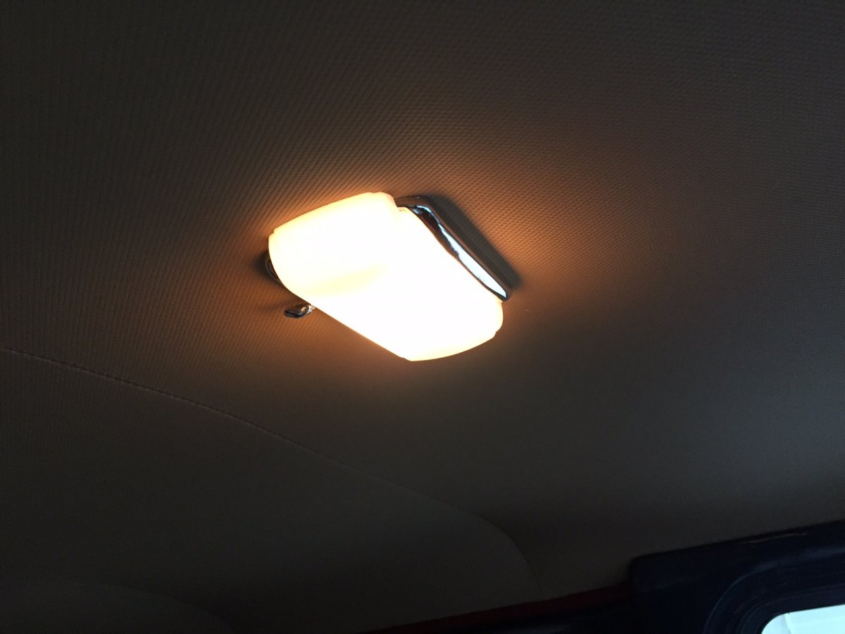

    Still trying to cross at least one thing off the to-do list per day. Yesterday I didn't have much time but was able to work on the dome light.
    Dome light was rebuilt by Larry. Saved me a bunch of time and headaches. Original fiber board that held the light was toast.
    Had been putting this one off for a while since I was scared to cut a hole in the headliner. Found a new lens on eBay.
    It works! These aren't connected to the door so it only comes on when you flick the switch on the back. One more task of the to-do list.
