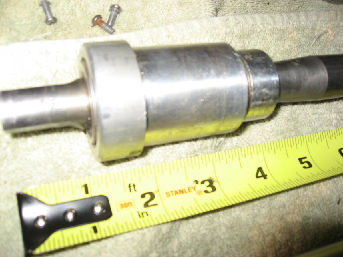

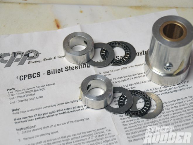

    Here's the steering column apart for new bearings and a lube. Shaft is only 16.5" long. We shortened the original Husky column and machined the bottom to 3/4' DD. The bottom bearing was an aftermarket piece from Classic Performance Products.
    This is the trick thrust washer bearing set-up from CPP.
    It's called The Steering Column Saver
    The top race and bearing balls were a little rusty so I wire wheeled the race surfaces and got a new set of 7/32" balls (insert jokes here).

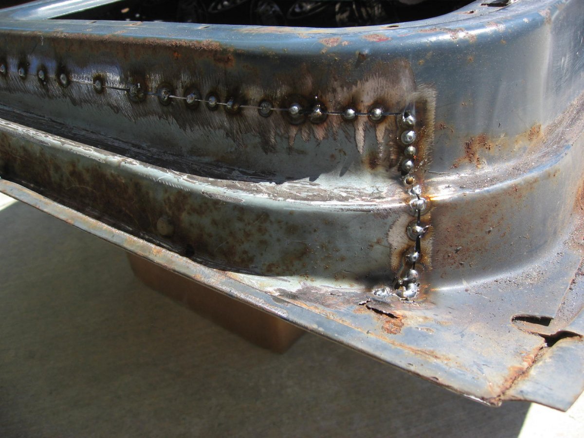

    Did a little metal repair on the driver's door. The bottom was rusted out so I could see daylight coming through.
    Luckily I still have the donor Husky and the door was solid on it. It provided a nice patch panel.
    Still has little rust on the repair piece but noting serious. Will grind away what you see in the picture and rust mort anything else.
    Ran out of time so will finish welding next weekend. Very pleased with the way it is turning out. All the windows are out for cleaning and all the window channels are also out to get new felt lining. Greased all the winders and latches too. Very smooth door closing now.

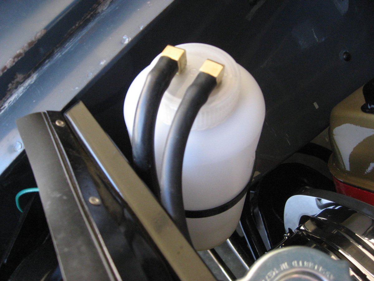

    Here's a coolant overflow tank I added this weekend. The radiator was burping just a little coolant several minutes after shut-down. Came out pretty nice using an original Rootes type windshield washer bottle. I modified the top with a couple of barbed fittings. There is now overflow in case it gets full. I'll watch what it does and can add one later. My other Husky with the same set-up has never needed one in 10+ years of driving (knock on wood).
    I've added a little coolant to the reservoir and observed it working. It sucks it back in to the radiator when its cold. It never gets more than about 1/3 full when hot.

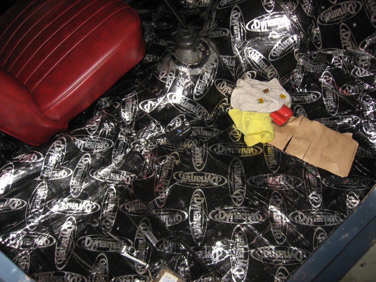

    Just about ready for carpet. Took the car out on the freeway and even with the Dynamat it is LOUD. Hopefully adding carpet will help. Am a little worried that I have an exhaust drone.

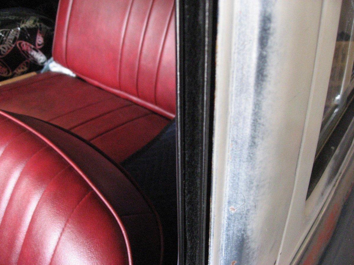

    This seal came from Hillman buddy Frank in Australia. He was nice enough to cut one down from another Hillman model that he makes. Frank is just an enthusiast that is helping keep our cars alive. Thanks Frank! There is another guy in Texas that makes these but charges twice as much and his parts never fit.
    Couldn't find a good source for channel felt in the US so had to get this out of the UK. The US sourced stuff wasn't thick enough and was expensive so I found this 3mm stuff from Woolies Trim. It was 1" wide so was a perfect fit in the channel. Was amazed how cheap it was and it arrived via airmail in 3 days!!!! No more door rattles. Now if I can just get the rest of the windows to not rattle. I also bought some maroon/burgundy Hardura from Woolies. That will be used to cover the wheel wells inside the car. Hardura is an embossed PVC vinyl with a felt backing, ideal for sound insulation, as well as under bonnet heat insulation.
    Had big gaps at the bottom of the 1/4 window before and the old seal was crumbling. Very pleased with the results on these.

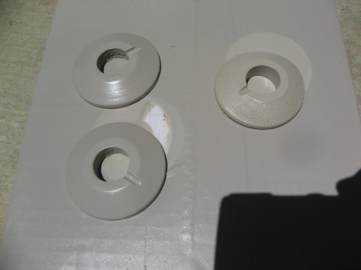

    So I've been trying to collect all the parts to put on the window cranks and door handles. The little plastic discs (escutcheons) that go behind the cranks and handles were crumbling and turning to powder. I've looked all over to find some that were in better condition and were not egg shaped from the sun/shrinkage. No luck. I couldn't find anything.
    I have a brother with a 3D printer so I asked him to print me a couple. Later that night he had them for me. Had to paint them but they look great. Can you believe you can just print parts like this?
    found this description on the web:
    The creation of a 3D printed object is achieved using additive processes. In an additive process an object is created by laying down successive layers of material until the entire object is created. Each of these layers can be seen as a thinly sliced horizontal cross-section of the eventual object.
    The two on the left were 3D printed. The one on the right is original and had turned to powder.

    I'm not sure how big. My brother uses it to make helicopter (drone) bodies and other fun stuff. Only downside is that he has to do the sketch of the part and program it in to the computer. This was a simple shape so I think it was easy for him.
    We talked about getting a scanner so we can scan and digitize the piece we want made then it will print an exact copy or we can send the file out and have it machined with stainless steel or whatever we want.
    I wanted to find an original escutcheon but this thing turned out nearly perfect so I am very happy with the results. Modern technology.....sometimes it's a big help.

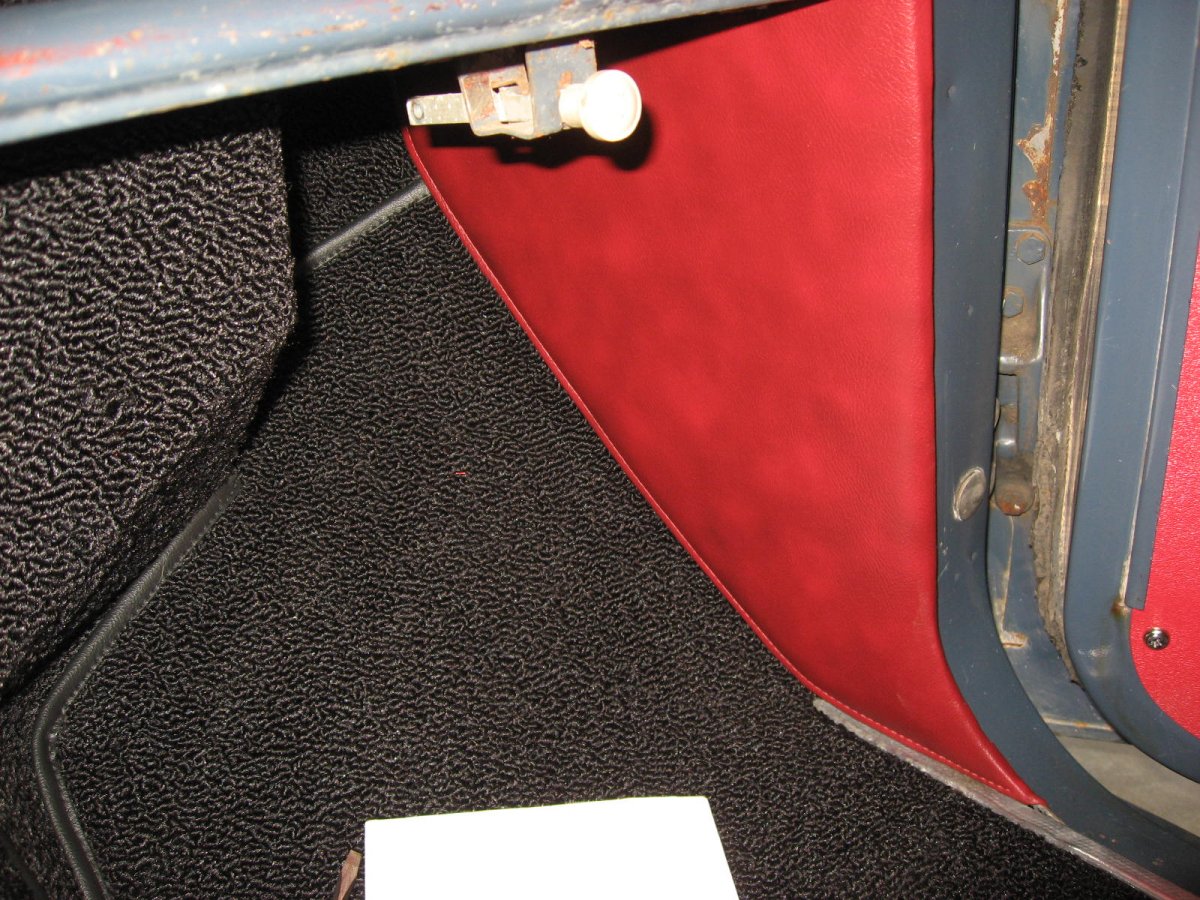

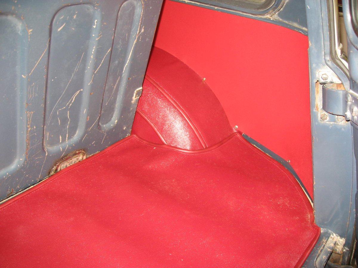

    We now have carpet in and some of the interior panels. All carpet work was done by Rays Upholstery in Watsonville.
    I opted for standard black loop with black binding. Simple enough.
    It turned out really nice and has a good crisp look to it.

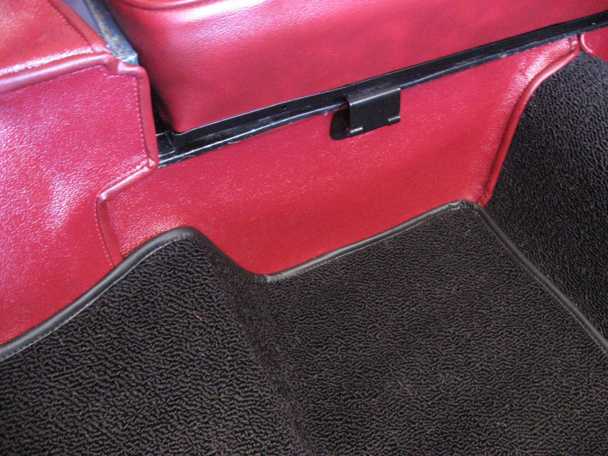

    The kick panel under the rear seat was done with Hardura as was original.
    Kick panels were done with the same vinyl as on the seats.

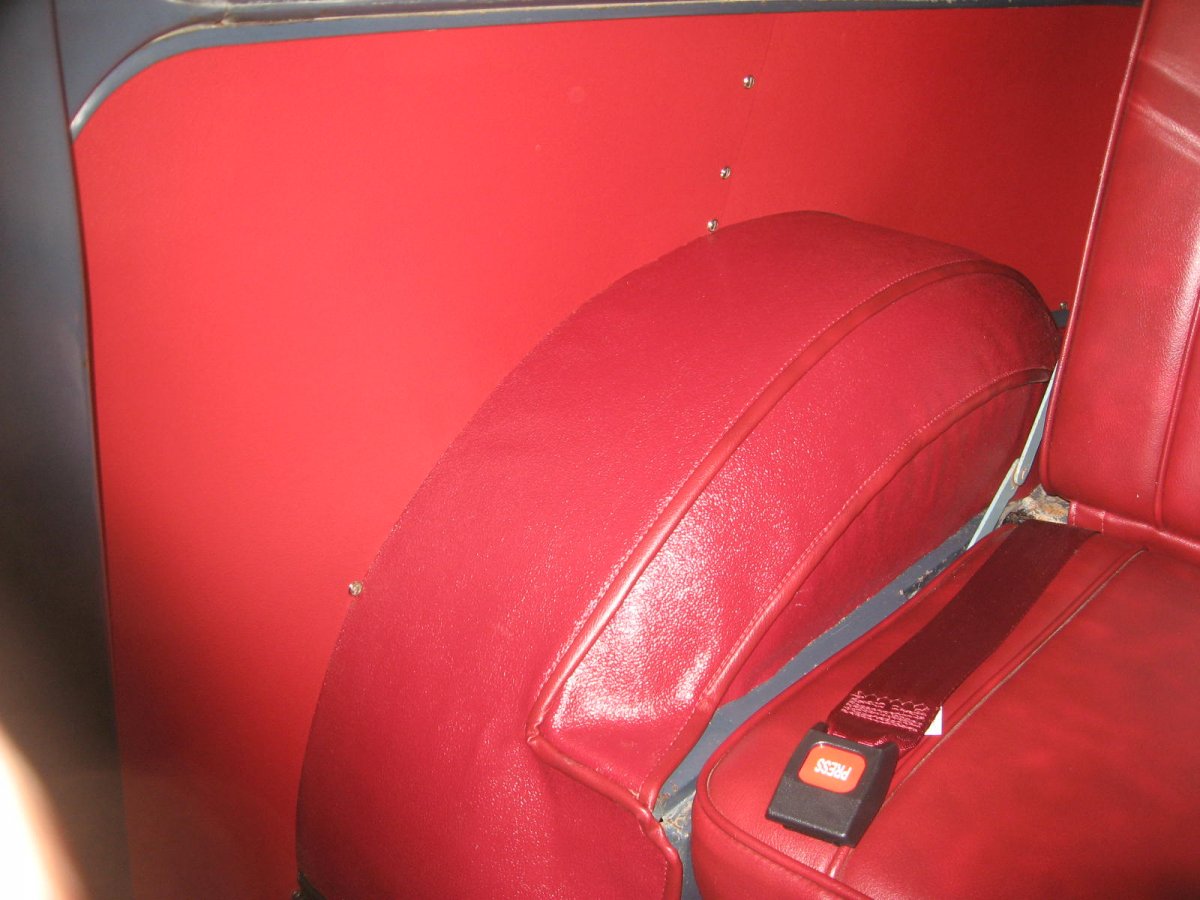

    Side panels are made from ABS plastic. Originals were fiberboard. Wheel well covers were also made with Hardura as per original.
    More of the side panels. Painted these with SEM upholstery paint in a color close to original color.
    This isn't original but they also made me a trunk floor mat. Will cut down on the rattles when I'm hauling a load.
    Here's a shot of the rear seat with the belts installed. I still need to make the side panels on the drivers side.

    The expansion tank now has an overflow.....just in case. Tested it in the sink and it seems to work like it should.
    kidcampbell71, Fedman and D-Russ like this.
