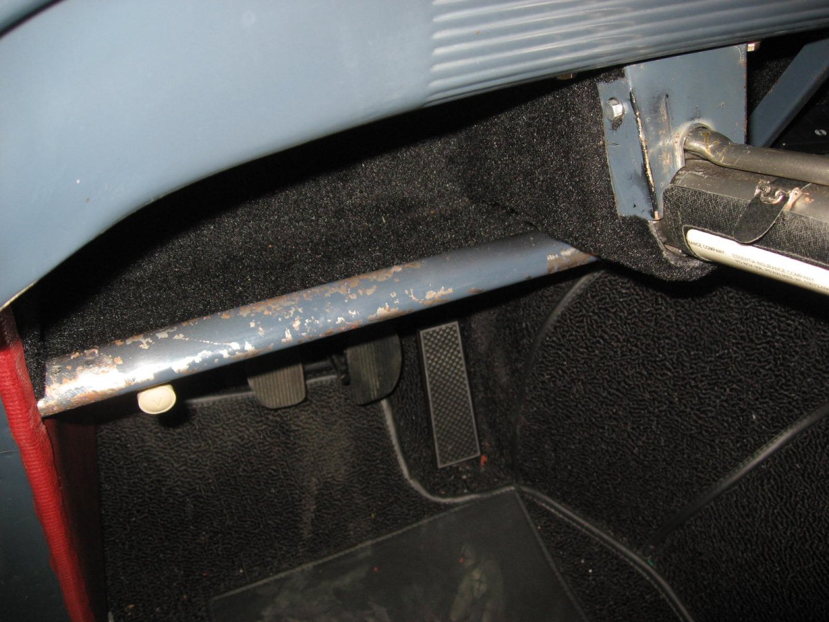

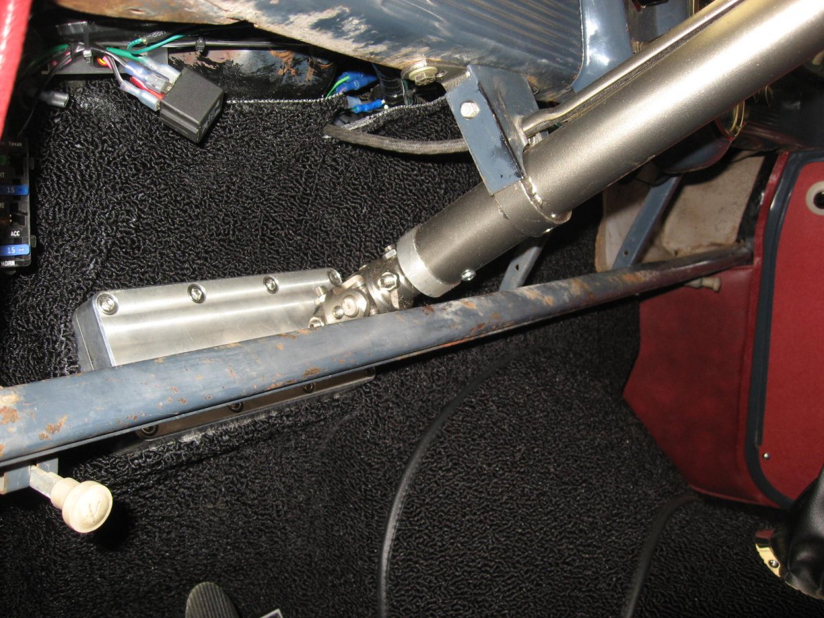

    Spent some time on the car this weekend getting the parcel tray under the dash finished. My buddy Dave whipped out the sheet metal and then we covered it in carpet. Turned out great and looks a lot like the original piece.
    Cut out is where the steering p***es through. I'm leaving the vent pulls even though they don't do anything.
    I had painter's blue tape on the bottom rail and it removed a lot of the original paint when I removed the tape. There wasn't any primer under the original paint so I guess it did ok to stay on there as long as it did.
    Dave hand formed the piece around the column.
    I found an old registration holder for the column so I don't have to worry about it blowing around.

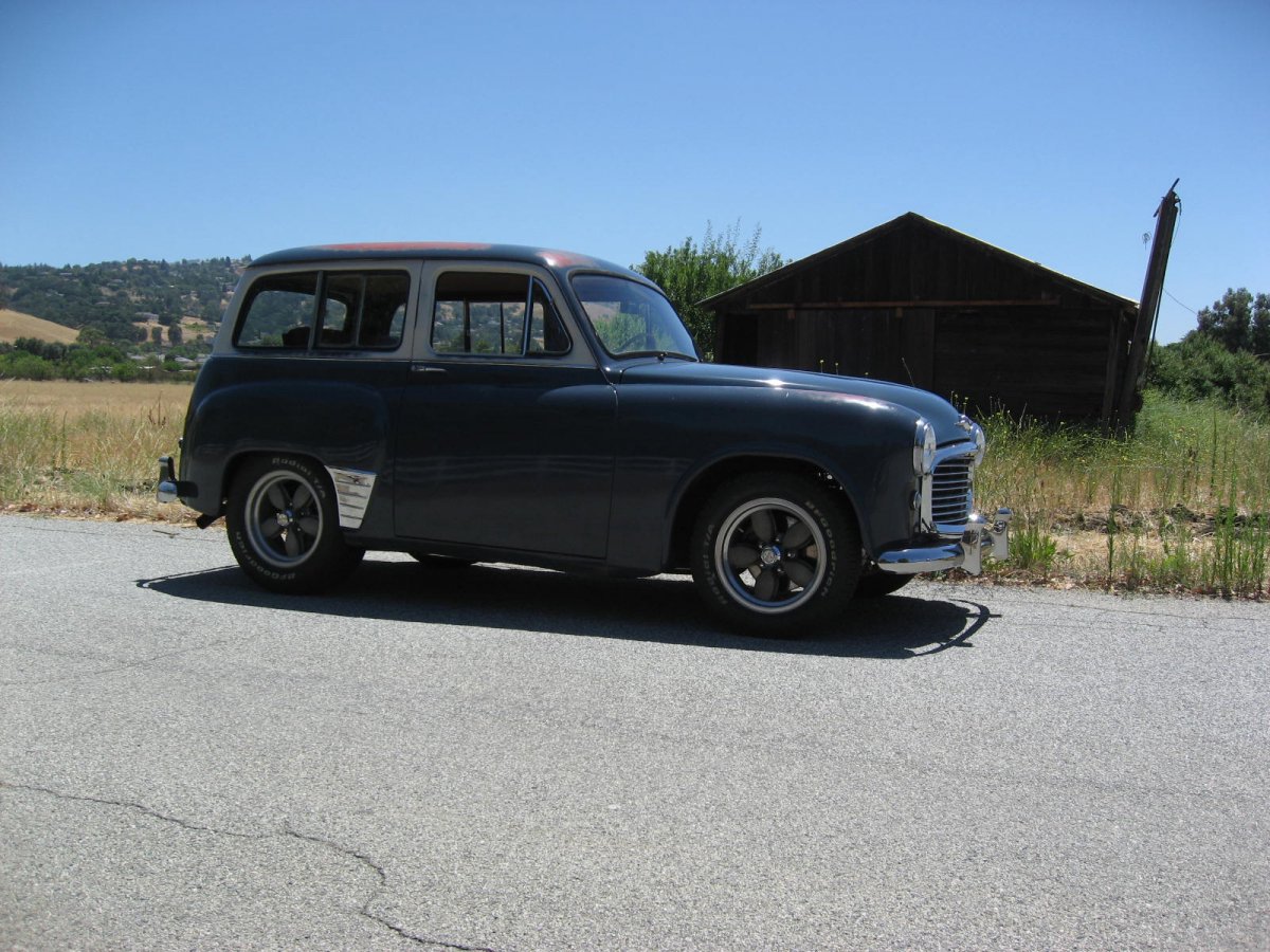

    Took some photos yesterday while I was out driving around.
    I think I'll swap out this grill for another one that is original to the car.
    A nice shot of the weeds too.
    I'm on the lookout for a better rear door....in the same color.
    Need to throw on some wipers and a mirror on the driver door.

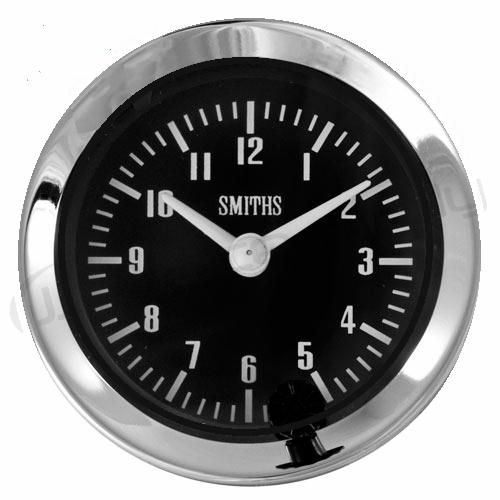

    Got a tach on the way. Its pretty small 52mm so hopefully I can find a place for it. They didn't have one less than 8,000 RPMs.
    Also have this clock that will go in somewhere.
