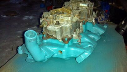

    Not the correct carbs... but this is "D" part numbered manifold 1373994943407.jpeg 1376741030912.jpeg

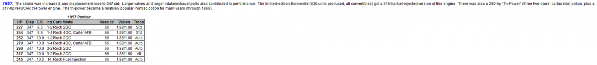

    Wallace racing shows 2 heads for 1957. The FI heads and then the heads they used on everything else.
    I found this online. It doesn’t tell you much but if you know GM stuff from that era it gives you an idea.
    If the heads are the same, then your differences would be induction and compression. More than like Pontiac didn’t have 2 different hydraulic cams but one of the Pontiac guys might no better. Plus your not likely to get a solid cam in an automatic. [​IMG]
    The pictures leave off the low compression 2bl option because I couldn’t get it on the screen.
