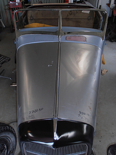

    Time to look at filling the grille shell. Don't want the radaitor cap etc to disrupt the flow of the lines before you even start looking.

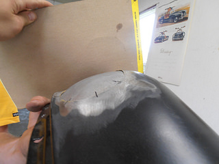

    Okay, so the stamping for the radiator filler sticks up and disrupts the visual flow from the front to the rear of the car. It needs to be carefully marked and cut off. My friend Paul who has seen more 32's than anyone around cautioned me not to fill it with a flat piece of steel unless I want to top it off with 1/4 inch of Bondo. (The top of the radiator shell is a 3D compound curve).
    Carefully cut the hole and mark the center lines.
  9. ziffer
    Joined: May 4, 2005
    Posts: 262
    ziffer
    from michigan

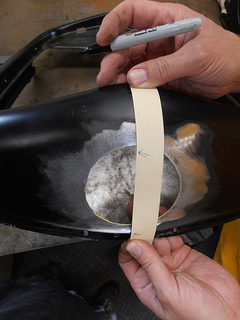

    Next it is time to get a distance across the SURFACE of that compound curve. You can use some really complex Topology equations or I prefer using a piece of cardstock and approximating the curvature with the card stock. Then just mark the distance and you have a template. (Don't stretch it tight when marking, also, it is better to have extra material to grind off later for a perfect fit.)

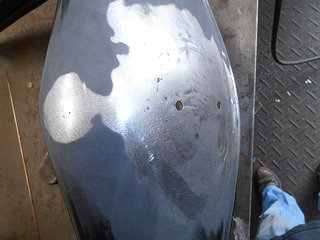

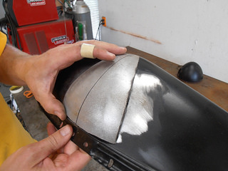

    Now what to fill that 3D cavity with. Enter Paul again with a great suggestion. Find a headlight at a swap meet with the right curvature and use part of it to fill the hole. ($5 fix).
    You can just make out the stamping in this piece but the radius was too tight.
    So diging up another headlight with a better Radius lay out the sector
    So you can see this headlight already made one repair so this is now a $2.50 repair
    Lay the piece on the shell and see how well it fits. Don't worry about the gap at the (front of the old headlight) that piece will be cut off.
  11. ziffer
    Joined: May 4, 2005
    Posts: 262
    ziffer
    from michigan
    The piece fits in well and lots of witness marks make sure we get it in the correct orientation.
    Curvatre is ever so slightly high but as we torch weld and hammer and dolly the shrinking will pull this down nicely.

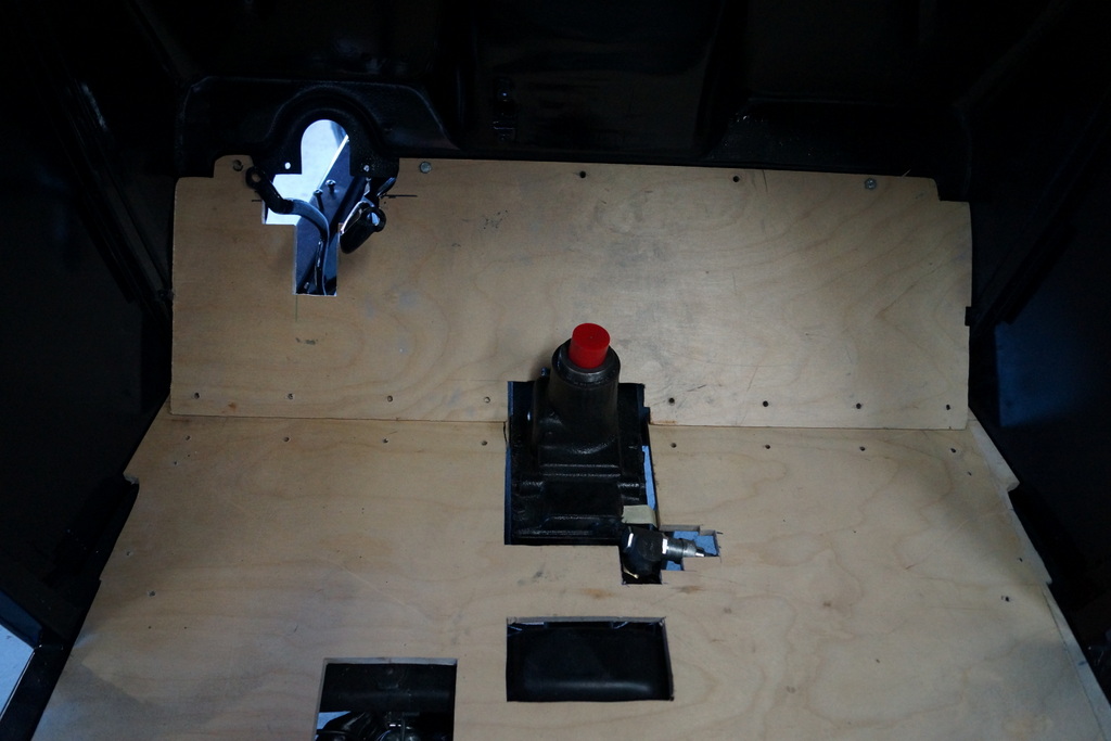

    There have been posts on making trans tunnels but I like to make them in one piece so here are some of the steps DSC00271.JPG
    Start with you floor and toe boards bolted up tight exactly the way you want them in the finished car then start with a cardboard template
    Start t******* and fitting. Make sure to give plenty of room around the shift tower, it will be covered with the shift boot and you don't want the trans tunnel rattling against the transmission.
    At this point we are just taping and roughing out what we need. We can lay it out on another piece of card stock to get the final pattern before going to steel
    Lay out the card stock template on to some 18ga and use a spring-loaded ctr punch to punch right through the pattern into the steel where you will have bolt holes. These punches will serve as a way to index the pattern to the steel as you start forming.
