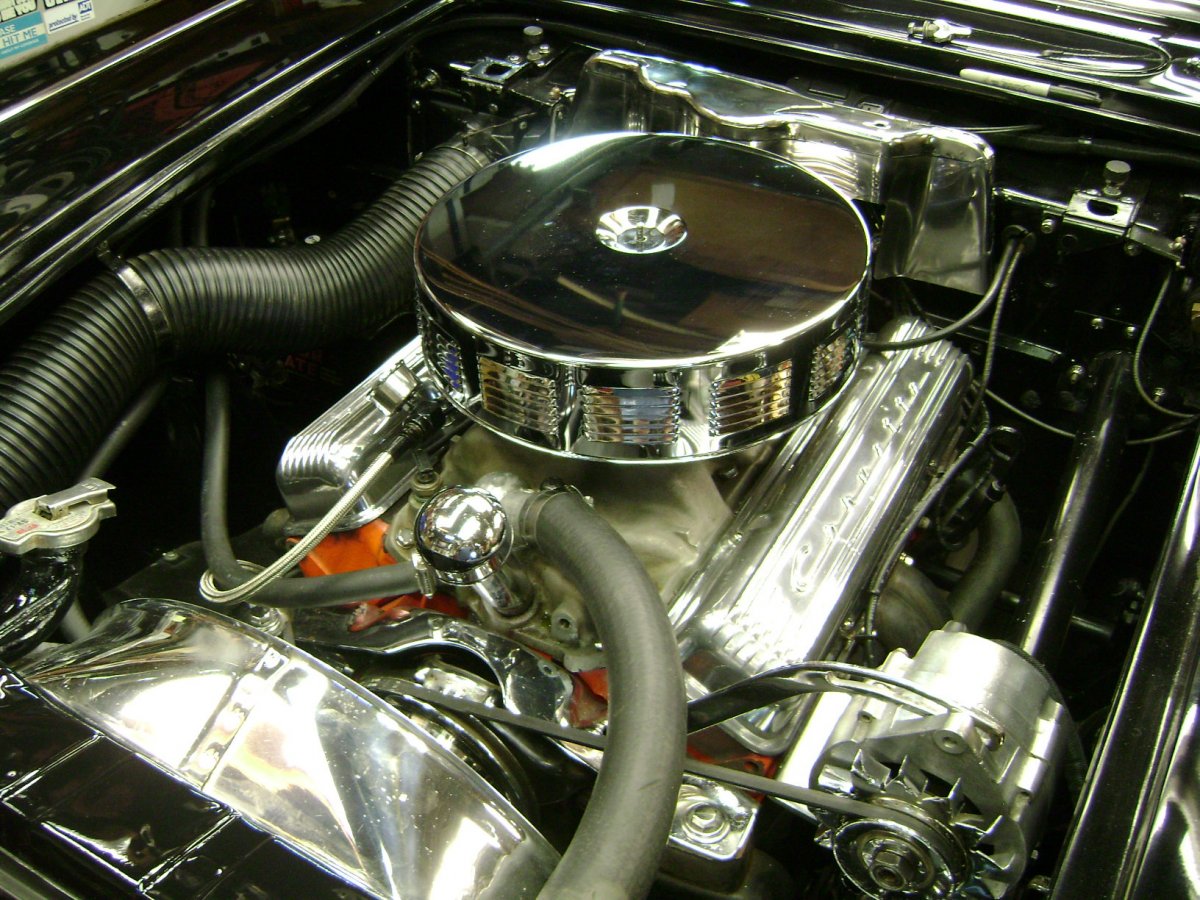

    Cleaning up the front of the engine some.
    Fan, radiator, water pump & pulley, crank pulley, motor mount.
    Found a chrome alternator pulley in my stash, might stick it on.

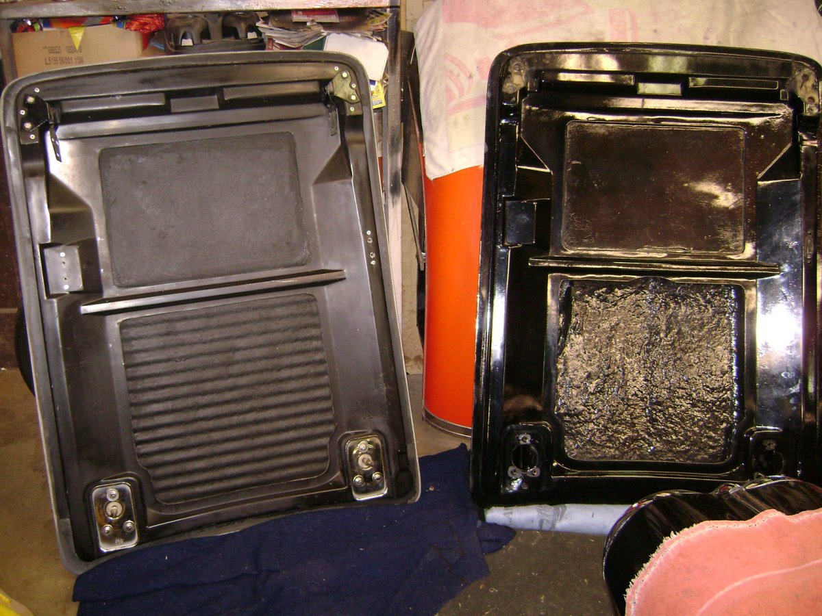

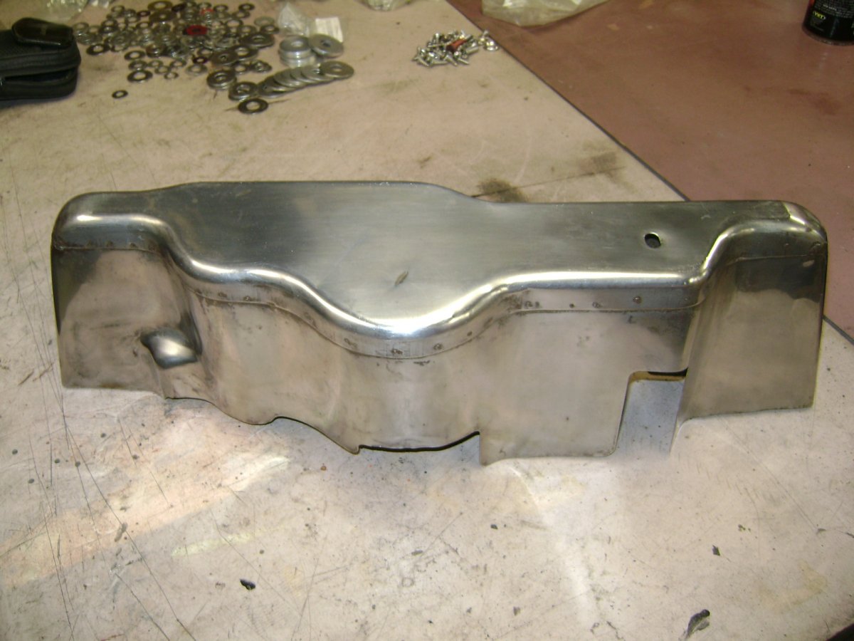

    Got a 1962 Corvette ignition shield top off Craigslist for a great deal.
    The seller was a cool guy and we talked rods for a while. His friend bought a Harley from my Corvette's previous owner and told him about the car. He called but I'd already made the deal on it. Had a Vette he restored and sold, so my shield was a leftover. Now looking for another 58-62 Vette.
    Had some tiny dents and scratches so I banged 'em out and gave it a buff.
    Gonna look great on the car and will cover the tan colored Accel distributor cap.

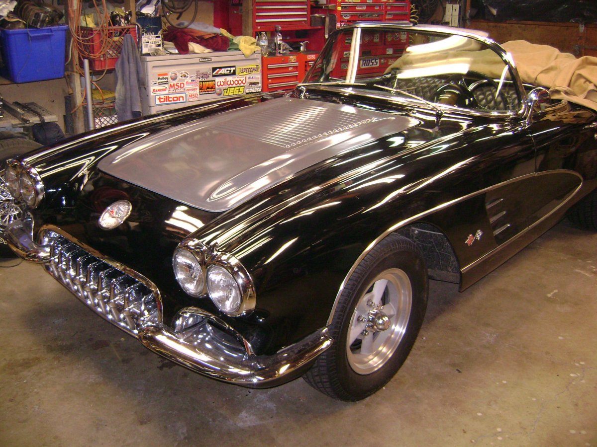

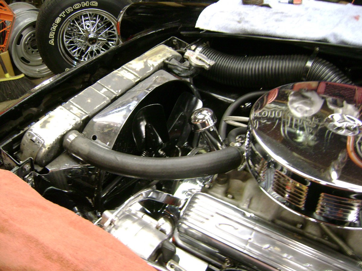

    Pulled off the hood to finish the wiring covers in front of the radiator.
    Also buffing out that area as it can't be done with the hood on.
    Painting the top radiator tank as well.
    Out with the old and in with the new.
    Getting the new '58 hood ready to install. Very nice press molded hood but going to require a bunch of prep work where the upper and lower sections were bonded together before it's ready for paint.
    Test fitting today.

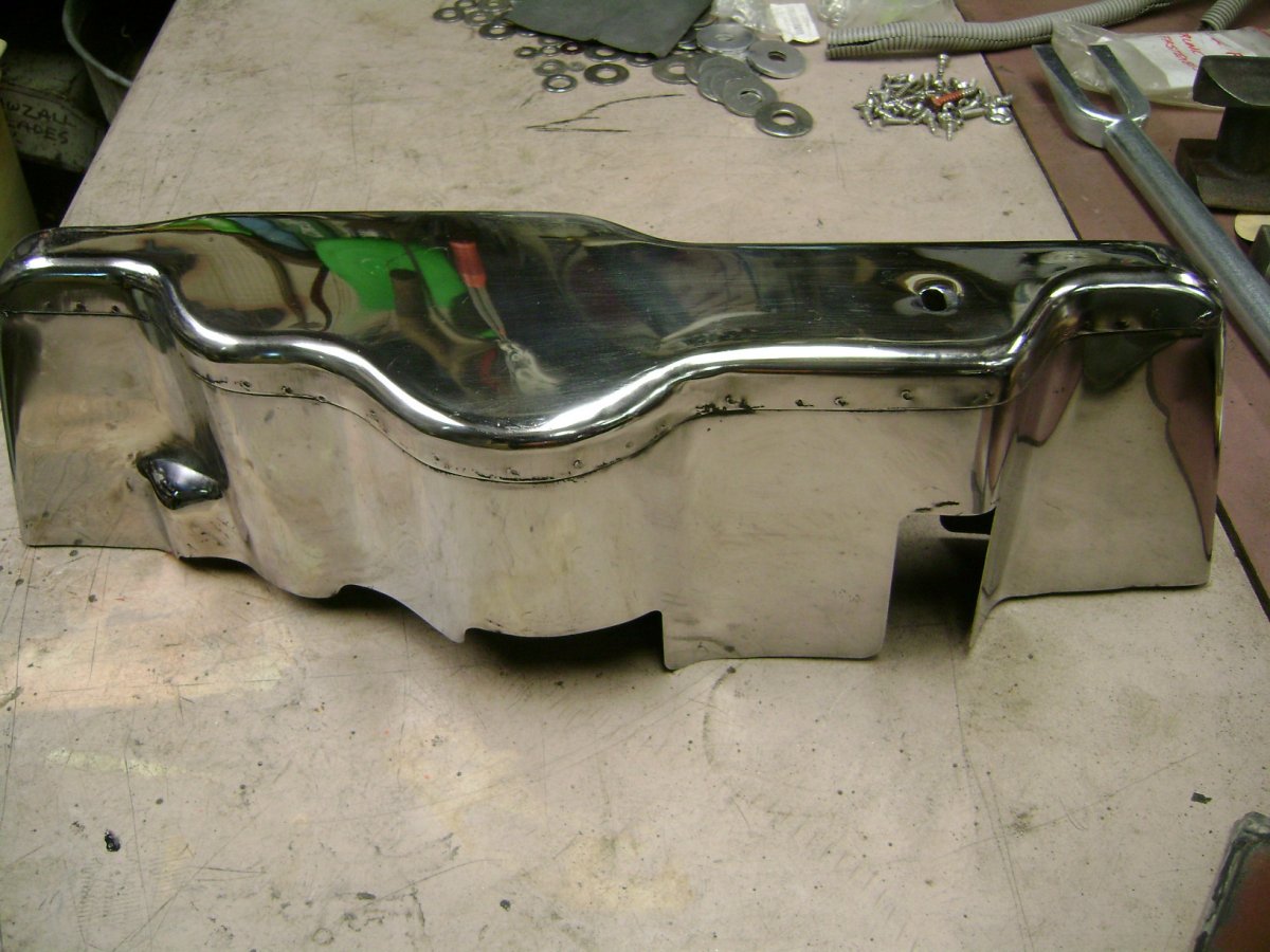

    Had to try the ignition shield top on. Not sure if I'll be able to use the vertical shields as they're meant to route the plug wires under the exhaust manifolds. Probably be too long and will need trimmed off.

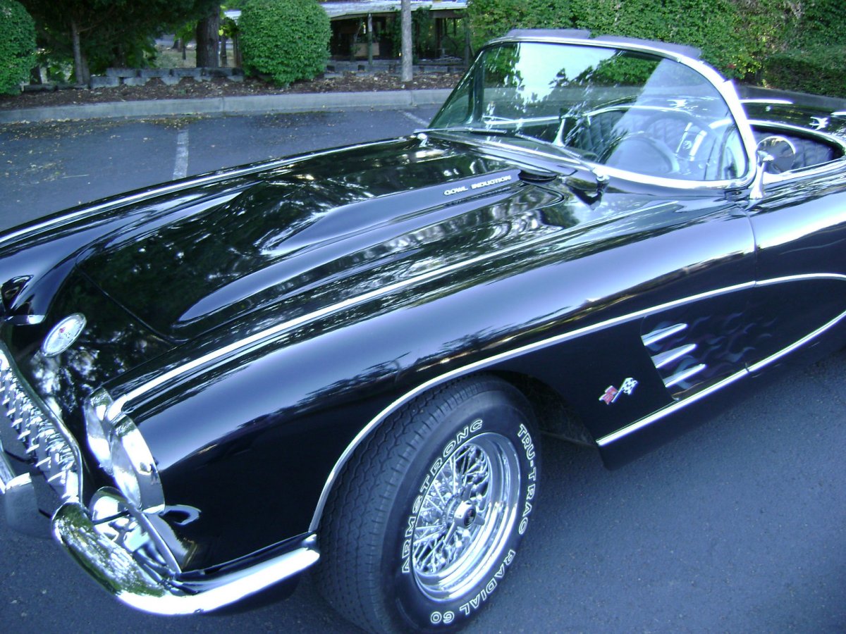

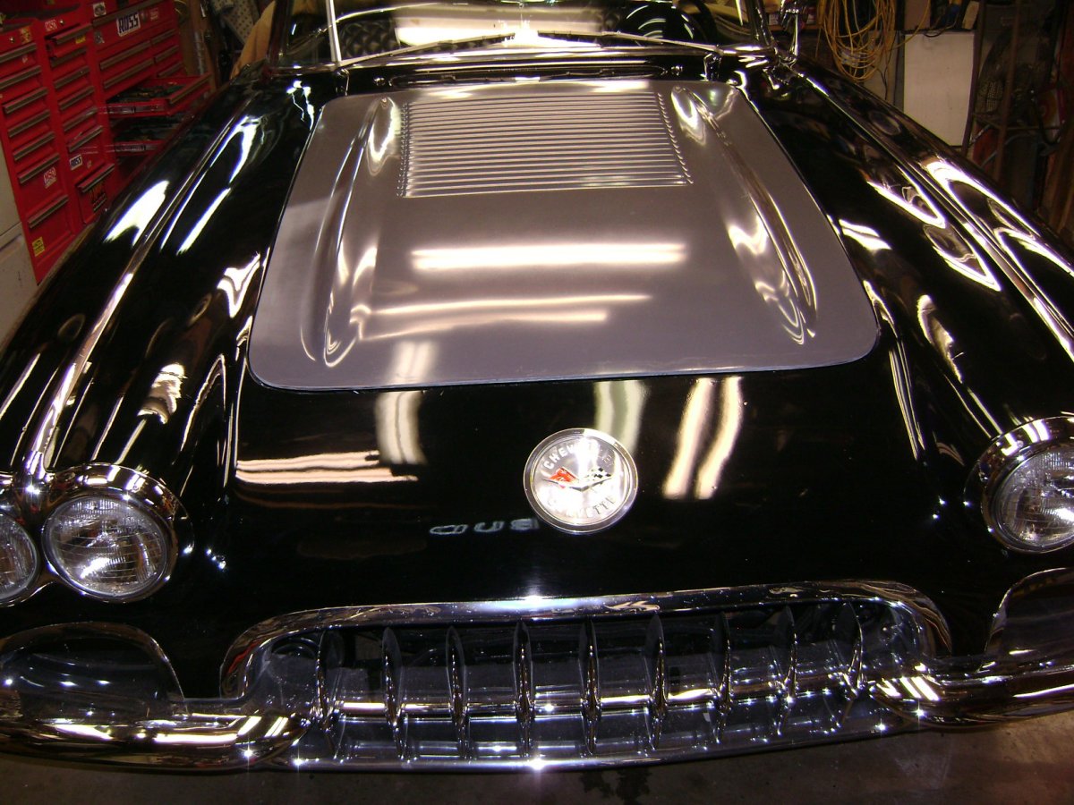

    Had a couple days into fitting the reproduction '58 hood.
    On and off a few times.
    Needed to scribe and file about 3/4 of the way around the perimeter. Also had to slot the holes on the hinges but got it fitting reasonably well. Replaced all of the attaching bolts with polished stainless.
    I noticed a 12/20/1980 delivery date on the box that contained the new hood. Maybe previous owner tried it on and gave up or never took it out of the box. Anyway, it tells me he wasn't fond of the cowl induction hood either. DSC00464.JPG
    I do like it much better.

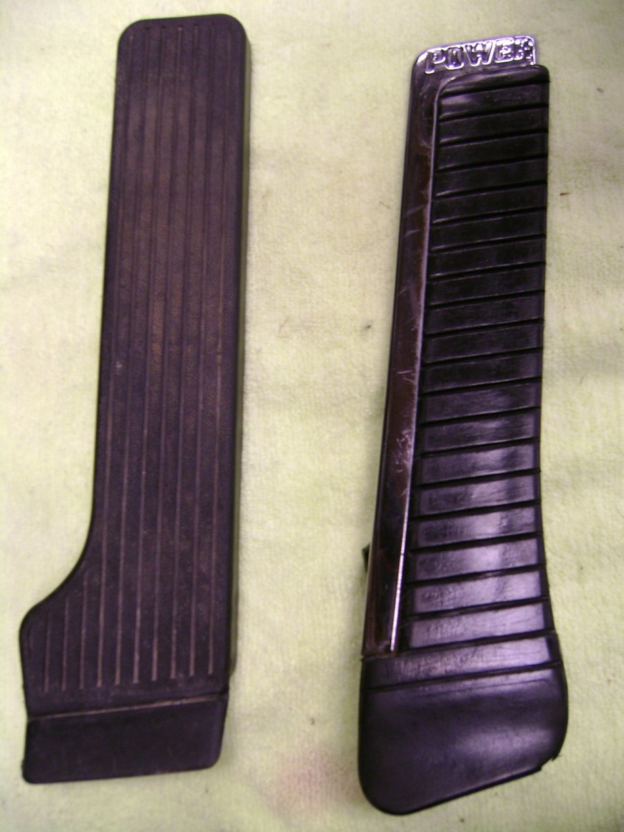

    The car had an extra added leaf spring and coil ***isted shocks in the back so rode pretty harsh. I removed the leaf, shocks and added some 3/4" drop blocks to get the rear down a little. Now rides much nicer. Also installed some new air shocks as I plan on pulling a small travel trailer. Yanked off the old "*******" traction bars and tossed 'em in the parts stash.
    Pedal on the left is stock.
    One on the right is from a '57 Pontiac Safari wagon I parted 35 years ago.
    Been saving for the "right" car. This car is it.
    I really like the stainless trim.
    I used to call the gas pedal the "loud" pedal .
    Looks like it will be the "power" pedal from now on.

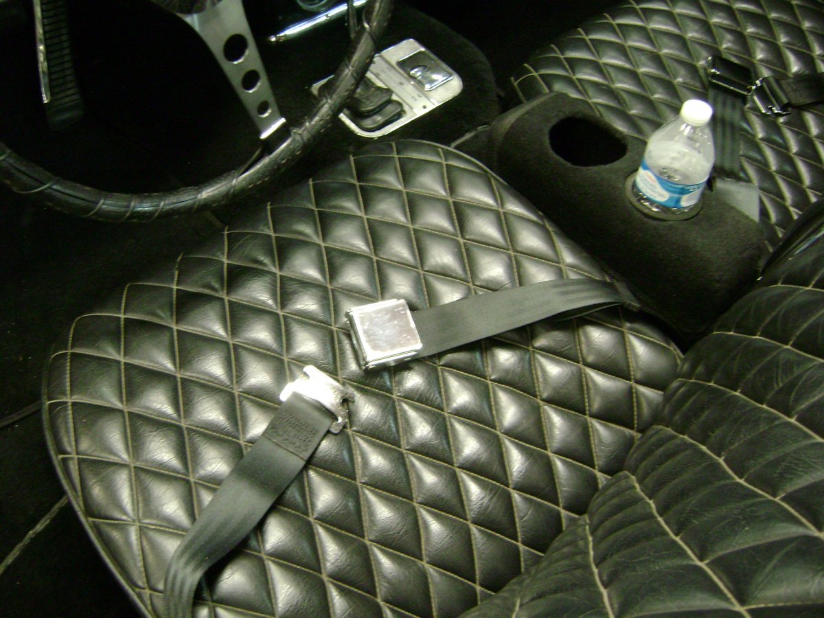

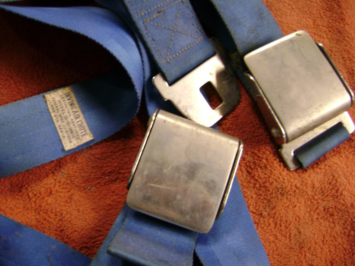

    I have these original blue Corvette seat belts I was hoping to use. They've been through the black dye bath 3 times and sat in it for a week each time. Now they're really really dark purple so I gave up. Went through my parts stash and found a pair of new, black, flip-buckle belts I'd forgotten about. Bought them for a project years ago but sold the car before installation happened.
    New belts.
    Built a cup holder because holding a can between your legs doesn't really work when you have a 4 speed.
    The holder was made out of a large plastic pan that I cut the ends off of since it had the correct shape and width. Turned the ends vertical and attached them together. Then used a cheapo carpeted floor mat and some black pleather to cover it. Pulls out in 2 seconds so can be removed for show.

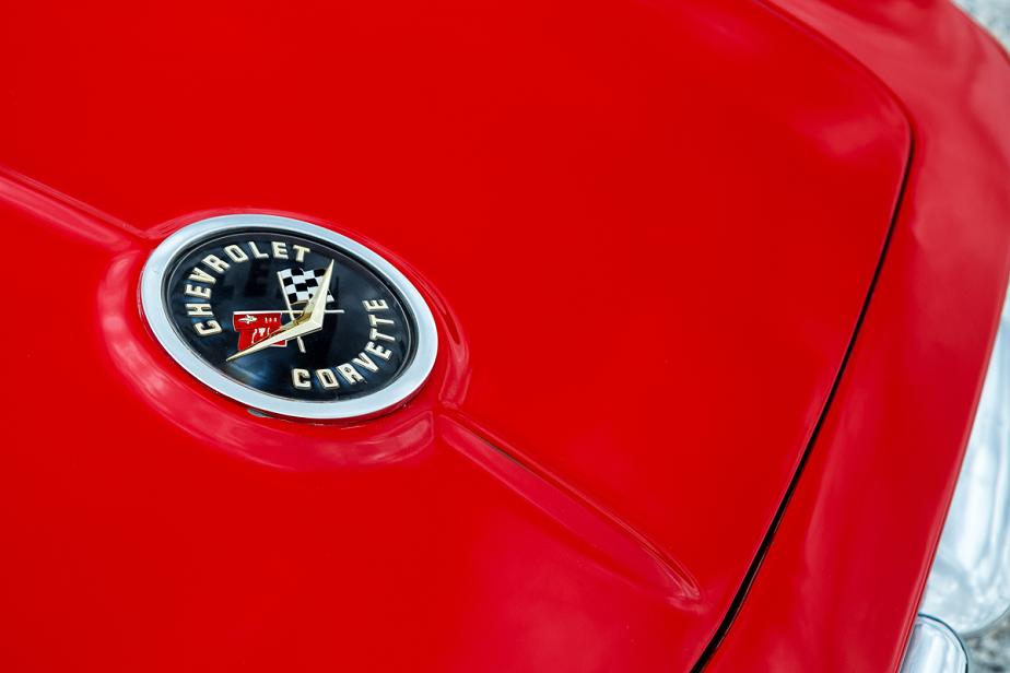

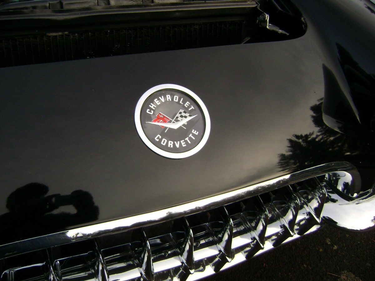

    Picked up a new GM trunk/nose emblem on eBay for 60% off retail. The production line emblems had gold lettering where the replacement is silver. The gold ones are reproduced but I like silver better on a black car.

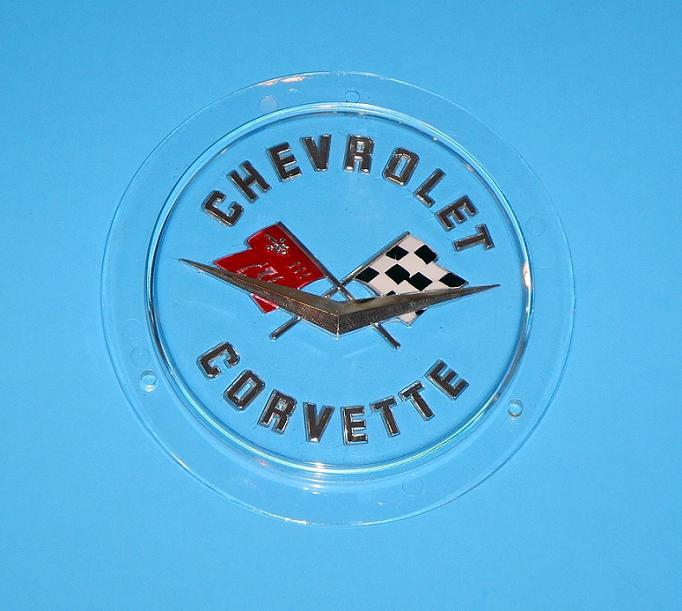

    All Vettes from 58-62 used this emblem but in 1962 only, the concave backing plate was black instead of silver. I have a black one from my old '62 of 25 years ago that I'm going to try on the '58.
    I think the black backing plate will look better on this car.

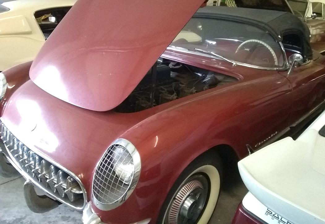

    I was going to buy this 1954 a friend inherited from 2nd owner. All original drivetrain, never been wrecked or damaged. Also included 2 different aftermarket hardtops. High quality repaint and custom matching interior in early 1962. Been pretty much sitting since then because owner bought a new 63 FI coupe in late '62. I have an L79/327 and a Muncie M21 which is where I was headed but then my good friend's car became available. The '54 is really too nice to modify and about 15% more money than my '58 that's already a hot rod.
    0 1954 Chevy Corvette Colton 5.jpg Has original 2 pot air cleaner but was off because of a leaky carb.

    Still waiting for my hood to come back from paint.
    Got the front and rear emblem backing plates done in black.
    Looks better huh?

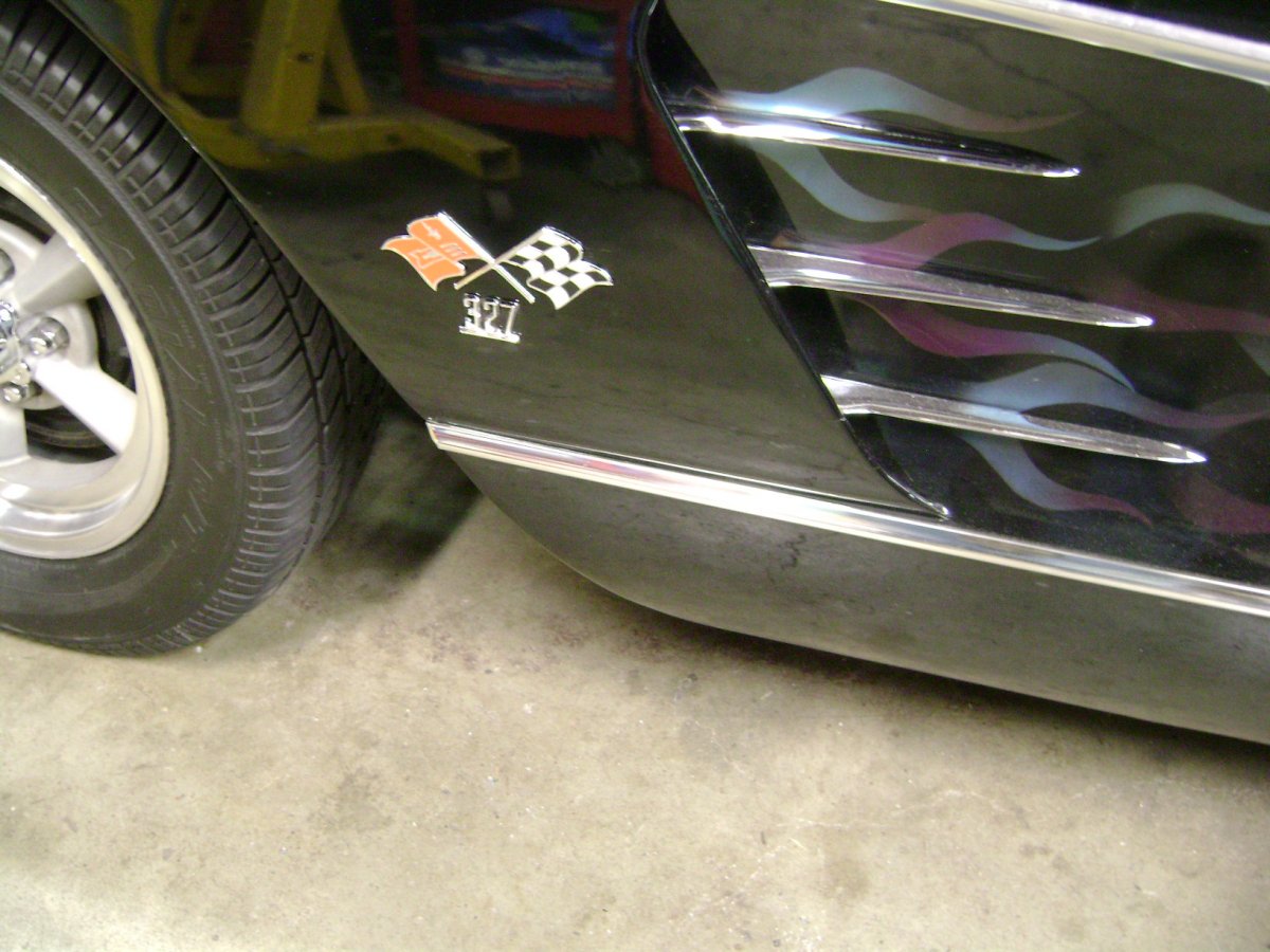

    Forgot to show some NOS 327 emblems I added. These were for a Chevelle and never installed on a Vette. No drilling, ground the studs off the back of the emblem and used clear double sided tape trimmed to fit.
