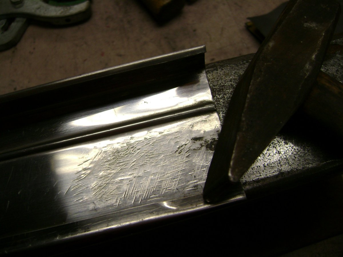

    Been working on the stainless moldings for the new hardtop. I ended up taking pieces from both tops to make one nice one. This included swapping the back windows. ugggg.
    I have one more full day to have the moldings done. (for one top)
    The stainless work is so time consuming. Some of the pieces have hundreds of hammer strikes from the backside to bang the dents out. I like the polishing part but hate the sanding after it's had the dents beat out and been filed to smooth out the high spots.
    The hammer I used looks big in the picture but is actually the size of a tack hammer.
    Lots of sanding.
    After the file job, I used 220 grit (shown),
    then wet sanded with 320, 500, 800, 1000 and finally 1200.
    Still needs a little more polish but you get the idea.

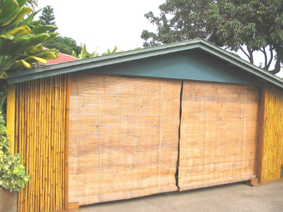

    Been thinking about enclosing my carport and you just gave me the right look.:D

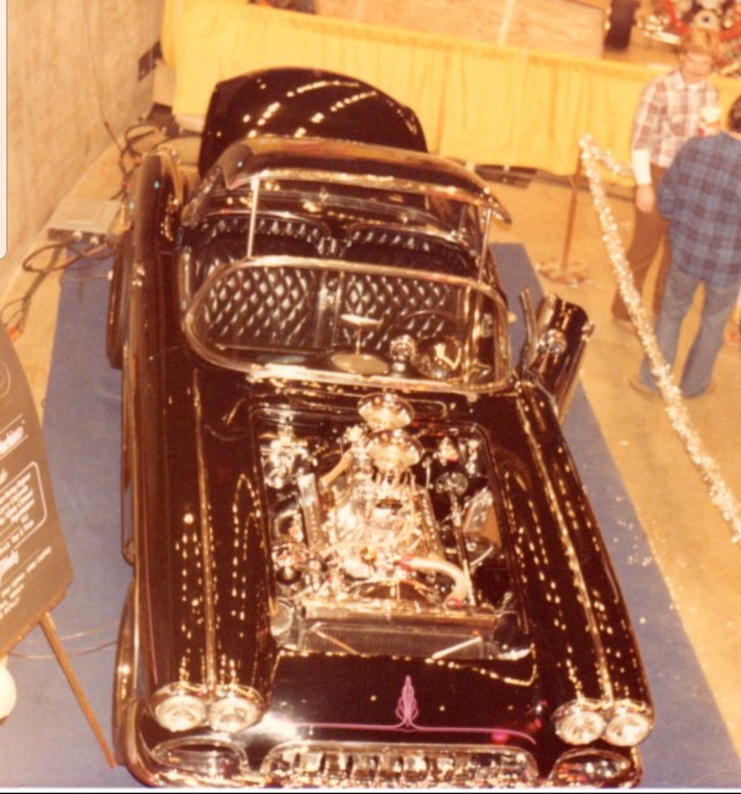

    Wow, that car looks so close to mine especially with the diamond tuck interior but not it. The picture above looks about the same era of 'show' pictures I have for mine. 1979-1981. I know the history of mine from 1973. I'd love to know more previous to that. Have found a couple hints of road racing on the car so keep looking at vintage photos of '58 racers very carefully.
    Here's a couple show shots from back then:
