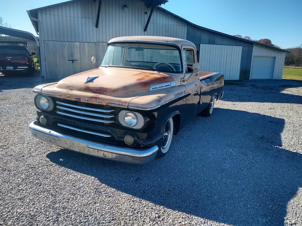

    I thought I'd start a build thread for my ongoing 58 Sweptside build. I found this truck for sale a little over a year ago at a cl***ic car dealership in Washington state. I didn't have the funds to buy it but I did have a 1967 Plymouth GTX that I had owned for a few years and was able to strike up a trade for the truck. The GTX was nice but never really was my kind of car as I am mostly drawn to anything 50's MoPar and when I saw a truck with fins I had to have it. There were 975 Sweptsides produced in 58 and supposedly less than 60 still around. This particular truck has the single headlights instead of the normal quad headlight set up. I've read that in some states quad headlights were illegal. 1958DodgeSweptside2.jpg 1958DodgeSweptside3.jpg
    The truck had been somewhat gone through by a shop but was in no means restored. It didn't have the original drivetrain so I thought it would be perfect for one of the early hemis I had lying around and have always wanted to build. When I got it, it had a 318 Poly, an A833OD four speed, and a 3.00:1 open 9" Ford. The 318 ran good but had a pretty good front main seal leak and the rear end leaked even worse. I know the 9" Ford is a strong rear end but being strictly a Mopar man I rebuilt an 8.75" with a 3.55:1 Sure Grip third member for the truck. I've also went through and rebuilt another A833OD transmission I had, and also machined out the case to press steel bushings in for the countershaft.

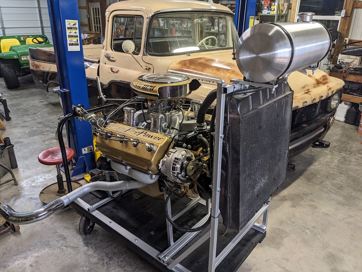

    I just recently got my 331 fired up for the first time and after some very helpful advice from some HAMB members, got my leaks fixed and it's running great now. 0209131406.jpg
    I got the engine about ten years ago. It was sitting outside in a field in Alabama with no intake. Needless to say it was in very rough condition. 0211131636.jpg 2015-03-17 09.58.06.jpg

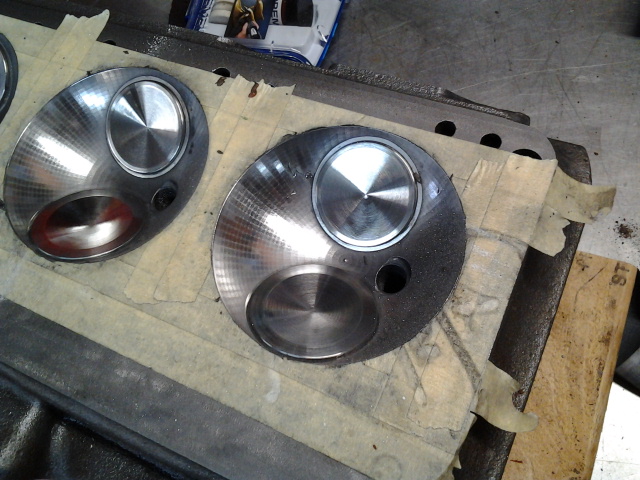

    This was the worst chamber. I really wanted to try to save the heads as they were the famous triple nickel heads and checked good for no cracks. A few years later I was going to trade school to be a machinist and made use of the CNC machines we trained on. Another student's dad had a machine shop with a CMM machine and he took a reading of where each combustion chamber was and wrote a program for me to clean up the chambers. 2015-07-14 08.30.35.jpg
    I also cut a pocket for a valve seat insert for the intake valve on the chamber that was so rotten. 2015-07-15 10.59.15.jpg

    I ended up machining .030" out of the chambers. There was still some pitting in some but this was as far as I was comfortable going. 2015-08-29 15.44.08.jpg
    I took the same amount off the head surface to bring it back to normal compression. I polished out the chambers and also ran the larger 392 stainless valves to help make up for the rotten intake valve seats. I ported and polished the heads but not too much as nature had already done alot of the work. I didn't take any pictures of that except a few when I was fixing my leaking manifold studs after the first run. 331HemiPort.jpg
    I'm running a set of 10:1 Ross pistons and an Isky B777 grind solid cam. I was actually looking for a cam with a duration in the low 230's, and was told this cam was, but it's actually 240 but I decided to run it anyway. It doesn't have much vacuum at idle but it does sound good. About the only thing I wasn't able to run performance wise was headers. It was just too tight in the frame but I think it'll flow just fine for my application with stock manifolds. 0126211121.jpg 2005-06-28 06.24.41.jpg

    Thank you! I took them to my local machine shop when I first tore it down to see what they could do for them and they wouldn't touch em so I figured I had nothing to lose. As long as it holds the valve seat inserts I put in I'll be happy. One thing I learned after working around some very experienced moldmakers after I got out of vocational school was I didn't know anything when I was doing this!

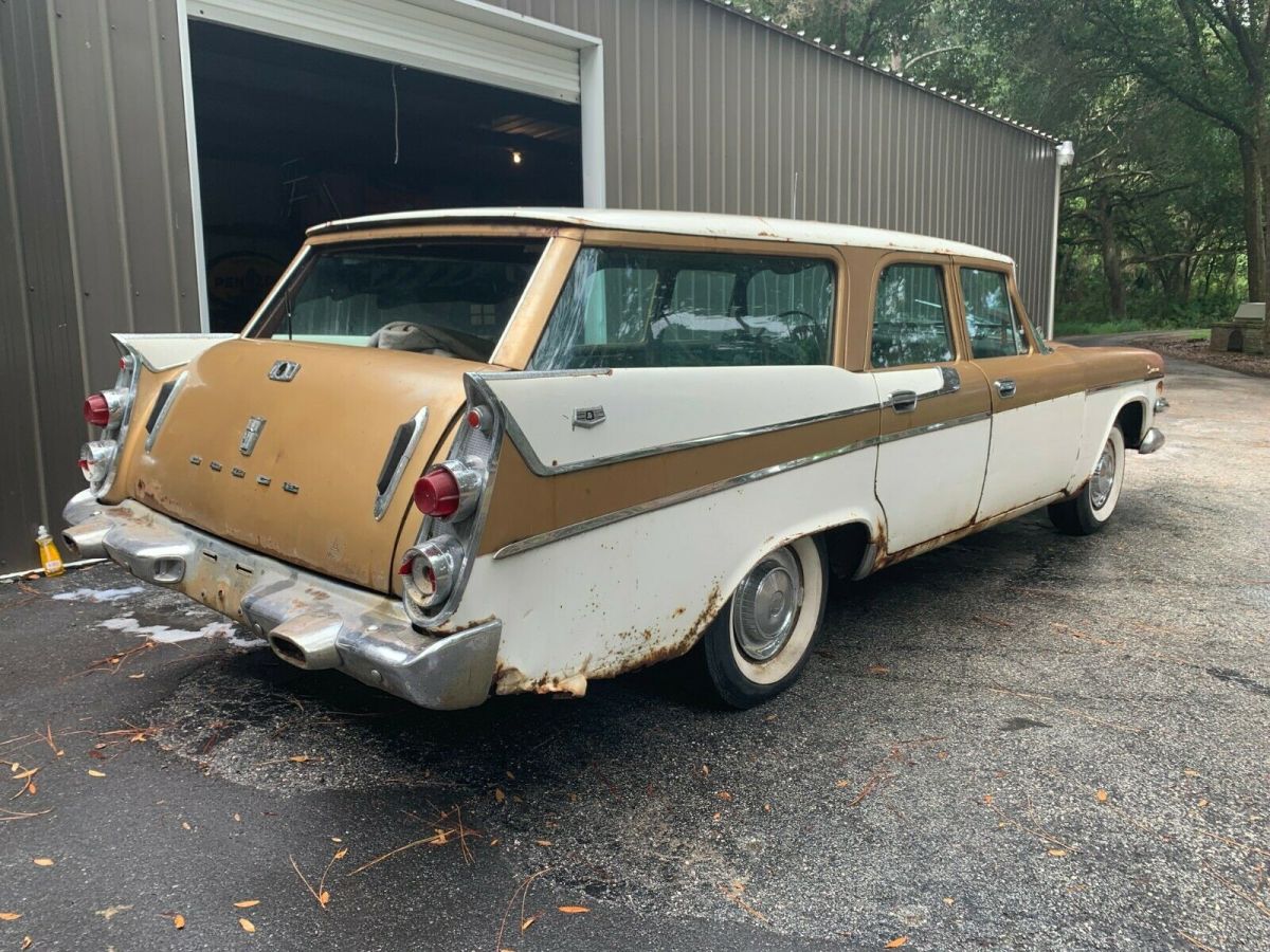

    On the matter of the tailgate I wonder since the bedsides are just from a station wagon what it would have looked like if they had used the door off of one too? 1957-dodge-sierra-d-500-hemi-wagon-3.jpg

  12. I Love them too. But also agree that the tail gate could have been better. 1415.jpg .

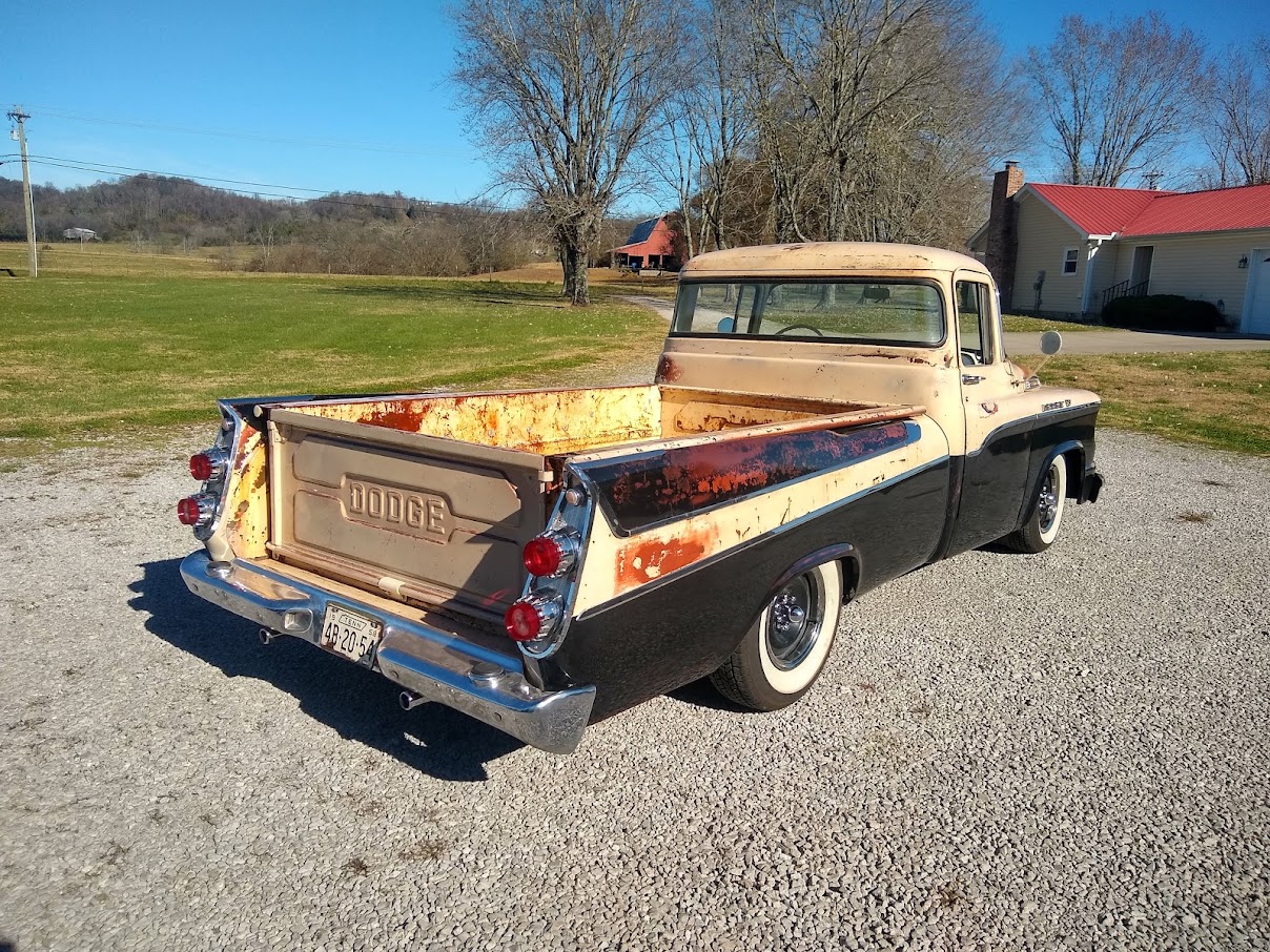

    In picture two showing the tail gate, is that the tail gate that was built with the truck from factory? If so someone in the design department was sleeping during tail gate hour!
  19. 57 Fargo
    Joined: Jan 22, 2012
    Posts: 6,327
    57 Fargo
    Yes it’s the original tailgate. The trucks were put together quite quickly, it’s the original stepside box minus fenders with station wagon quarters tacked on the outside.

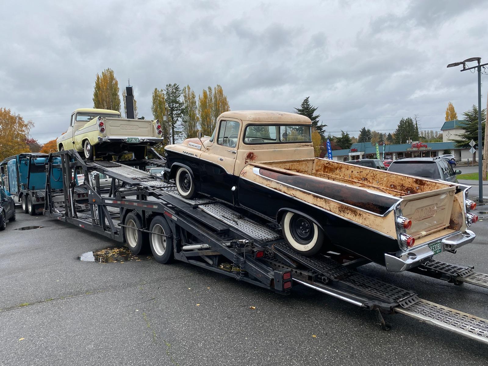

    I forgot to mention that when the truck was headed from Washington state to Tennessee the same dealership had sold a '57 Sweptside that was headed for Florida I believe, so they rode all that way on the same hauler. 626306569.jpg

    Here's a video of the engine running. Just before I started it today I stripped a worm clamp on the hose at the water pump trying to stop a small leak and ended up losing about a gallon of coolant before I could find another one to stop it. Somehow that amount of liquid spread out across Hell's half acre but once I got it cleaned up I took a short video.
    I know it'd look a lot better with this Magspark instead but with electronics being where I always run in to trouble I couldn't resist the hot spark and internal coil.

  28. Great looking engine,,,,,sounds really good .
    I’m ***uming the oil pressure gauge was not hooked up at all ?
    Only drawback I saw was the HEI distributor,,,,,,Mopar made electronic distributors as well ,,,,LoL .

    I've got a manual pressure gauge screwed right in to the block. Haven't tried screwing in the sending unit for the electronic gauge yet to see how close it is.
    Like I said earlier the cam has a little more duration than what I was looking for so it has pretty low vacuum at idle but picks up pretty quick right off idle. Right now I've got it set at 30 degrees total advance which put me at about 11 degrees initial.
