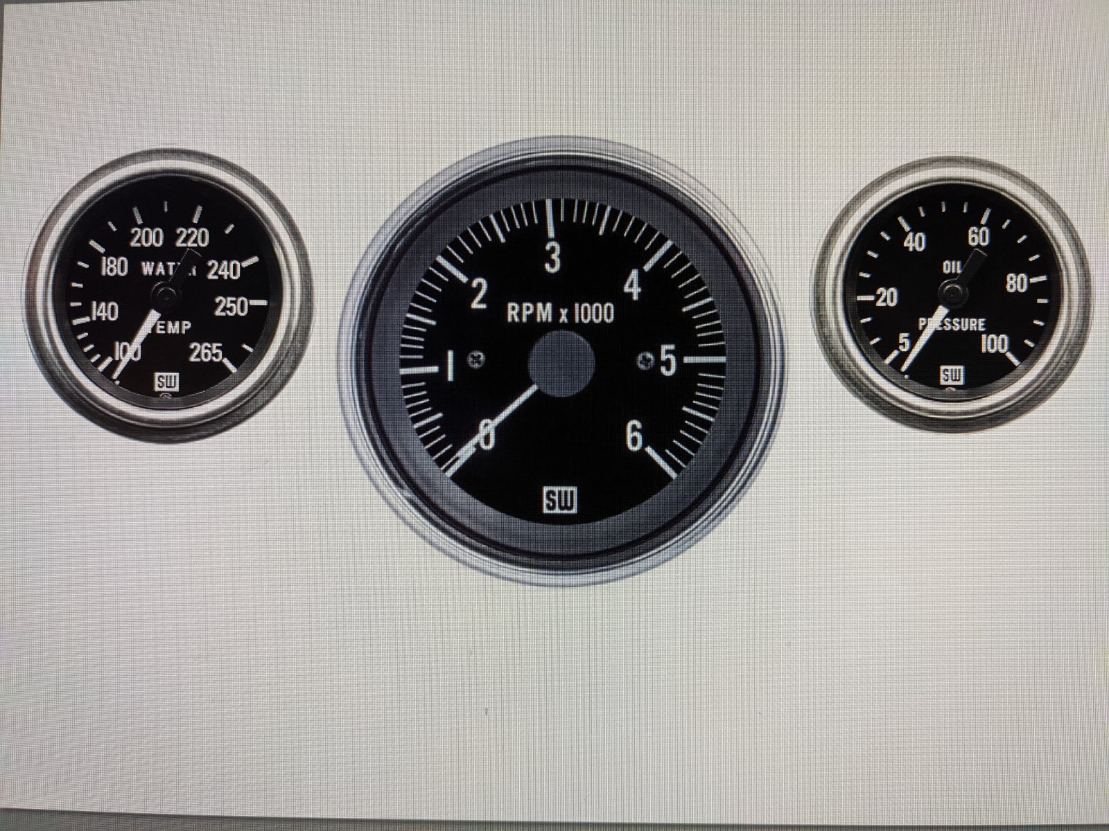

    I've been thinking about maybe replacing the gauges in my dash mounted cluster. I'm not sure why I went with electronic gauges, I reckon just because I liked the look of them, but I think I'd rather have mechanical gauges in it. The electronic ones were not cheap but I'm just not all that impressed with the construction of them and not sure I trust them. GaugeCluster!.jpg
    I've been looking at these Stewart Warner black face gauges. I think they'd match the stock gauges better as well. TempGauge.jpg

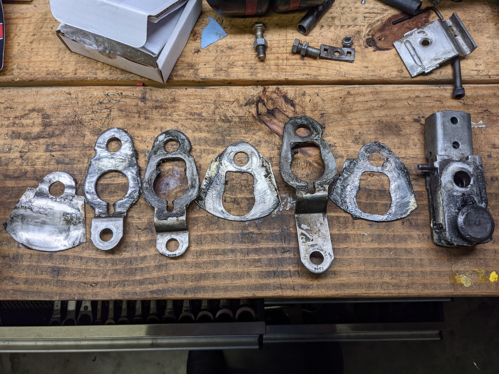

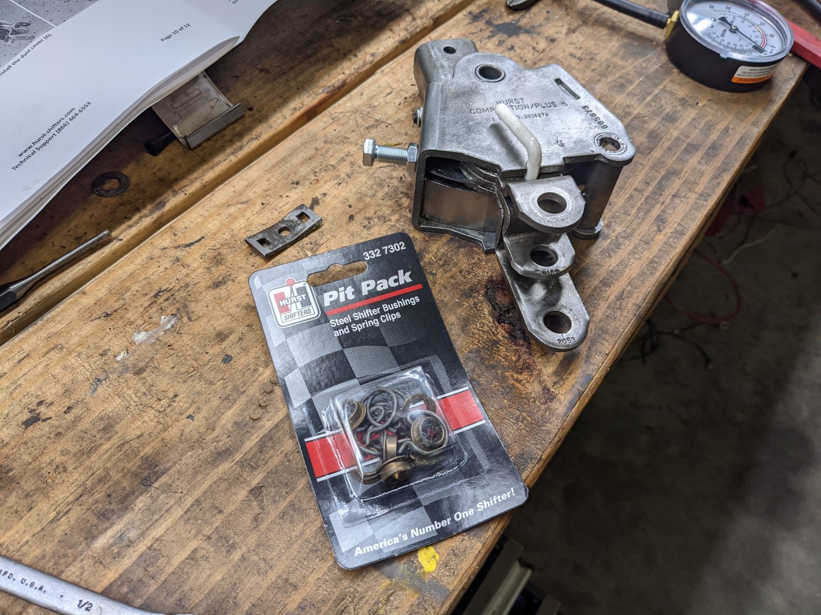

    Last night I finished up rebuilding my shifter. Every once in a while if you didn't hold your mouth right when shifting out of second it would go into the neutral position but would still be in second. It's done this since I got the truck when it had the 318 in it. I thought maybe it was a linkage problem because it was kind of cobbled together so I bought a new Hurst mounting plate and linkage kit but it would still do it. I wasn't sure if maybe it was something to do with the transmission itself but the one I rebuilt to go behind the hemi is a completely different A833 so after seeing another thread about Hurst 4 speed rebuild kits and steel bushings I figured I'd try that. Shifter.jpg Shifter1.jpg
    I think somebody has been in it before because it was missing some internal washers, the dust cover, and the bridge plate was bent from being over tightened. Also the 1-2 shift lever has had some grinding done on the bottom at some point. I cleaned everything up, stoned all the flat surfaces and re***embled it. Shifter3.jpg Shifter4.jpg
    I also noticed the 1-2 shifter rod and the reverse rod were in a little bit of a bind so I bent them some to make it a little smoother. I drove it back and forth to work today and it felt really smooth. The funny part is when I got home I noticed one of the steel bushings was laying where I park it under the lift so on one of my many trips back and forth to the vise bending the linkage I left one out somewhere. It still shifted good but I'll run it up in the air and see which one I missed tomorrow.

    I didn't miss any bushings on my shifter linkage. Turns out they send seven to a pack and I just didn't notice. I was in a hurry to get the shifter hooked back up so I could drive it the next day and wasn't paying attention!

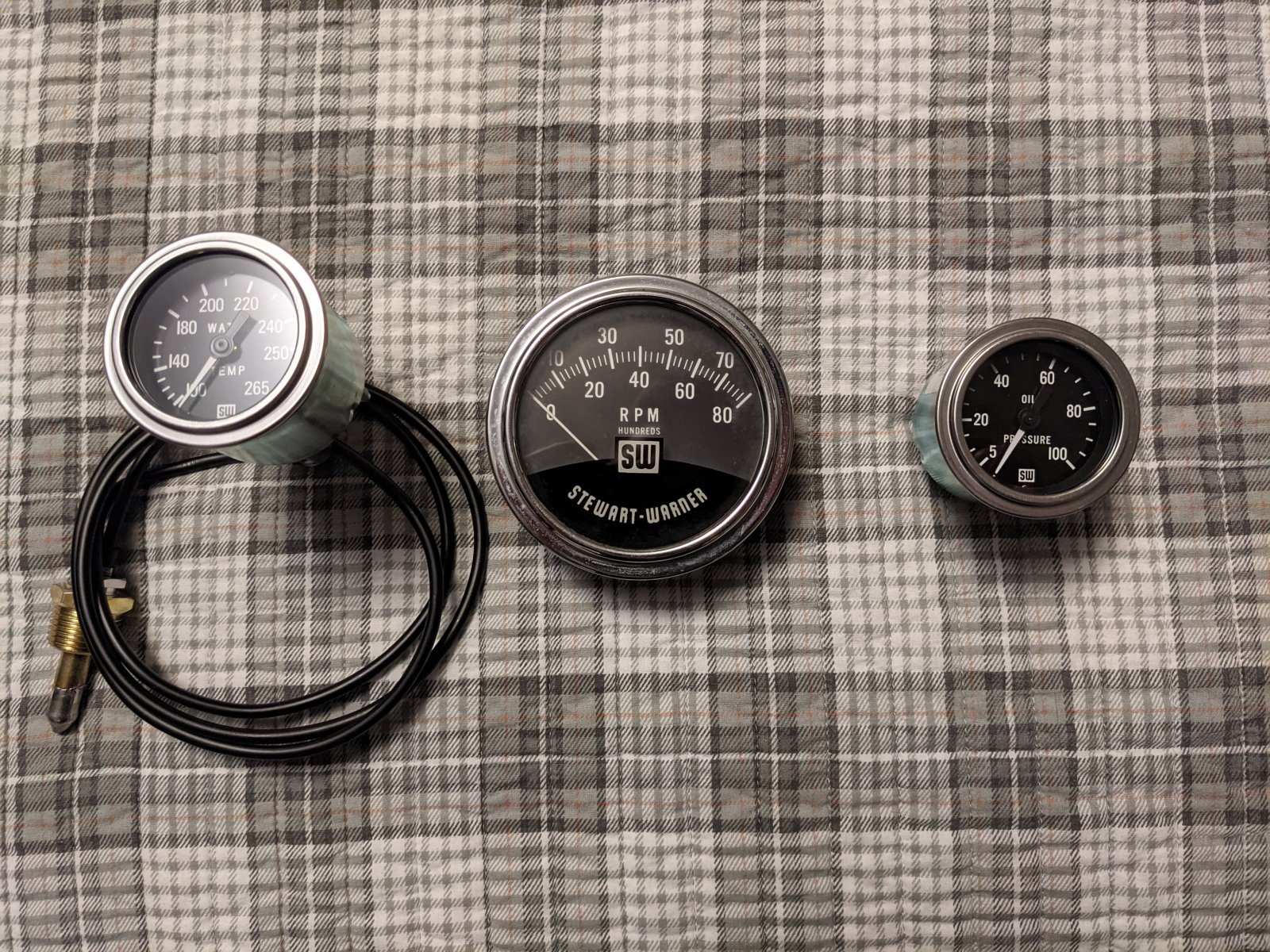

    I've got all my gauges together now to replace the electronic gauges I'm running now. Gauges.jpg
    A big thanks to @60Pioneer for hooking me up with this awesome vintage Stewart Warner tach. He reached out right before I was fixing to buy a new one and I'm sure glad he did. These are going to look so much better and I'll trust them a lot more. I bench tested the tach tonight with a TachMatch unit I got that's built to pair up any ignition source to any kind of tach. The vintage tach setting sends out a 3,000 rpm calibration signal and you use a potentiometer to make the tach match. Tach2.jpg
    They worked great together. Can't wait to get these in the truck.

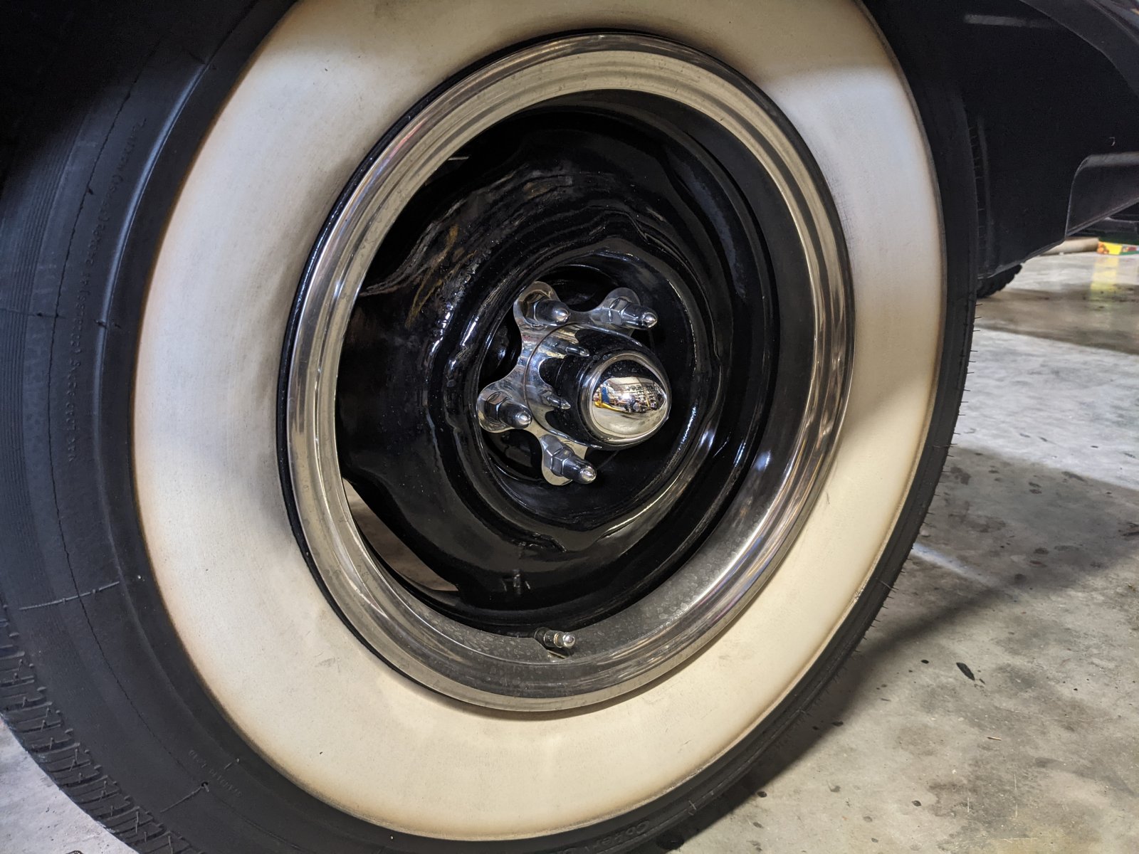

    Washed the truck for the first time since I've had it on Saturday. The tip about using Simple Green and a magic eraser to clean the white walls worked great. Alot better than the Bleche Wite and a br*** brush. 1958DodgeSweptside9.jpg 1958DodgeSweptside10.jpg EngineBay11.jpg
    Took it on its first "long" trip. Not really long compared to what a lot of members on here drive theirs but as I can count the times I've been out of Tennessee on one hand I don't ever go far! Went on a 140 mile round trip to look at an old Shovelhead project. All interstate travel. Cruised at 80, turning about 2,300 rpm, with no problem.

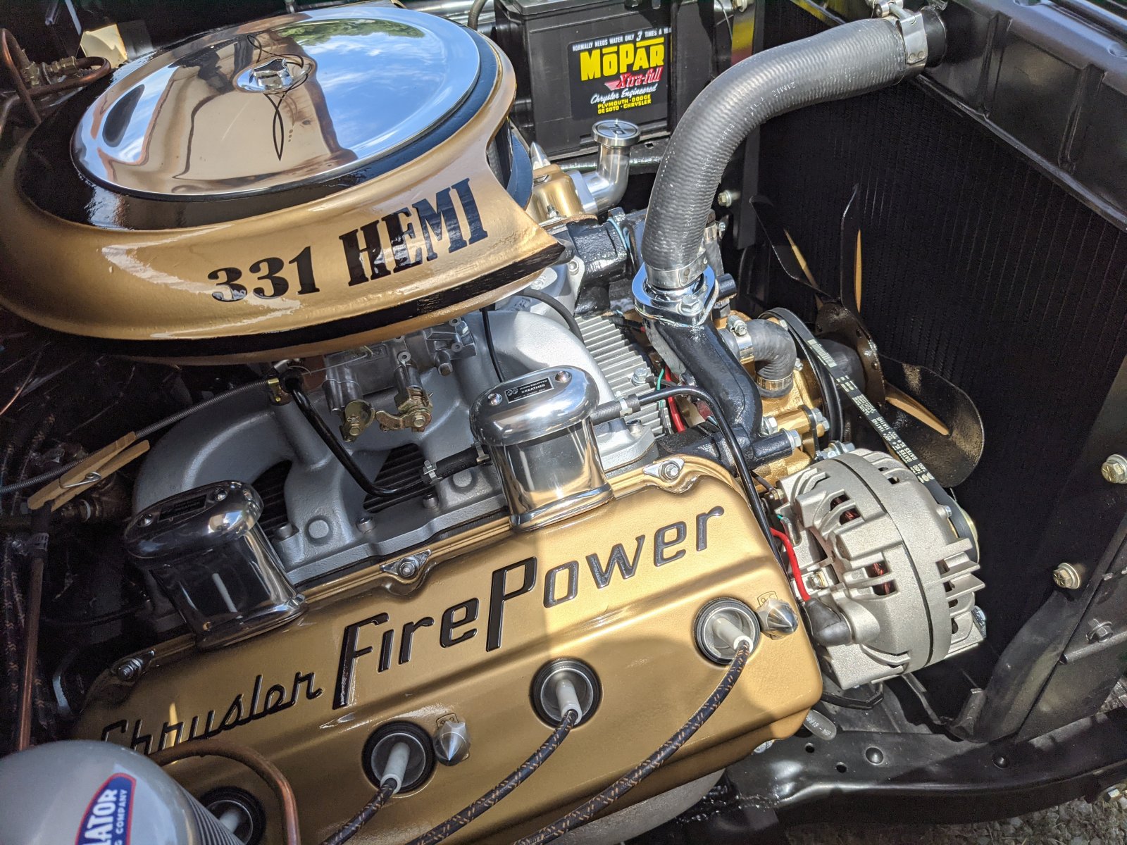

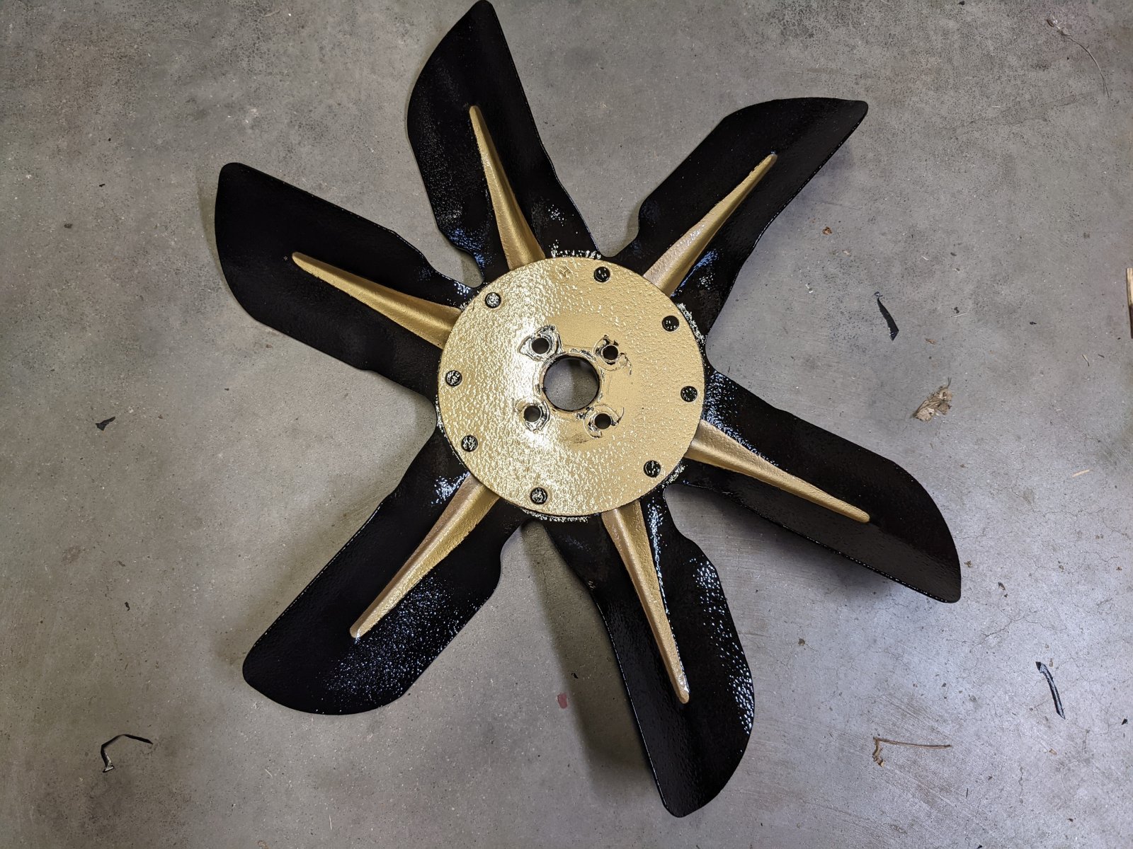

    Finally getting closer to having the truck running again. I repainted the fan where all the black paint came off when the radiator started leaking. The black enamel didn't adhere to the fan good at all so I stripped it all off. I was just about to paint it solid black instead of dealing with taping off all the stamped places like I did the first time but it did have a pretty cool effect when it was running so I redid the whole thing and clear coated it this time too. Fan6.jpg Fan5.jpg
    I was going to try and get it in yesterday but got sidetracked with other things and also decided I'd be better off installing my new mechanical gauges with the radiator out so I can step in there and have more room to work.

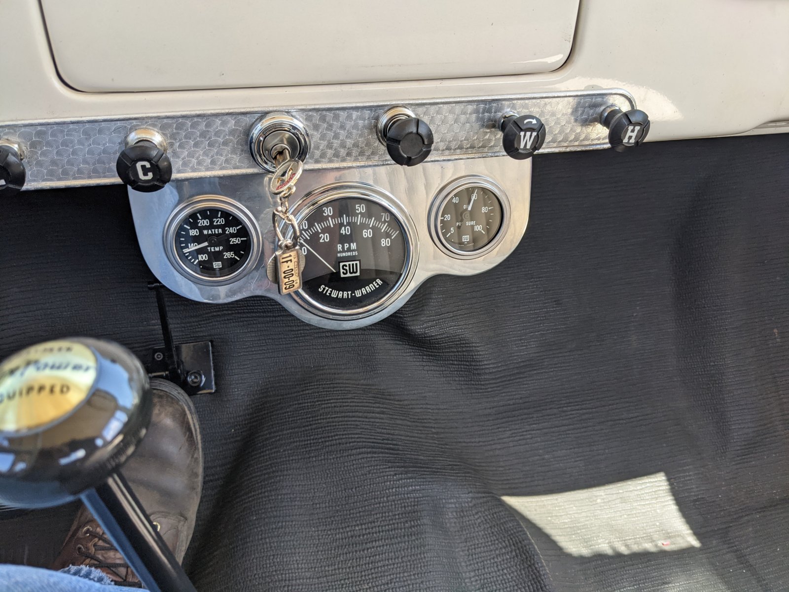

    Finally got back on the road again yesterday. Monday night I got my new mechanical gauges installed then bolted in the new radiator which was a perfect fit. EngineBay13.jpg EngineBay15.jpg Gauges1.jpg
    Last night I got the tach wired up to the TachMatch unit and installed in the truck. Another thanks to @60Pioneer for hooking me up with this tach as it looks so much better than the cheaply made electronic gauges I was running. Here's a picture with the lights on. Gauges2.jpg
    The mechanical oil pressure gauge reads way more accurately than the electronic one did. It's right where it was when I was running the engine on the stand instead of showing it almost always having 80+ psi of oil pressure. I feel a lot better with these gauges in there now.

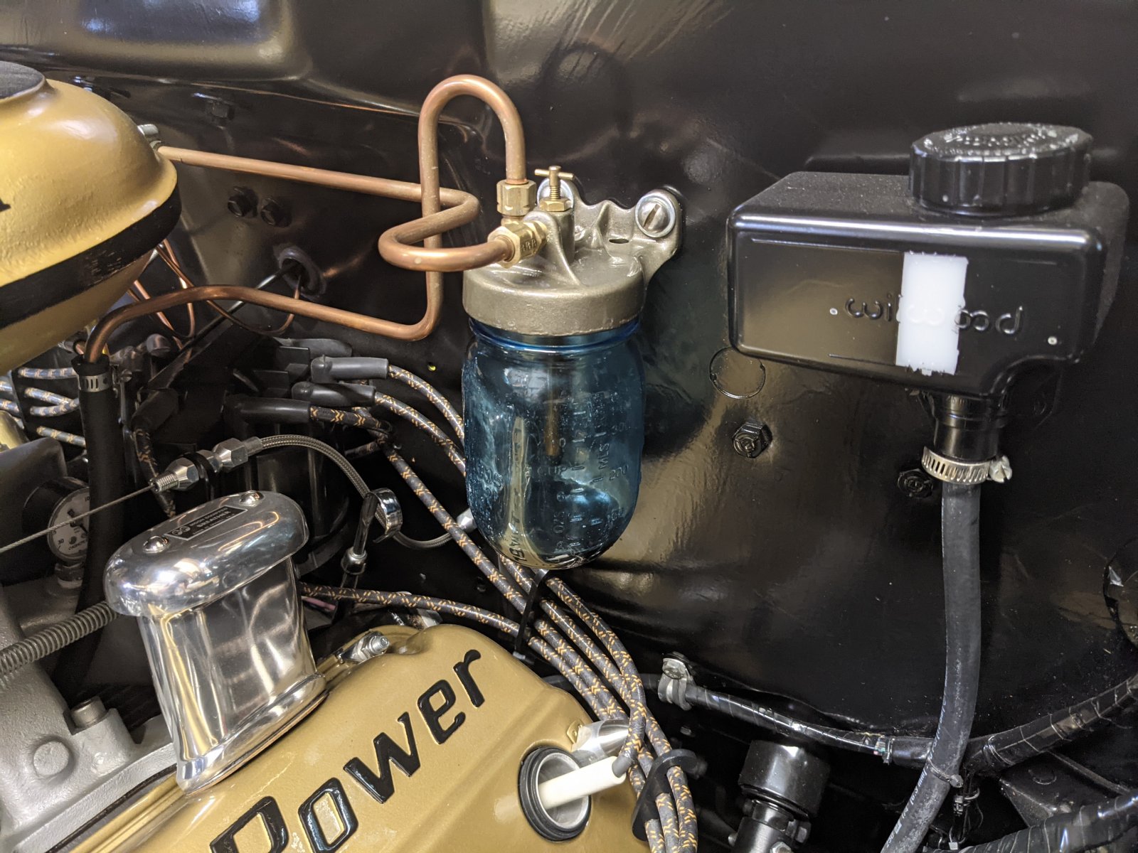

    I went to empty my PCV oil catch jar the other day and it busted when I was unscrewing it which was disappointing. OilCatchCan.jpg
    I was worried I'd have to come up with some completely different oil catch system but luckily it's the standard Mason jar thread that's always been used so I popped another one on there. OilCatchCan1.jpg
    Not as cool looking but it does the job!

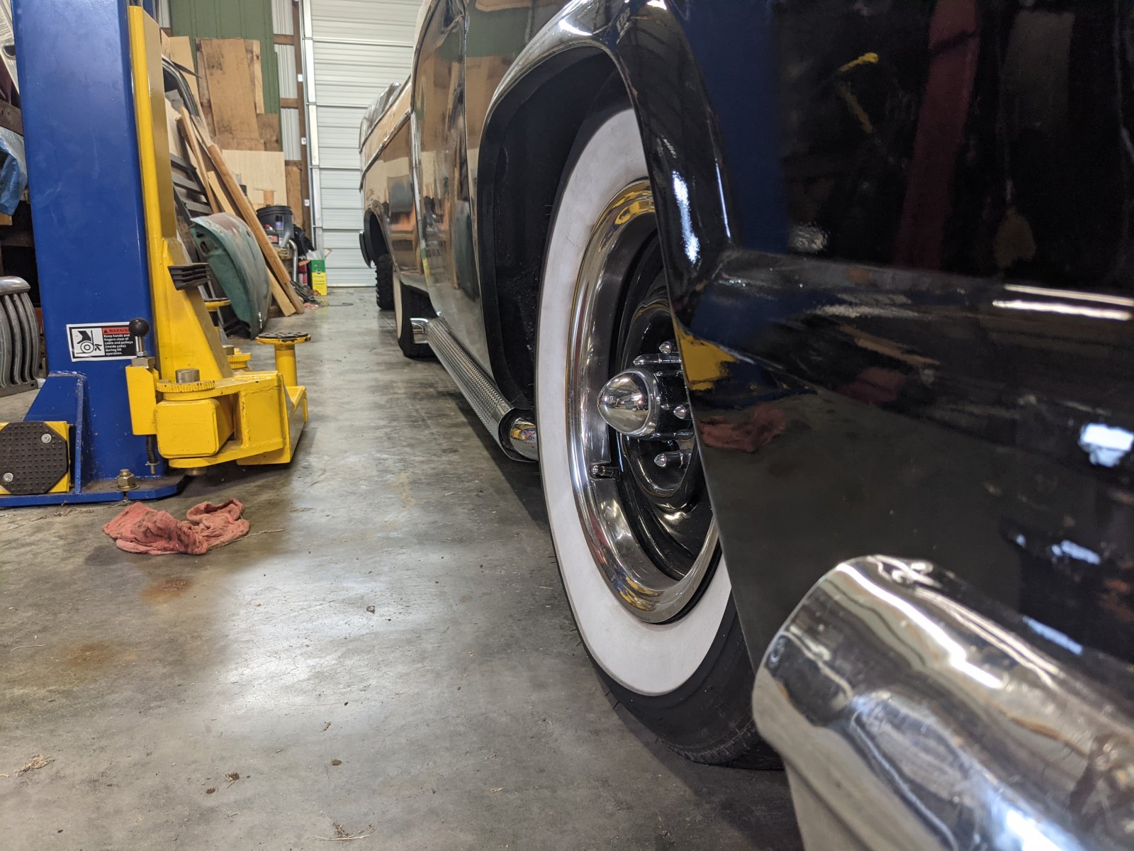

    One thing I've been having trouble with is the outside of the front tires wearing quickly. TireWear.jpg
    I don't have any experience in making front suspension adjustments so I don't really know what the culprit is or where would be best to start. I thought about posting about it before but didn't know if it would really be right here since the truck has been converted to modern suspension so if it needs removed I understand, but would appreciate any advice. NegativeCamber.jpg
    To my eye it looks like with the wheels pointed straight that they already have a negative camber. I'm wondering if with the Hemi in there now if maybe the springs are too weak for the weight. I replaced the power steering rack with a manual one and it is fairly difficult to steer. Is it maybe wearing the edges in curves when the weight shifts to one side of the truck?

    Did it wear the tires off before you changed the steering rack, or is that something that happened after the rack was changed?
    Its pretty unusual to wear the outer edge off both of the front tires, that usually points to the front wheels being toed in too much. Usually, worn parts, incorrect camber adjustment (generally not enough adjustment to tilt the top of the tire out enough to wear the outside edge off the tire), too much weight, or a toe out, would wear off the inside of the tires.
    That said, never underestimate how bad a screwed up wheel alignment can mess with the tires. What someone might have used as alignment specs could have an effect on tire wear as well, if it was originally aligned using the specs for the front suspension, which may have been designed for a vehicle with no where near the weight of your Hemi has, could be a problem as well. I've also seen alignment shops that will adjust a vehicle with too much toe in to compensate for worn front suspension parts they (or the customer) didn't want to change. Also, sometimes a wheel with a different offset (or width) will mess up the steering when turning.

    @gene-koning I drove it around a pretty good amount when it had the 318 Poly and power steering, and never noticed it wearing the tires like it is now. I might have toed them in too much when I switched the rack. It also has a slight pull to the right.
