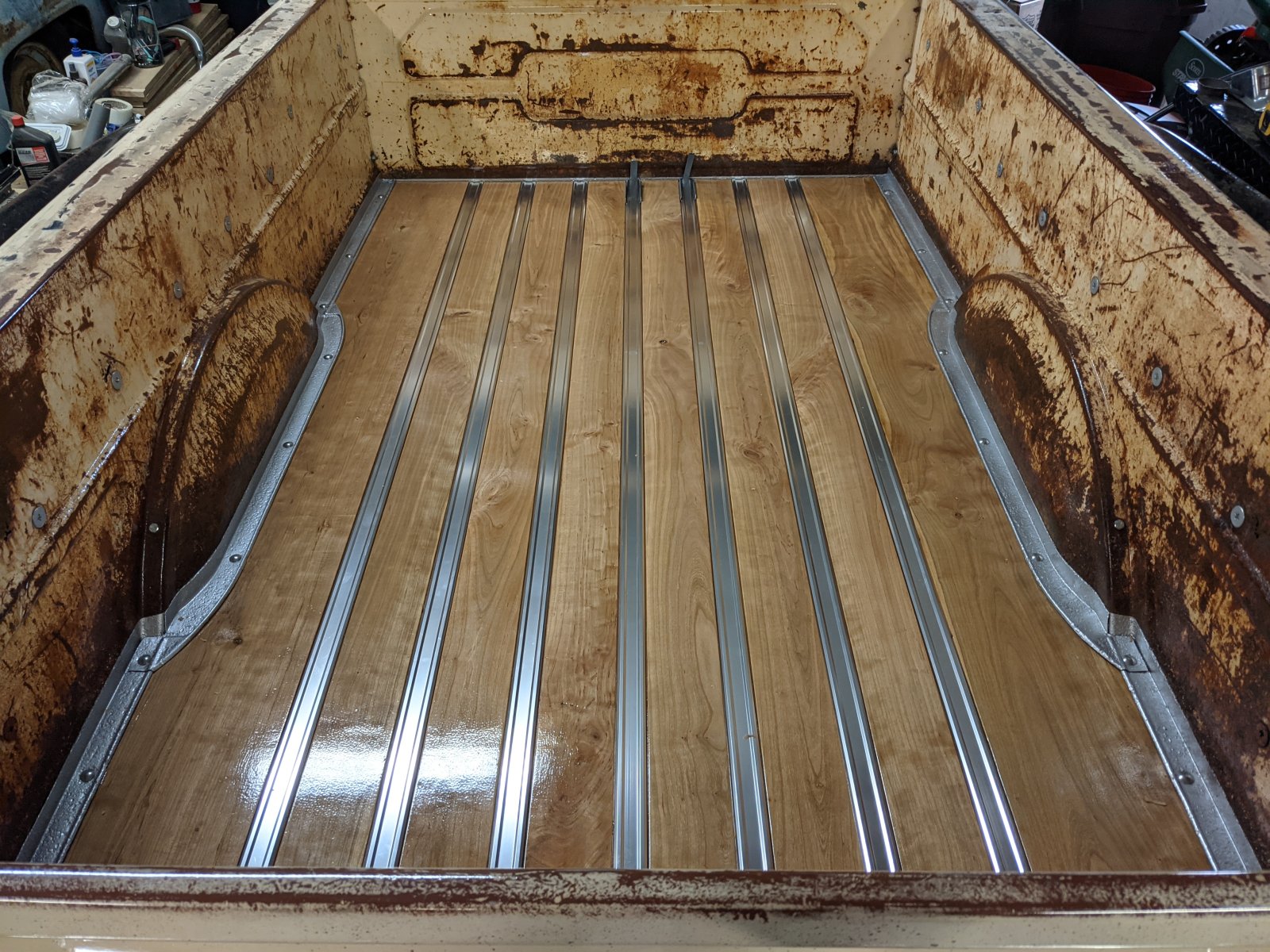

    Figured I'd do a little update on what I've been up to on the truck. With the nice warm weather finally coming to an end I spent last week trying to hurry up and get the bed wood cut for my truck. I started out with some wild cherry boards that were about one inch thick that I planed down to 3/4". A friend of mine rough cut them out for me, from a tree him and his son had cut down, on a small sawmill that he has at his house. Here's a picture after I had them all cut before I routed the edges for the aluminum strips. BedWood.jpg
    After the routing I sanded all the boards and applied some linseed oil to the tops to bring out the grain. I painted the bottom of them black. BedWood2.jpg
    For the finish I decided to go with some water based Varathane Spar Urethane. It's way thinner than I expected it to be. It's look just like a quart of milk. It seems to go on fairly well and levels itself so that's good. BedWood3.jpg BedWood4.jpg This is after about five coats. I still need to do some sanding and apply some more coats but I'm going to have to move everything to somewhere I can run some heat now. I also decided to tape off the edge of the bed rails and spray it silver so it would match the aluminum strips. BedWood1.jpg BedWood5.jpg
    I haven't decided just yet how I'm going to finish out the inside of the bed but I'm going to do something to make it look a lot cleaner than it is now. It'll at least look better with some wood in there!

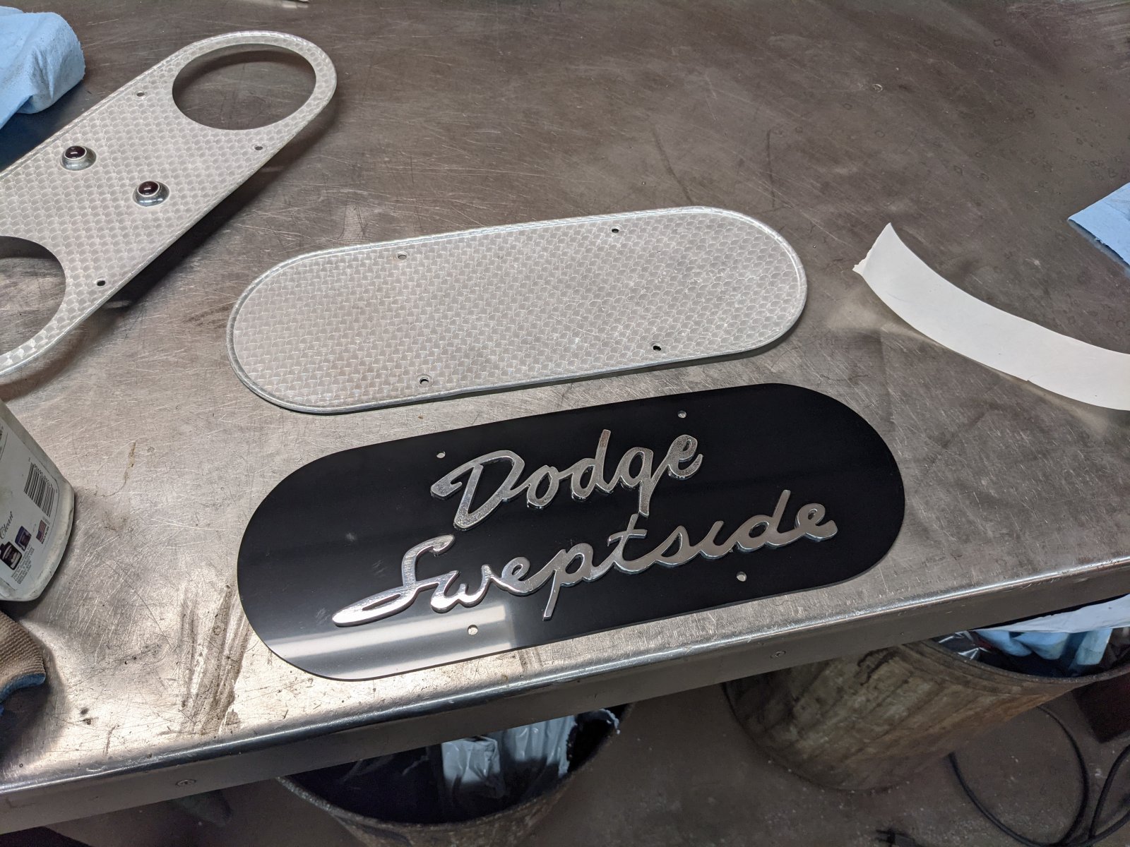

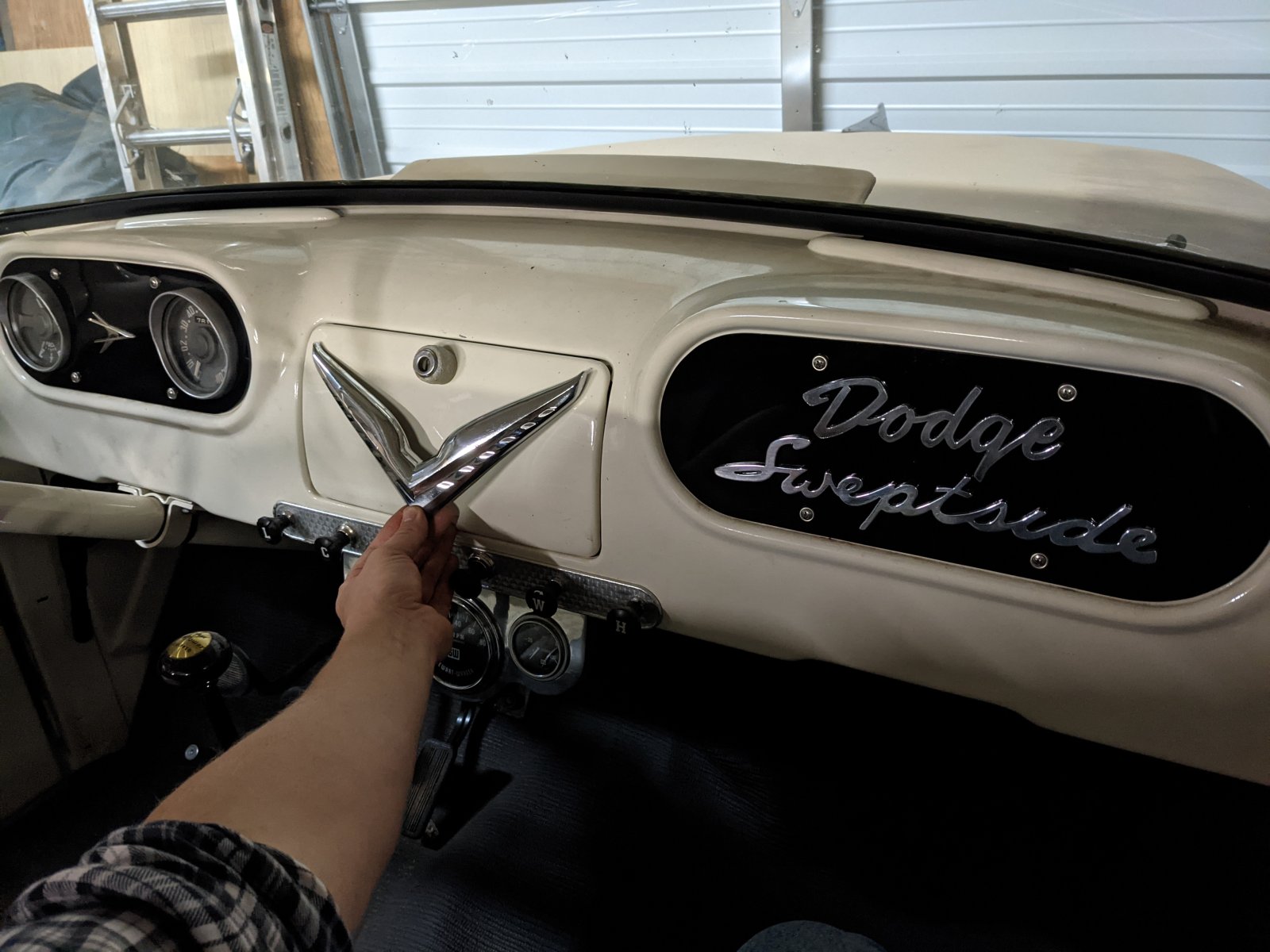

    Another thing I made last night was a way to display my Sweptside ornament I made. Since I don't know how long it'll be before I get around to messing around with the wagon tailgate I figured I might as well have it somewhere on the truck. DashPlate.jpg
    I took some black guitar pickguard material and made a plate to go on the dash on the p***enger side. DashPlate1.jpg
    I'm also going to make a black one for around the instrument cluster since I've done away with the warning light set up when I went to mechanical gauges.

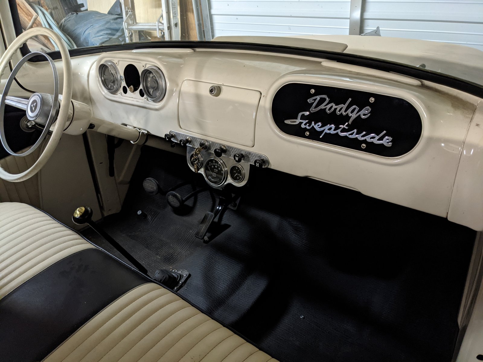

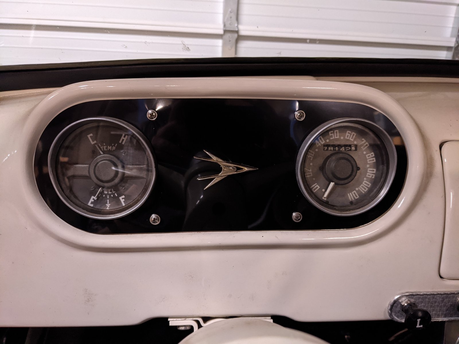

    Finished the plate for around the gauge cluster today. I cleaned up a Forward Look emblem I took off a '56 Desoto I s****ped a while back and put it in the space in between. DashPlate2.jpg DashPlate3.jpg
    I'm crazy about the Mopar emblems and ornaments from the '50's. I don't want to get things too busy on the dash but I'm thinking that the '51-'52 Chrysler V emblem I have would look good on the glove box door and fits perfect there. DashPlate4.jpg

    I’d skip the v emblem. It would make the dash look like a Warshawski’s special. I think it is about perfect as is. Just my 2 cents.
    Hotrod1959, MRW1994 and rockable like this.
  21. pprather
    Joined: Jan 10, 2007
    Posts: 9,737
    pprather
    Don't over do it with the V8 emblem.
    rattlecanrods, MRW1994 and rockable like this.

    I'm of mixed feelings. The truck is a 1958. This was during the height of glitzy and gaudy on American iron. The exterior is going to be flashy, so the inside can withstand a little flash too. You just don't want to overdue it, but in the end, it's your taste that matters.
    MRW1994 likes this.
  23. MRW1994
    Joined: Dec 31, 2021
    Posts: 263
    MRW1994
    Thanks for the input everybody! I was afraid it might be a little crowded with it there. I'll leave it off for now and maybe come up with another way to use it somewhere else on the truck down the line.

    I wouldn’t worry about the inside of the bed sides. Looks like a truck. That wood floor turned out beautiful, nice work. Love all the other little details as always!
    I'm real happy with how it turned out but I'm also really glad that it's done! I don't really care for working with wood like I do metal.
    Here's a couple of pictures I took of it outside today. BedWood7.jpg BedWood8.jpg

    Nice job on wood, notice how it color matches the bed sides. Stop now looks good as is.

    Ya know you’re going to look back someday and say “I should have done those bedsides “.
    Sure the side look like a “truck”, but the bed doesn’t;)
