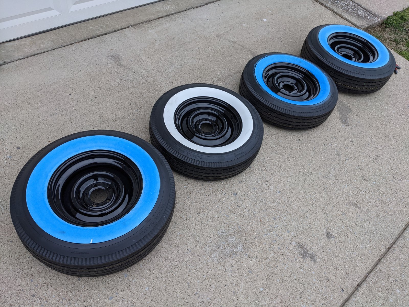

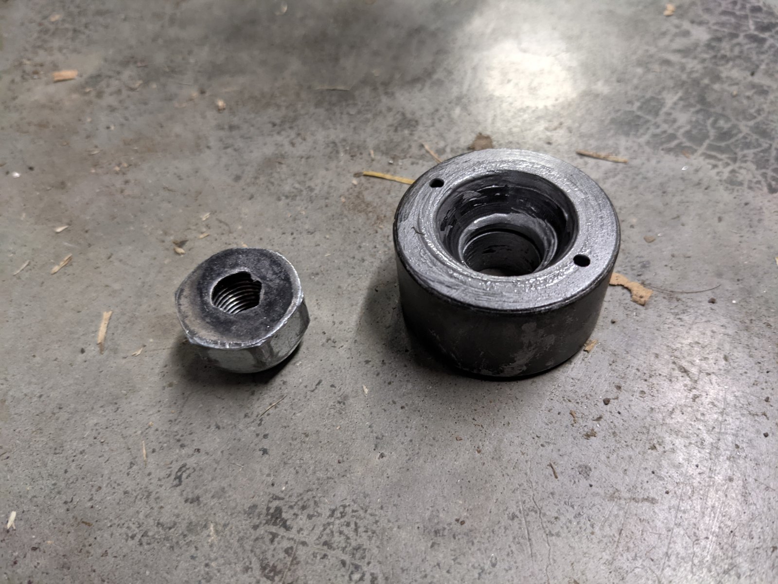

    Took a minute to get all that blue off! I decided to replace all the rear wheel studs with some longer ones. WheelsStuds.jpg
    I had already replaced the left hand ones when I was rebuilding the rear end but I was never comfortable with how short the stock ones were so there's plenty of thread engagement now. The ones I put in recently came out easy but the old ones took a little bit to get out. WheelsStuds1.jpg
    You can see the number the air hammer did on the lug nut I was using. The wheel stud installer with the bearing worked great. 1958DodgeSweptside19.jpg 1958DodgeSweptside17.jpg
    They look great and ride even better. I'm pretty sure the beauty rings I've got will work. I think I'll end up putting them on because I like the way they look but I couldn't bring myself to mar that fresh black paint yet.

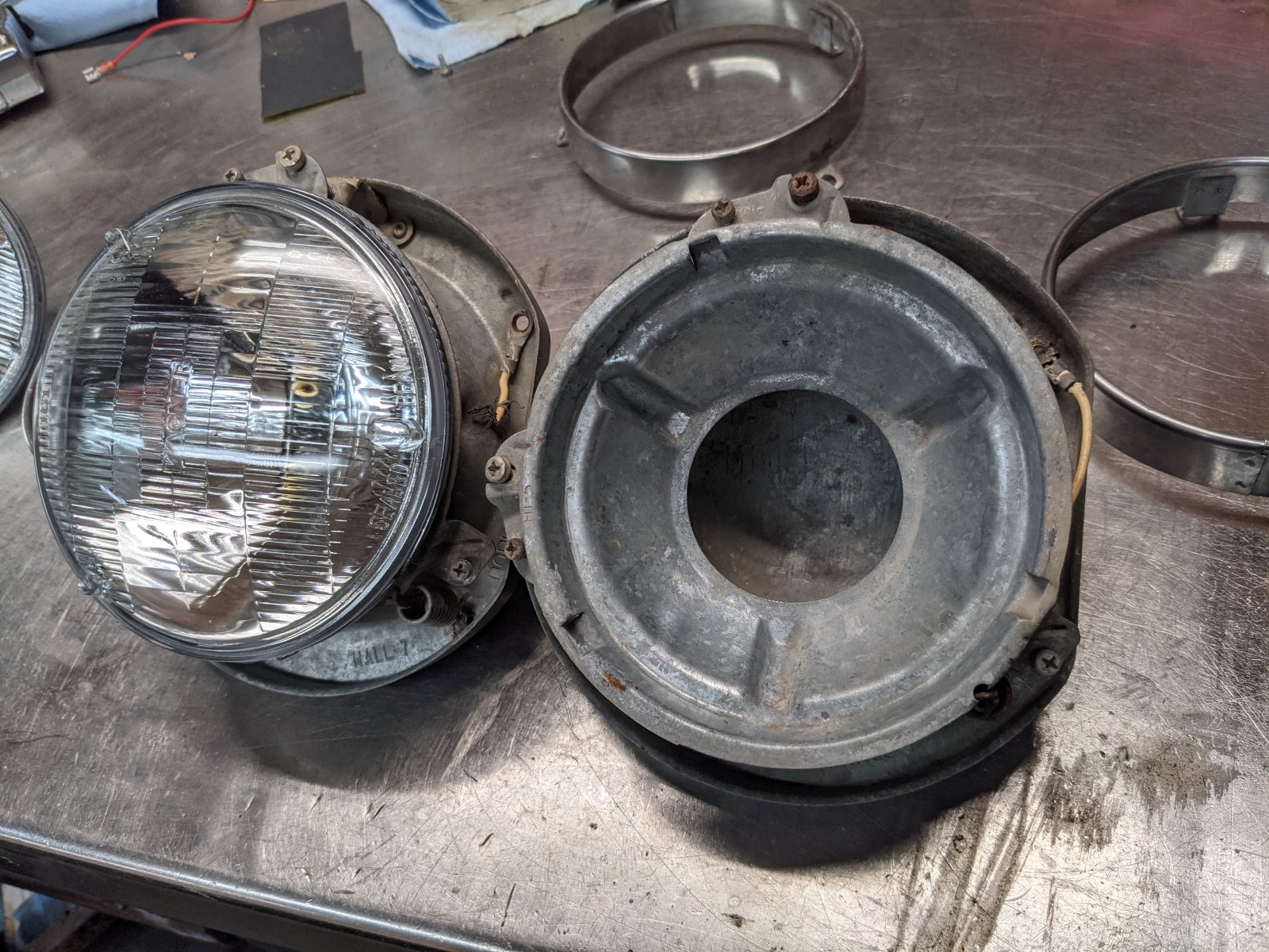

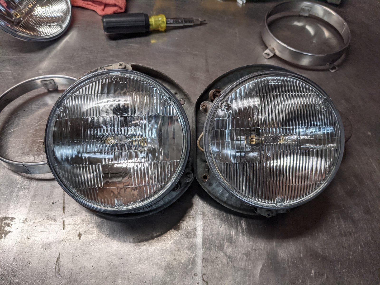

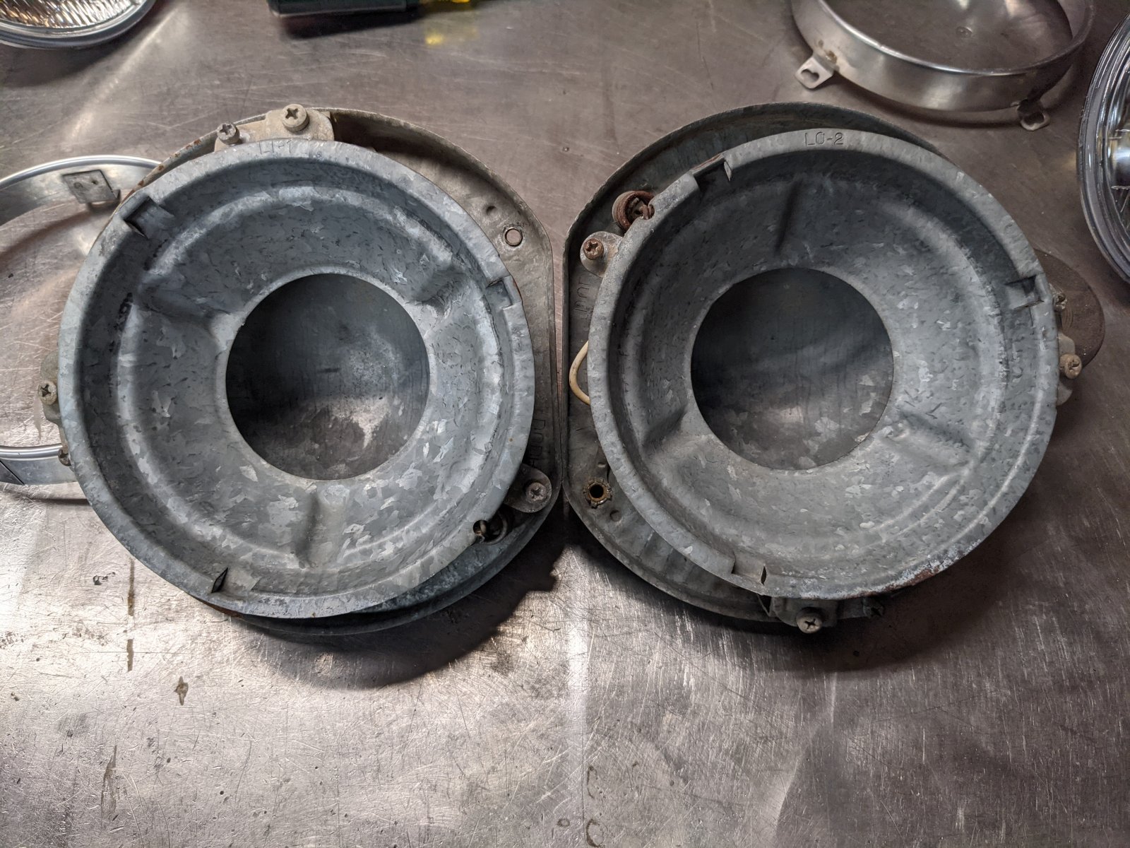

    I am trying to figure out the headlight ***emblies now. It took some doing to get the single ***embly out as it was pretty rusty. I'm surprised there was a good enough ground for the lights to work! Headlight2.jpg
    It looks like single headlights is all this truck has ever had because I had to knock out the half moon plate to let the back of the quad housing go in. Headlight9.jpg
    The single ***embly was mounted to this plate. I ***ume I will have to make something similar for the new ***emblies. I have looked around for a picture of how they were mounted but haven't had any luck. Headlight7.jpg
    I ***ume they go in like this as this is the only way they would fit. I'm also having some trouble figuring out the buckets I got off of eBay. I hoping somebody will be able to shed some light on the situation for me. Headlight6.jpg
    Y'all might have noticed in the pictures of when I was mocking up my bezel that the high beam was vertical. I think I have the driver side right now. Headlight5.jpg
    I have two buckets that are marked LI-1 and LO-2 that line up right but then the other two I got are marked HI-5 and will only hold a high beam sideways. Headlight8.jpg
    I tried looking into it and found an article about some later Mopars that also had a RI-1 and RO-2 for the p***enger side. If anyone has any information about this I would very much appreciate any advice.

  18. gene-koning
    Joined: Oct 28, 2016
    Posts: 6,902
    gene-koning
    That 58 Quad headlight truck I had was many years ago, and then it was only here for a short time.
    My take on the buckets. The two flat sides of the buckets should be together, that allows the two lights to be closer to each other.
    If the buckets are marked, RI-1 and RO-2 and LI-1 and LO-2, the letters designate the bucket location.
    "R" (right side of truck), "L" (would be the left side of the truck), "I" (inner light, towards the center of the truck) or "O" (outer light, towards the outer edge of the fender). The # "1" (probably for the 1 element light or Hi beam only has two wire connections) and the #"2" ( probably for the two element light or the hi-lo beam light, has 3 wire connections). The bright only was always towards the center of the truck. I'm sure the labeling was for the production line purposes.
    For the record, the 3 notches in the headlight buckets match up with the 3 bulges on the lights. The lights only fit correctly in one position, but can be rotated and the bulges will fit in any of the 3 notches (they won't fit snuggly into place in the wrong rotation but can be mounted that way, a lesson I learned at that 1st job in the gas station many years ago).
    Later versions of the quad headlight buckets are one piece units with both buckets welded to each other.
    Thor1, Stogy and MRW1994 like this.
  19. MRW1994
    Joined: Dec 31, 2021
    Posts: 263
    MRW1994
    I agree I think it's going to be a very good change. I can't wait to see your new Hemi in your truck by the way, that's going to be slick.
    Thank you, I would really appreciate that. I just haven't been able to find much information about them.
    Haha well I have taken to having the occasional inebriant down at the shop now but you don't have to tell her that part!
    That makes a lot of sense about the designations. I'm not sure what the HI-5 ones are for but I ended up with two of them. I was looking at it before though and where the larger protruding nub on the lamp is for alignment and the shorter one is what sits on top of the bucket it doesn't seem like it would be too hard to cut a notch in the correct location in the bucket and maybe make the ones I have work.
