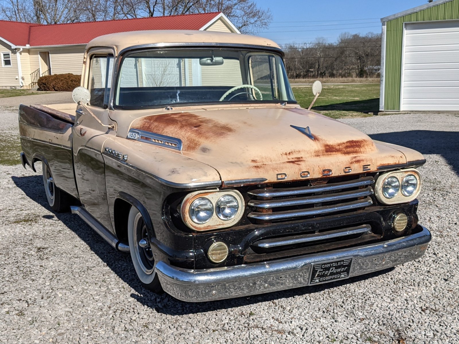

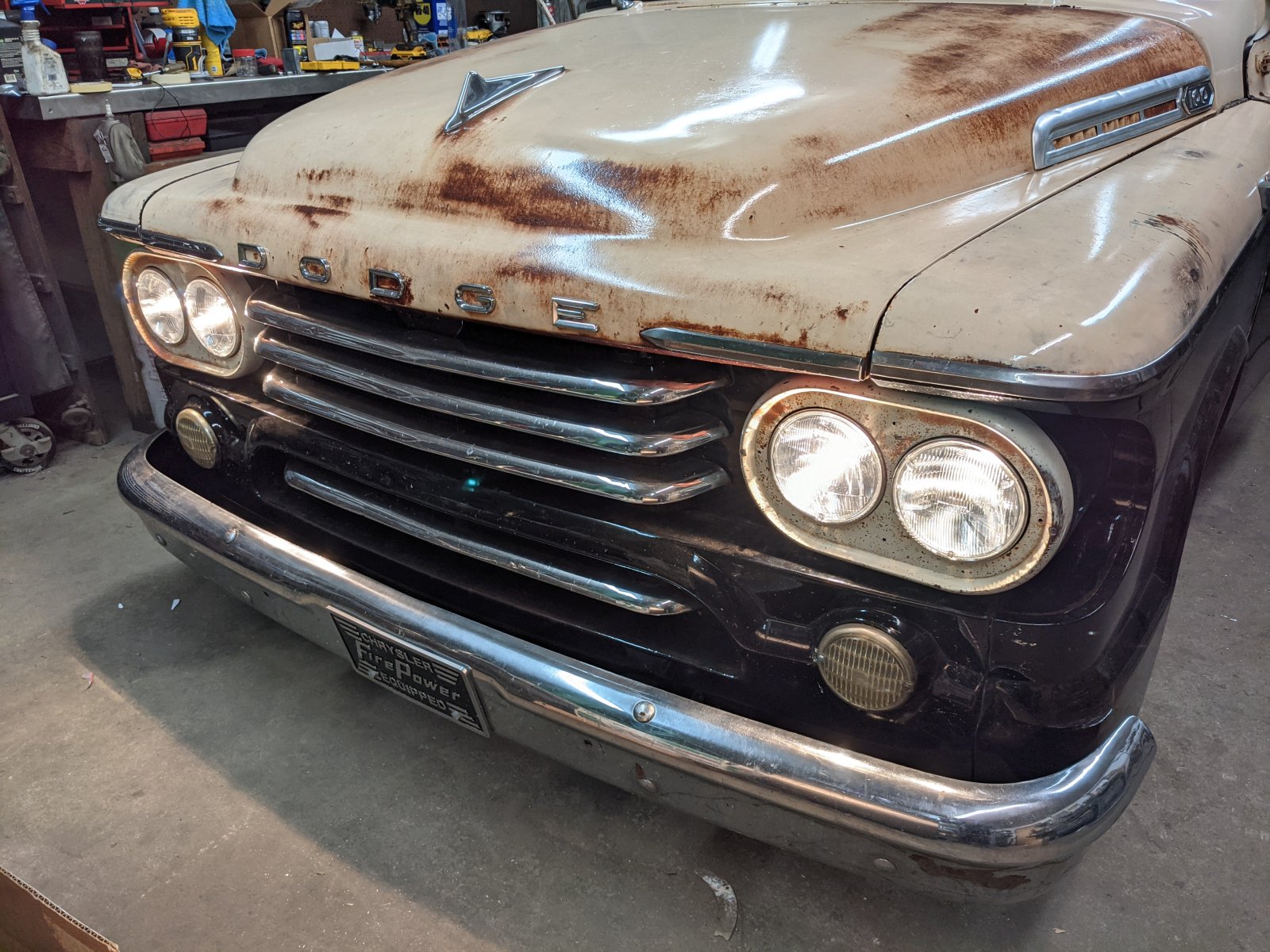

    Got my lights all wired up after making some backing plates for the buckets and notching the oddball buckets I had for the p***enger side so the lights were turned the right direction. Headlight13.jpg
    I really like how it looks and it wouldn't take anything to switch back to the way it was. I'm just about finished making the other trim plate. I think it will look even better when they are on.

    I like it with 4 eyes.

    4 eyes imo look better but, I like both options.
    Most of the time when I paint something finned like this I usually use a small brush and some 1 Shot but I decided to try something I had read about a while ago where you use grease on the part you don't want painted and spray the whole thing. Headlight14.jpg
    I used some Hi Spot blue with a roller and was very happy with the results. The paint on top peeled away without much effort at all. Headlight16.jpg
