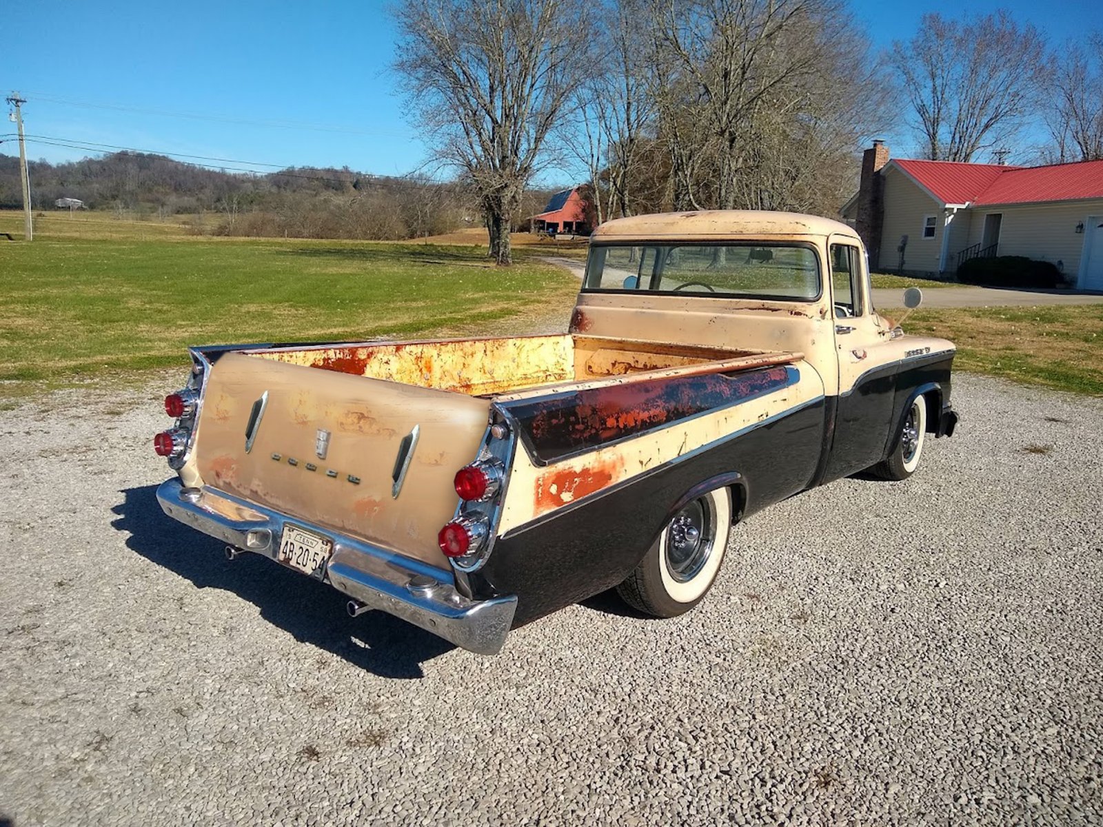

  13. gene-koning
    Joined: Oct 28, 2016
    Posts: 6,348
    gene-koning
    The wagon tailgate is the same from 57 to about 60 I think. One would be real hard to find, the bottoms tended to rot out, and I'm pretty sure they would not be wide enough. My son has a 57 wagon, if I remember, I'll try to get a width on it.
    I suspect the main reason Dodge didn't use the wagon tailgate on the truck was because of the bottom hinging, the truck and the wagon were way different. The truck had a simple hinge pin that fit into the bottom hollow tube on the tailgate and bolted to the bed rear uprights. The wagon has a double hinge that is torsion rod sprung, the wagon gate had to swing up and out as it opened. also, method for holding the gate closed was pretty different, the truck tailgates were held closed with chains on the outside, the wagons had a center latch on the inside. You also need to take into account the wagon has a rear window, window tracks, and a window crank mechanism that the truck doesn't need. The wagon tailgates were very heavy, the truck tailgate is pretty light.
    One more little thing about the differences between the two, the truck tailgate stands vertical to seal against the inner bed sides. the wagon tailgate sits at about an 80 degree angle, won't be an issue at the top, but could be a real problem with hinging at the bottom, because you would want to keep the truck box side level when opened, but the car side needs to clear the bumper when its open. The wagon had a filler plate that was attached to the inside of the tailgate that filled the gap between the gate and the floor when it was open, but folded up against the lower tailgate when closed. That filler plate probably wouldn't survive inside of a pickup bed very long.
    Having laid hands on both, a standard pickup tailgate, and a wagon tailgate, merging the two to function correctly would be challenging. Gene

  26. While I'll agree with Gene's ***essment of the difficulty of using a wagon tailgate, that doesn't mean it wouldn't look better, much better. If your metalworking skills are up to it, why not just build a tailgate?
    Using the profile at the ends of the 'fenders', extend that straight across, eliminating the compound curve of the wagon gate. Thin the tailgate to the minimum; after all, you no longer need the 'thickness' without a window. Some creative engineering on a simple hinge pair, maybe a pair of bear-claw latches to keep it closed or simple chains inside the bed. You'll end up with the tailgate platform higher than the bed level when open, but not objectionably so. Extend the bed floor to make up the remaining gap. 'Open' the lower flange under the tailgate so any **** that falls though goes to the ground instead of collecting under the gate. Done!

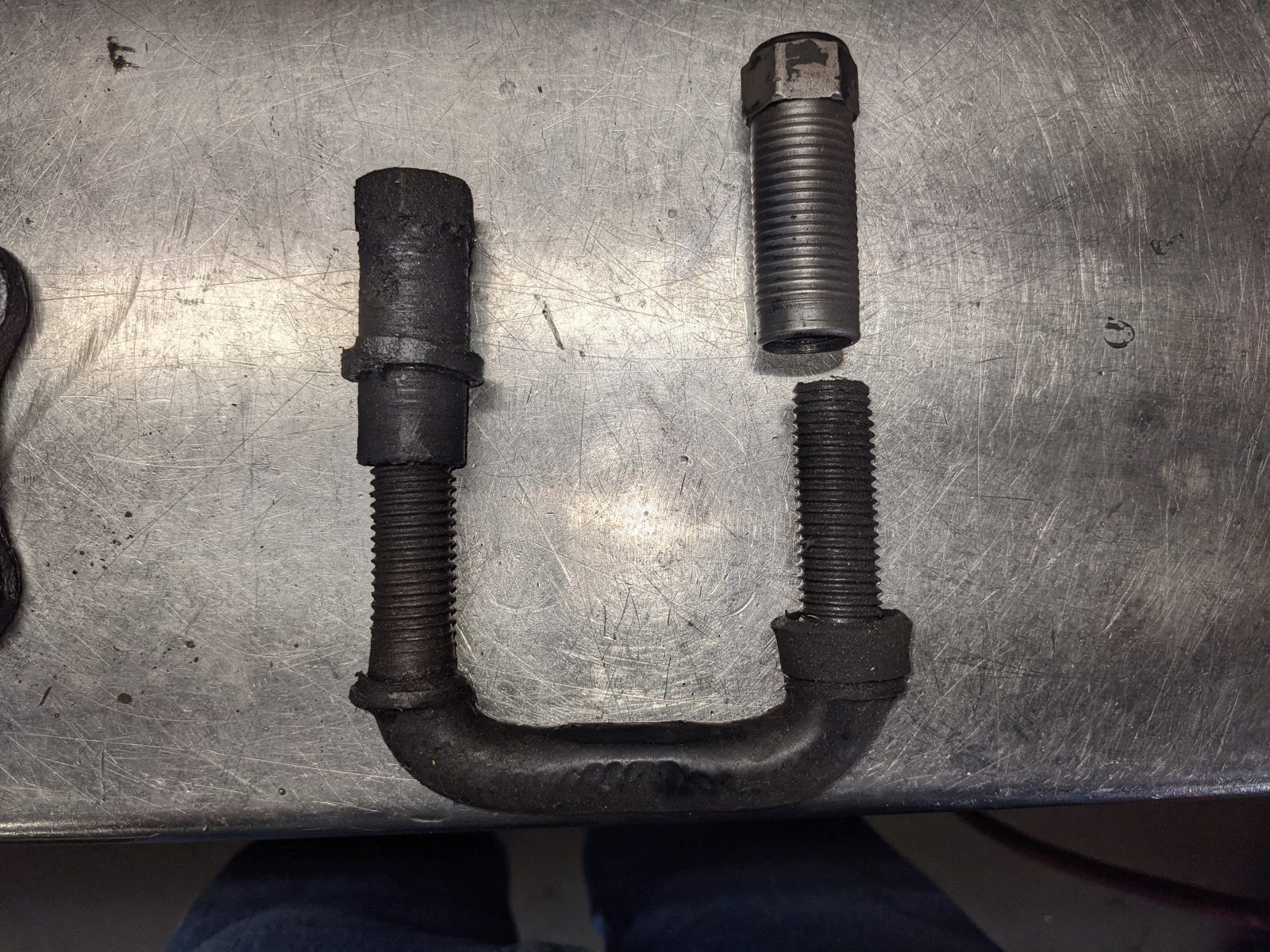

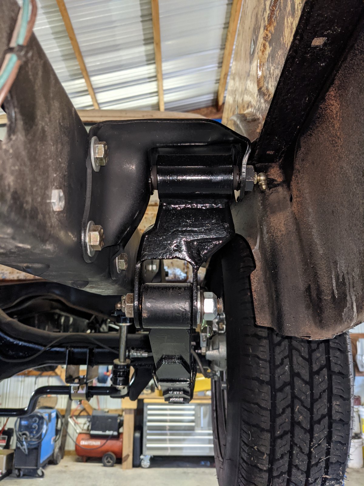

    It had a plywood bed with carpet on top. I'm going to be installing a wood bed with the polished aluminum strips. 3.00:1 open 9" Ford rear end that had a real good leak. One of the exhaust pipes was actually touching the plywood. RearEnd.jpg RearEnd1.jpg
    I had a B body 8-3/4" rear end that was the perfect length. I went through it and checked all the play and installed new seals and bearings. The third member is a 489 case 3.55:1 cone type Sure Grip. The truck had a lot of body roll, I reckon because of the length of the wheelbase and the weight. It cracked me up any time someone rode with me because I had the steering wheel to hold on to but the p***enger was all over the place! I finally found a sway bar that was the right length for my frame. I'm running it backwards because of the shocks being mounted towards the front but there's plenty of clearance between the front bar and the snout of the third member. Looks kind of funny but I didn't see why the concept wouldn't be the same regardless of which way it was mounted. RearEnd4.jpg
  29. MRW1994
    Joined: Dec 31, 2021
    Posts: 262
    MRW1994
    The leaf springs had a lot of wear in them. Also the spring perches on the 9" Ford weren't exactly the right length apart which made the springs kind of fan out. The front leaf spring eye had a bushing in it which I replaced with a bronze bushing. The rear shackle ***embly was a little more involved. RearEnd5.jpg
    The shackle slid into the rear eye of the spring then the bushing part threaded on it and also in to the shackle mount. I could never really wrap my head around what was supposed to be the wear item here. I guess since the grease fitting is in the threaded bushing it was supposed to stay stationary and spin on the threads of the U shackle. RearEnd6.jpg
    However it was meant to work it did all the wearing on the shackle mount. I drilled out all the rivets thinking I might bore it out and put a bushing in it. RearEnd2.jpg
    Instead I ended up finding another set of shackles and modified them. I offset the shackle and made it the right width for the leaf spring. I turned a bronze bushing for the rear spring eye and drilled and tapped a grade eight bolt so that I could grease it. Hopefully this will wear a lot better and at least be easily rebuilt. I also installed some spring clamps to get them all back in line. It's definitely a lot tighter now and I hope will make the ride better too.
